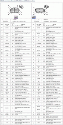

Yes, the D-pillar speakers are the ones all the way in the back. GM calls them "twiddlers". Here are the pinouts from the GM service manual. Y91 is the LUX configuration, the one that's titled "w/o Y91" is your current non-LUX wiring. Don't plug the amp in until the wiring is changed, it will damage it.

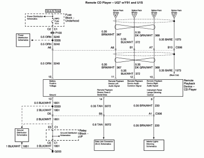

This is the schematic for the CD Changer.
The only ones you need to add are Audio Left, Audio Right, Audio Common and Class 2 Serial Data wire. They splice into the same wires that the XM radio use for audio input. The computer system then determines which input you want to use automatically. No need for any additional programming. The other wires are already there in the main harness even in the tahoe that you can use (such as power for the cd changer, backlights, etc.)
About those wires I was just referring to...they are all spliced together at SP250 or Splice Pack #250 (their name for a group of wires that are all spliced together).

Sorry for the poor quality. Perhaps someone else could find the higher resolution version of this. Console connector C306.
W/O Y91 is for tahoe/yukon/avalanche models.
w/ Y91 is for Denali/Escalade models.
This is how i figured out how to get the wires moved around.
