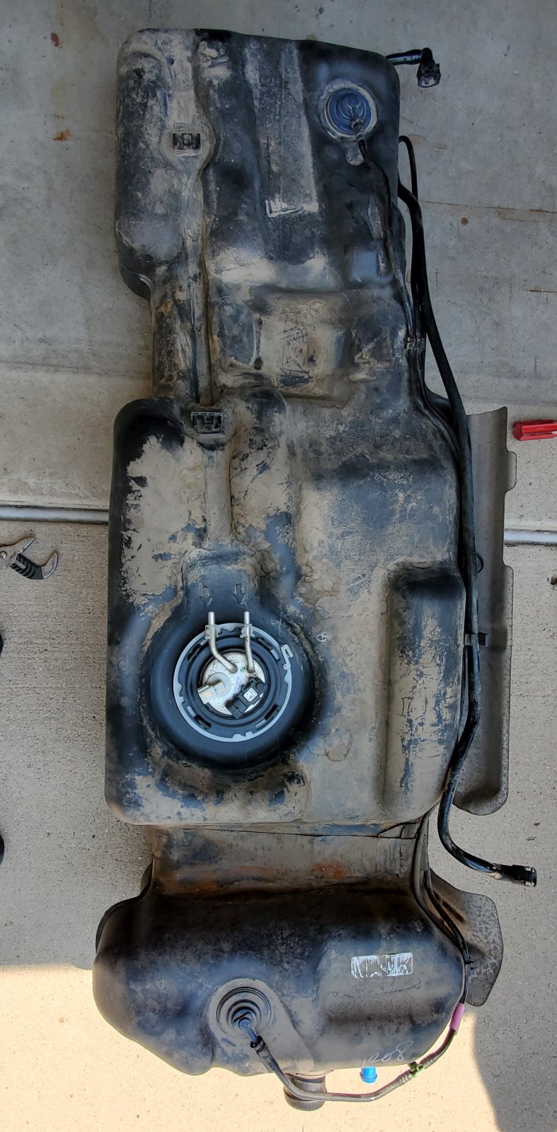

On the right side in the pic you will see a metal sheet. Between this and the tank is the evap system's plastic tubing from the vent valve (right bottom) to the charcoal canister (top right side).
If the mechanic did not insert these lines correctly and then pushed the tank up with hydraulik jack and screwed it tight, he may have squeezed this line.
I would say that this is the most likely reason, because if he would for example forgotten the vent valve connector, the vent valve would stay open and you would receive an engine lamp and message "check gas cap"...
@bajajoaquin That pic is of my flex fuel tank when it was on the ground; if yours is not FF then some of the routing may be different.
While the tank is down you might see if the mechanic would gently blow some compressed air through the lines to make sure they're clear. Not a lot of pressure, since that can bunch up any charcoal pellets if there are any in the lines. He should be able to easily blow (lung) air through the canister.
Also might be a good time to pull the fuel pump back out and verify the level function with the cluster gauge.
