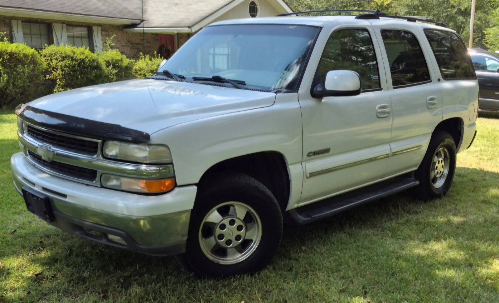

Hi! New to the forum. Bought a 2001 LT Tahoe last September with 268,000 + miles. Excellent maintenance records from previous 2 owners ( i mean, 12 pages of spreadsheets of maintenance). Original engine and transmission. For 3K cash, we are very happy with the beast.
Problem... We have been chasing a check engine light with various codes, (emissions, mostly), but the biggest issue right now for me is a fuel smell when we fill up the gas tank. If it's 3/4 full, you don't smell fuel, but if it's topped off, it reeks. We've replaced the gas cap with OEM part, reconnected a loose vacuum line under the rear of vehicle, and tightened the fuel hose clamp to the tank. The fuel smell seems to be coming from the rear-- not in the cabin per se (although our dog might disagree)... but, when I open the lift gate after filling up, it's like I poured gas on the back of the vehicle. Any suggestions? Hubby and I are pretty reasonable home mechanics and have worked on plenty of older Chevys and other vehicles (current resto project a 1964 beetle). Thanks in advance for ideas...
