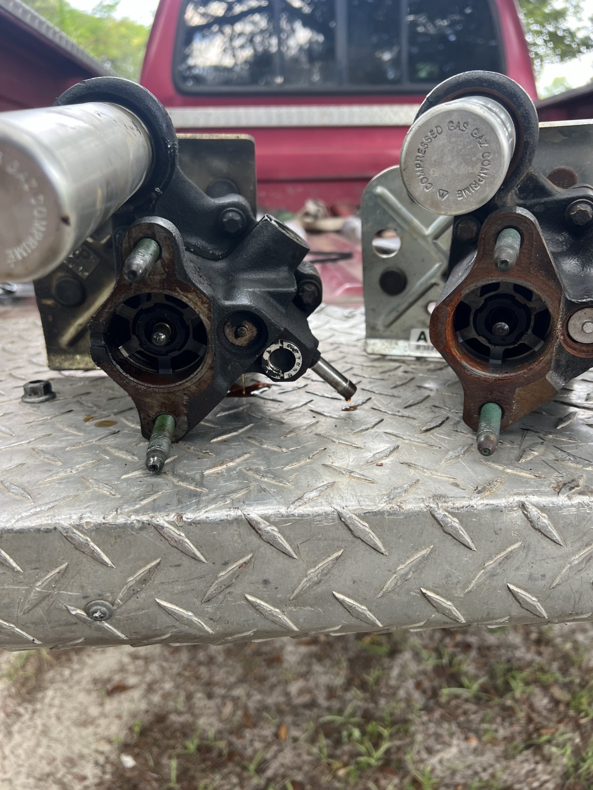

So did some googling or uhhh…. Rock autoing and found that there are two different hydro boosters. The one with the king cylinder like I have in my Tahoe is for the gas trucks, SUVs and 2500HDs, and is rated for 7200# whatever that means. The short cylinder one is for diesels and is rated for 12k#. It explained why my RCSB always had a better feeling brake pedal than the Tahoe while both are hydroboost it has the diesel one.
So now I gotta rob that off it lol.

Good thing, I had cylinder envy. Shorty on my yukon,thing fookin stops awesome. But if it could stop awesomer I may had to upgrade.
Does it work like an accumulator? To store charge in the event of a failure or something? Not sure why they would have diff sizes tho

So the smaller one is rated for more weight and is what came in the Dmaxs. Is yours factory or did you do the swap?

-Swapped from $20 catch cans to my $300 Mighty Mouse and found out my nitrogen cylinder on my Tahoe hydroboost which I think is OEM. Is actually twice the size as my RCSBs which is from a duramax. It had clearance issues so I had to ghetto fab a bracket.

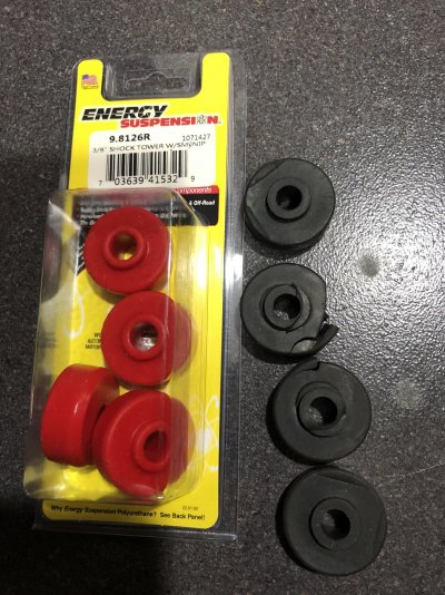

-Lastly, removed steering stabilizer. The shock seems fine but the rubber bushings are completely gone. I’d like to replace them with poly and maybe a Bilstein shock cause they are pretty. But if anyone has a link or part # to poly bushings I’ll just do that. Although I’m gonna drive it a bit and see if I think the stabilizer is even worth it.
Member just posted this 299997-f3d6336ca0c2c1b54e4521b363ed57a9.jpgused these for his stabilizer.

Member just posted thisView attachment 406081used these for his stabilizer.
Perfect thank you! Added to my amazon cart.

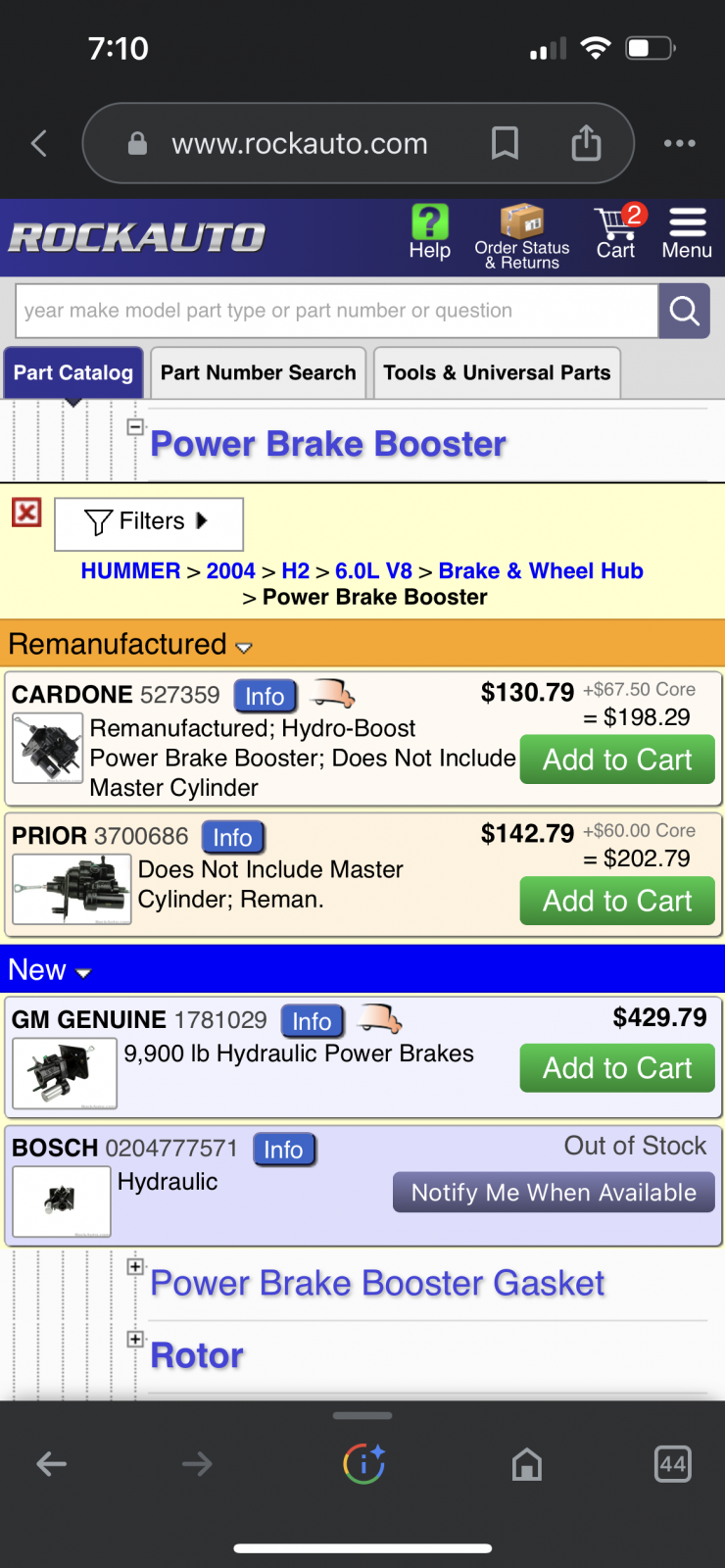

Got my diesel hydro booster unit in and it feels great, much better than the old Tahoe unit and exactly how I remember my Silverado feeling. I did notice the 290k mile Tahoe unit has been leaking awhile and it’s actually something I remember seeing when I first bought the truck. I would wash the engine bay and a few days layers some grimy buildup would be around the booster.
So it’s possible that just the Tahoe unit was wore slap out, but I think it’s the 12k# rating vs the 7,200# rating.
Also interesting is that Hummer H2s have an even different hydroboost unit that’s rated for 9,900#.
Diesel guys seems to think the 2011 LML duramax booster is even better than the 12k# unit found in 2001-2010 diesels. So I’m trying to dig some ratings up on those but nothing yet.

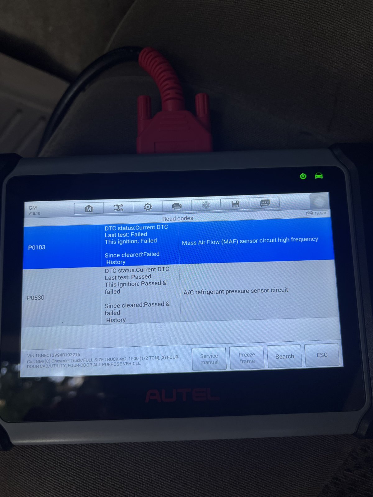

I’m about to lose my mind over this AC again. After repairing the bare wires going to the pressure sensor that was eliciting the P0530 code it worked great for a few days. Then like usual it stopped working again, but has no code and my wire repair was very solid. Is it possible that it’s the HVAC control panel in the dash, or the blower motor resistor?
Looking at a scanner when the AC button is pressed ON, the scanner shows AC requested NO. As if the button is just broken.
Any of you TECH2 owners think a tech2 would have some sort of function that would help over HPT or this Autell?

Guess I never updated this, the AC issue ended up being a bad pin in the pigtail going to the pressure sensor. That’s been fixed and it’s had no AC issues. I did start having horrible REP issues again and swapped the little black control box on the firewall with a known good one and I think it’s fixed. I honestly only drive the truck a few times a month now which is nice, it needed a break from the 20k a year it got for a few years. I still have all the 4x4 swap parts and I might be looking at doing that in the late spring.

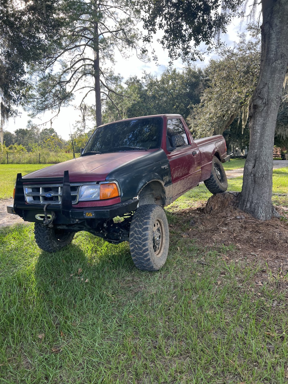

Been jamming away at making my ****** little ranger become a good DD and it’s excelling so far!
