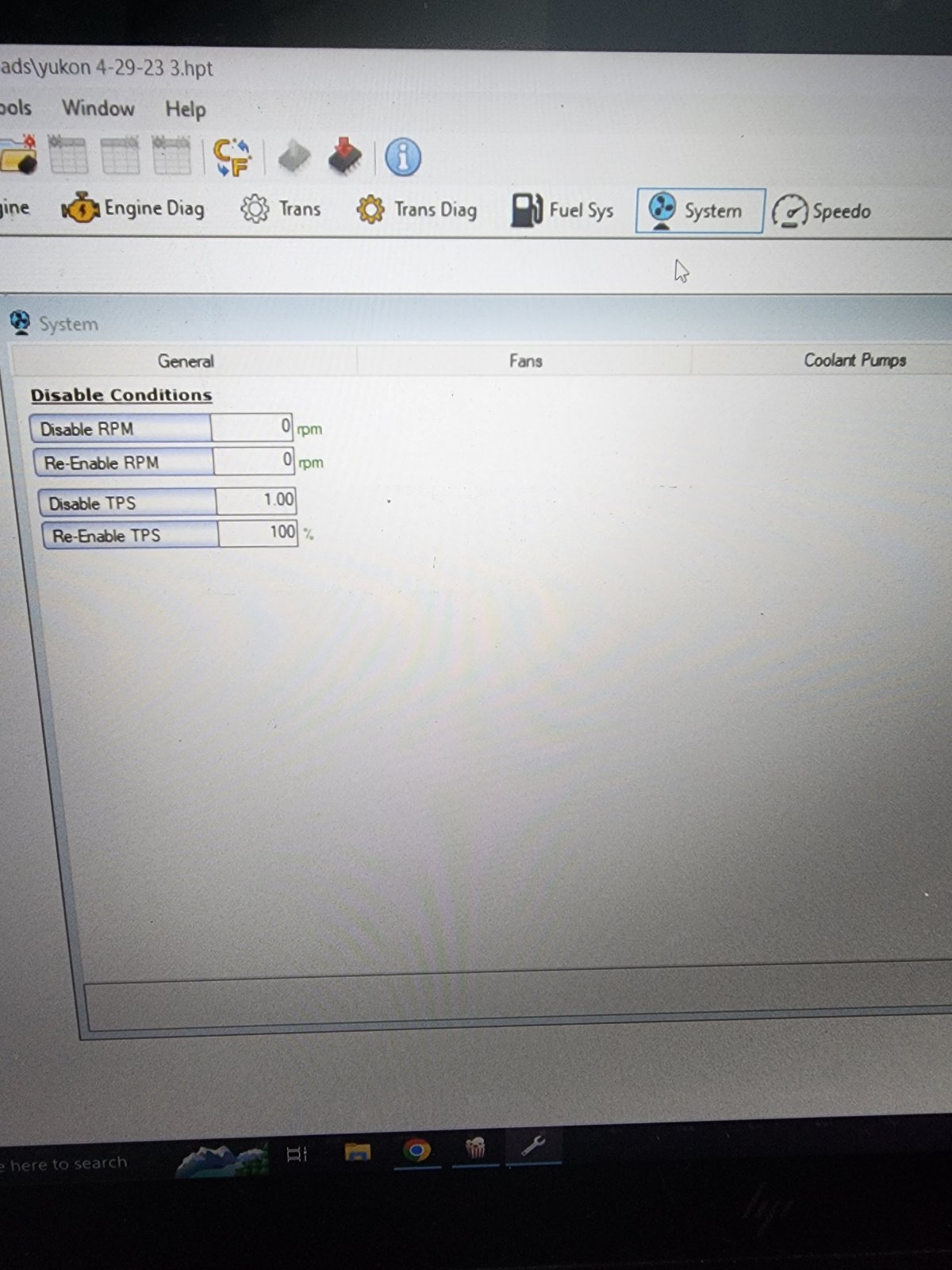

I think it’s actually done! There’s two small things I’m gonna change/play with tho. For one the compressor kicks off under 100% TPS which is good because you don’t want to destroy it. However, it only reenables at 0% TPS, problem is at idle the truck is at 11.6% TPS. Therefore the compressor won’t kick back on until the key is cycled. Kinda dumb, not sure what the problem is because the re-enable at 0%tps is a factory setting.

not sure if compressor is controlled by bcm or not for your years, but it should be in the little fan system icon if its controlled by the ecm

I sent you the tune from my Camaro a long time ago. Compare that to yours on the ac stuff. I've never had an issue with that, only slight idle issues when a/c is on and I'm coming to a stop. I'll sort that out when the time comes

No...it's controlled by the bcm in gmt900s (atleast for auto climate controlled*) so the ecm doesn't do anything changing those. not sure if same for 800s...
Oh yeah, gmt800 it definitely makes a difference lol.

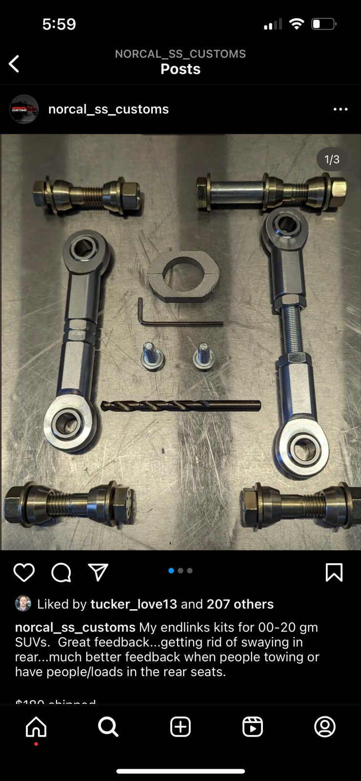

Started ordering some parts, NorCals new rear endlinks, and some OEM rear UCAs because they are cheap, lasted this long, and I like rubber for quiet.

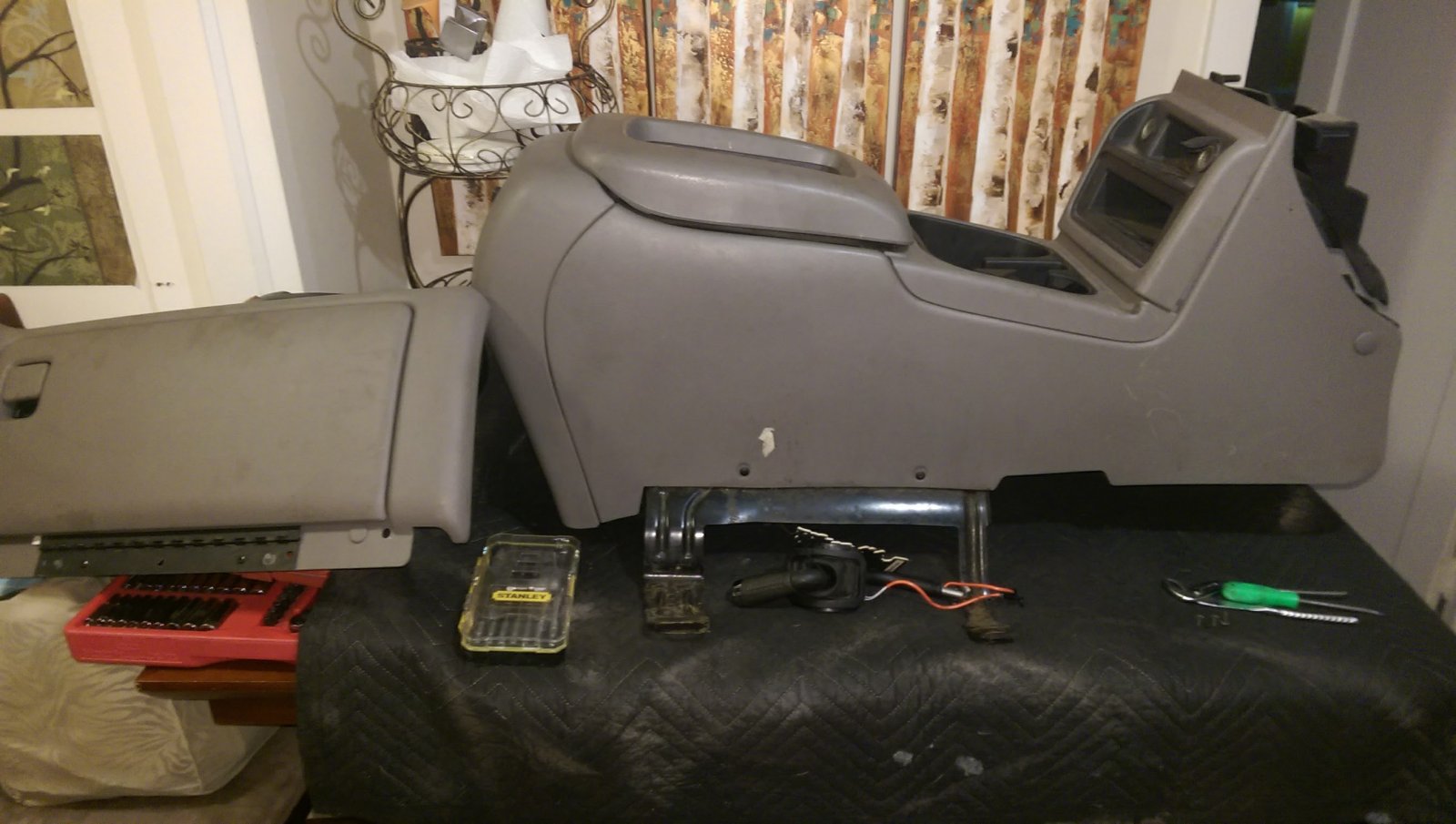

I bet a portable steamer would've taken that crayon right off. I had the same console/jump seat when I 1st got my 03. Converted to the full console and I love it.
