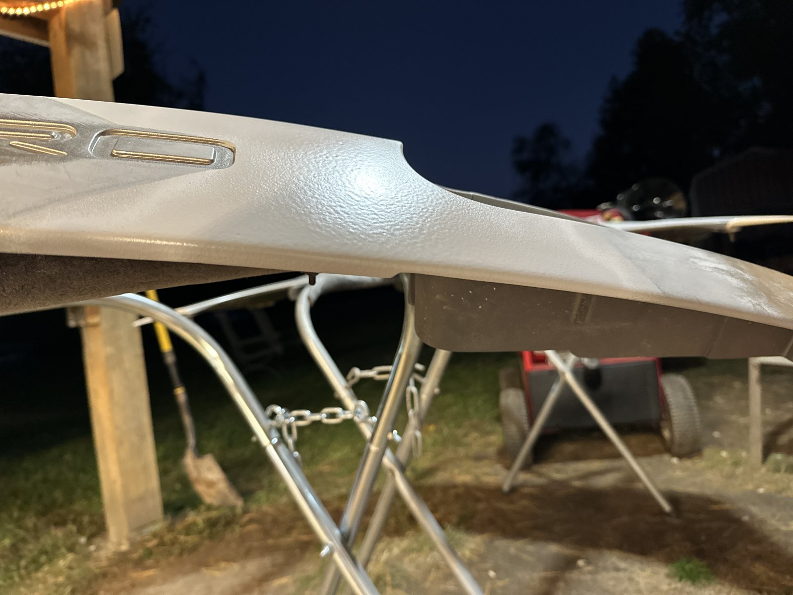

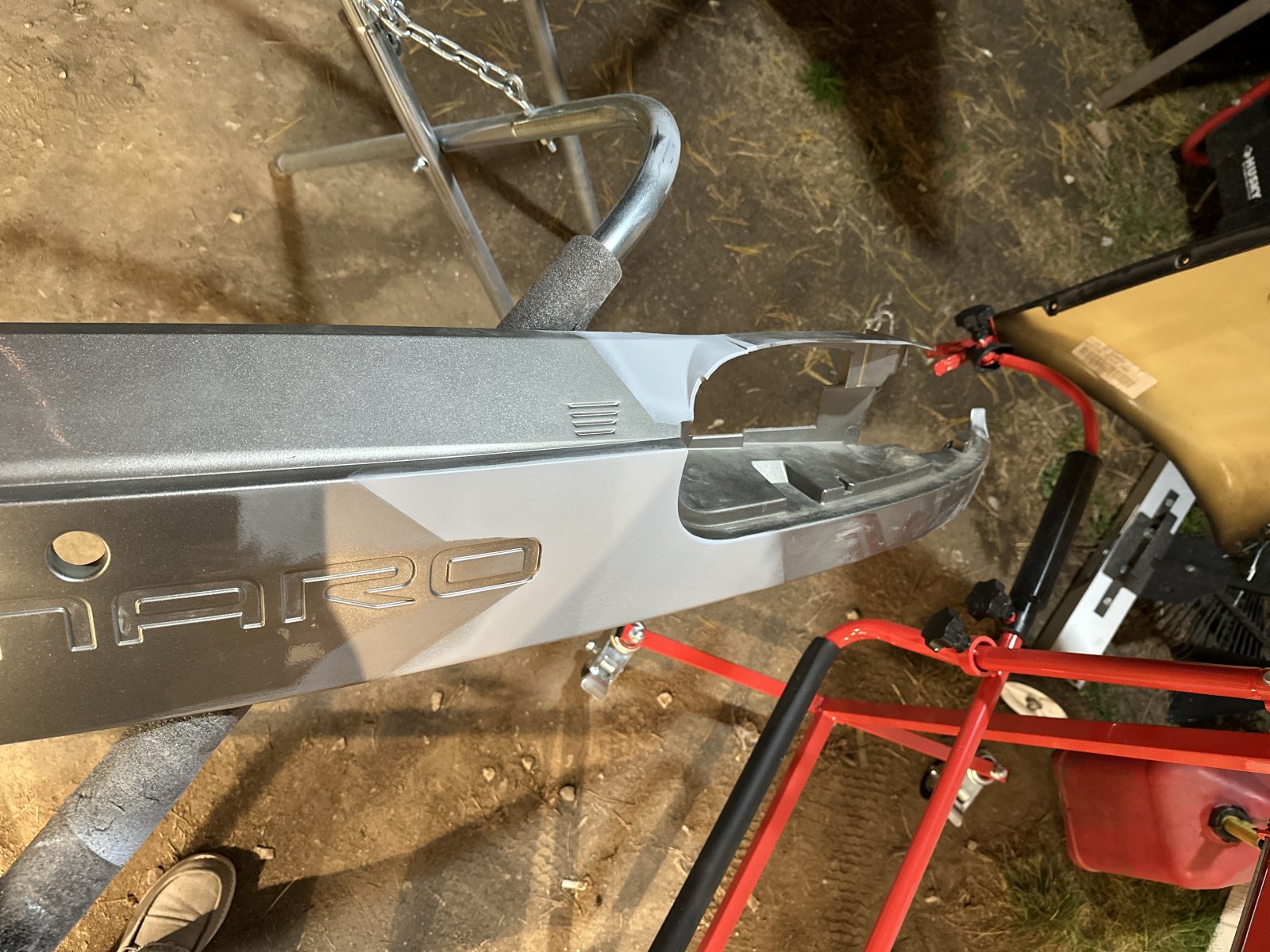

Final block on filler and feather fill sprayed on. It's hard to tell much with so many different colors. This should block out great

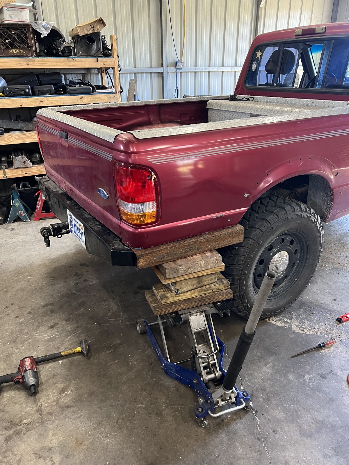

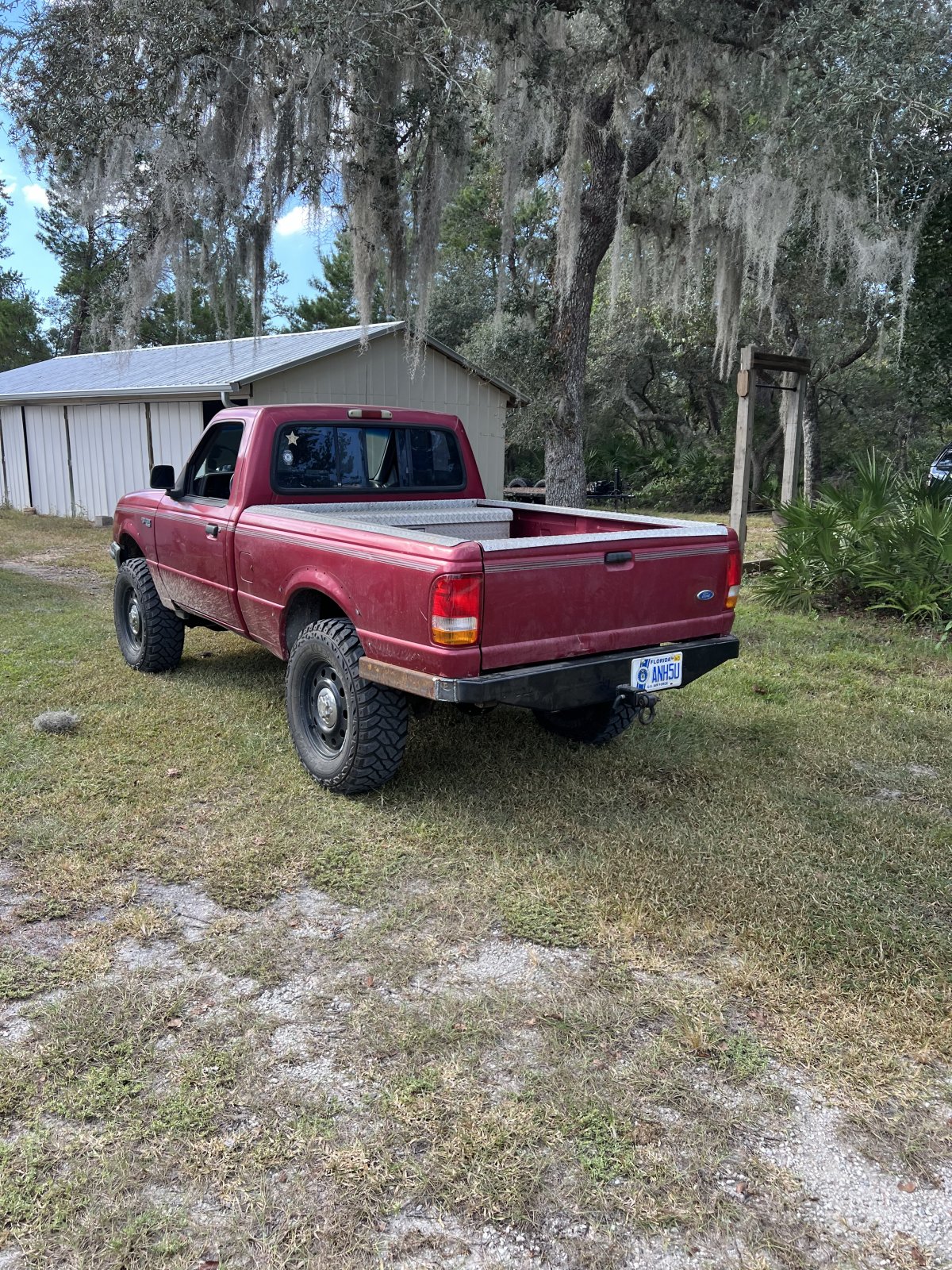

Did more ranger stuff since the Tahoe ac still works.

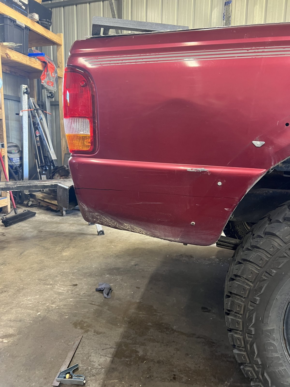

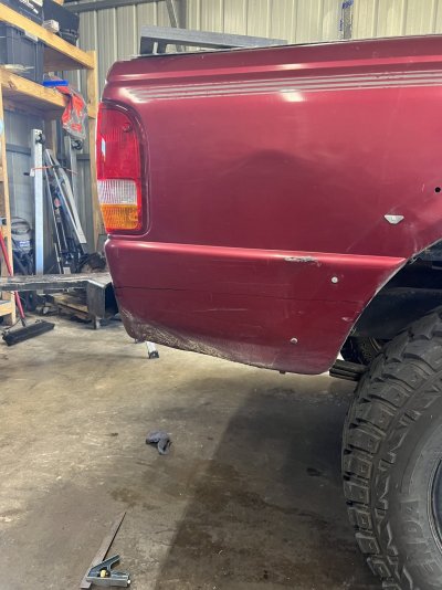

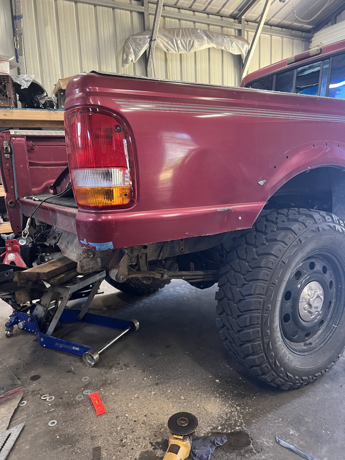

Changed tranny fluid which had probably less than half a qt in it, supposed to have almost 4. Then I started hacking stuff up again. I’ve always liked the look of a high clearance cut bed with wrap around bumper, so I cut stuff and welded stuff. Not even close to done but I’m digging it so far.

Why no angle like a pre runner?
Cause wrap around maximum clearance bumper like rock crawler. If I went the pre runner look I wouldn’t have wrapped the bumper around cause prerunner means lightweight. Since I plan to abuse this thing more like a buggy/trail truck, it gets moar protection.

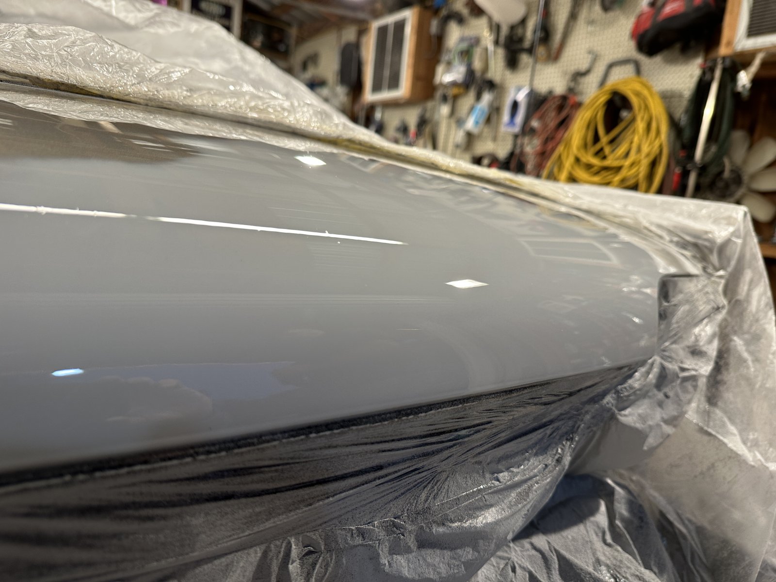

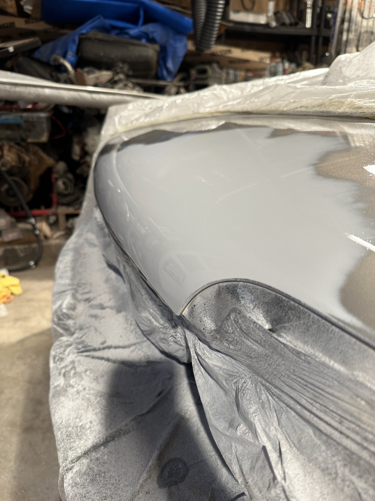

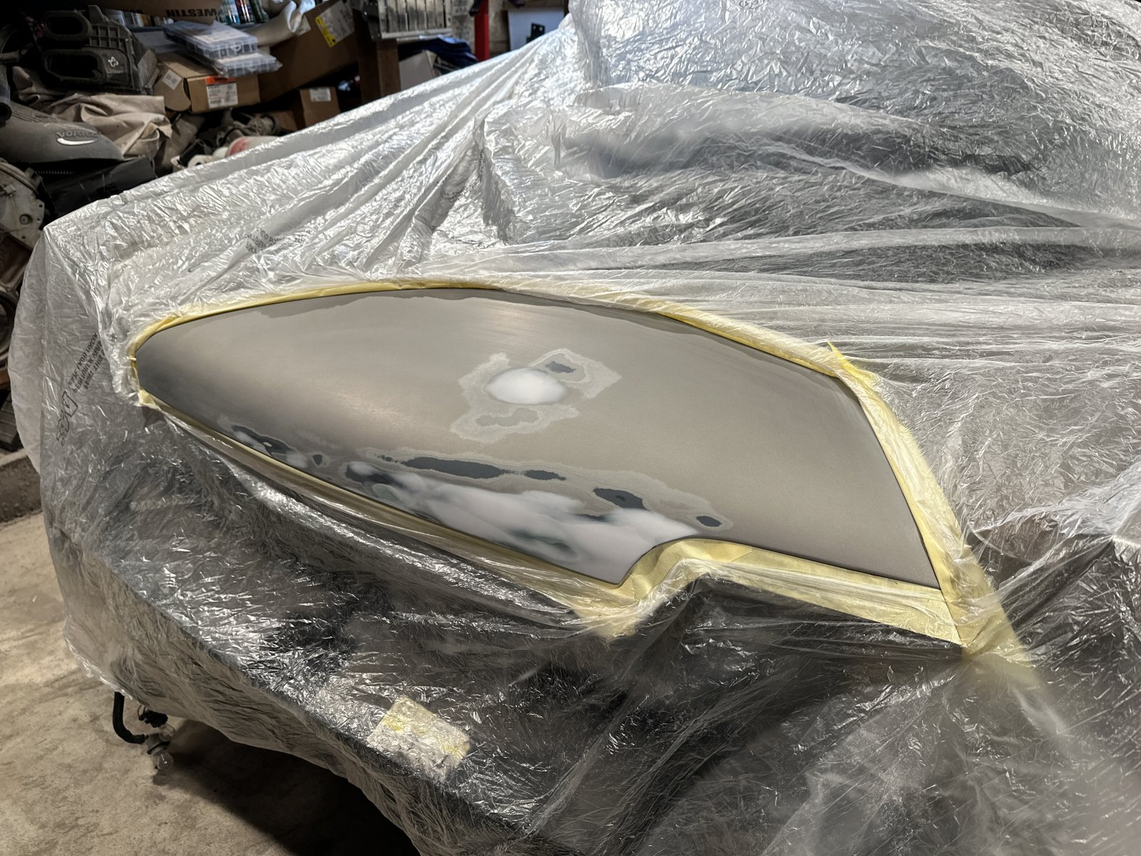

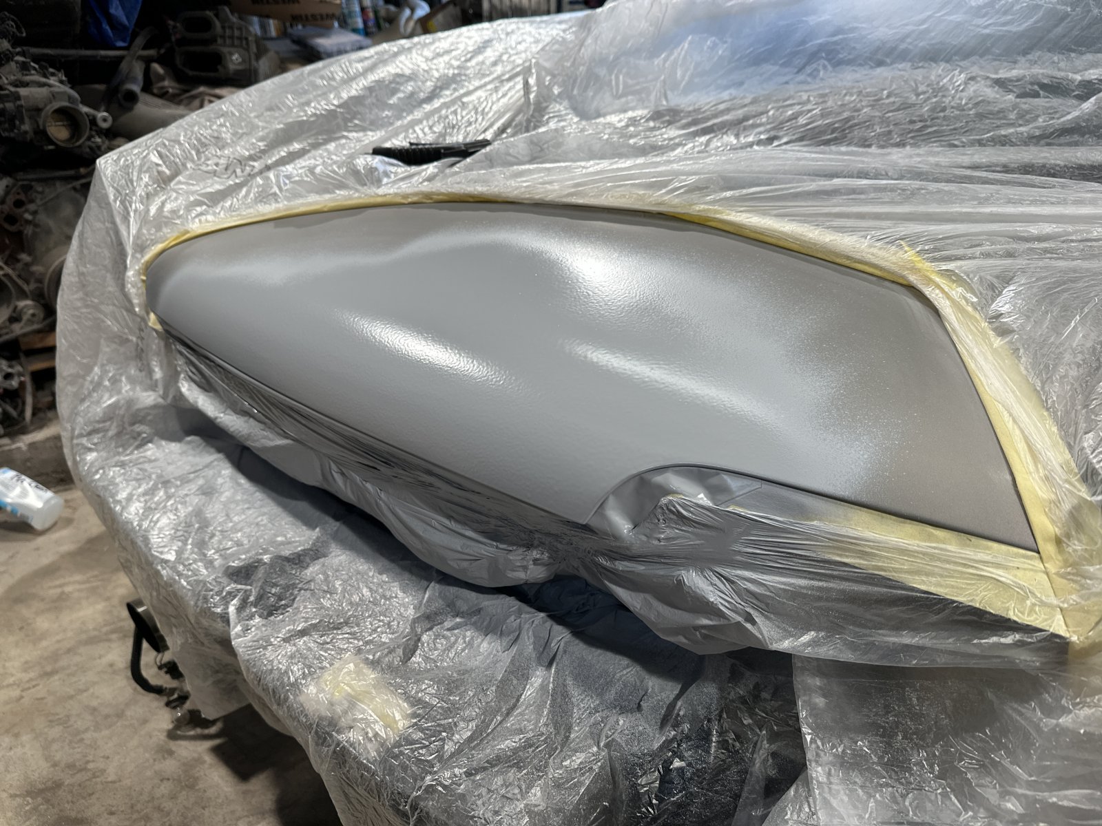

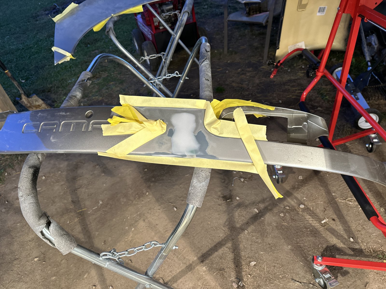

Got the hatch and other panels blocked out last night. That feather fill is awesome. Hatch is ready for a little touch up sanding and then final prime with 2k. Water block then paint. The other panels will need another coat of feather fill when I do the hood. I broke through in some places. Feather fill is not only an excellent high build primer, it also adheres to and seals in the SMC. You need to apply that, then top coat with regular primer. Again, really happy with how it's coming along.

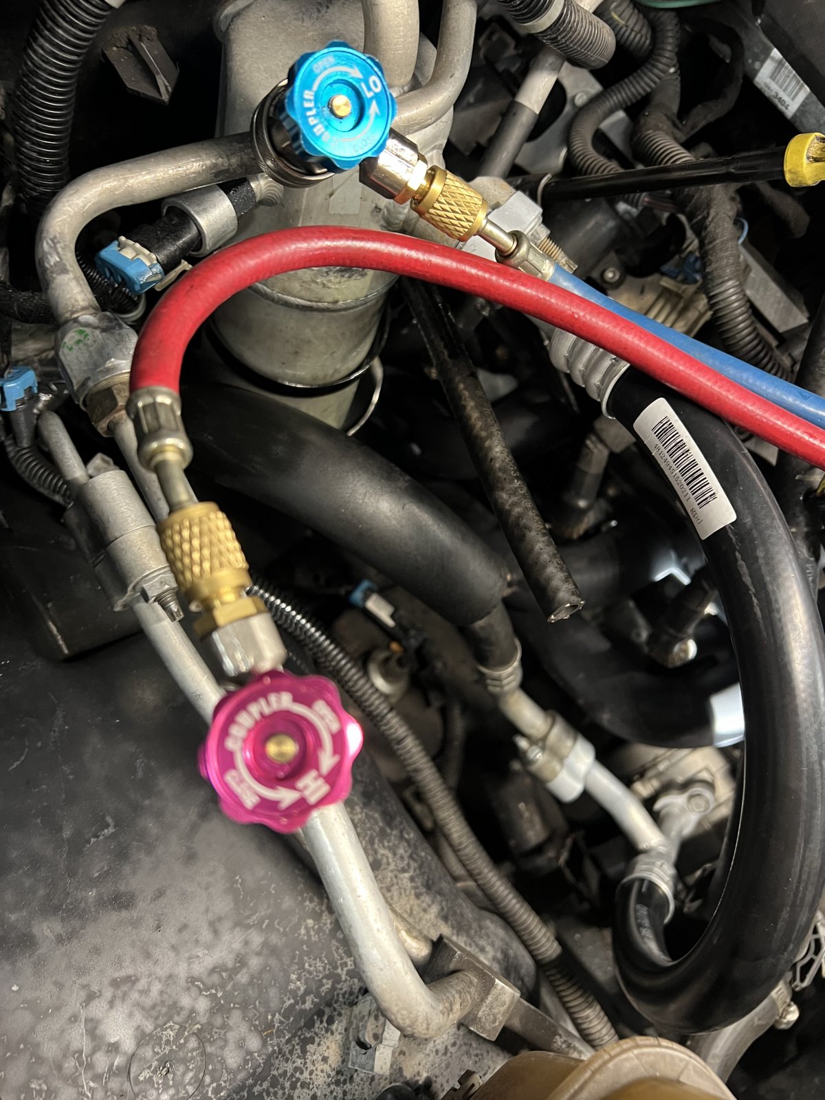

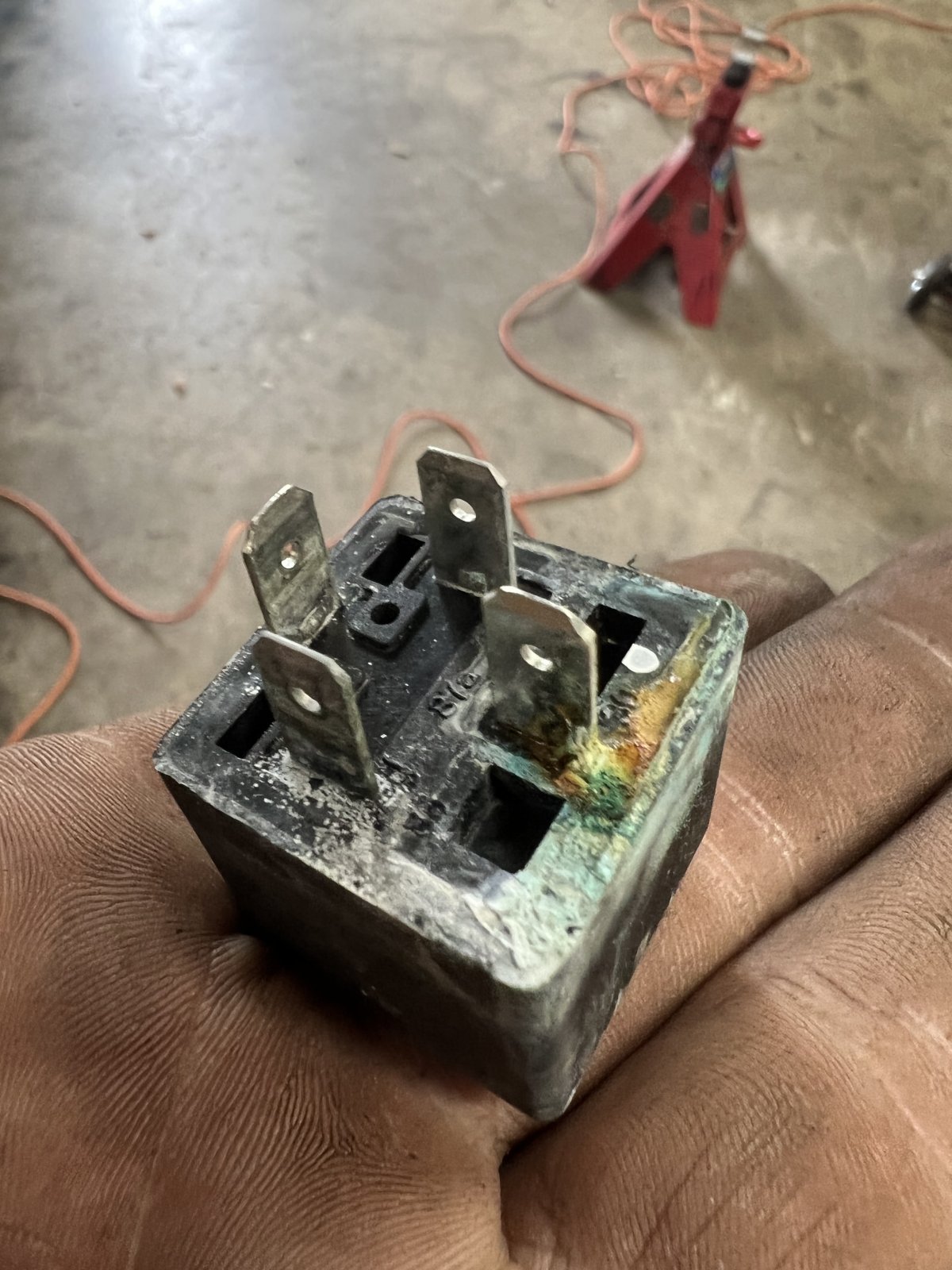

Haven’t touched the Tahoe in awhile just because the AC finally died again ( man it’s a hella slow leak). Plus I had back to back weekends at work with some pretty demanding events including an air show that I had to manage.
Anyway today I slapped the GMT900 line in the ac and got it blowing, I replaced the motor on my exhaust cutout, and cleaned/replaced my HID relay harness so my driver headlight will act right.

any strain on the hoses or do they all fall into place pretty well?
