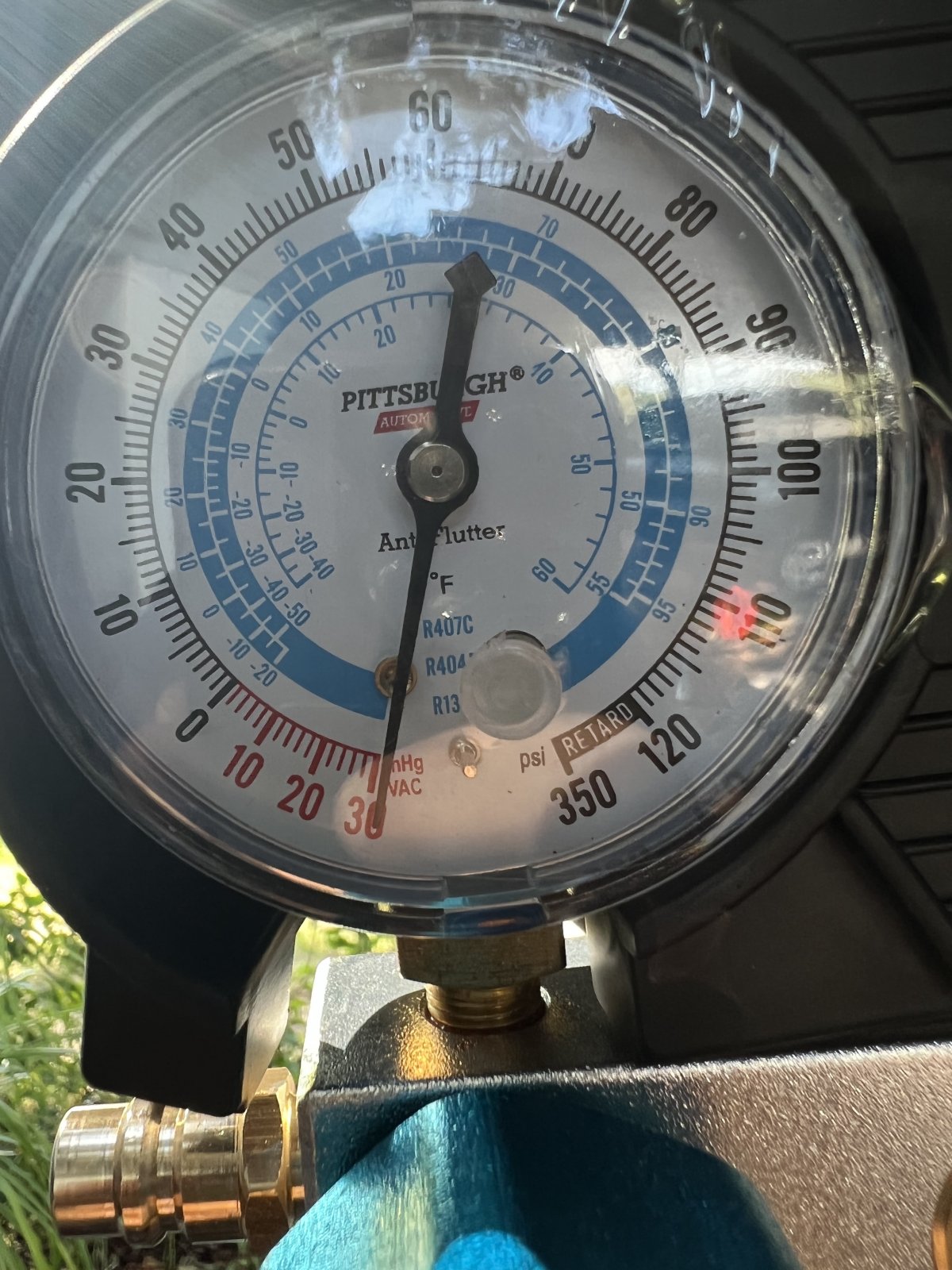

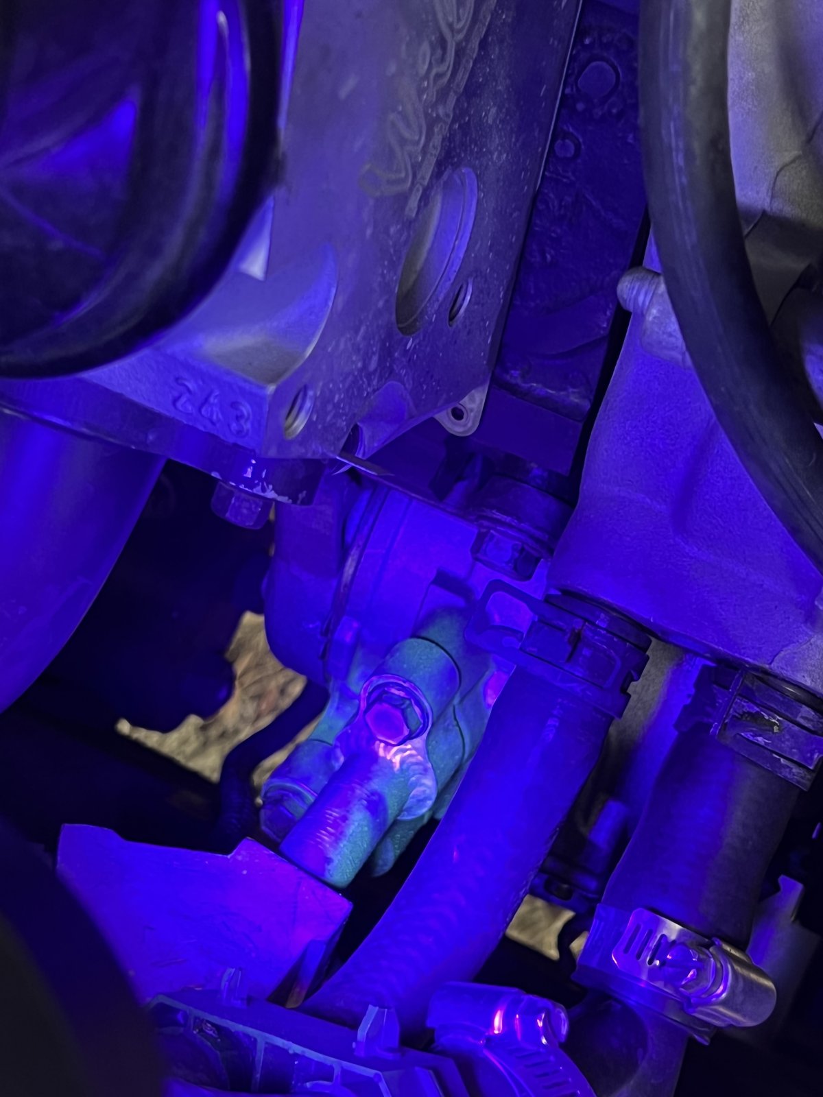

Looks like the same area to me, system was totally empty so time for another drier, for the 4th time now iirc. Also gotta get a new gauge set, for some reason the QD for the high side worked fine in my hand but would not lock over the line. Need to upgrade from china freight stuff with all the use it’s been getting.

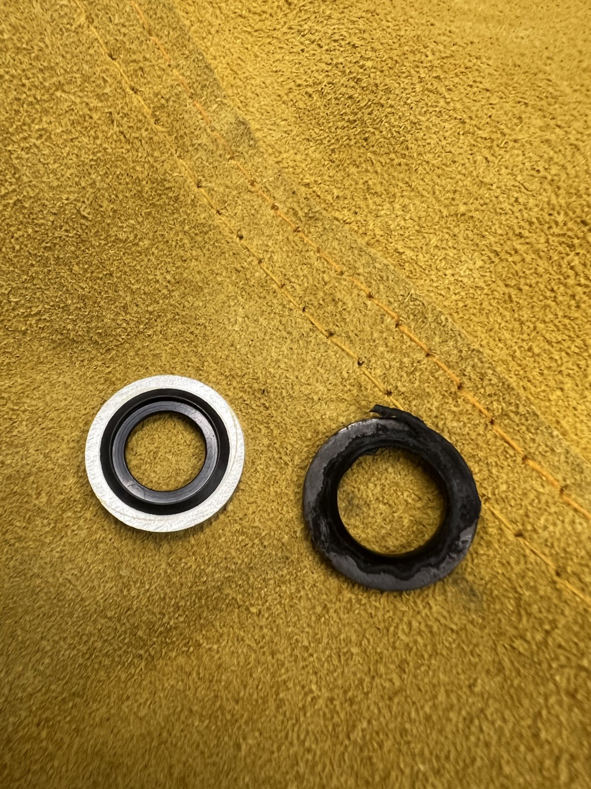

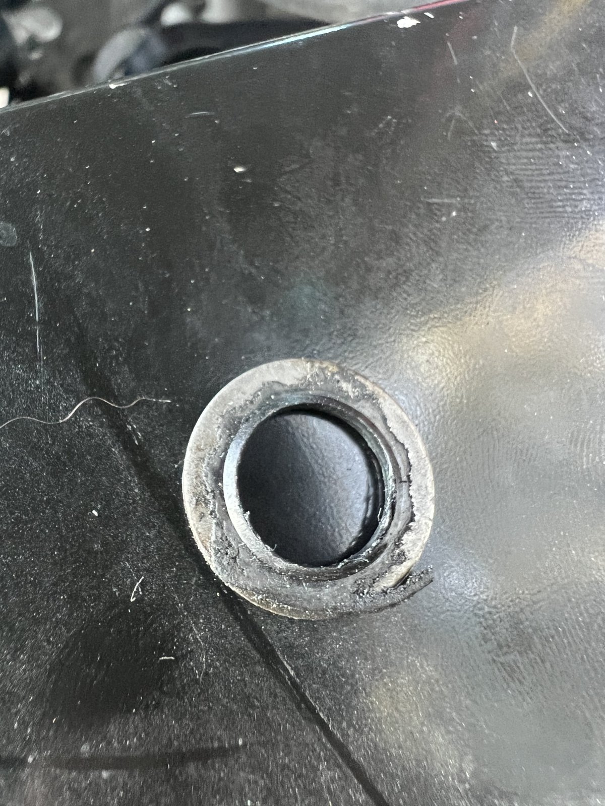

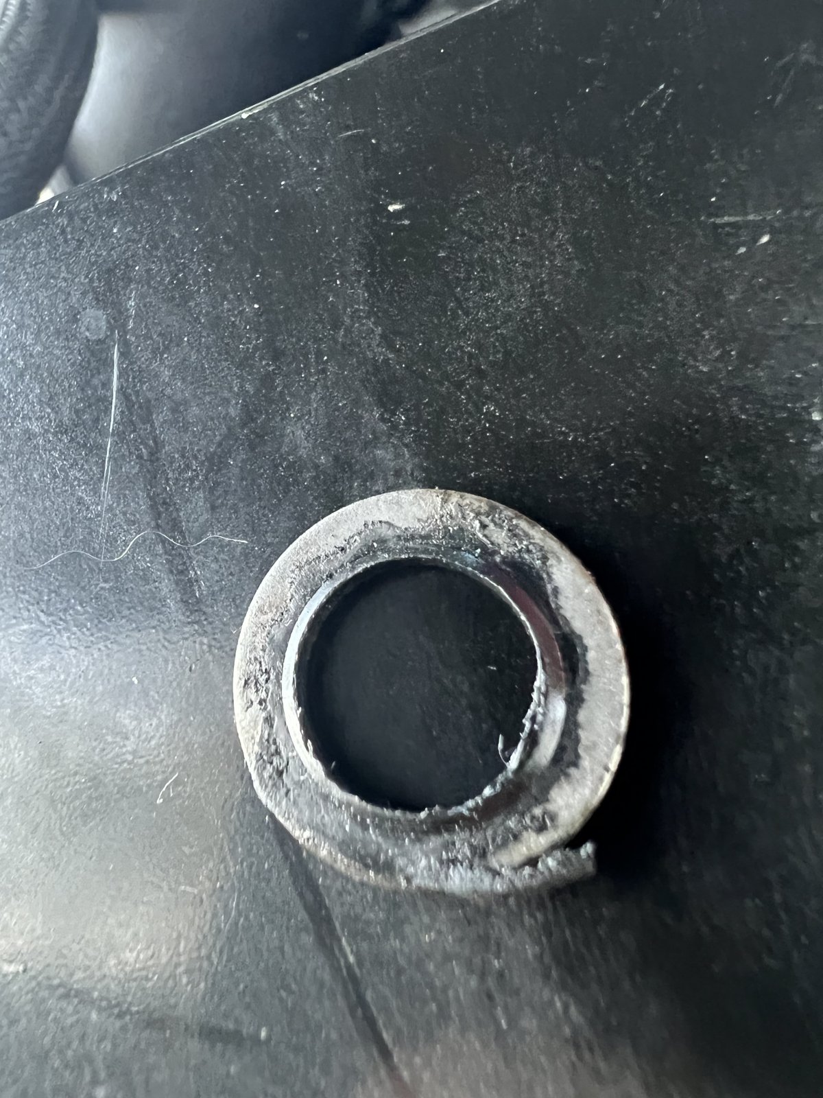

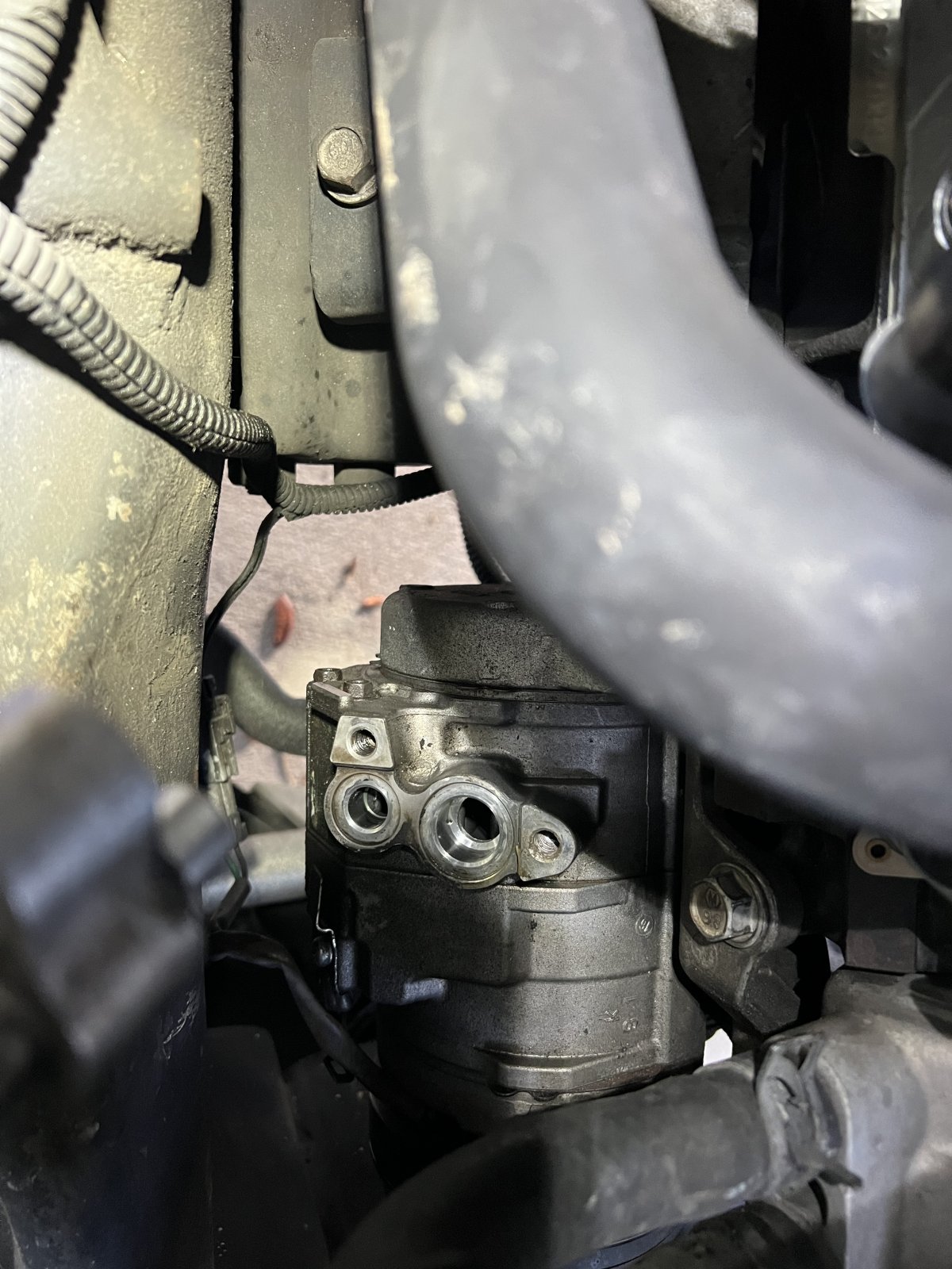

I think I found the AC leak. The old seal was replaced maybe a year ago, it’s the lower line that connects to the compressor and iirc the seal is from a cheap set from harbor freight. It looks to me as tho the oil leak I had for a few weeks seeped oil onto the seal and it deteriorated it.
The new seal is from a professional American made kit I bought a few months ago, and is clearly much higher quality. So far so good it’s holding more vac than every before and held for three hours while I went to town.

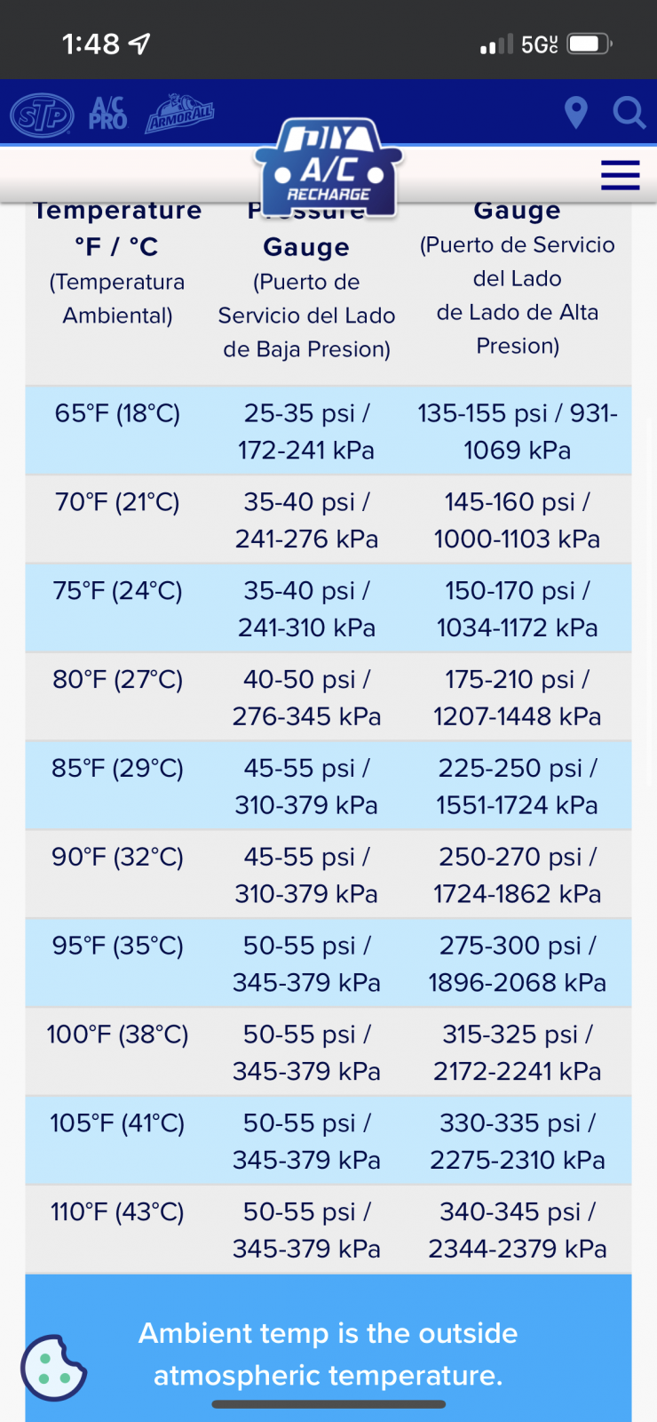

Hope y’all have better luck than me, despite it holding pressure, being filled to the recommended capacity, and both fans working. The stupid high pressure sensor is staying on making it force the compressor off. I can sometimes override this with HPT, but just today that has only been 50% effective. I’m seriously lost on wtf is wrong.
Obviously it leaked out all its refrigerant sometime last week. Now that it’s been vacuumed and refilled why would it not work as it did just before the system leaked out?
I thought maybe the condenser was getting hot from idling stationary in 100* heat. So I hosed it down until ECT was down in the 140*s and the condenser was cool to the touch. Clearly it’s not a physical issue it must somehow be electrical. Or maybe there’s something in the rear AC system that is ******* up the entire thing, I’ve never touched the system in the trunk.

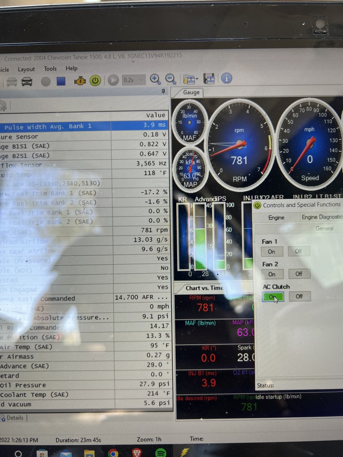

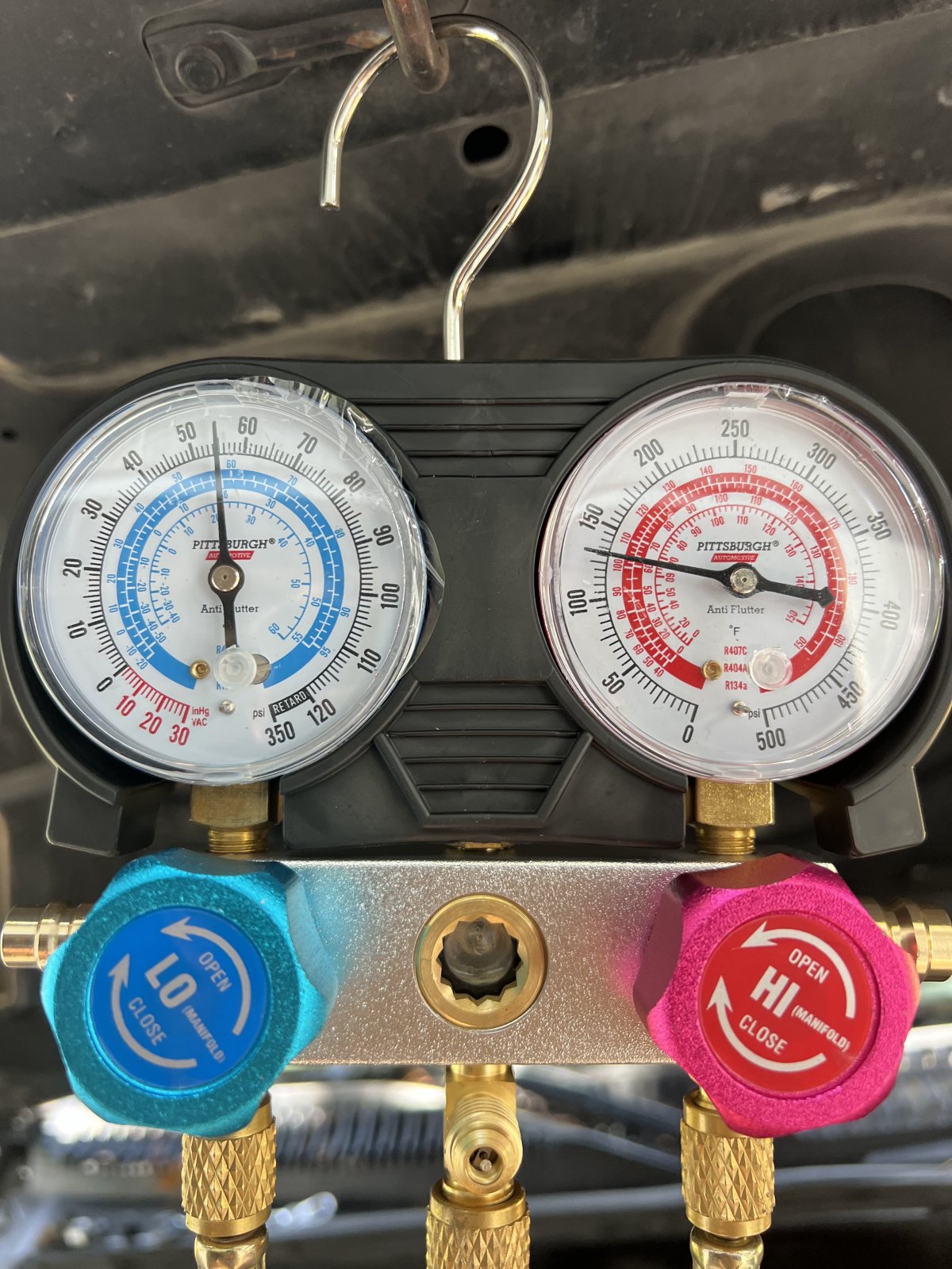

I think the compressor is ****** for some reason. I replaced the sensors and it’s reading a little more (up to .18v while on), however the high side pressure just isn’t much even when the compressor commanded on. I though I’d do a test and command the compressor in but turn the fans off to see if the high side rises with the condenser heating up. About 15seconds into this test something started making terrible noises and smoking. Pretty sure it’s the compressor and it’s ****** and so is all the other parts I’ve replaced in the last year. Phuck my life

Turned it back on and commanded compressor to come on hoping I could get a video of the noise and smoke I saw previously. Everything worked fine and the air blew cold no noise, I compared the feel of the compressor clutch to my RCSB and they feel the same. Is there any test I can do to figure out if something internally is causing the compressor to send a signal to the ecu telling it that the pressures are off and it can’t turn on?
If the compressor was totally destroyed it wouldn’t turn back on and idle for 10 minutes with cold air right?
Or am I totally losing my mind? Remember this whole thing started with a leak, I don’t understand how it could so quickly escalate to this.
