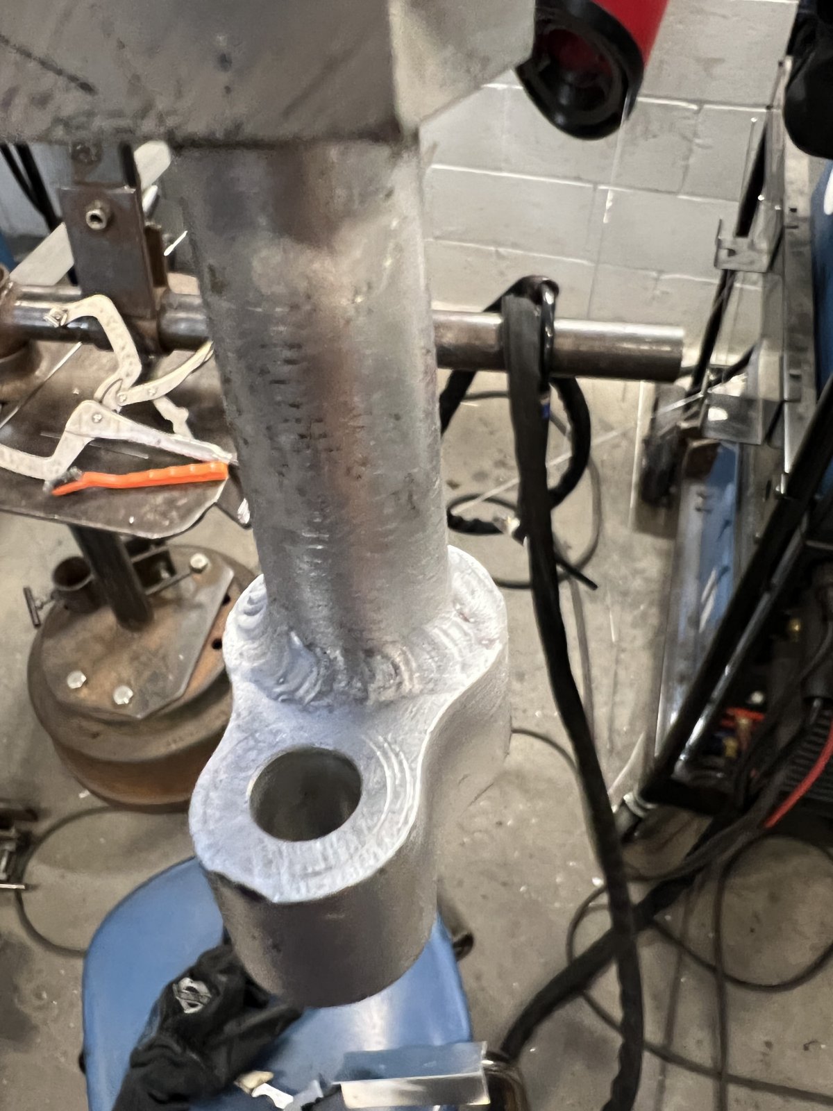

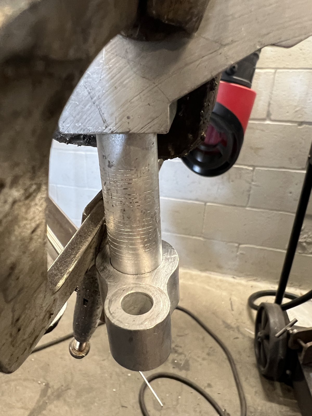

Got the line welded up, actually was pretty easy. I cleaned it with non-chlorinated brake clean, hit it with a stainless brush and went to town with 1/16” 4043 filler, 3/32” thoriated tungsten, glass cup with a gas lens, and 120amps through a miller dyNASTY 400.
Hopefully it doesn’t have any issues, I’m gonna replace the seals and loctite the bolt.
