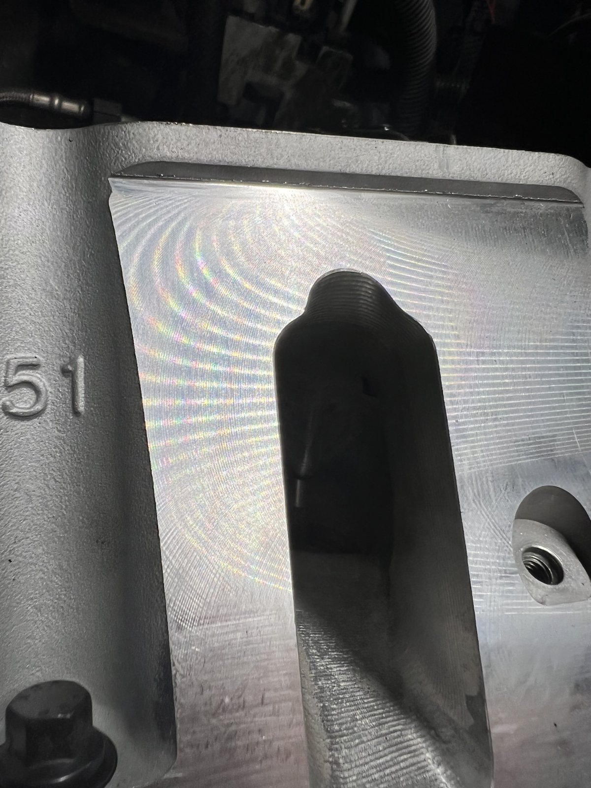

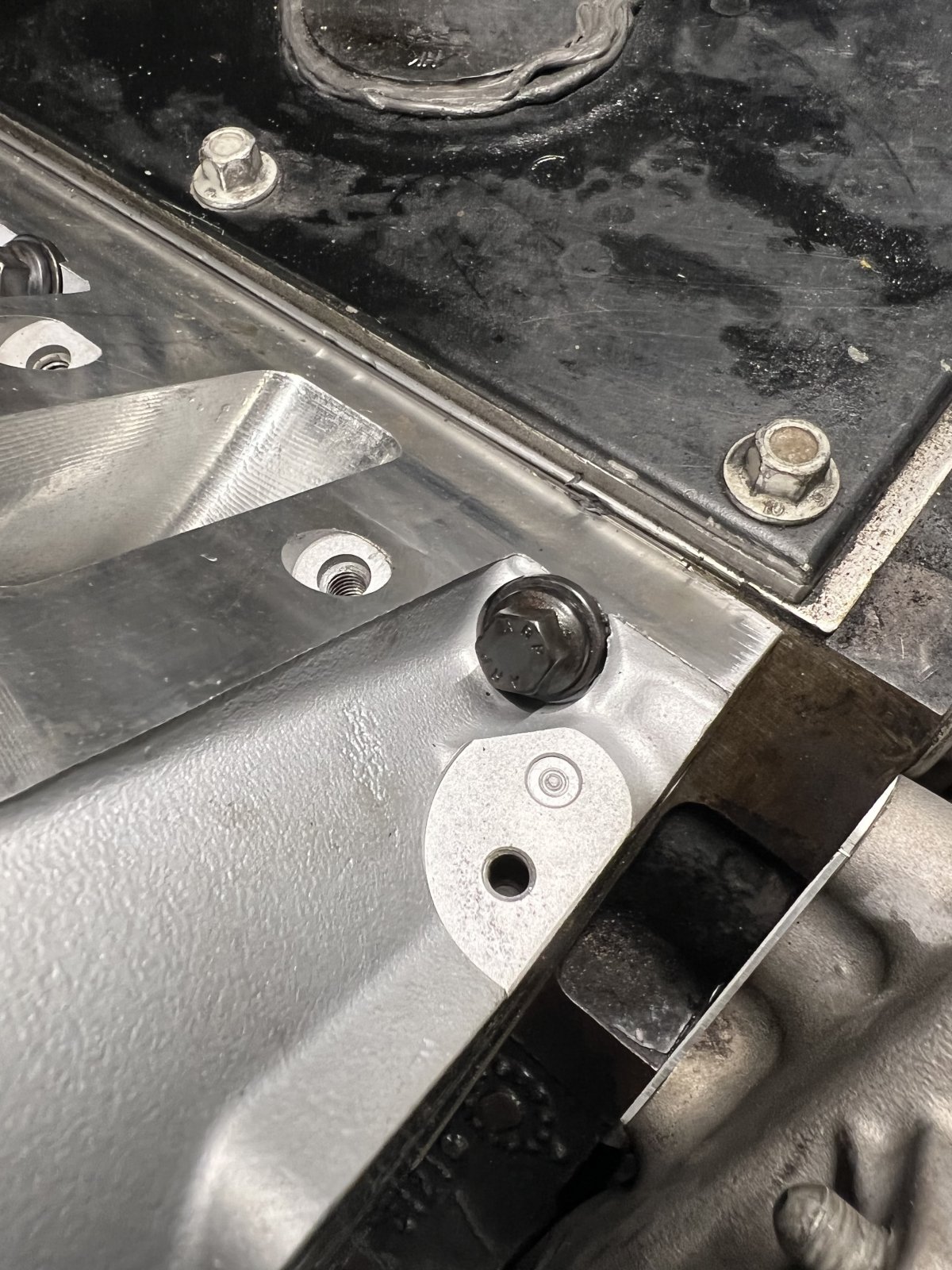

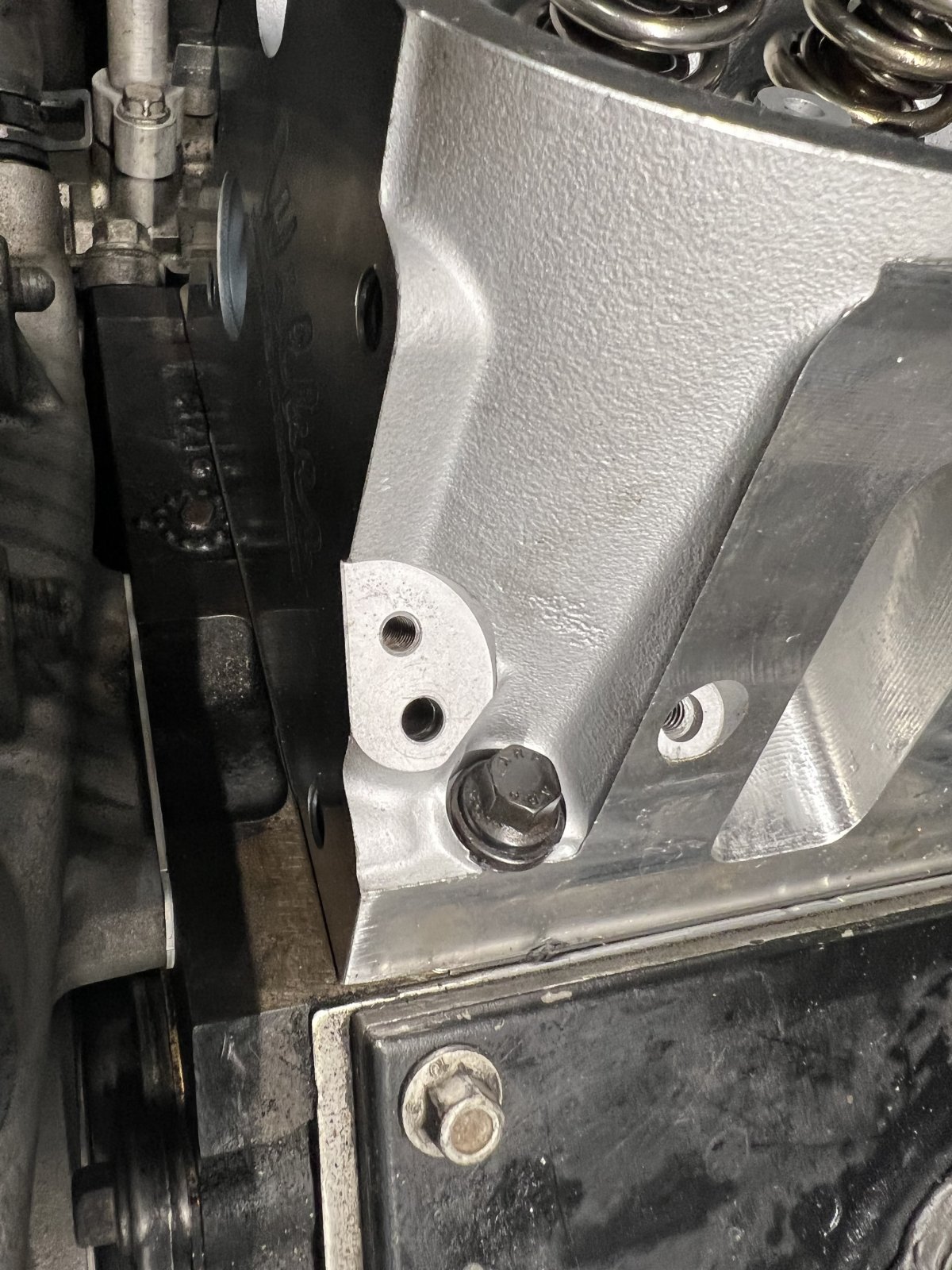

The ARP studs are perfectly short enough to have almost no protrusion so that’s a win. Also got the steam ports drilled and ready to go, tomorrow it should be driving.
Nice work as always Dan. Glad you got the bolt situation figured out. I think that's about how my btr bolts looked. Wish I would've taken a pic. Glad you got the coolant holes drilled with no issues as well. Having the reroute that hose would've bothered me after a while (if it were my truck). Looks factory and should work as intended. I'm curious if the mpg improves with the more efficient heads or if it hurts it. I can definitely tell the avalanche is working less to run 80+ on the interstate so I have to assume with proper computer calibration by a trained a professional, I'd have to get better mileage than before.

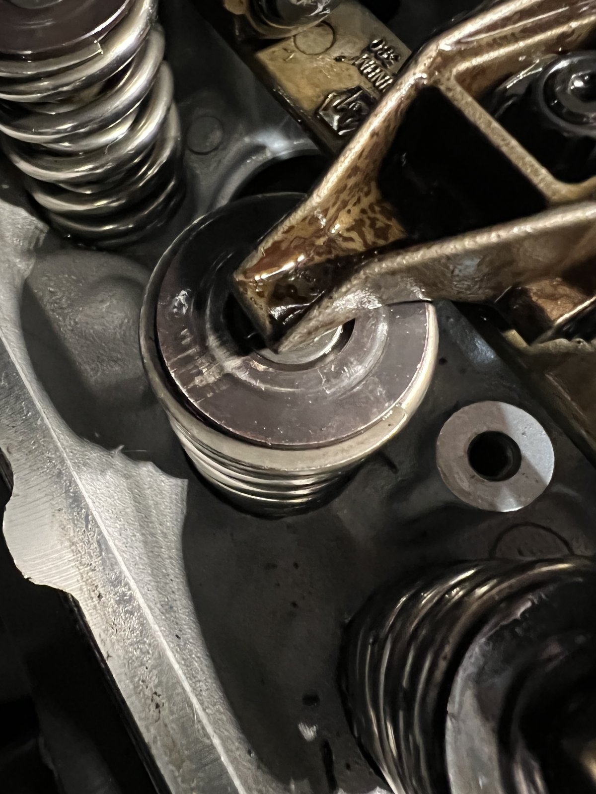

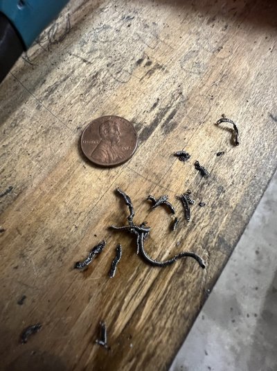

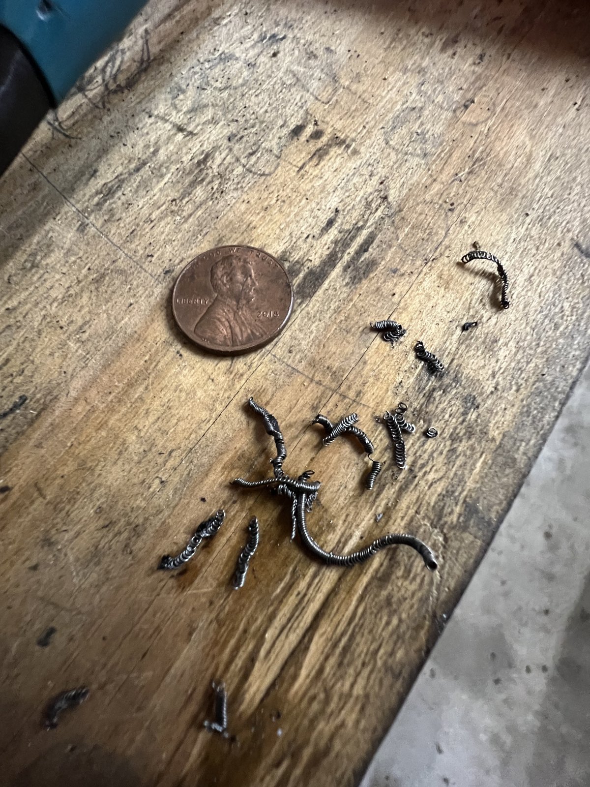

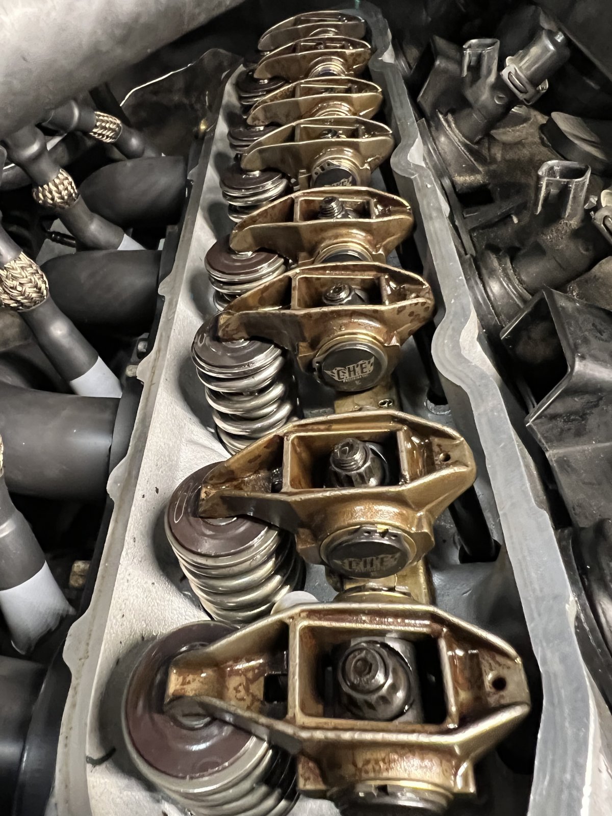

I’m officially concerned, found this stuff in the valve covers but see no Reason for it. All the rockers appear to be torque correctly and I even went back over them. I pull the oil filter and the oil looks all right a little bit of shiny but I don’t see any large pieces like this in the filter medium either.
The only odd looking thing is on the passenger side where it looks like maybe the spring compressor tool rubbed the spring seat a little bit. Almost positive it’s not caused by the rocker arm. I guess I’m going to putting it back up and see if it still makes noise.
Looks like a spring of some kind. Strange. I hope it's nothing catastrophic!
