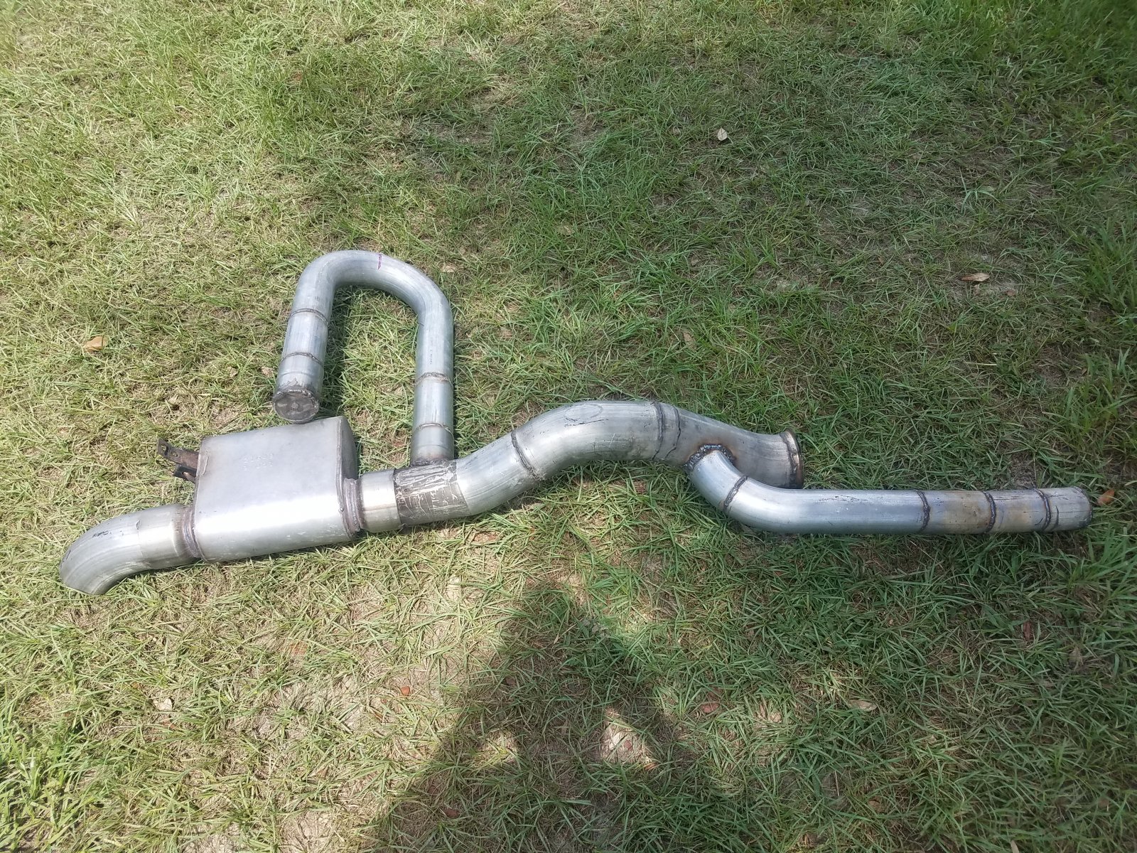

The second J tube is in! Boy was that a PITA. The fab stuff was easier but my god is that over-axle double J tube crap heavy and awkward!
Struggled with getting the V bands at the header collector to stop leaking and eventually gave up. IDK what it is they look perfectly aligned and as tight as I can get them without thinking I'm breaking stuff but they still leak pretty badly and its annoying.

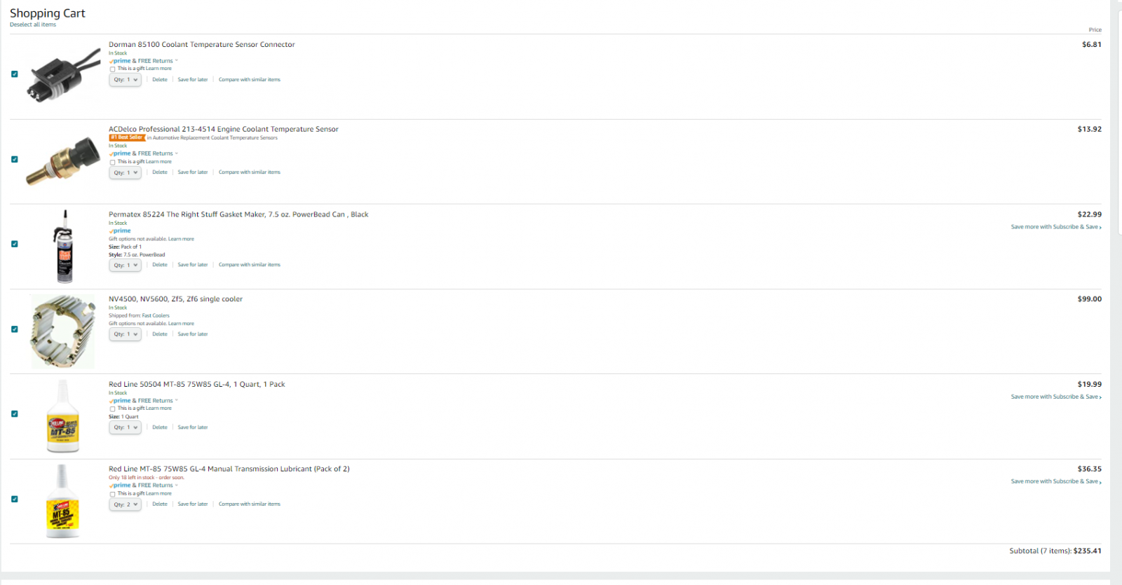

Since the trans is leaking at the shifter tower isolator it's the perfect time to push forward with the trans temp sensor install especially with the new cluster arriving this week. Gotta get a few things ordered tho.
-Correct NV4500 fluid so the carbon synchros don't get eaten up Probably going with Redline GL4 as its cheap
-Fast PTO cooler with 1/4NPT port for sensor just one cooler no need for both sides IMO
-ECT sensor that fits 1/4NPT or a sensor and an adapter
-Shift tower Isolator
-RTV in an easy dispenser (Mine finally died after like 4 years)
-2 Wire pigtail to wire into auto trans harness with the correct plug for new ECT sensor.
I feel like this project is overly expensive for what it is, the dang GL4 is outragious.

$20 per quart? How many quarts does it take?
4 without a PTO cooler, each cooler holds 1qt extra so I'll just need 5 unless I do the 1qt overfill but I don't think I'll do that this time. My RCSB takes 8 IIRC because it has 2 coolers and the 4x4 tail shaft holds an extra 1.5 or something. Its easily a $200 expense to fill.
Also that redline fluid is about half the cost of everything else. The OEM Castrol Syntorque that is unobtainable now used to be like $60 a qt.

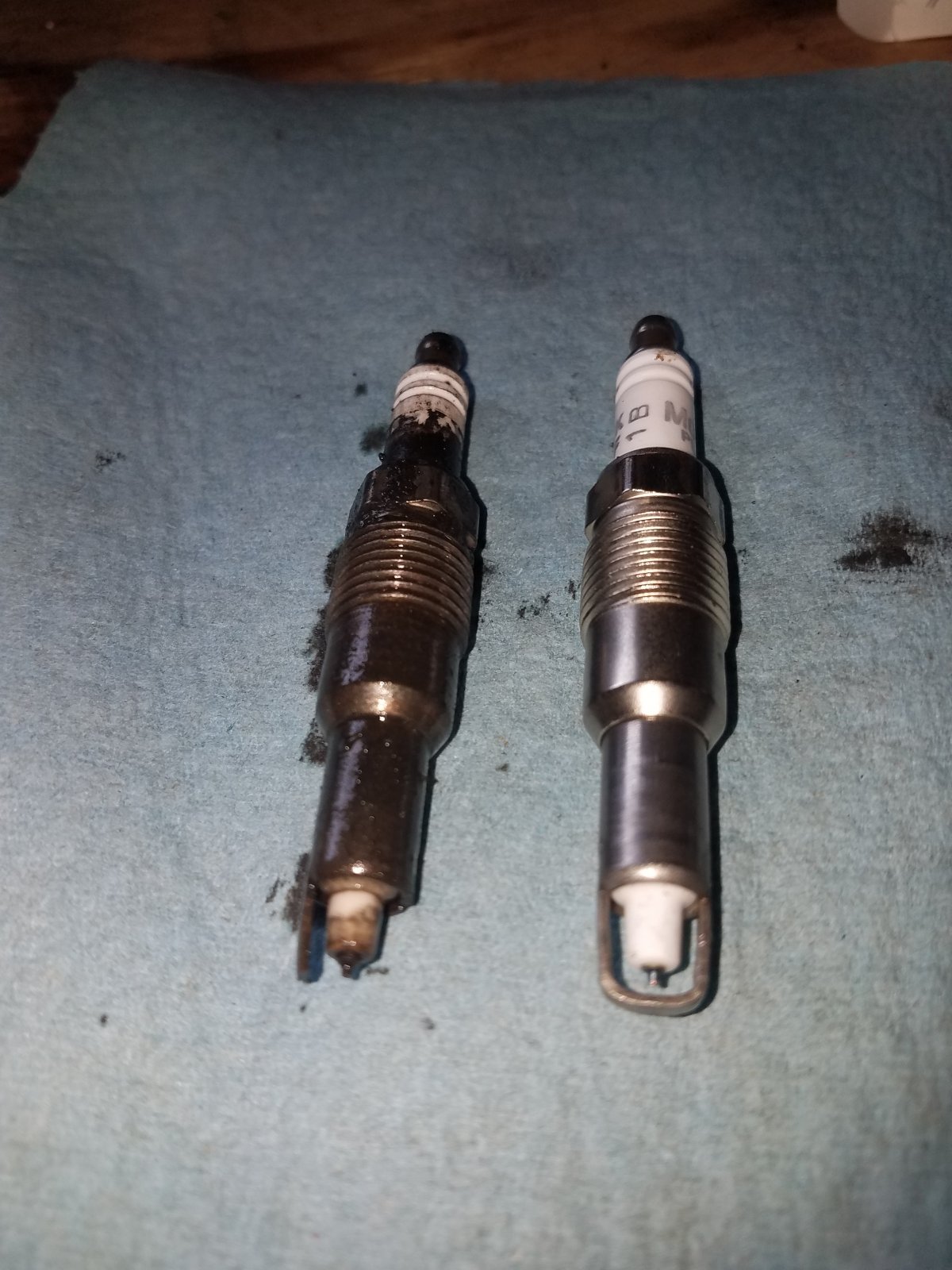

Not much to take pictures of but here's a picture of a totally ***** spark plug from a 2006 F250 with the god awful triton 5.4 I worked on this weekend. The truck had such a bad misfire it wouldn't go above 40mph and shook like Apollo11 coming back through the atmosphere. Not sure why Ford decided to make the plug hex section so small I think it was a 9/16" and someone had attempted to remove it before and gave up after they half-rounded it off. The other bit of fun on this truck that I should have snapped pics of is that every single connector I've seen is broken and secured with zip ties. I mean every injector, coil pack, and sensor on the entire engine it seems. IDK if some Ape removed them all with channel locks or if the Fords of that era have cheap plastic connectors but it's a mess.

I had a co-worker with a truck that had a Triton in it, I took one look at that engine and refused to help him work on it. What a POS.
Even worse is that it's gutless, this particular truck was a single cab, SRW, and a service bed. That truck compared to their van I worked on right after which is a 6.0, 4l80, with a massive full steel walk in crazy heavy like 12k GVW service bed thingy. The van feels twice as fast and I'm certain the van weighs a minimum of 3k more than the truck.
