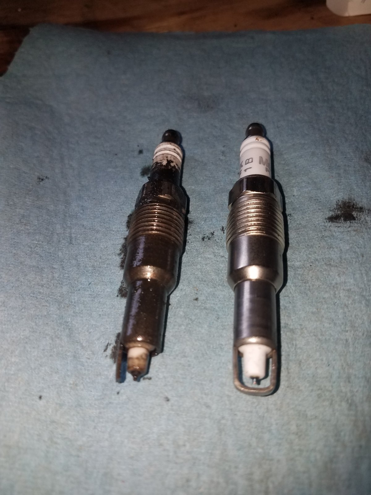

Not much to take pictures of but here's a picture of a totally ***** spark plug from a 2006 F250 with the god awful triton 5.4 I worked on this weekend. The truck had such a bad misfire it wouldn't go above 40mph and shook like Apollo11 coming back through the atmosphere. Not sure why Ford decided to make the plug hex section so small I think it was a 9/16" and someone had attempted to remove it before and gave up after they half-rounded it off. The other bit of fun on this truck that I should have snapped pics of is that every single connector I've seen is broken and secured with zip ties. I mean every injector, coil pack, and sensor on the entire engine it seems. IDK if some Ape removed them all with channel locks or if the Fords of that era have cheap plastic connectors but it's a mess.

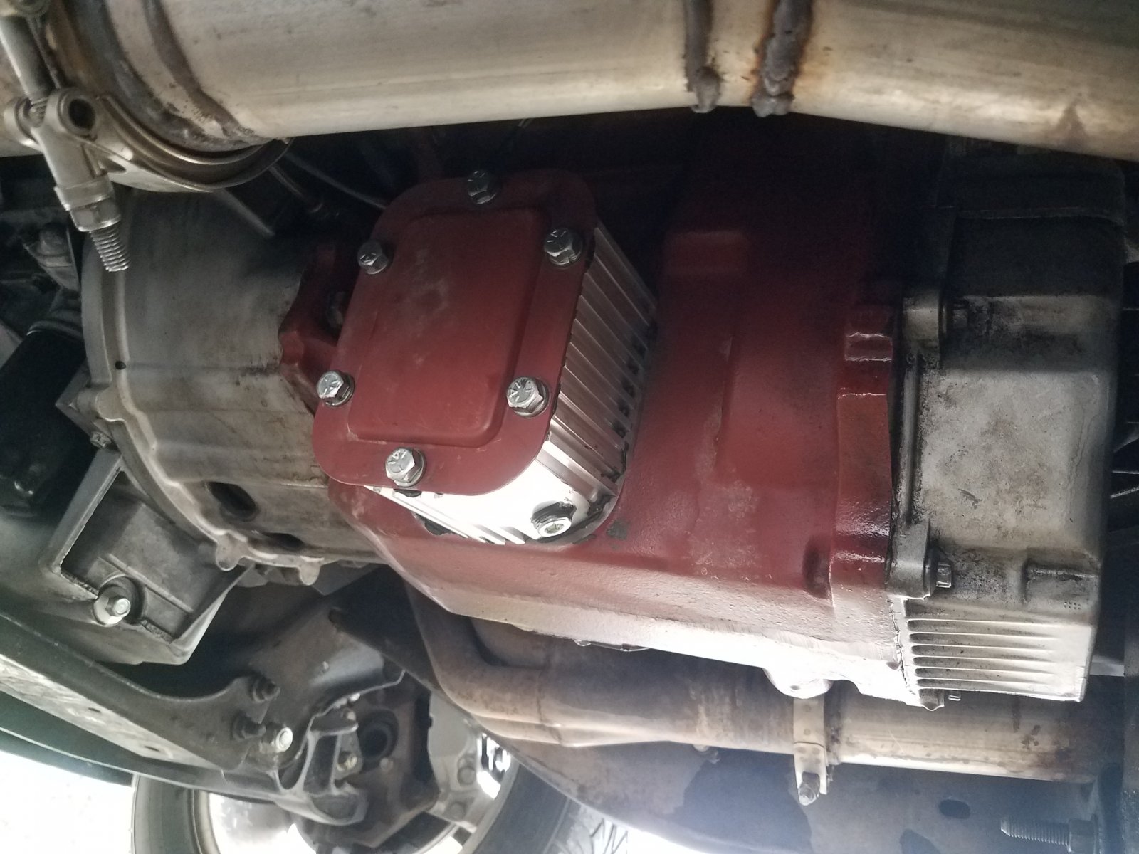

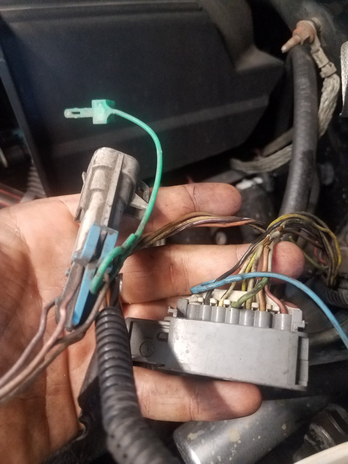

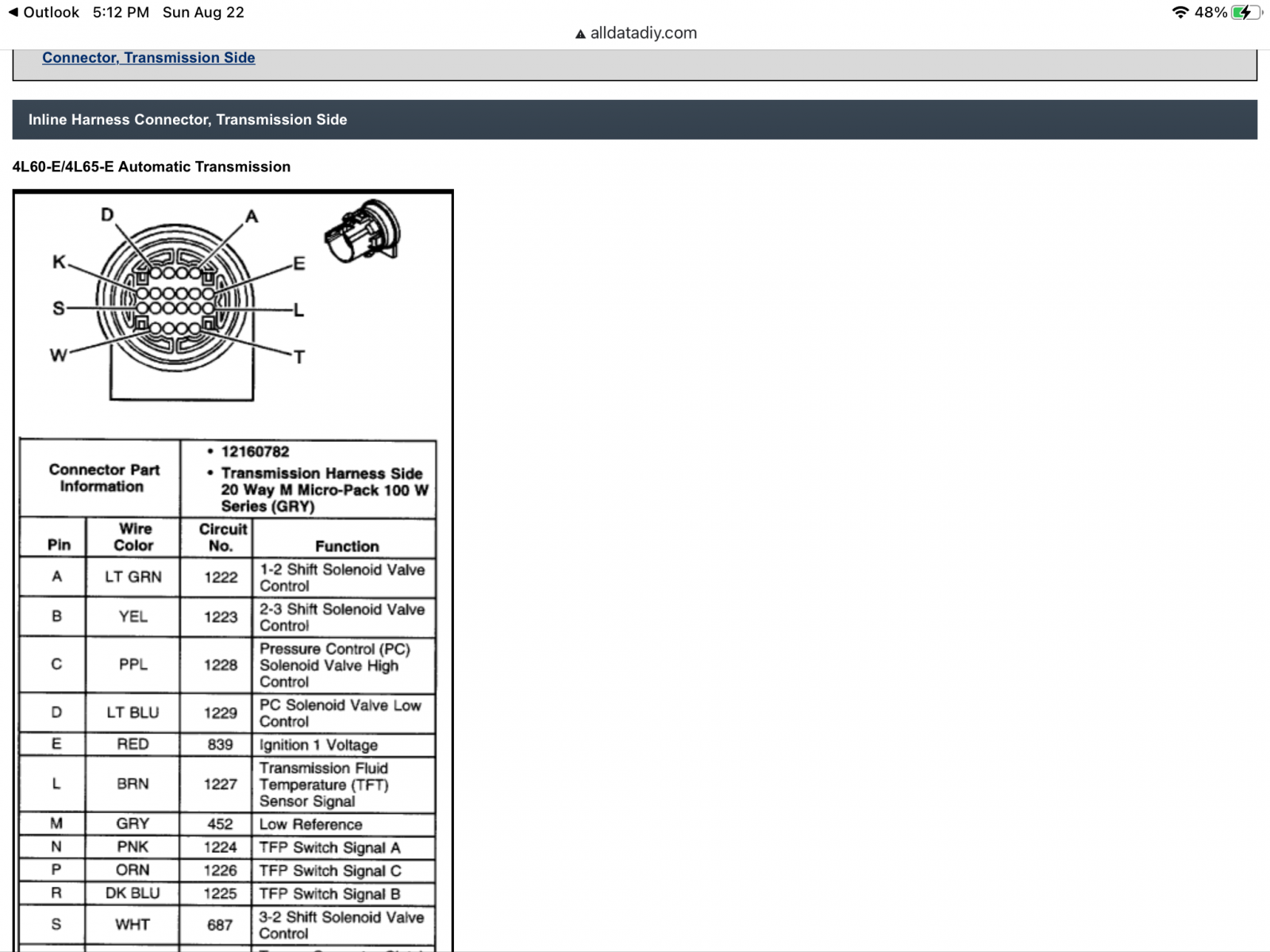

Got time to fix the loose shifter as well as install the PTO cooler. Went well and got the temp sensor installed just not wired up. I'm kinda confused at what wires to use, heres a pic of what I can find left over from the auto trans but it doesn't look like the typical circular 4l60 plug.

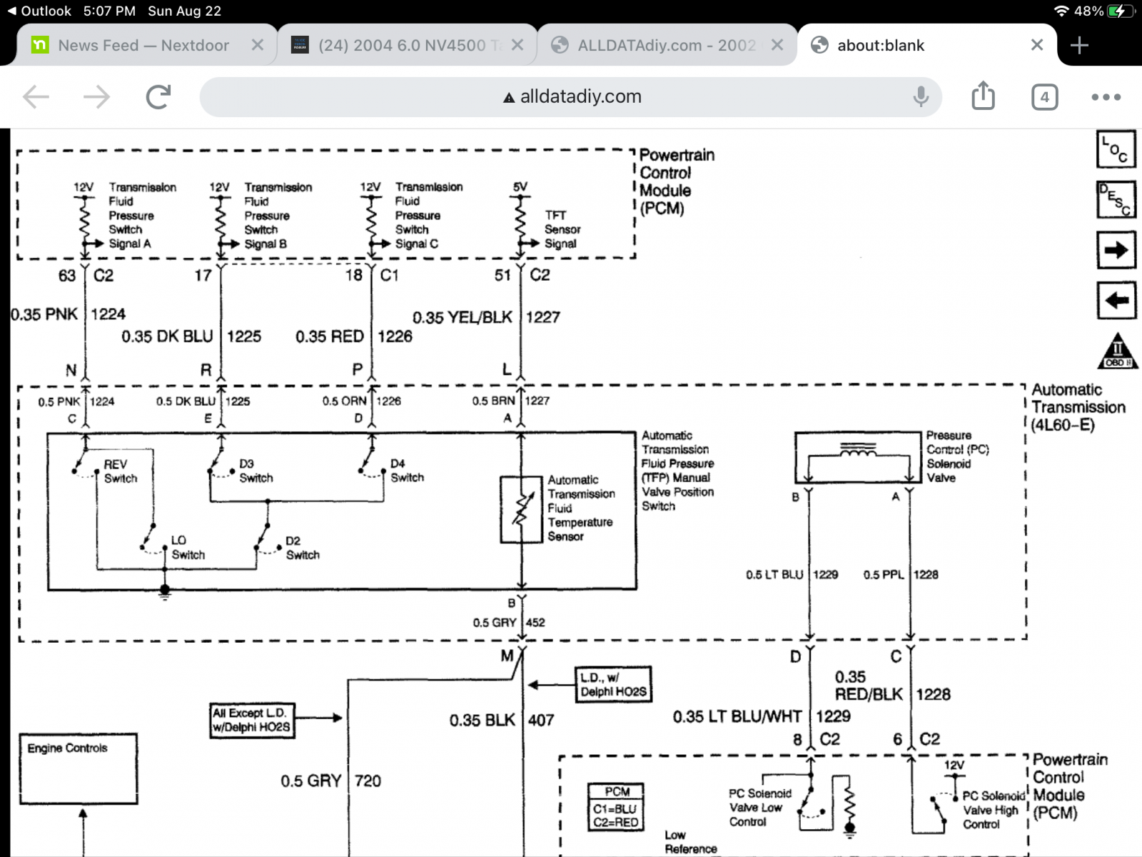

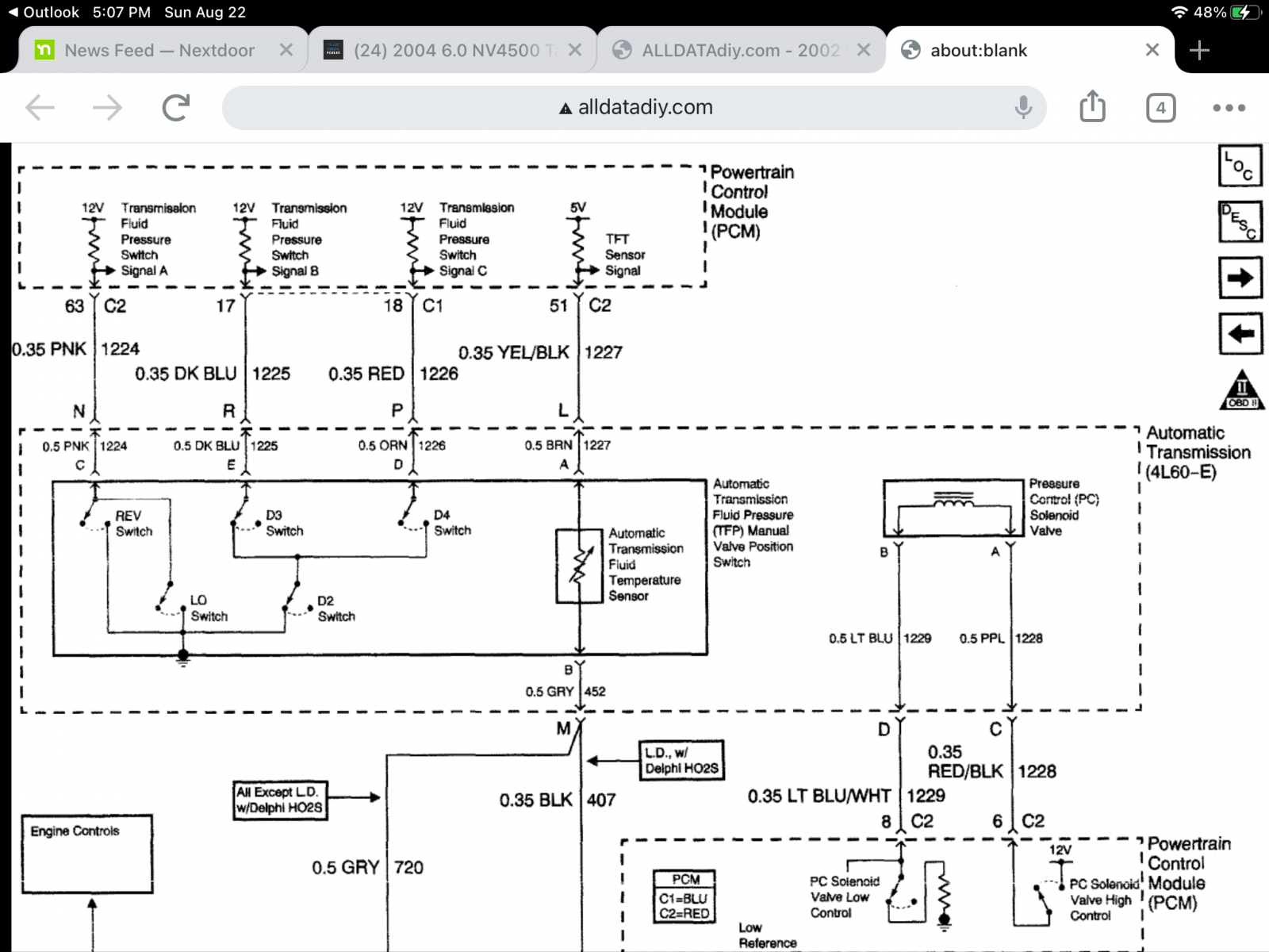

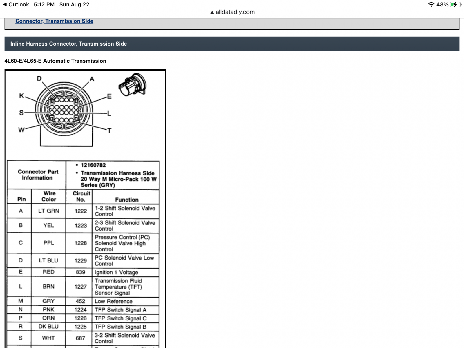

Look again, the 13 pin round connector has to be there or the plug got cut off. Here’s the wiring diagram and pin out diagram for my 02, it should be the same. View attachment 348372View attachment 348373
That's the diagram I was looking at, idk where it could be. Where does it come down from? The engine bay? Does it come through the a grommet in the floorboard?
52,956
It comes down the driver side frail rail and then to the TC and then over the top of the TC or trans to the pass side of the trans on mine. Not sure if it’s in the same harness as the neutral safety switch or separate. Pretty sure it just goes straight to the PCM so there should be no need to go through the floorboard but I’m not sure. I do know it’s in the same harness as the TC, it extends from the TC on to the trans.
TC you mean transfer case? Or Twerk Converter? Or Trans cross member?
I'll have to crawl back under there next weekend and look. Its gonna be a Tacoma driving week anyway I have a lot of crap to haul around.

What @Rocket Man said. And @randeez is also correct on your other question. That plugs into the electronics where your shifter linkage goes. The other plug may be rear O2?
Oh yeah, it does look like an O2 plug totally useless.
sometimes dealing with trannys....they'll tuck it up and behind, so there isnt a visible hangdown
See I much prefer to know what I'm playing with and have it all hang out.
Probably duct taped into the crack.:emotions33:
Is that the method you use? ;)
