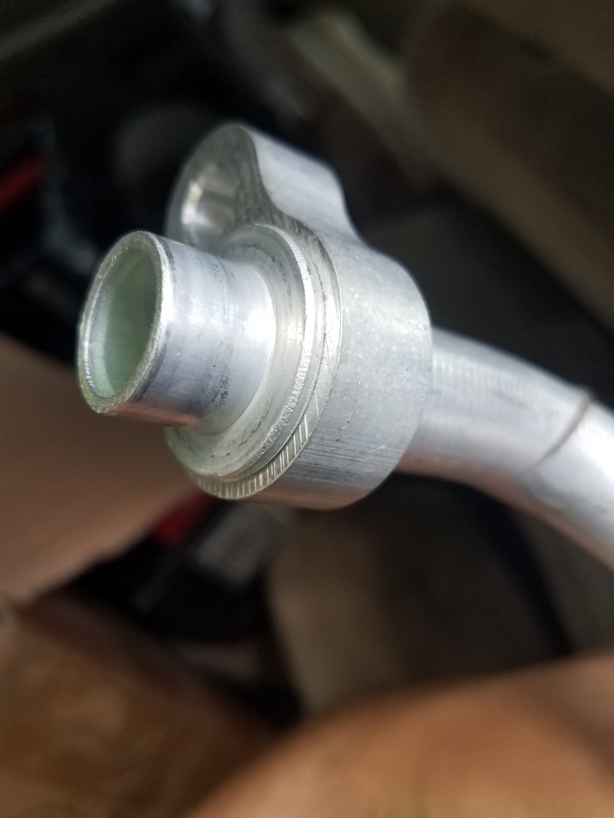

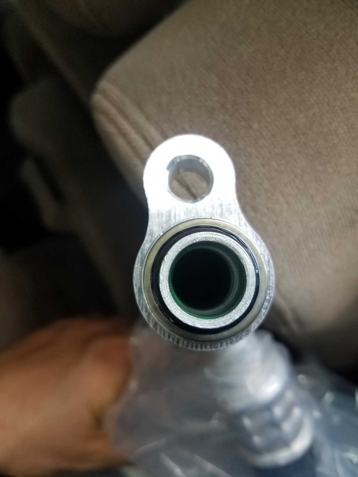

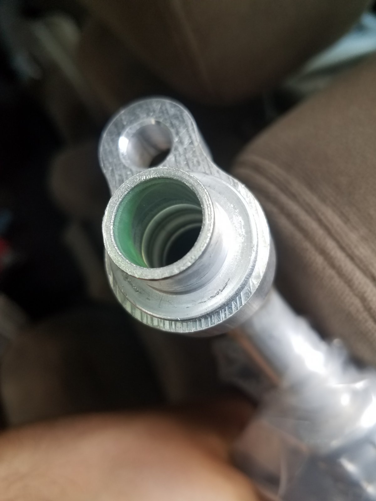

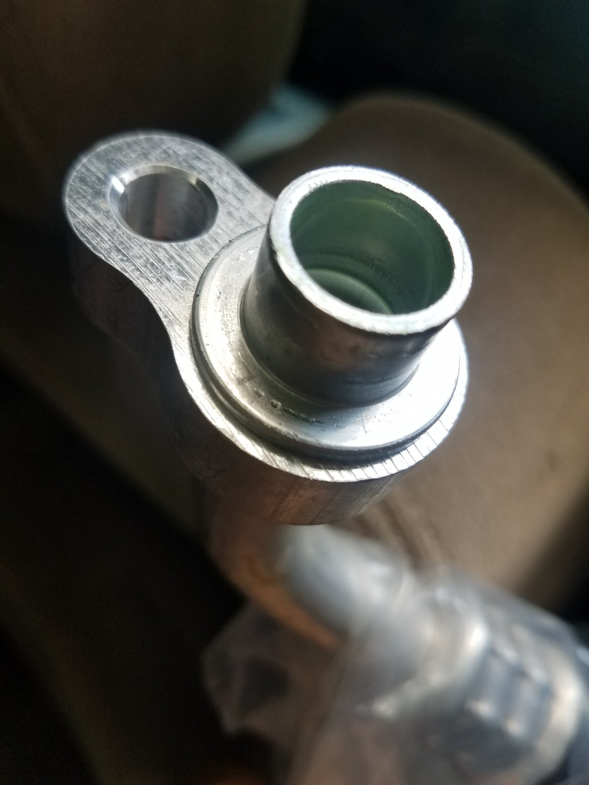

Also, @randeez I just put the block into a vice and tried to spin the hose inside the block but it did not budge a bit. Not saying your wrong just saying I'm a little biotch:gayflag:.
Here are some up close pictures of the line with the seal it had when it leaked, I see no failure with the seal or any cracks or holes that would allow a leak from there.

make sure its tightening down flat on the seal also
trying to describe it... but say where the bolt goes into the compressor. you put the hose on there flat and as you tighten the bolt its not bottomed out where the bolt is, so you tighten up that gap, but it pulls the aluminum block in further on that side, opening up the opposite side. you may need a washer or something to make the bolt tighten up before it pulls the one side in too far

I gotcha, I definitely take my time tightening the bolts down carefully and by hand, no dugga duggas. What's odd is it's been around 6 or 7 months since it happened last time which I believe was due to me pulling the head and bending the compressor way out of the way. Not sure what happened suddenly to make it leak everything out in a day.
Next time it's going together with a softball-sized glob of JB weld encapsulating the entire area.

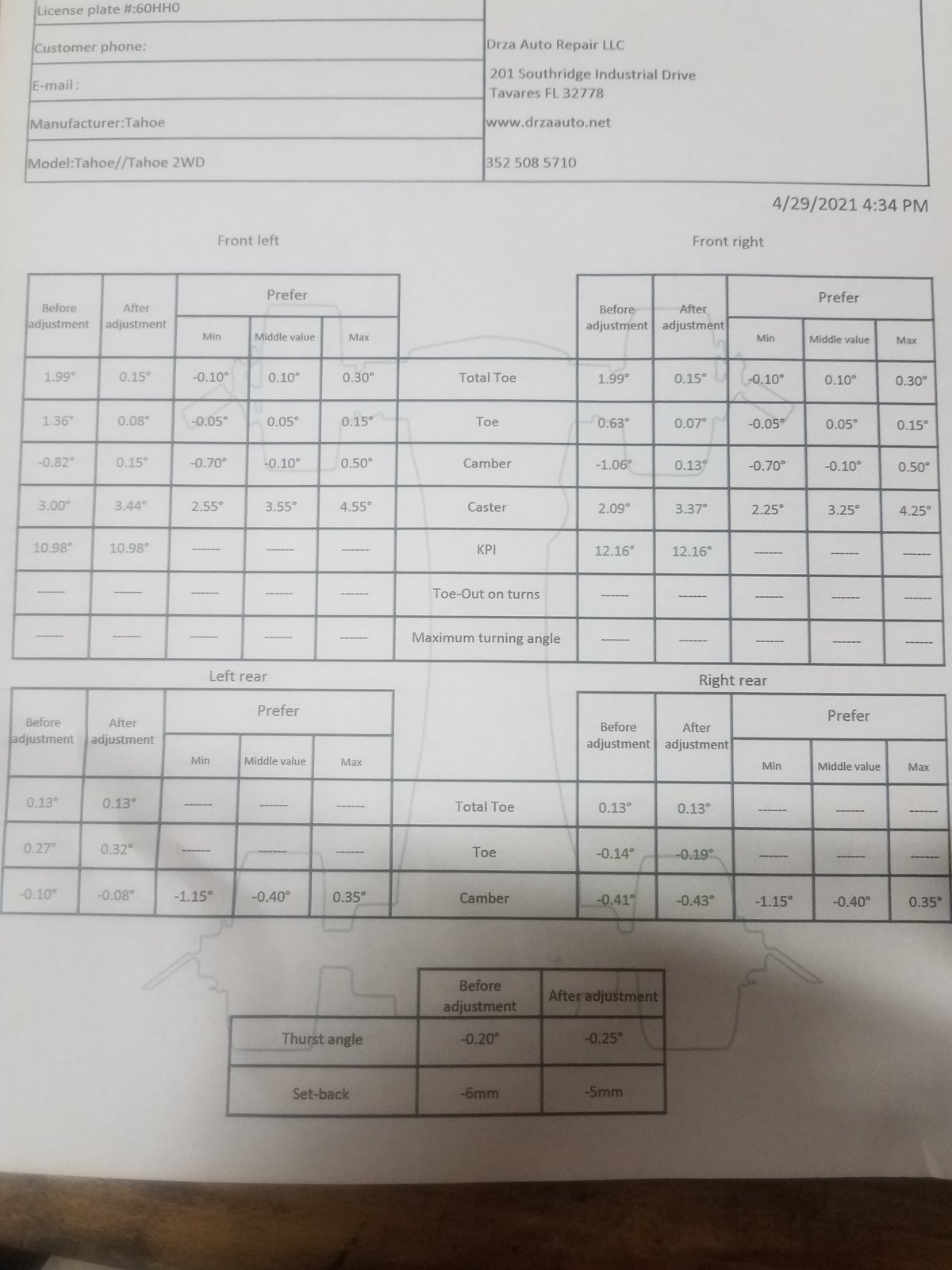

Went to the alignment gods at DRZA today. The Belltech bushings did the trick and he got the alignment about as perfect as can be. The truck is considerably more stable, safer, and the no longer shots in a random direction when I romp it.

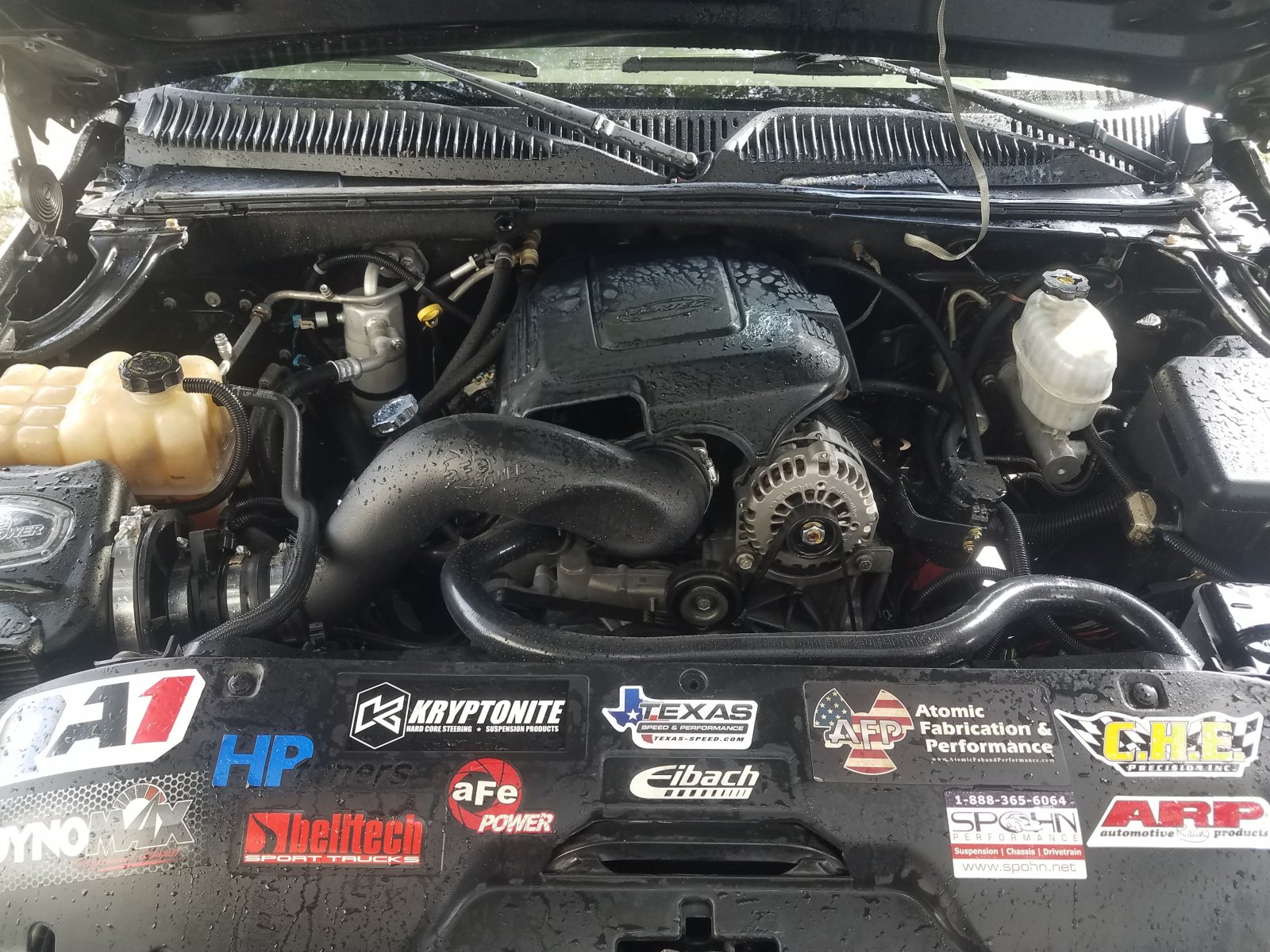

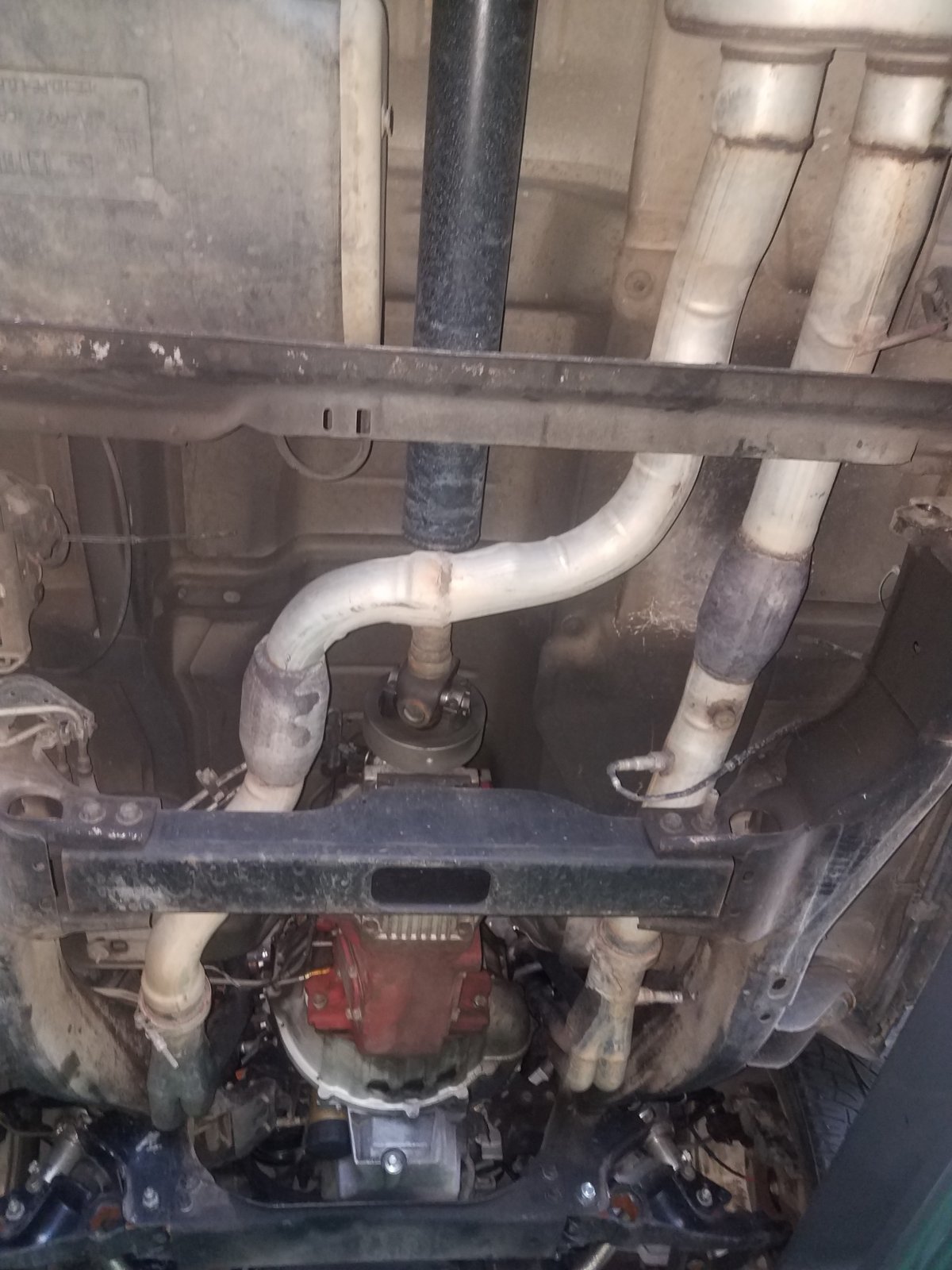

Heres some random undershoot pics of the trucks. Also i borescoped my cats Monday and sure enough they are real.

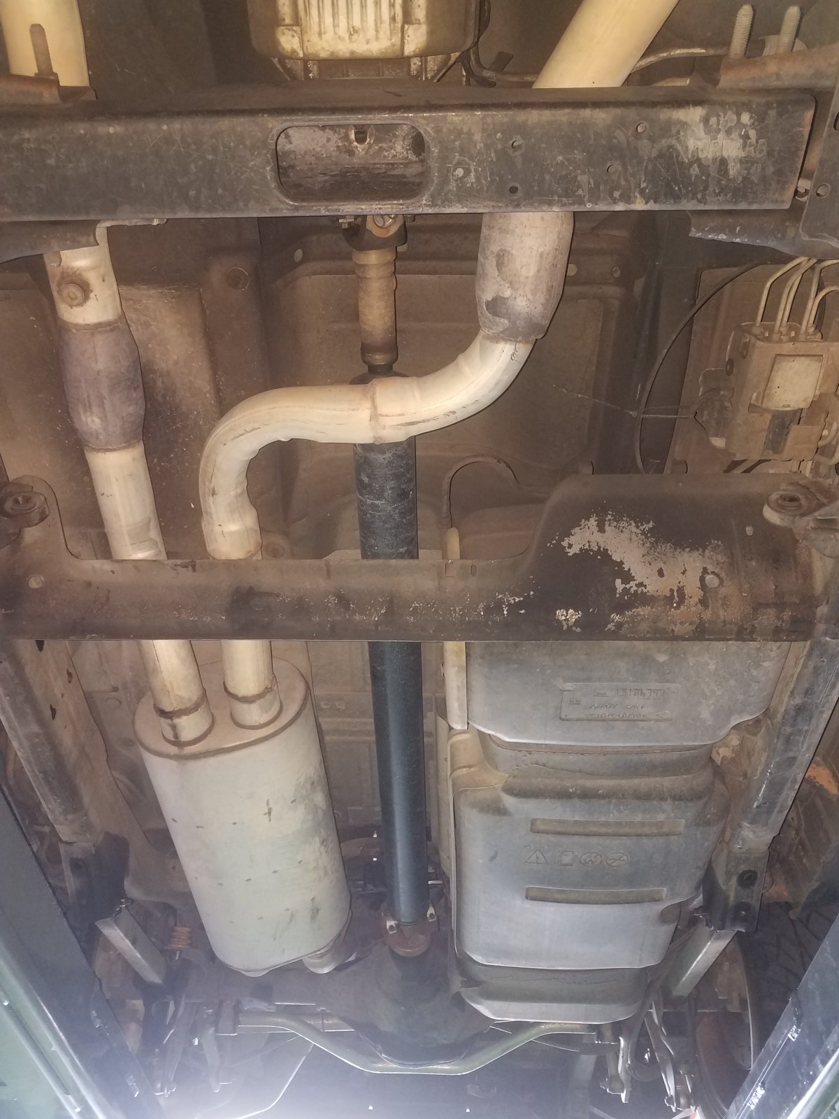

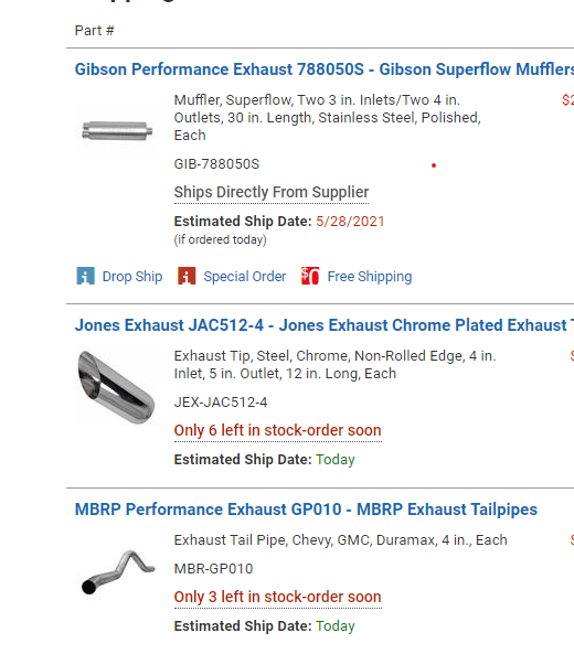

Well when I was at the alignment shop I convinced him to help me out with my exhaust debacle. He does some crazy nice exhausts like full titanium with pie cuts and other gorgeous stuff, typically not old Tahoe junk. Anyway, I ordered the big ole Gibson dual 3" inlet single 4" out muffler, a Duramax 4" mandrel-bent tailpipe, and a big ole tip for the ladies ;). Hopefully, this will be the final rendition of the exhaust.

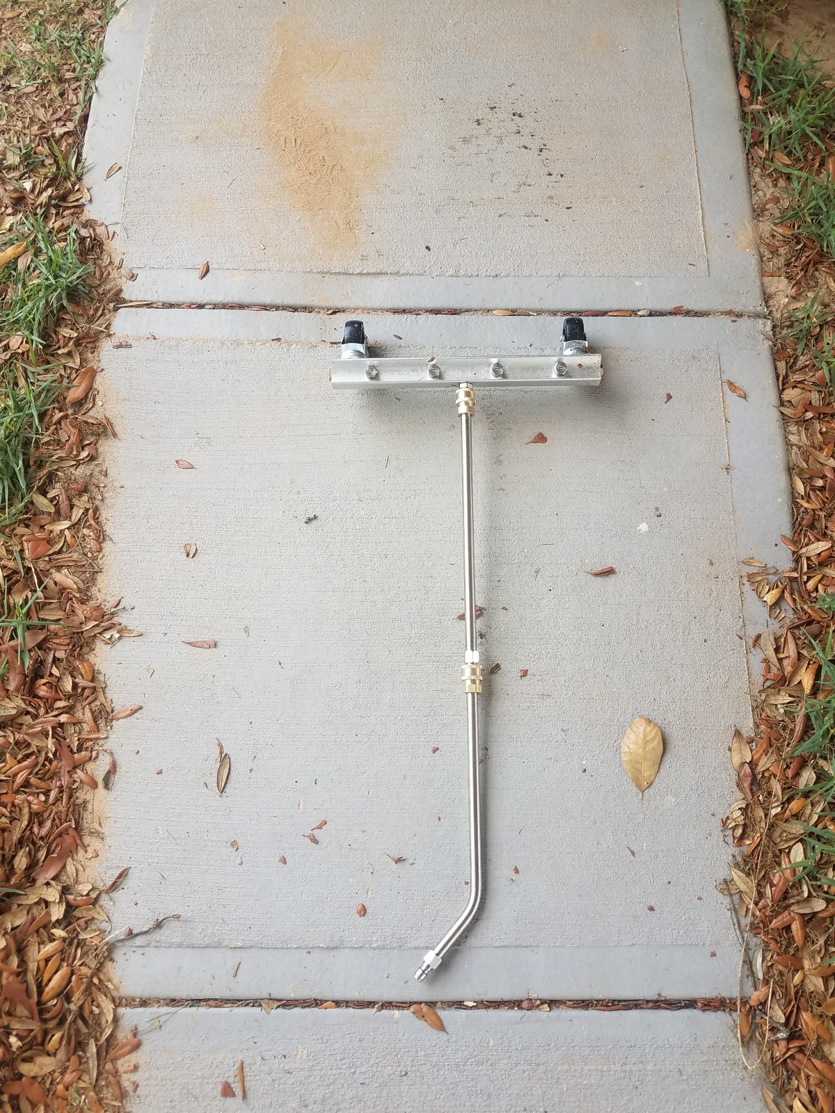

Wasted $28 on this dumb under car washer thingy. It's well made but theres no way to keep it going to direction you want it just spins at the QDs.

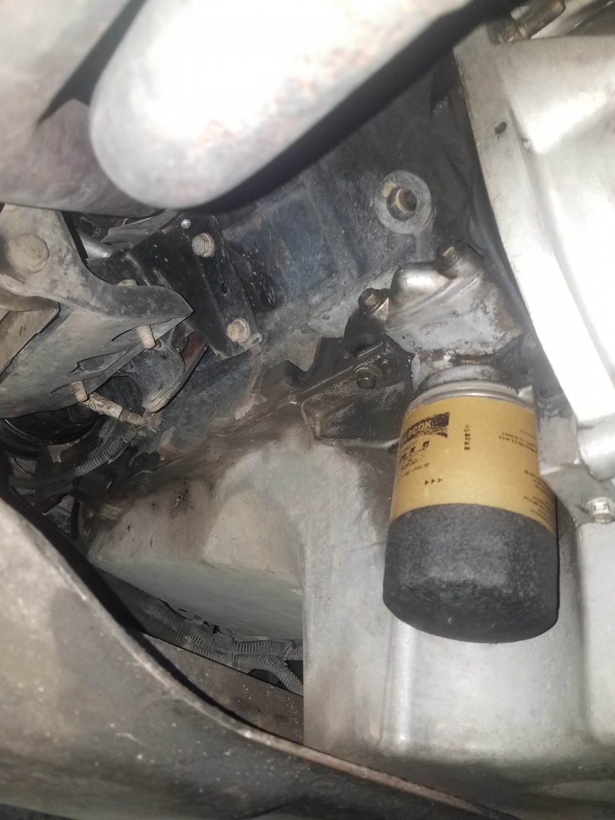

Gave it a good spray down with the regular pressure washer anyway and noticed the brake master is getting oddly dirty, it must be leaking from somewhere.

Don't like that sprayer? I was thinking of getting that one myself. Home Depot?

Amazon, it's a pretty bad design there's no way to control which direction it goes because it's able to swivel at the QD attachments. It's kinda like trying to push a rope, anyone over 40 should understand :jester:
Also, the way my electric pressure washer works it changes pattern with QD nozzles, well it also somehow changes over to soap lessening the pressure with a different QD nozzle and somehow the sprayer attachment did the same. So all I could get out of it was low pressure and bubbles. Good for an initial soak down but I need moar powa baby.
