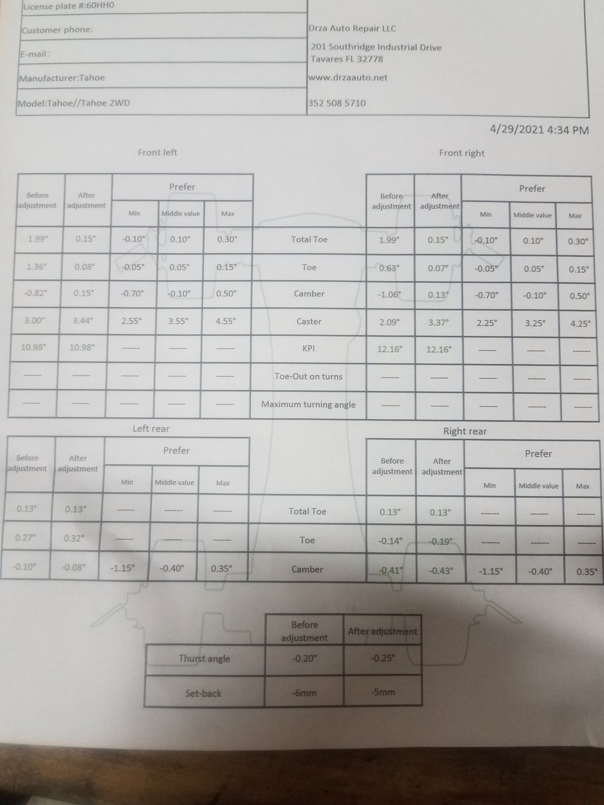

Went to the alignment gods at DRZA today. The Belltech bushings did the trick and he got the alignment about as perfect as can be. The truck is considerably more stable, safer, and the no longer shots in a random direction when I romp it.
Bad news is my AC went out again. I see no leak and it had plenty of pressure, too much pressure actually. The high side was right around 350 but the low side was pegged at 120! It was about 95*out. I'm vacuuming the system the refilling to see what happens as nearly every component is new and I don't know what else to do.

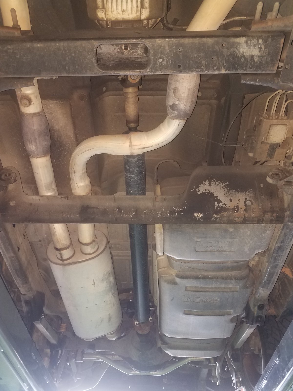

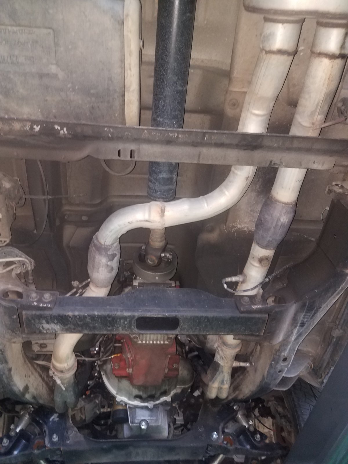

Heres some random undershoot pics of the trucks. Also i borescoped my cats Monday and sure enough they are real.
View attachment 278006 View attachment 278007 View attachment 278008 View attachment 278010
Your driveshaft is different in the front custom welded ?

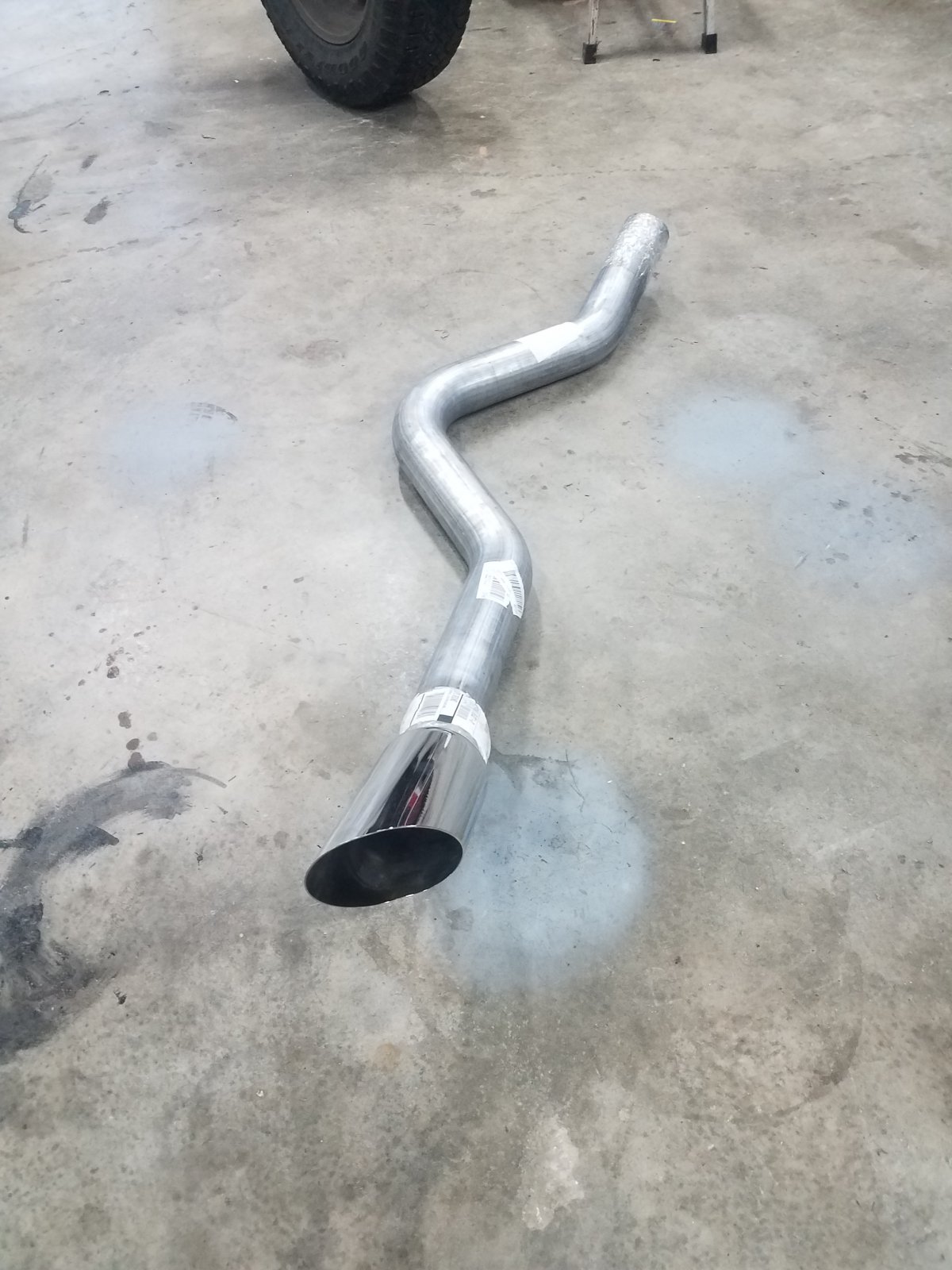

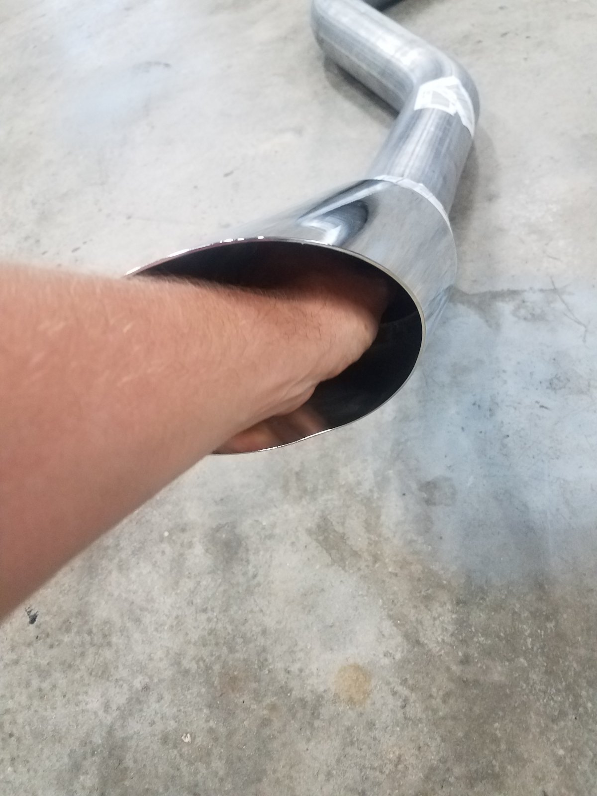

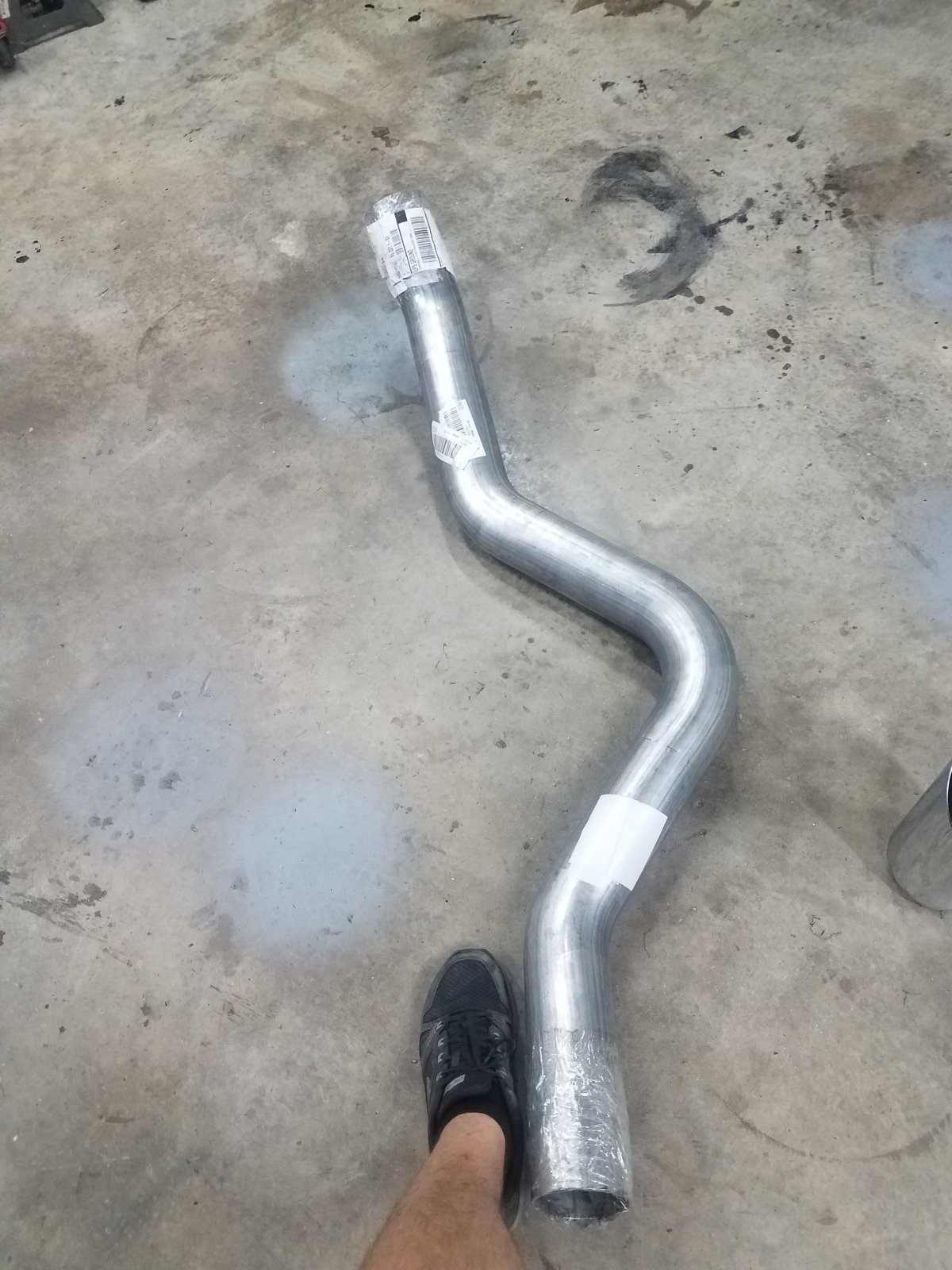

Everyone like big pipes right?
I kinda under estimated to size of 4" it looks ridiculously big. Not sure I like the tip either but guess I'll find out in a month when the muffle shows up.

same size, mines bent a little to the right tho.
i bought an entire 4" straight exhaust to cut up for mine...was like 200 bux lol.
i planned on doing 5" but its rilly spensive, like 150 bux a bend
Yeah 5" nearly doubles in price or more. I can't believe how cheap the 4" stuff is I guess diesel guys just buy the crap out of it so cost is down. I might need more bends but I'll see what he can do with this first.
One big pipe is better than 2 small ones right?
4" area=12.57
3" area=7.07
single 4 is only a little bit smaller than 2-3"
