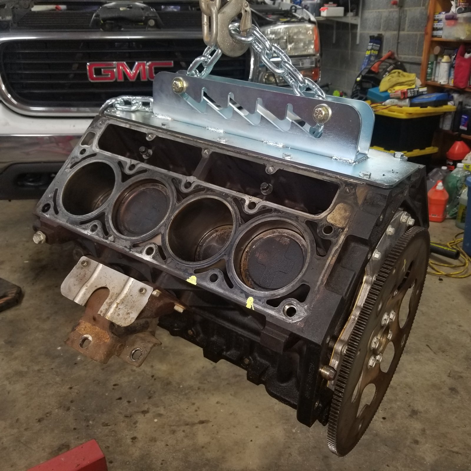

I will check that out too. Hoping the Jegs engine valley plate comes tomorrow. Makes it easier to get clearance up against the firewall when removing and installing.

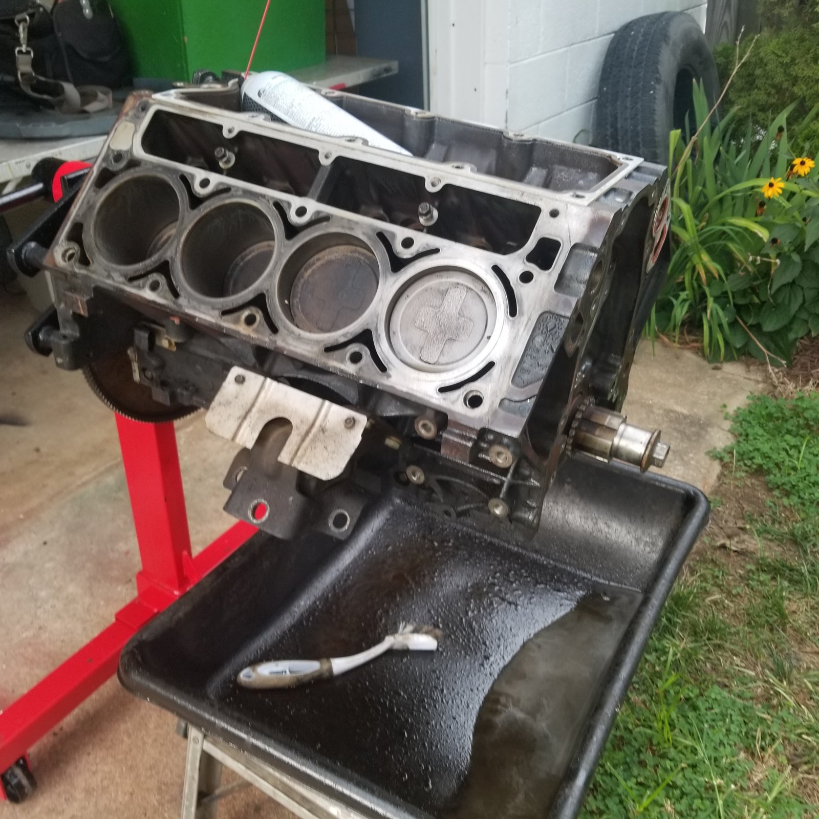

I received Jegs plate Thursday. I got motor out midday today and started cleaning it up. The harbor freight 1000 lb engine stand works great. Jacked up transmission and it came loose and took time getting it out

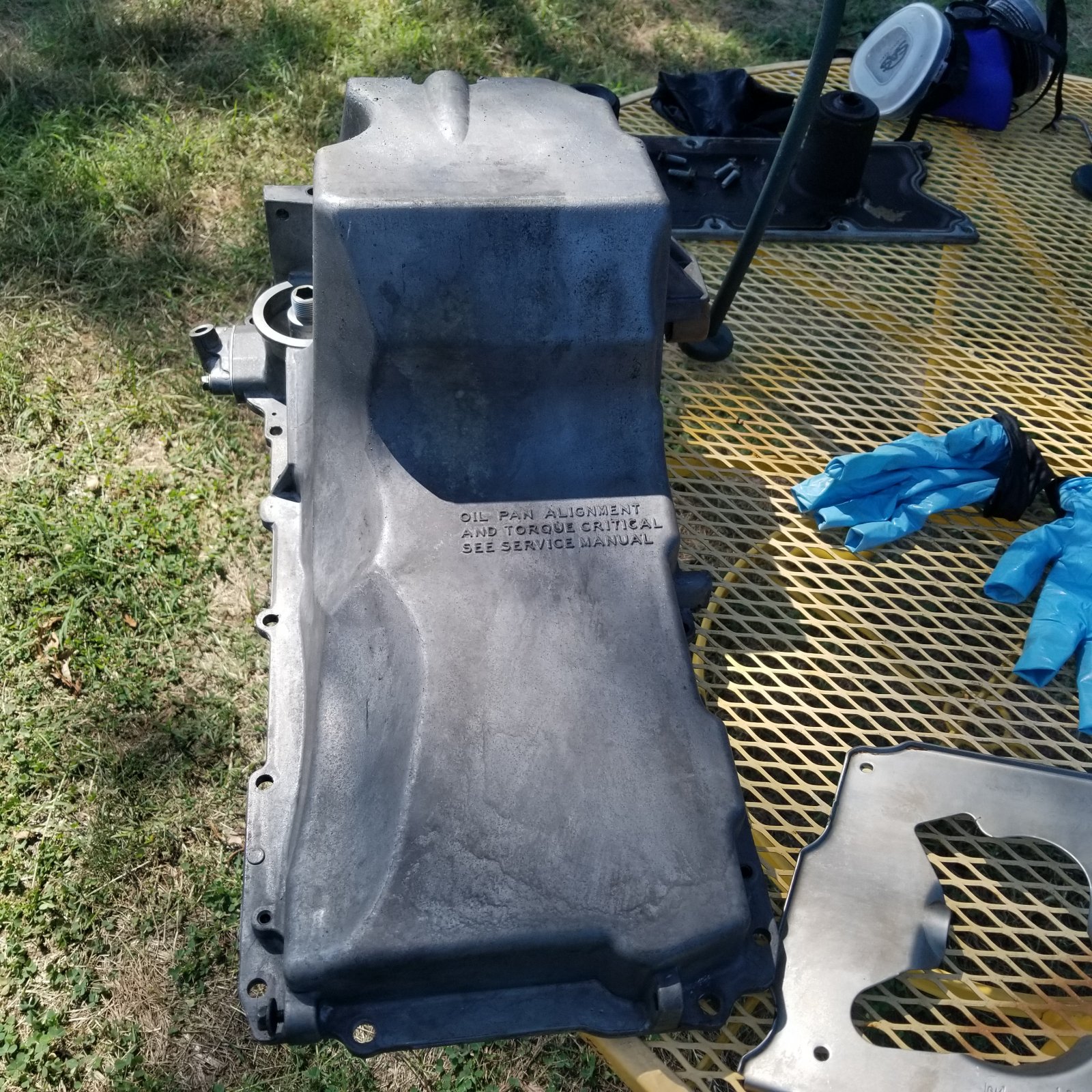

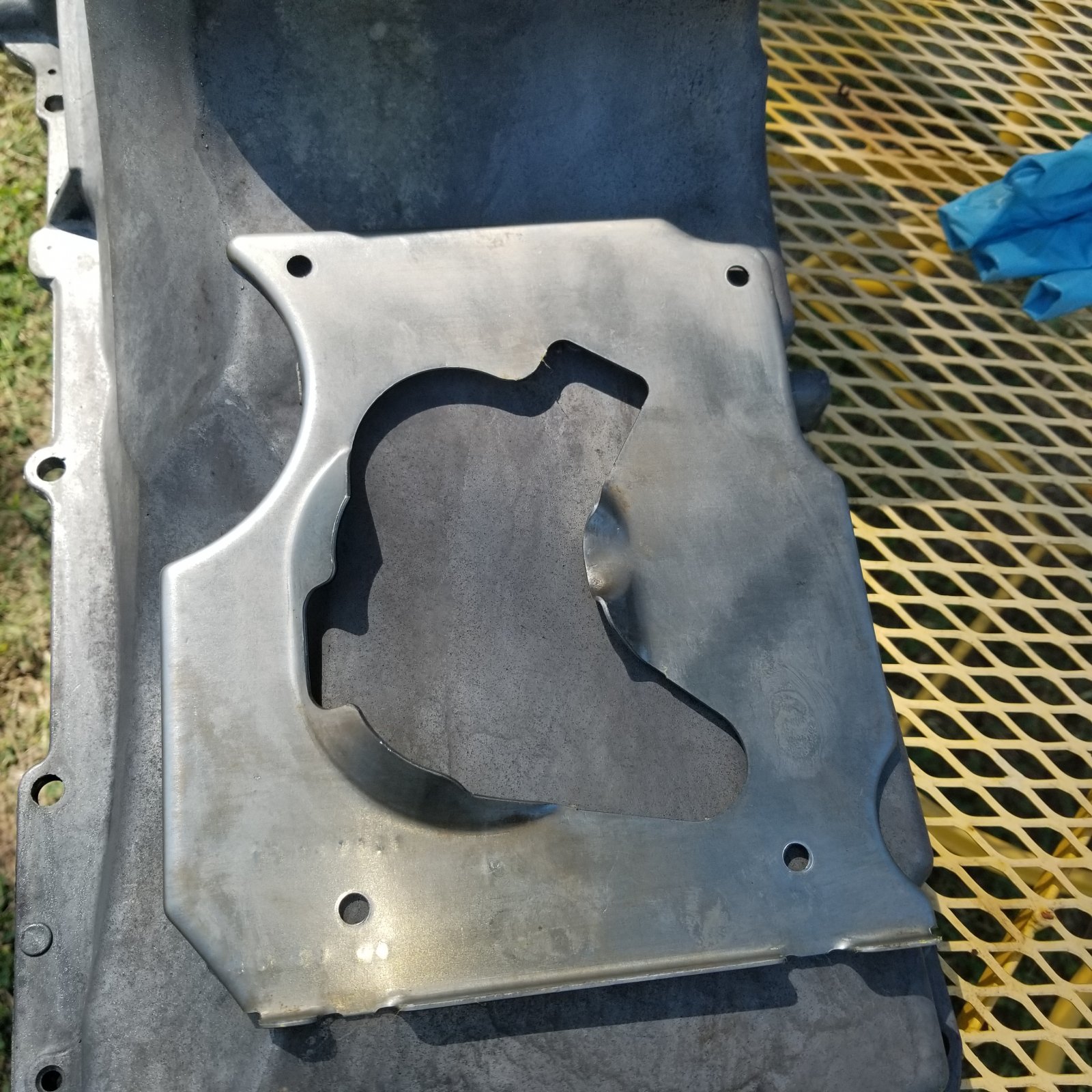

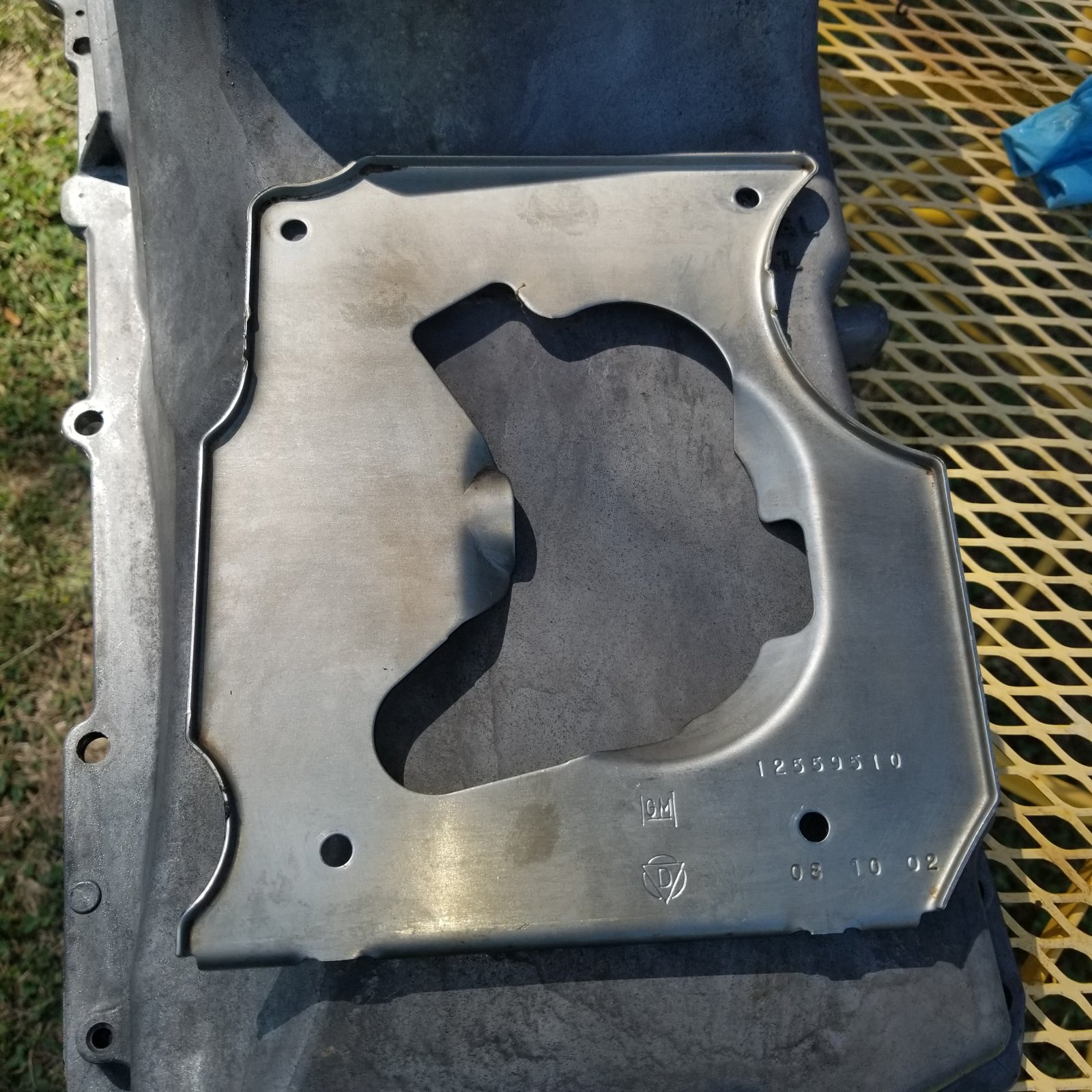

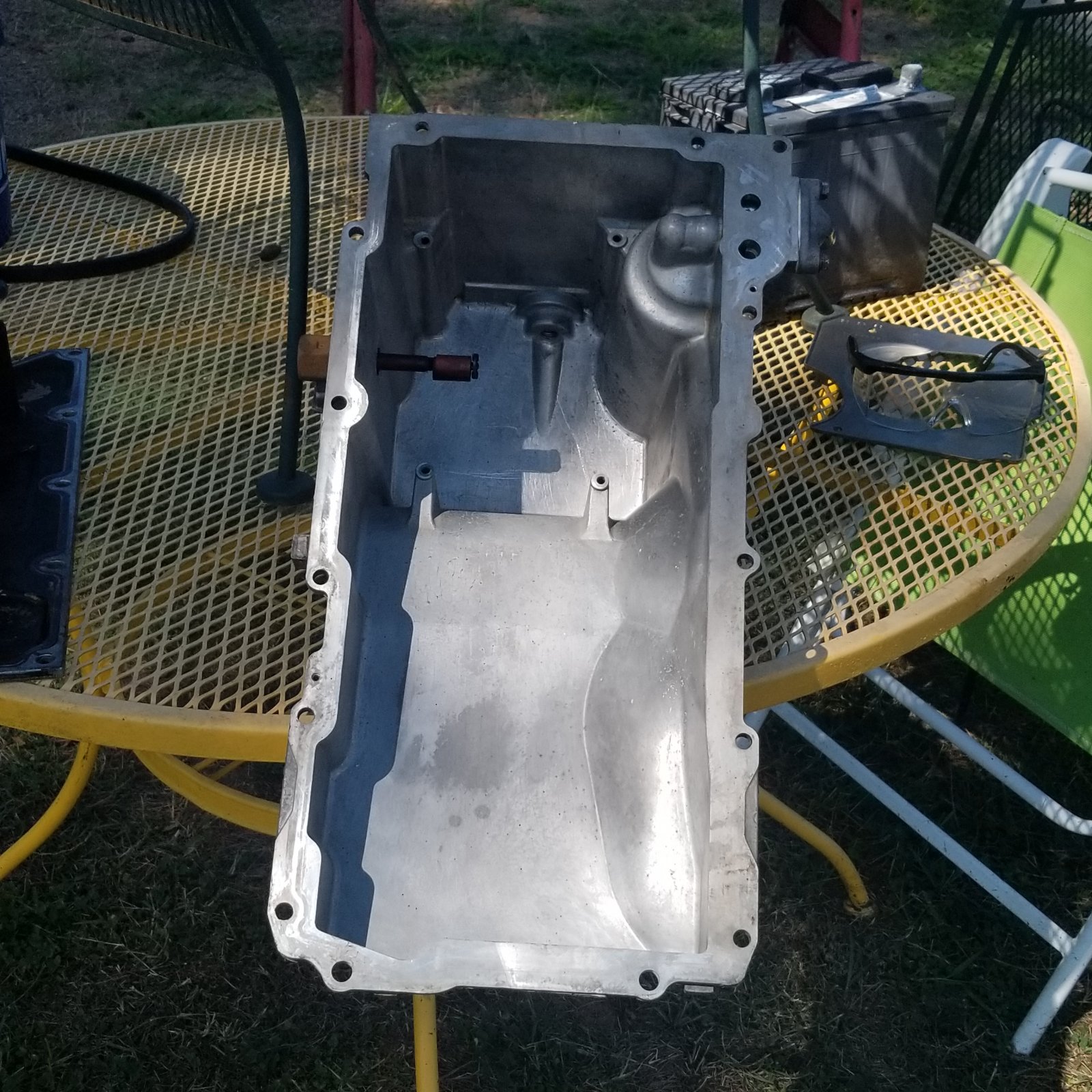

Got oil pan clean using easy off cleaner. Saw that on YouTube and follow up by cleaning with break cleaner
