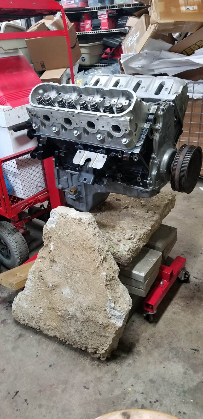

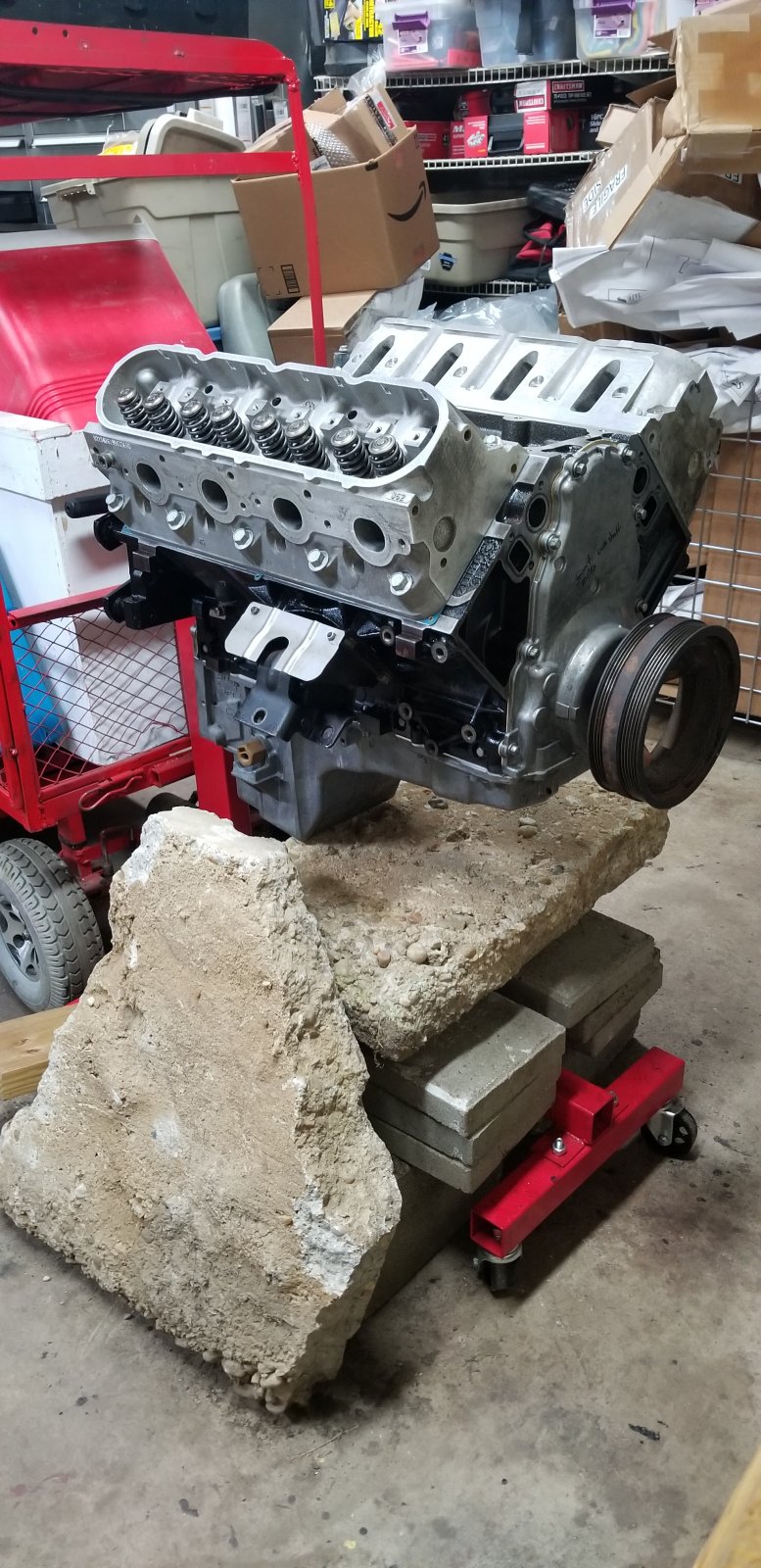

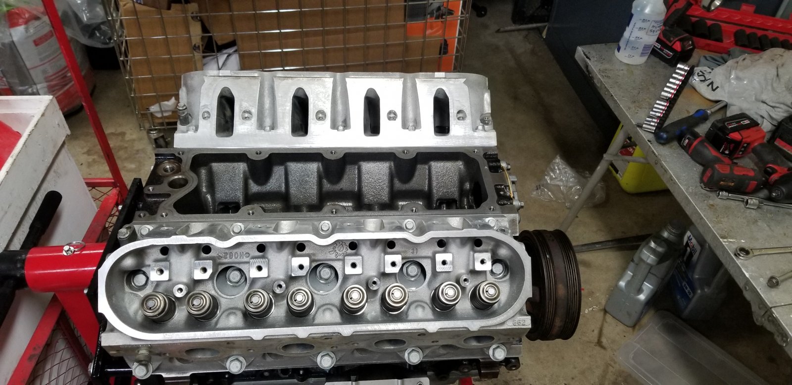

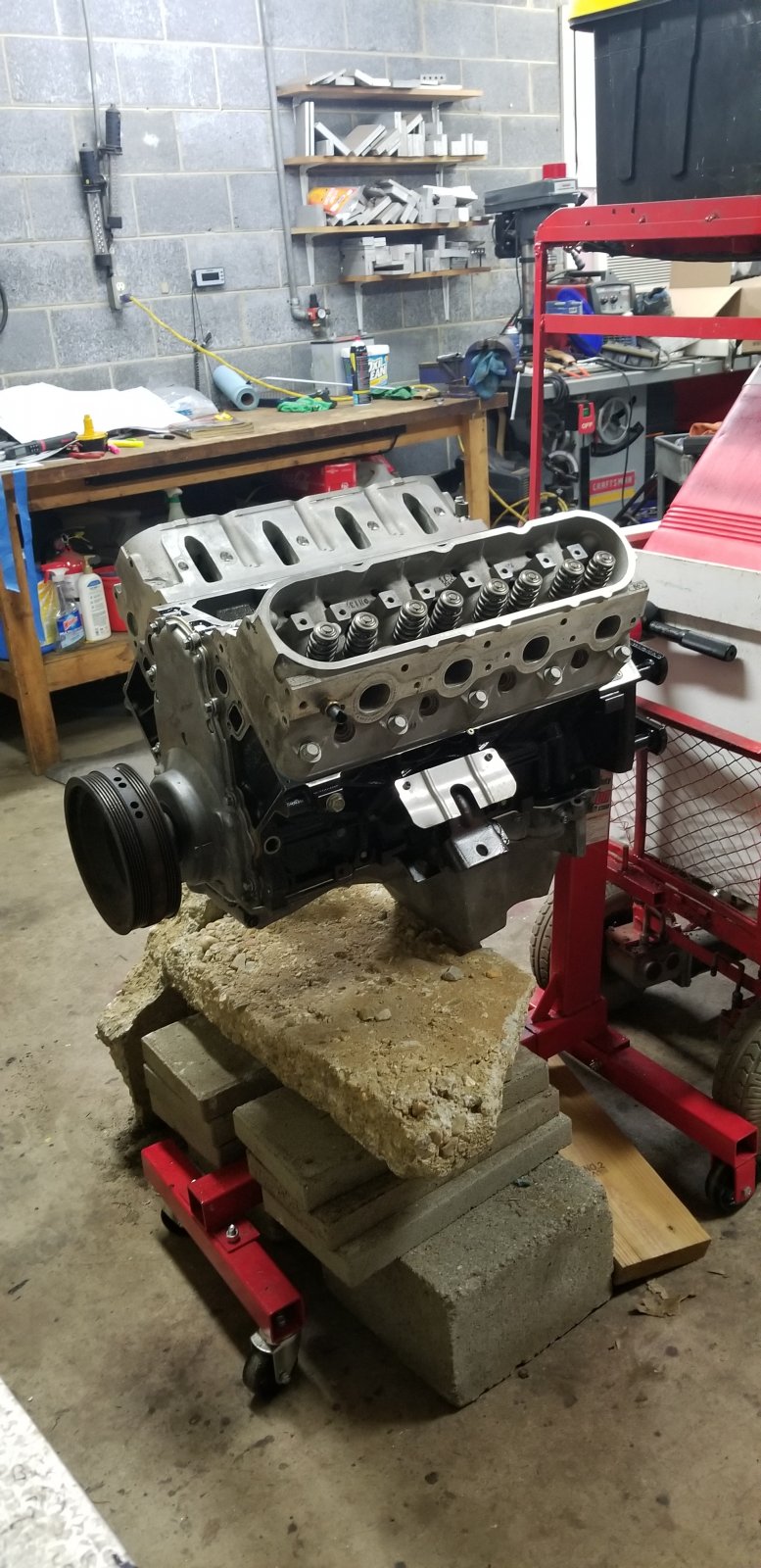

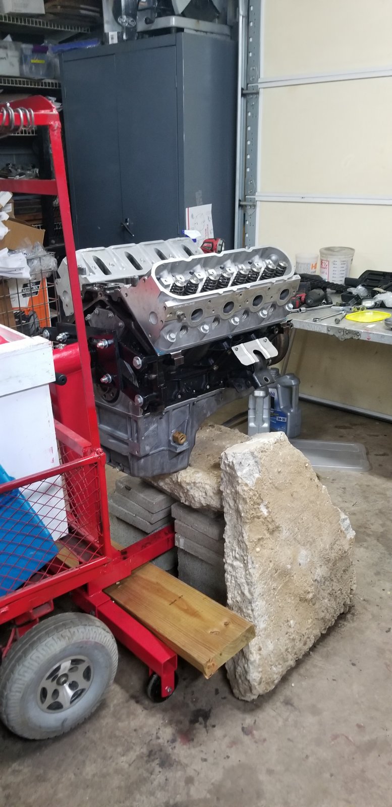

I was able to get the heads on last night. I did not have a helper so I improvised. I used some solid concrete blocks, paver blocks, and an old slab of concrete. Plus shored it up using my electric parts cart.
