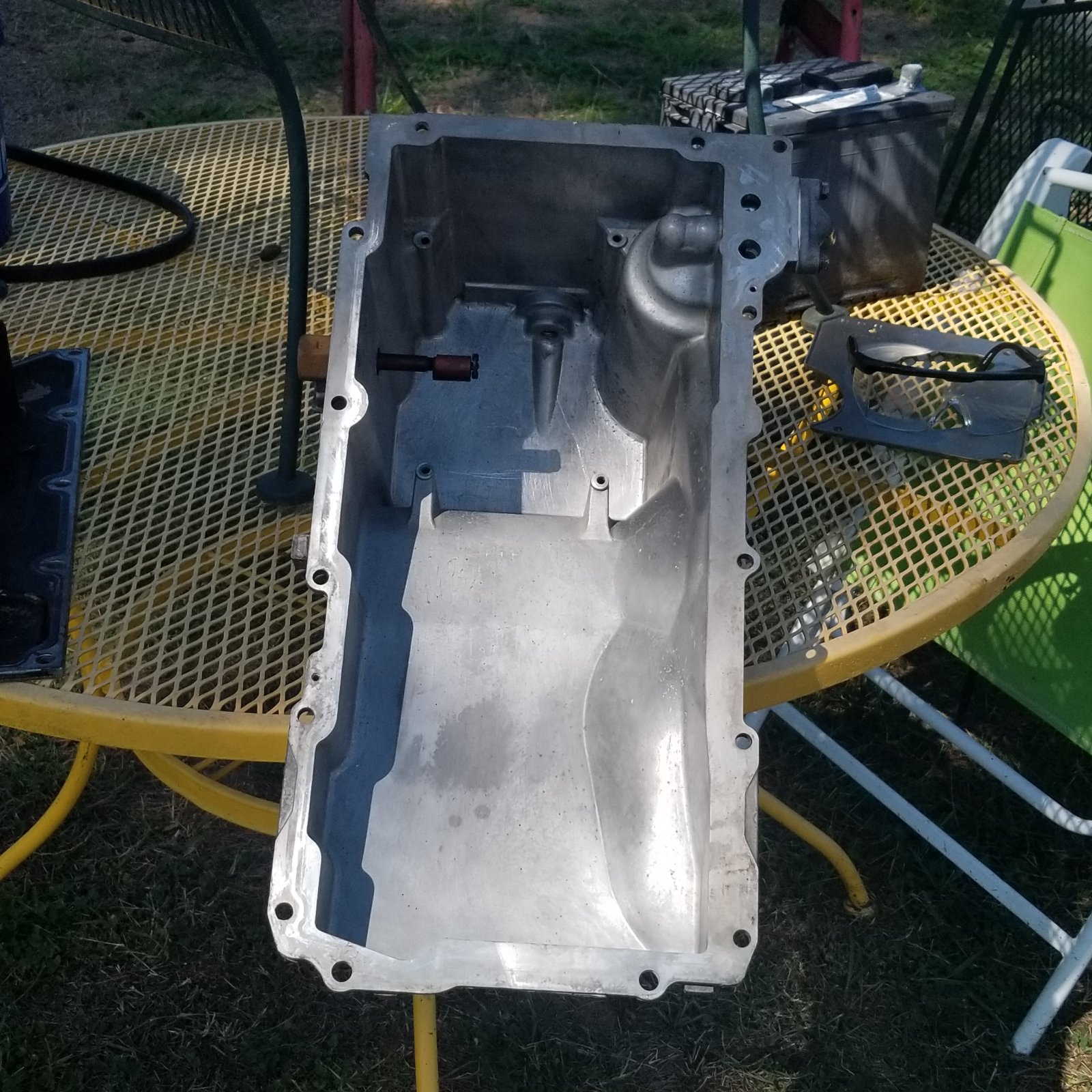

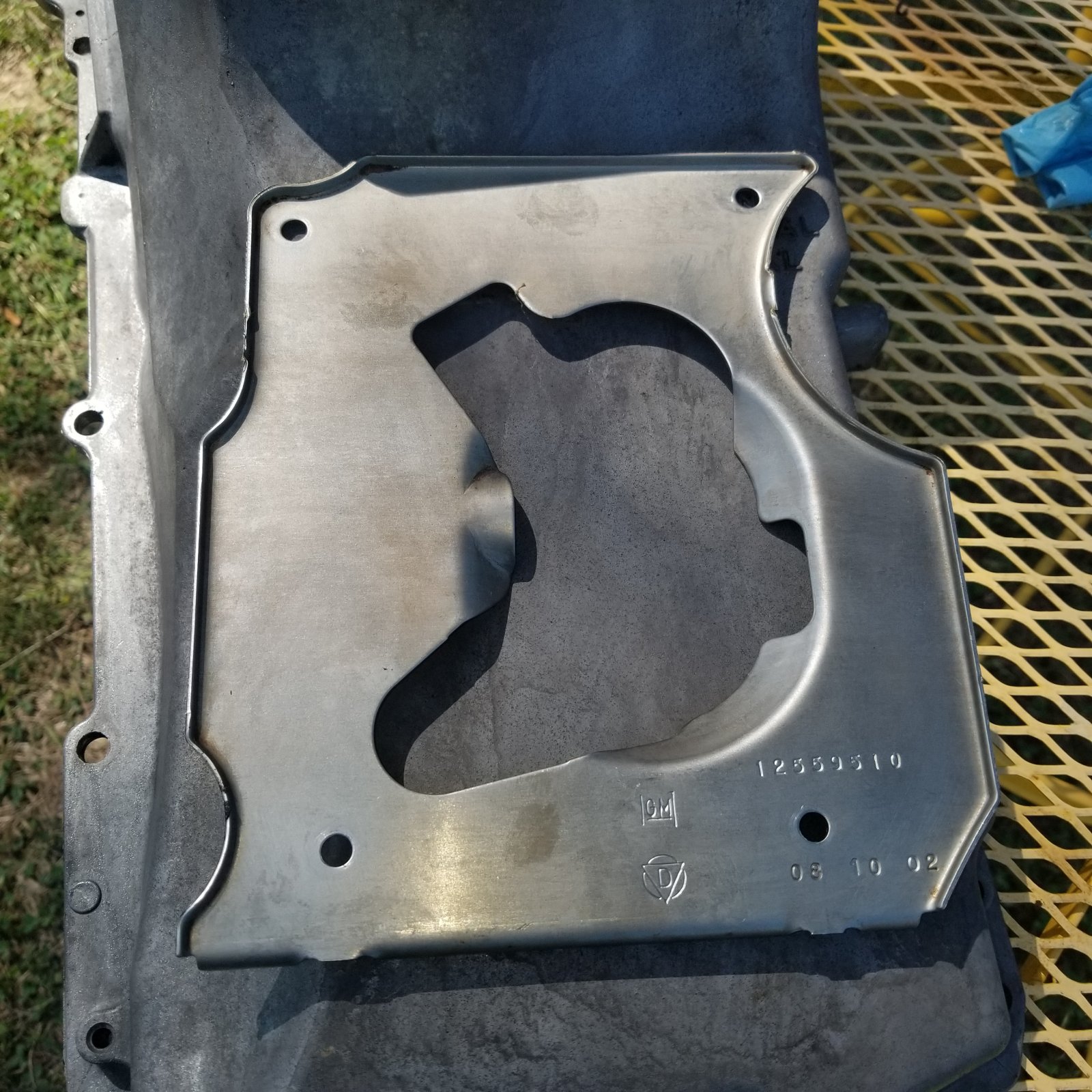

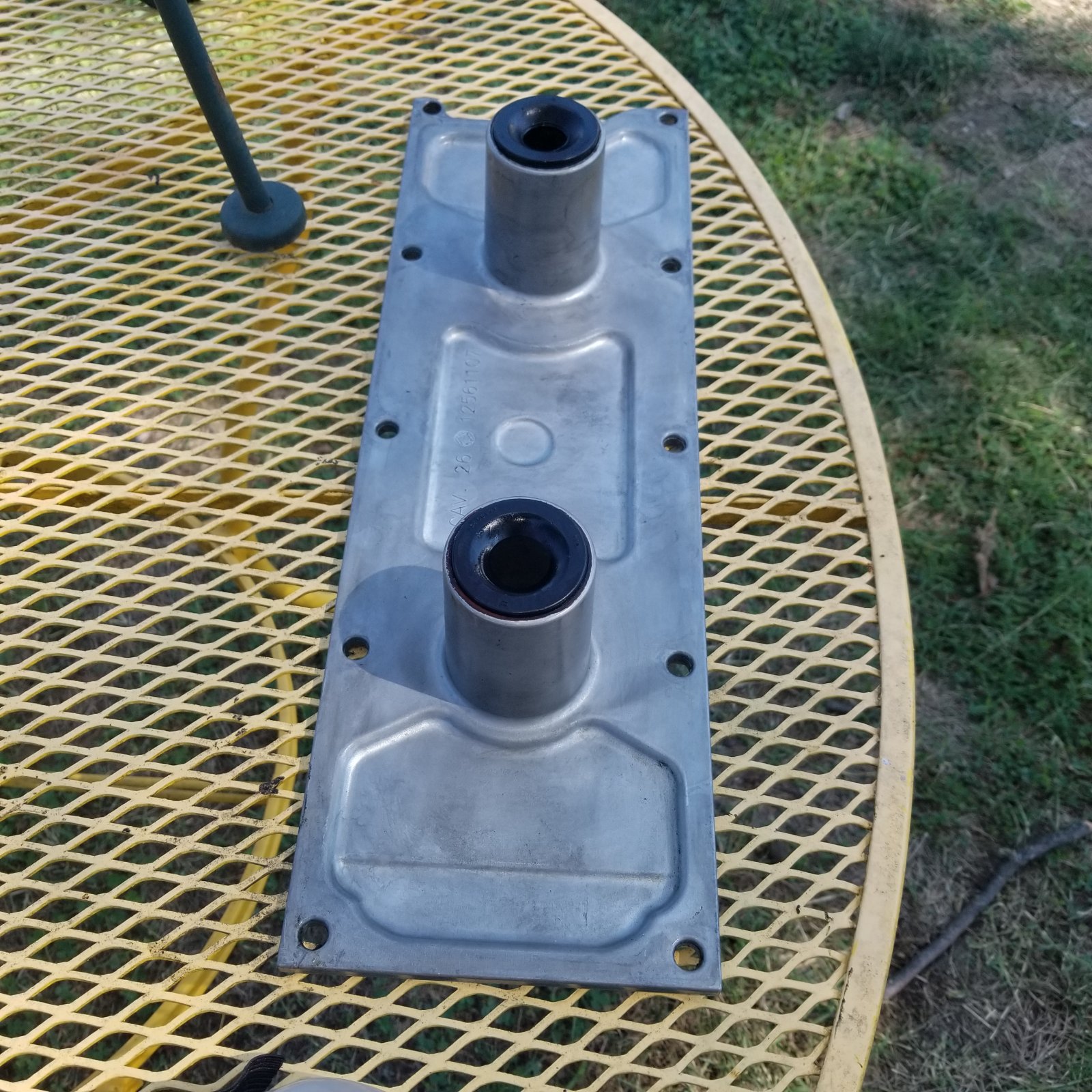

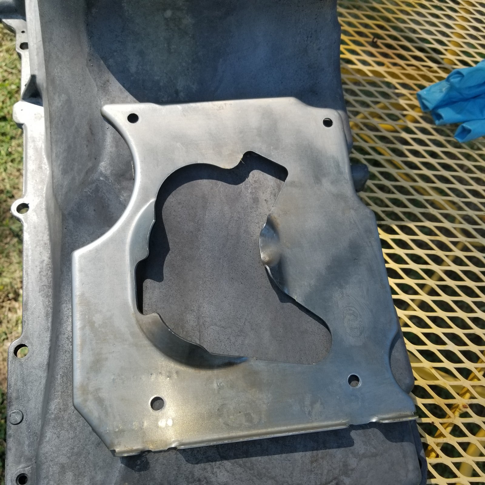

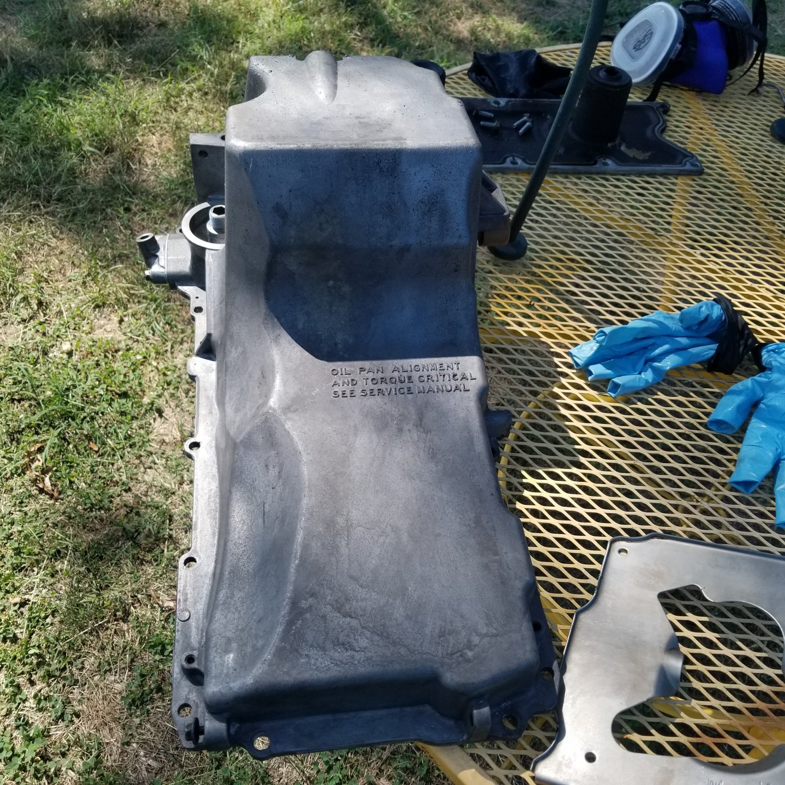

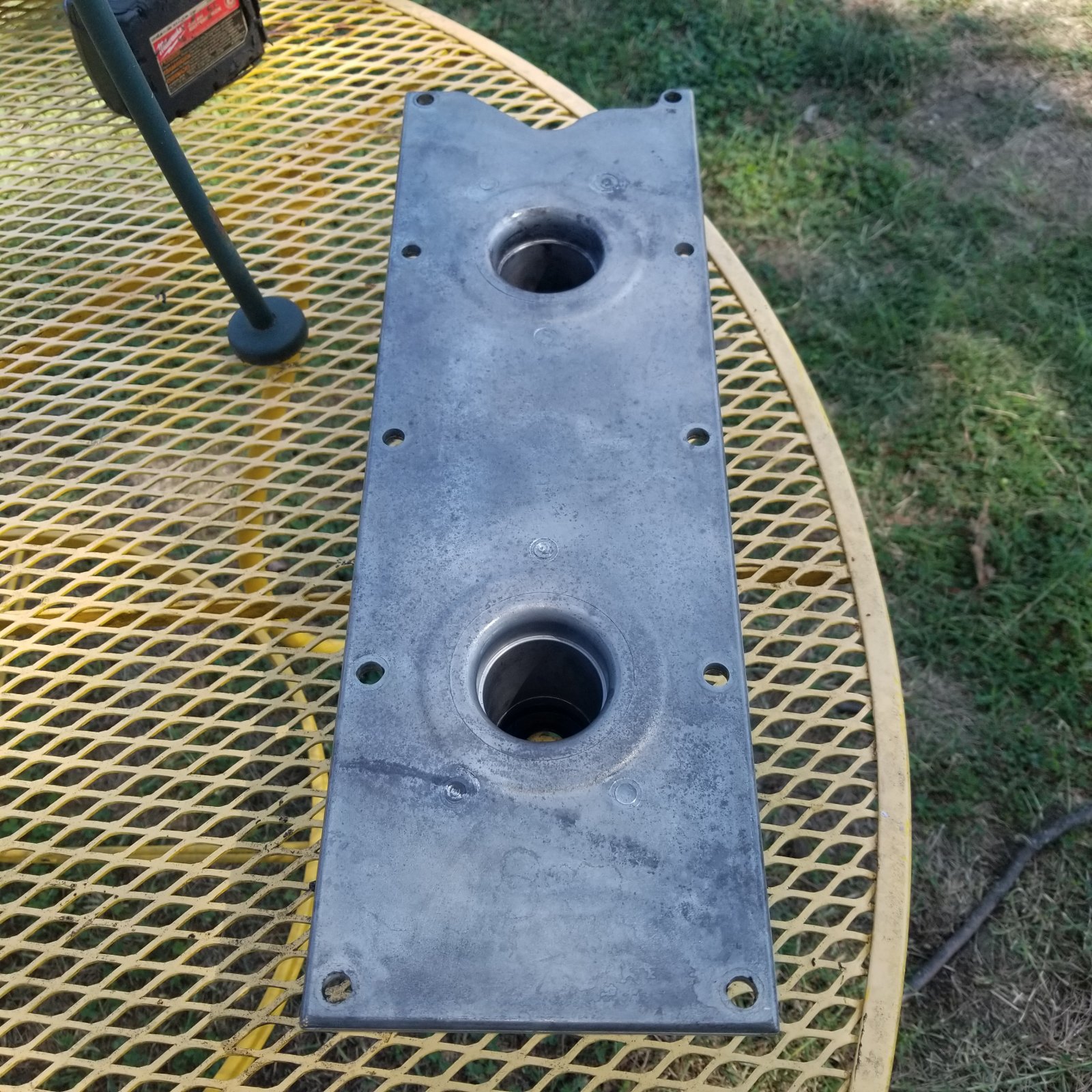

Got valley pan cover cleaned

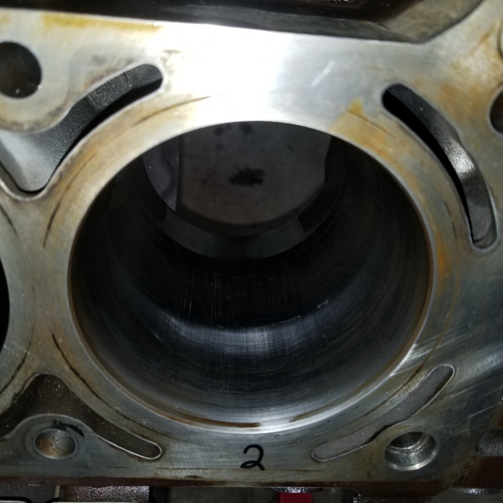

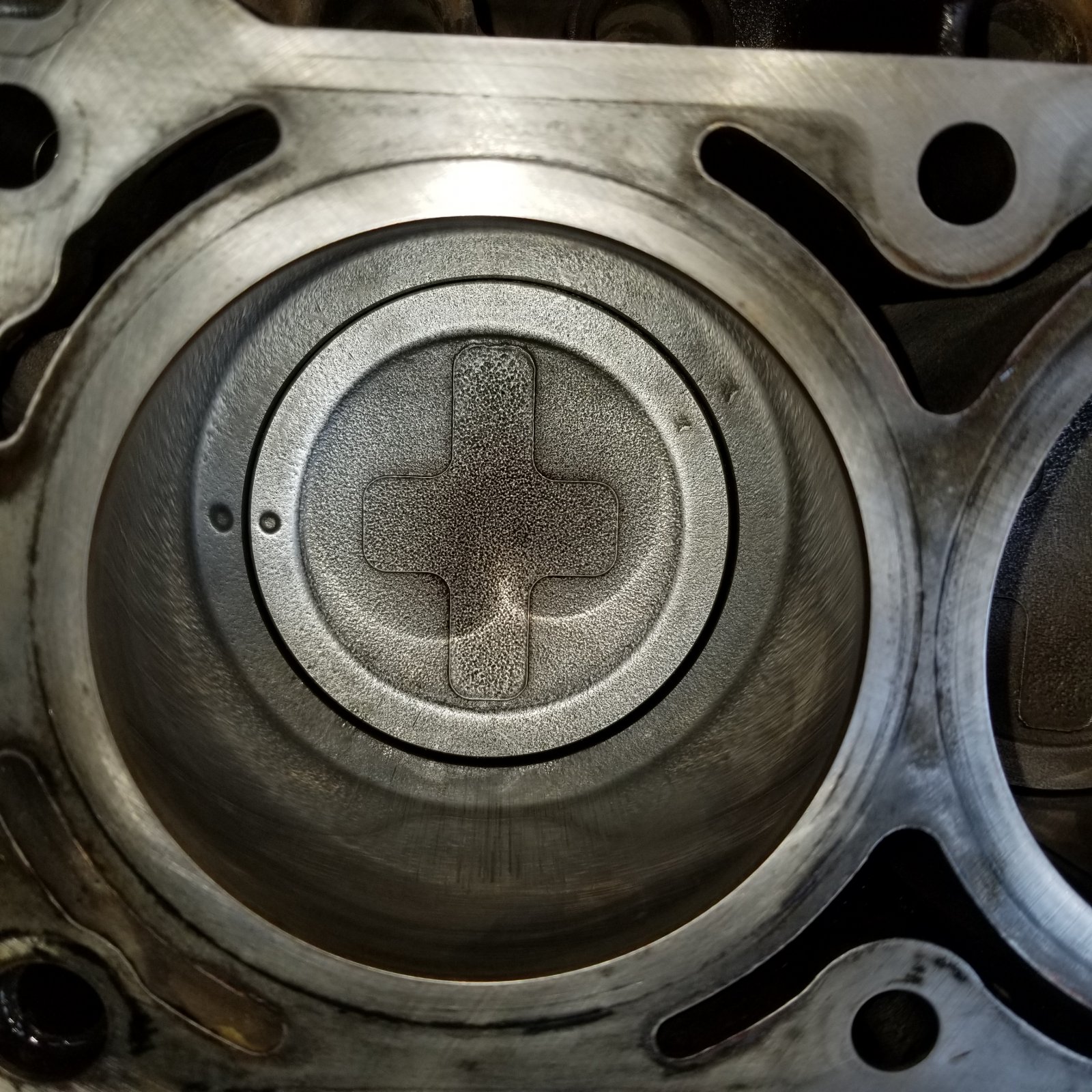

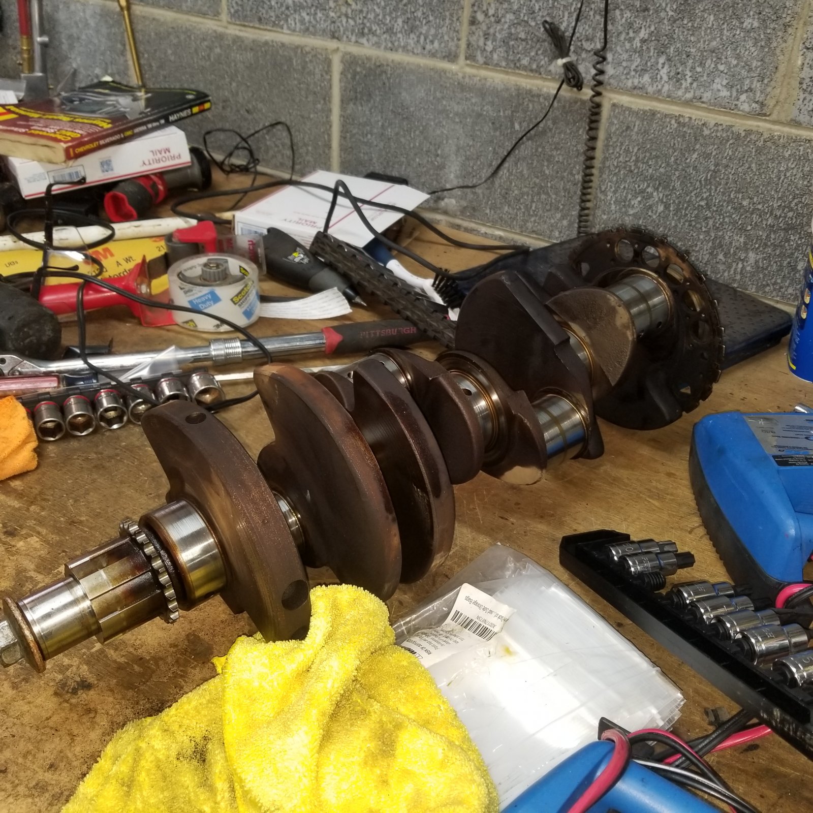

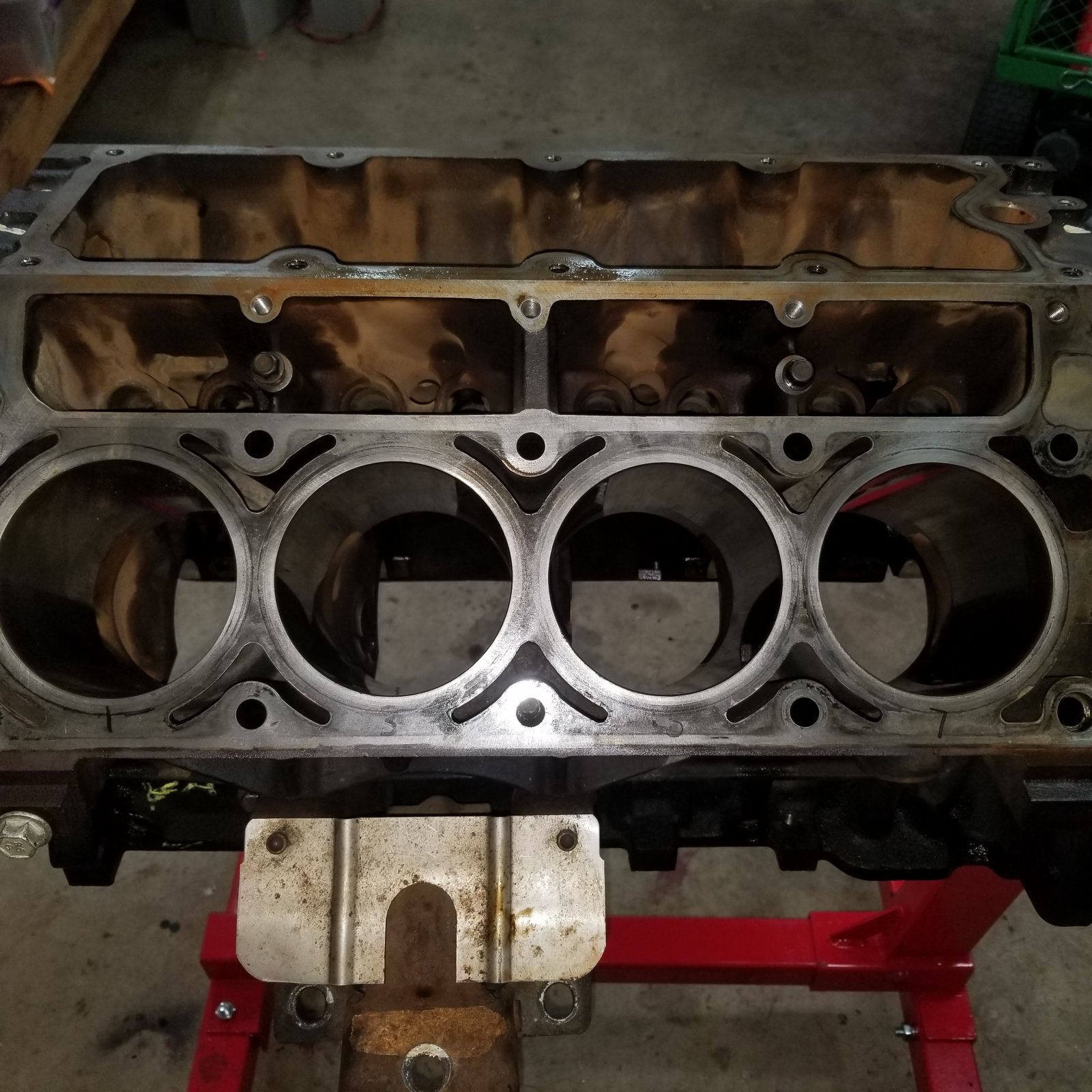

Update, taking block to machine shop this evening. My heads are being picked up today.

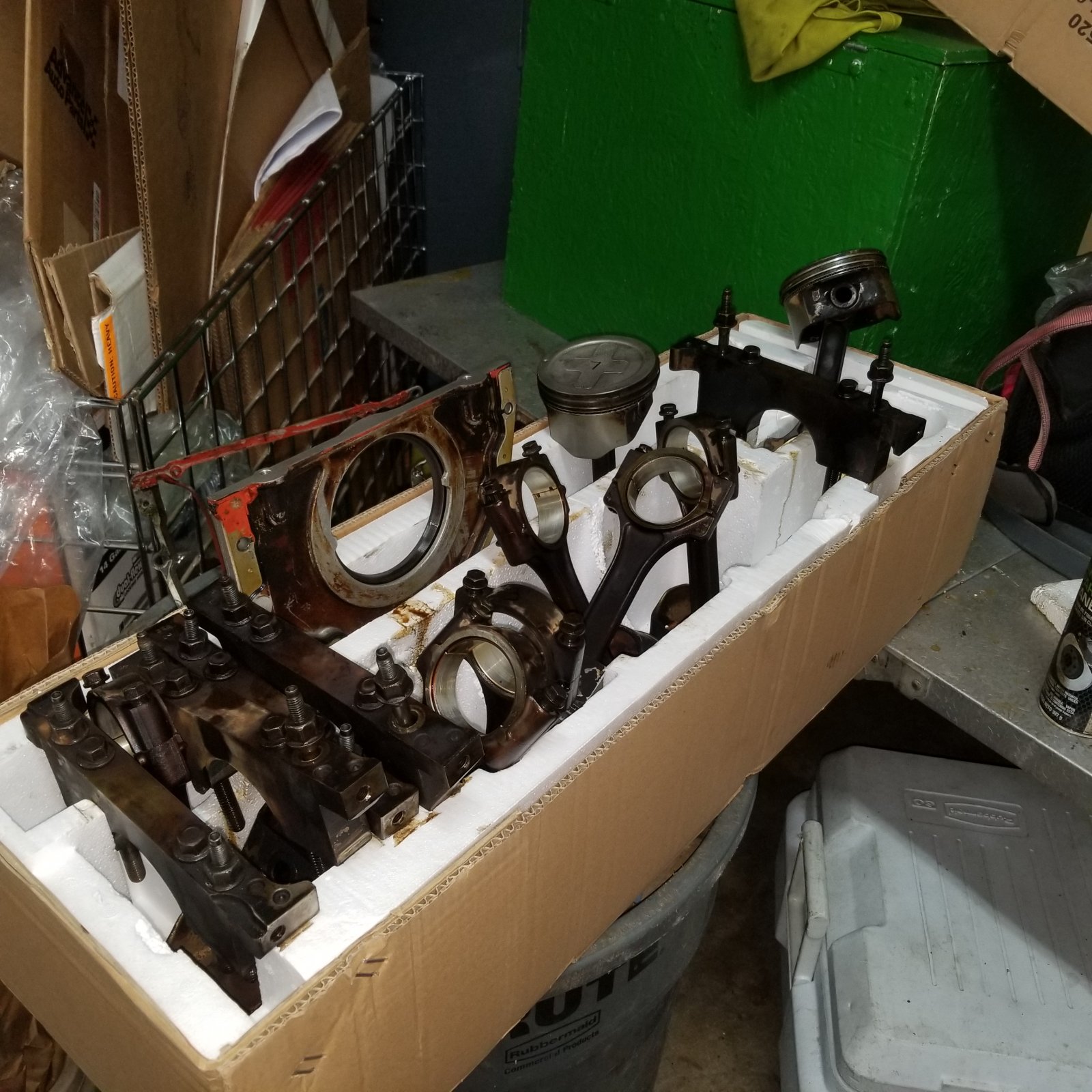

Crank is removed and pistons. I am getting new cam shaft bearings installed, quoted $60.
Ask them to clean block and hone cylinders while it is there. They are inspecting the rocker arms and push rods.
Is there a way to check the pistons/ wrist pins and connecting rods?
I researched on most reman motors except gm they reuse the pistons and connecting rods. I have read it is best to keep stock pistons/connecting rods and replace the rings?
Any thoughts? I'm not modifying the stock flex motor.

Update, Both heads rebuilt and cleaned out the door $384.
Machinist looked at all my parts,
Crankshaft GOOD (clean at home)
Pistons, connecting rods, and wrist pins GOOD (Clean at home)
Machinist recommendations;
Chase thread passages for head bolts
Hone all 8 cylinders (just to clean up no damage)
Tank dip block (they remove coolant plugs and install new ones)
Replace Oil Bypass tube rear block (it can cause oil pressure loss)
New Crank bearings (stock GM)
New Connecting rod Bearings (stock GM)
New rings for all 8 pistons (Stock GM)
Crankshaft bearings and connecting rod bearings have normal wear of 235,000 miles and no damage from lifter failure.
Friend of mine is going to let me use his Snap-On 1/2" and 3/8" certified torque wrenches to ensure it is set to torque specs.
Machinist said they use the Lucas Engine assembly lube to when reassembling motors and prevents dry starts.
Is there another brand that others prefer to use???
At this point a simple lifter and cam has turned into a complete rebuild. To properly do it right for me the motor had to come out and be on an engine stand.
