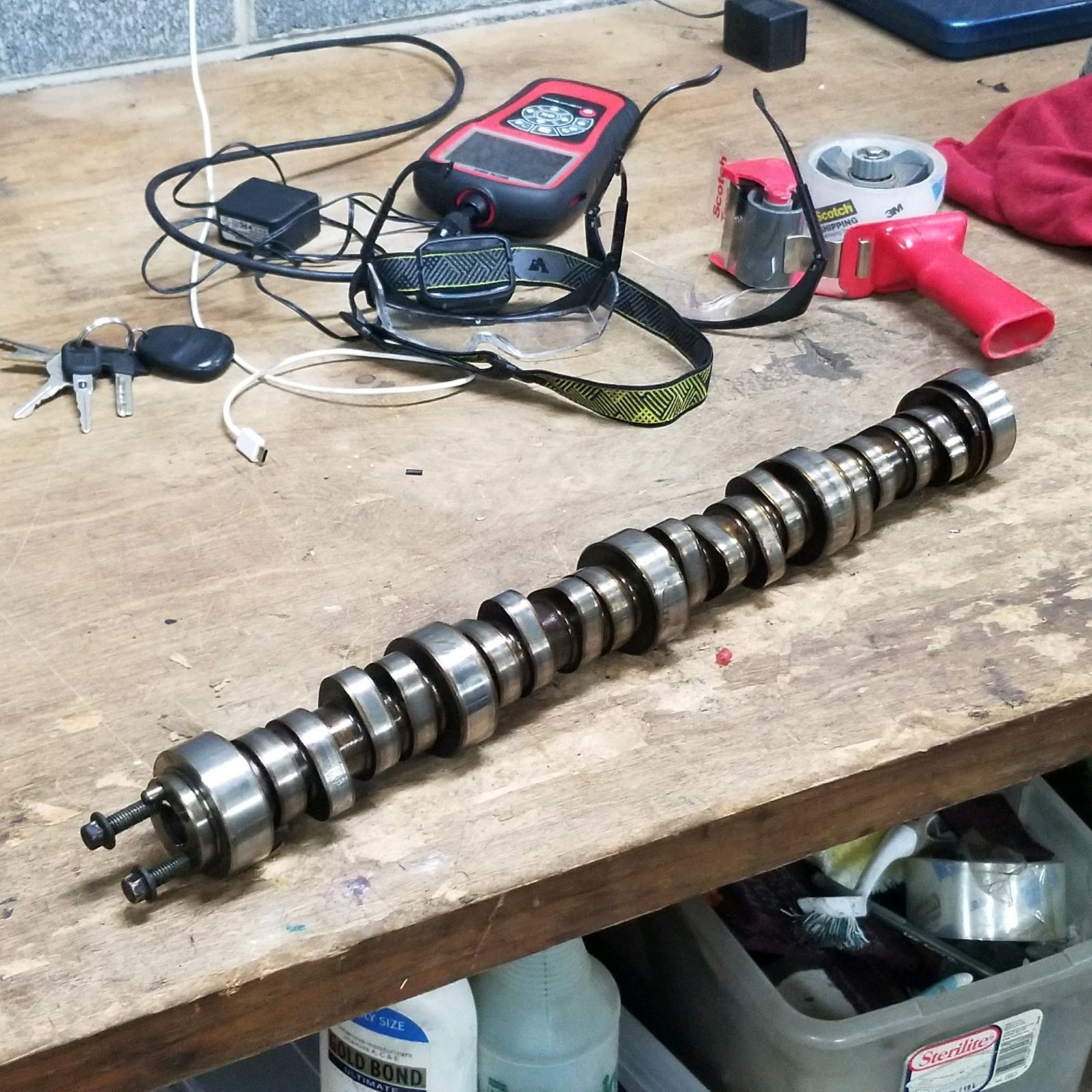

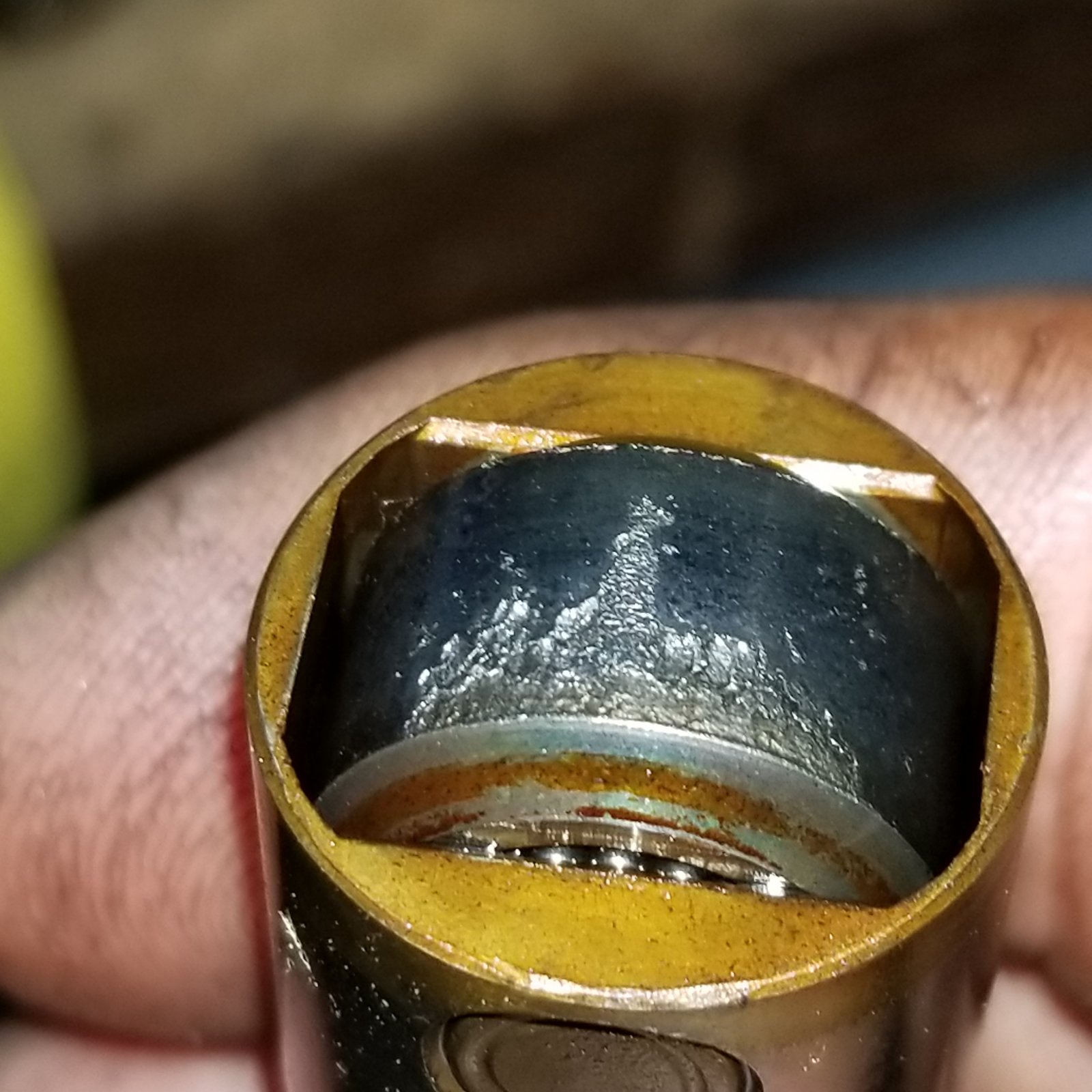

I had another post on misfire on #2 and I removed the passenger side head and the one of the lifters (towards front) appears to have turned 90 degrees and has ruined the lifter and the cam lobe.
I have drained oil last night and waiting for it to filter through the towel and look for metal particles. I did cut the oil filter open and I did have some small metal particles from the lifter in the paper pleats of the filter. I will look at the drain plug tonight and also the towel to look for metal particles. I have not pulled the oil pan yet to look at the screen or pan. Looking at the bottom of the valve of the bad lifter it does have some pitting and I am assuming that part of the metal exited through the exhaust port?
I have not removed the Driver side head yet. Looking from inside the passenger side head other than the cam lobe damaged on the #2 cylinder it looks normal wear. I was planning on using a boroscope and look inside the camshaft housing for damage.
Has anyone ever had a lifter collapse or turn like mine and have metal particles in the filter and if so did you have to do a complete rebuild?

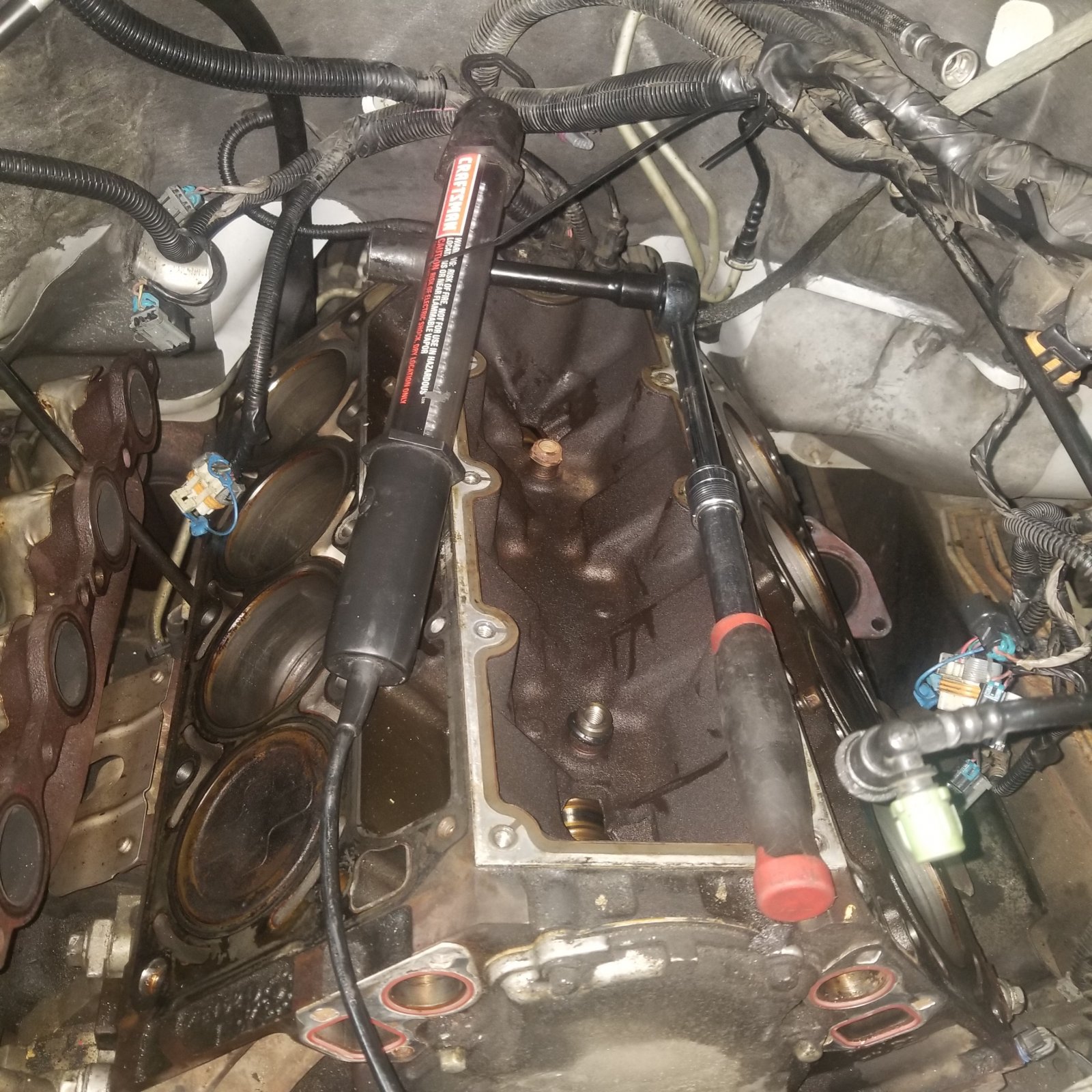

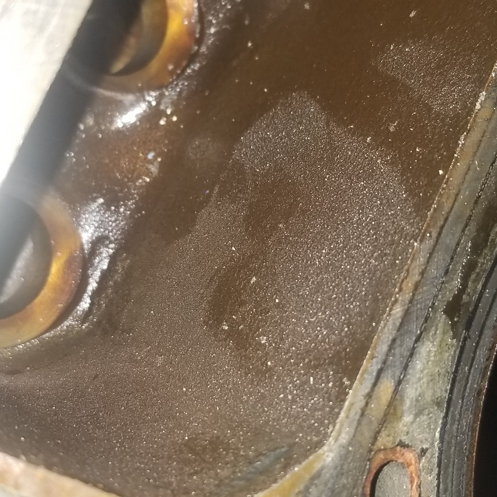

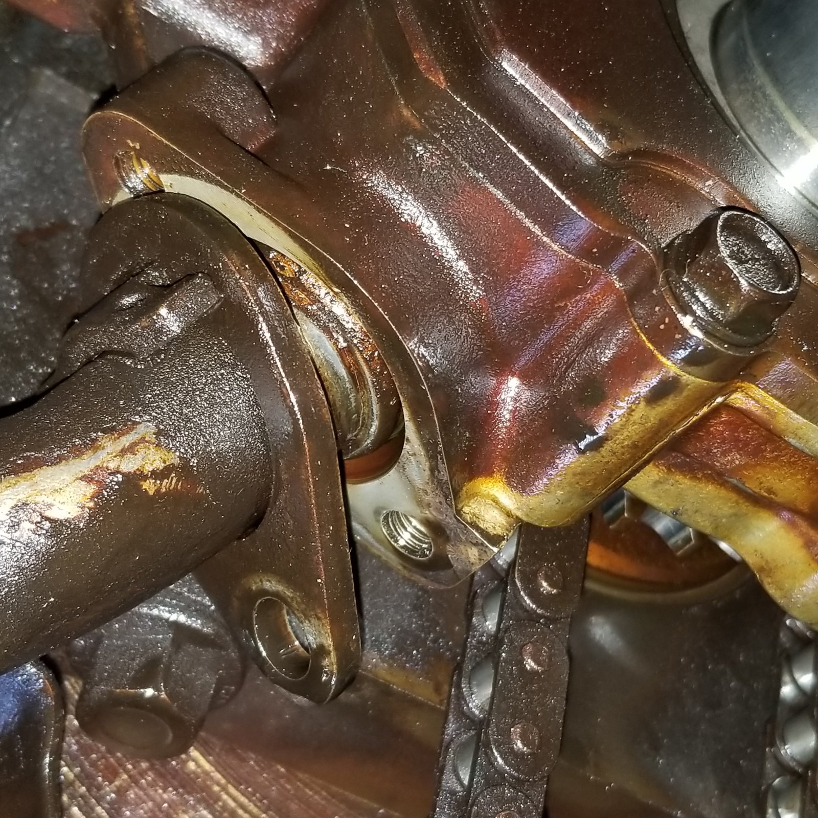

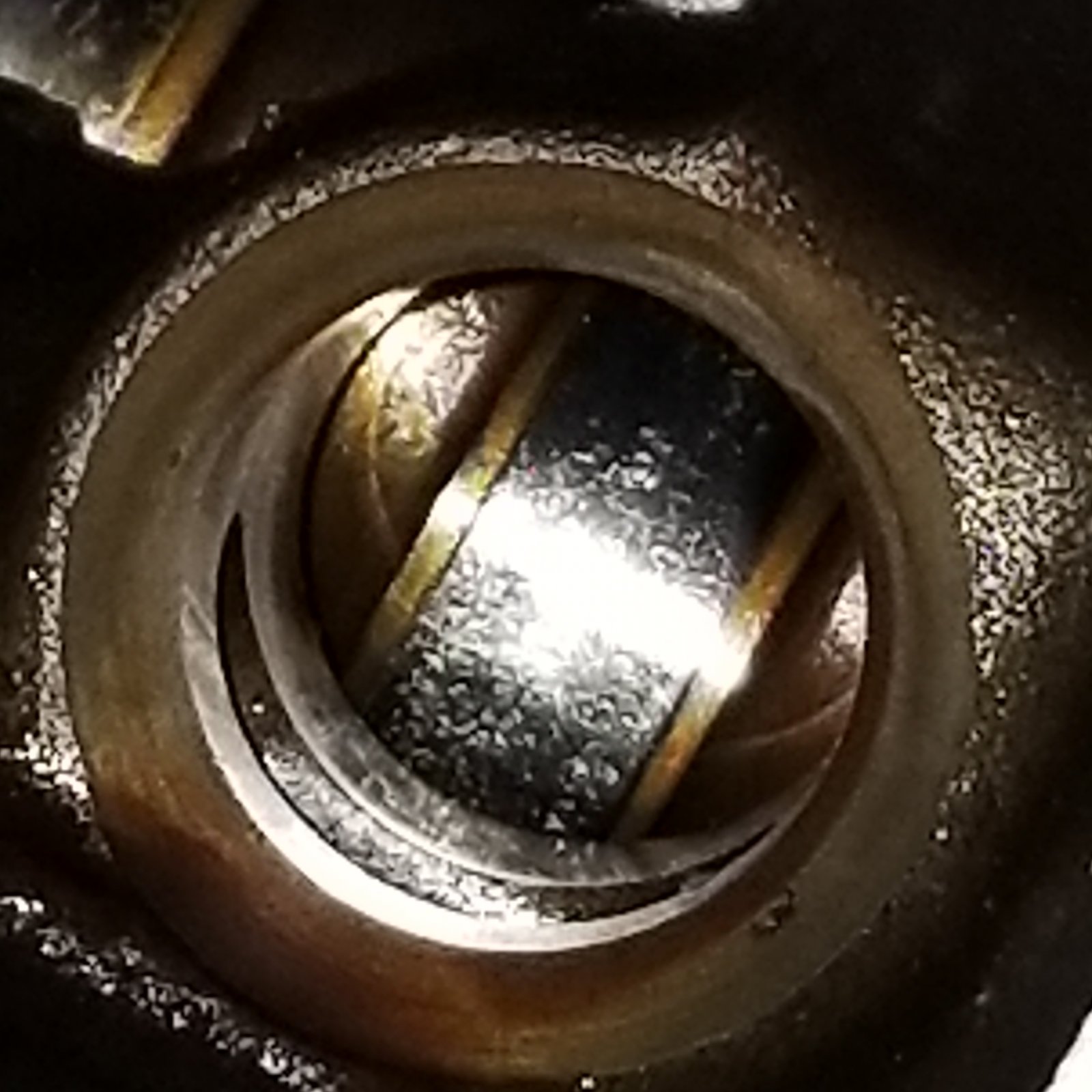

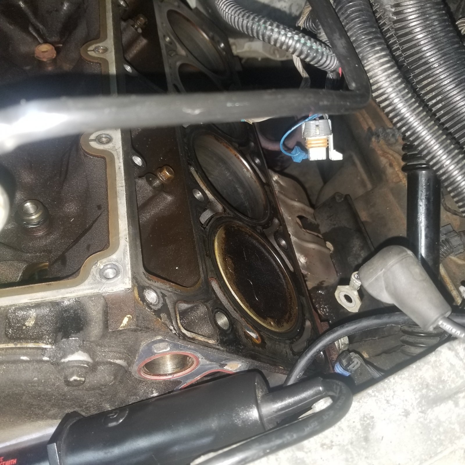

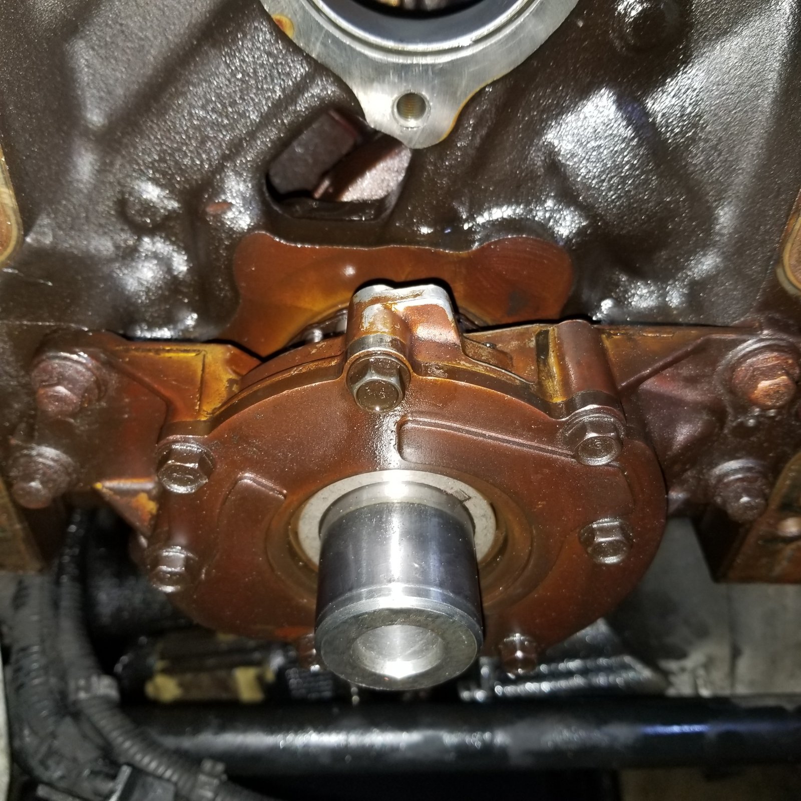

Here are some pictures heads removed. Machine shop said condition the Heads have normal wear and suggested the valve guides be replaced. Keeping it stock on cam and heads. Since I am going to all this work I might as well fix it right.
I have found two Gm dealers that sell gm oem parts at a considerable reduced price from list. Example cam list for $590. Dealership out west has it for $275 shipped. Something to keep in mind in reducing your parts/repairs cost..

Anyone have suggestion on proper way to clean the block surface that the heads bolt onto and gasket surfaces? Had seen some use a paper disc but am concerned with damaging the block surface.
Light steel wool and oil?

I am considering removing the motor from truck. Besides removing transmission bolts and three flywheel bolts is
it hard install engine back and align transmission??. I would have a helper working the lift.
stand and reassemble. Seems easier to assemble and sure everything is clean and timing cover and oil pan seal right.

I used a rag, a lot of carburetor cleaner as well as a lot of elbow grease to clean the block and careful use of a gasket scraper. I would shy away from steel wool as I would hate to have a small piece of wire shed off and cause issues. I would add a new timing chain tensioner to your list. Not very expensive, but with over 200K, cheap insurance.
As for removing the motor, your basically down to the short block so not a bad idea to pull it. With help, should t be too tough. You can get to your rear main seal that way and check it out/replace it.
