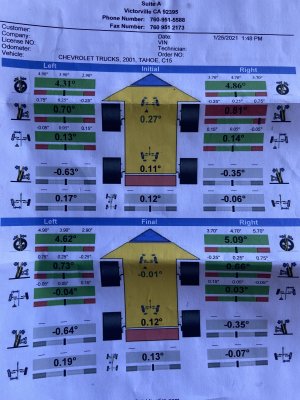

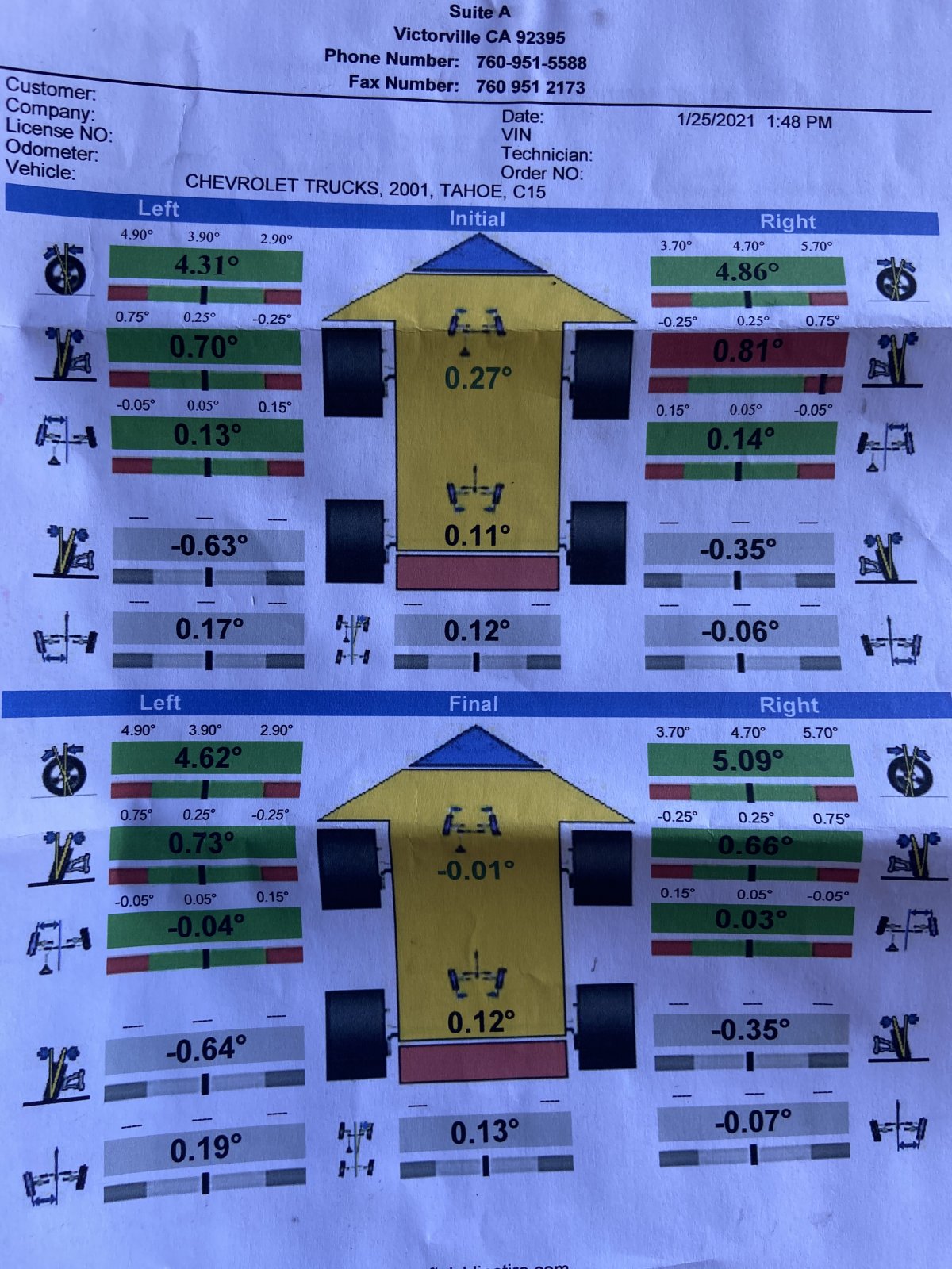

I bought it 2 years ago now, previous owner was the original owner. No accidents were on the record.
I’ve had the frame checked for any tweaks or damages and they said it had neither.
This is the most recent alignment I’ve received
