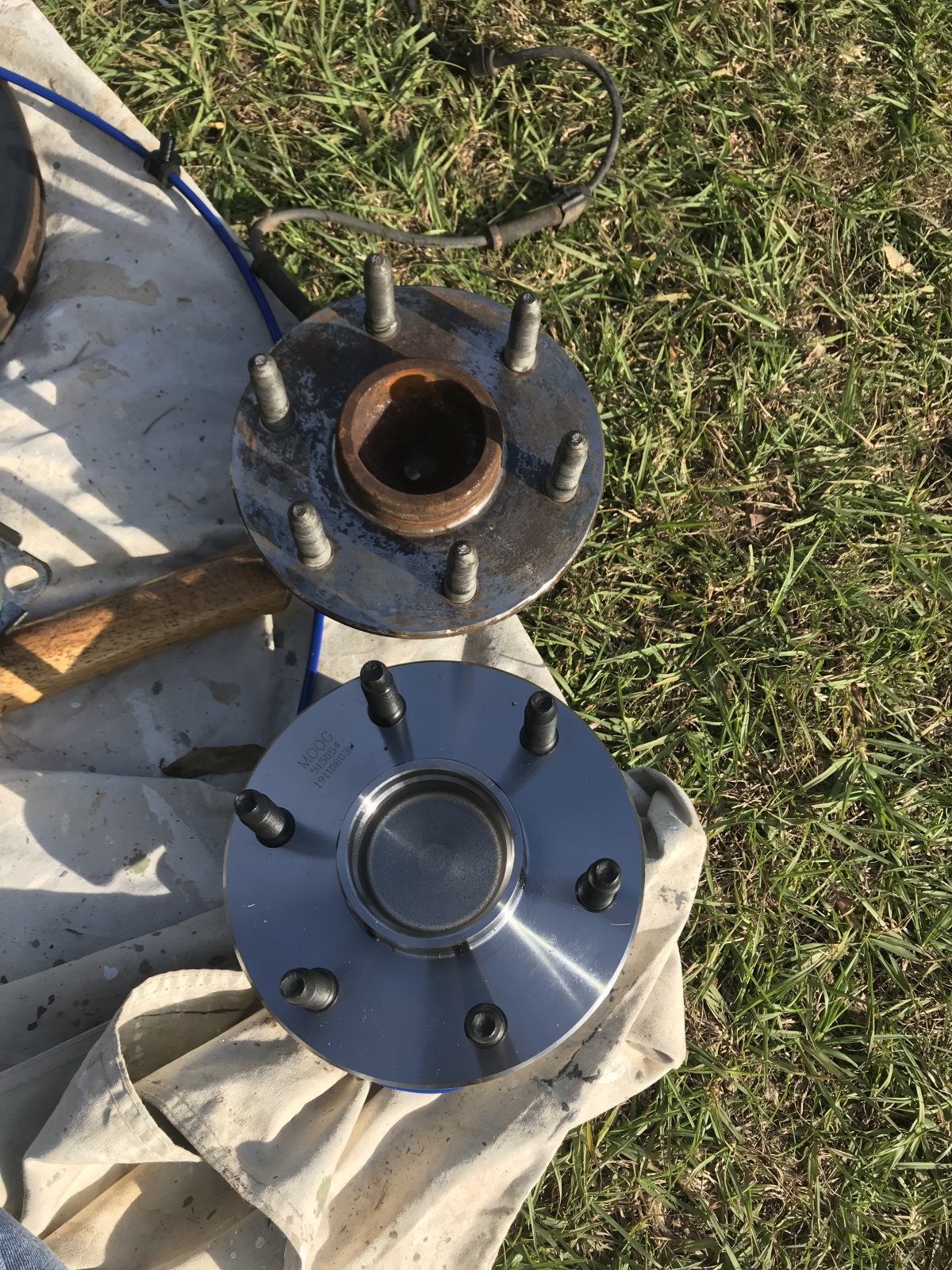

My Yukon starting doing the same thing out of nowhere. Was getting bad enough I didn't drive it much. I replaced the Idler arm and it helped some. I put new shocks on the front and it helped a little more but still would wander. Thought it might be the hubs/wheel bearings but they felt tight. I changed both front hubs anyway and put two new tires on it and it drives fine now. No wandering. Almost drives like a new truck again. I still need to change the Pitman arm since I bought one. Don't know if that would solve your problem but it did for mine. I do have 20x9 rims with 305/45-22"s on it.

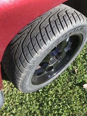

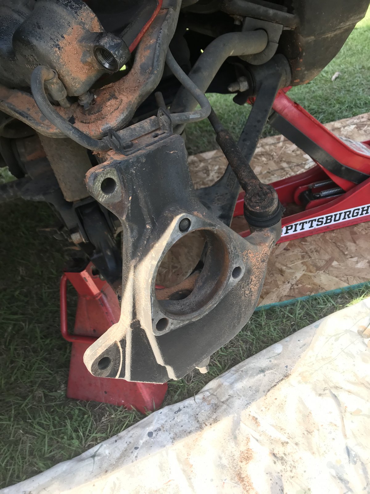

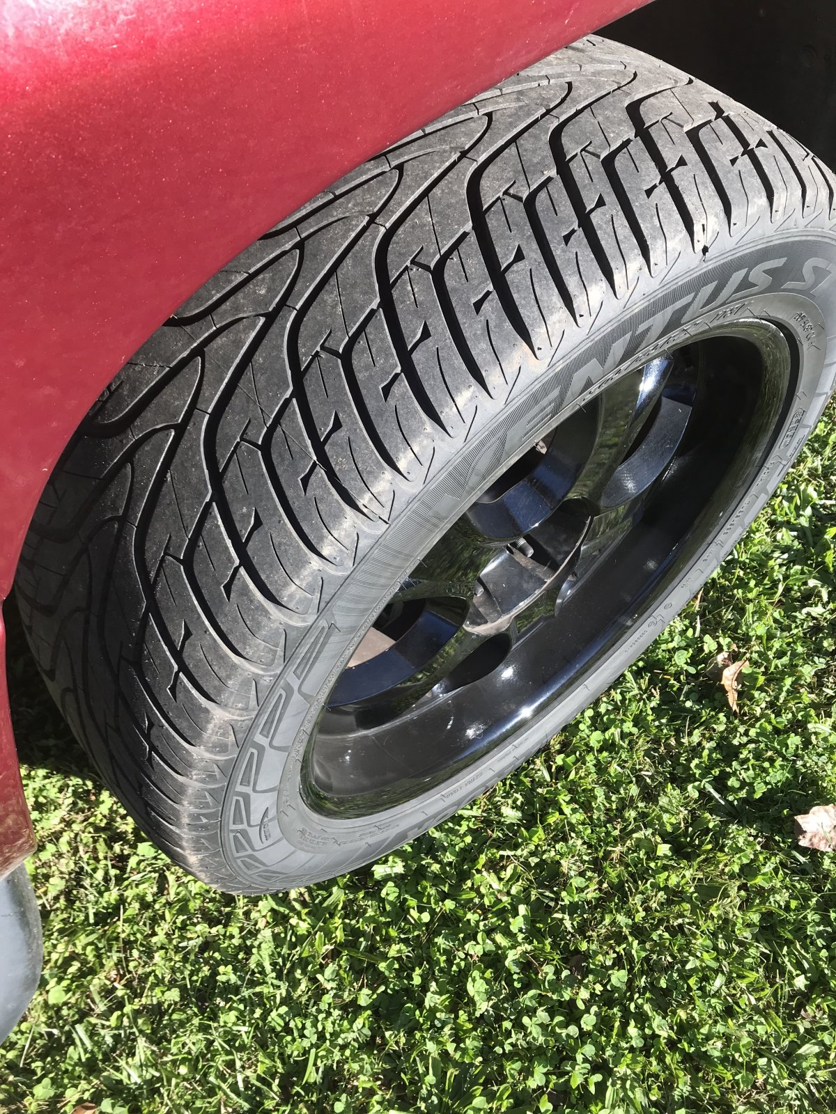

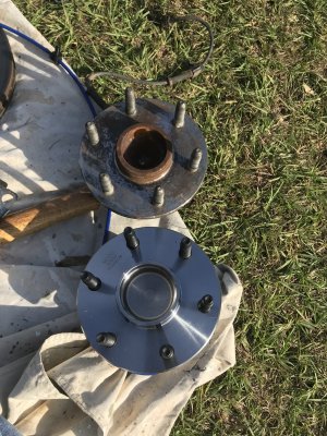

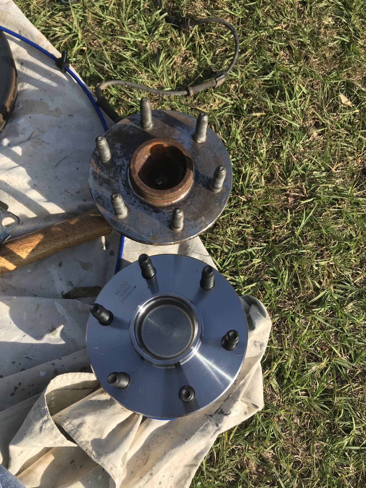

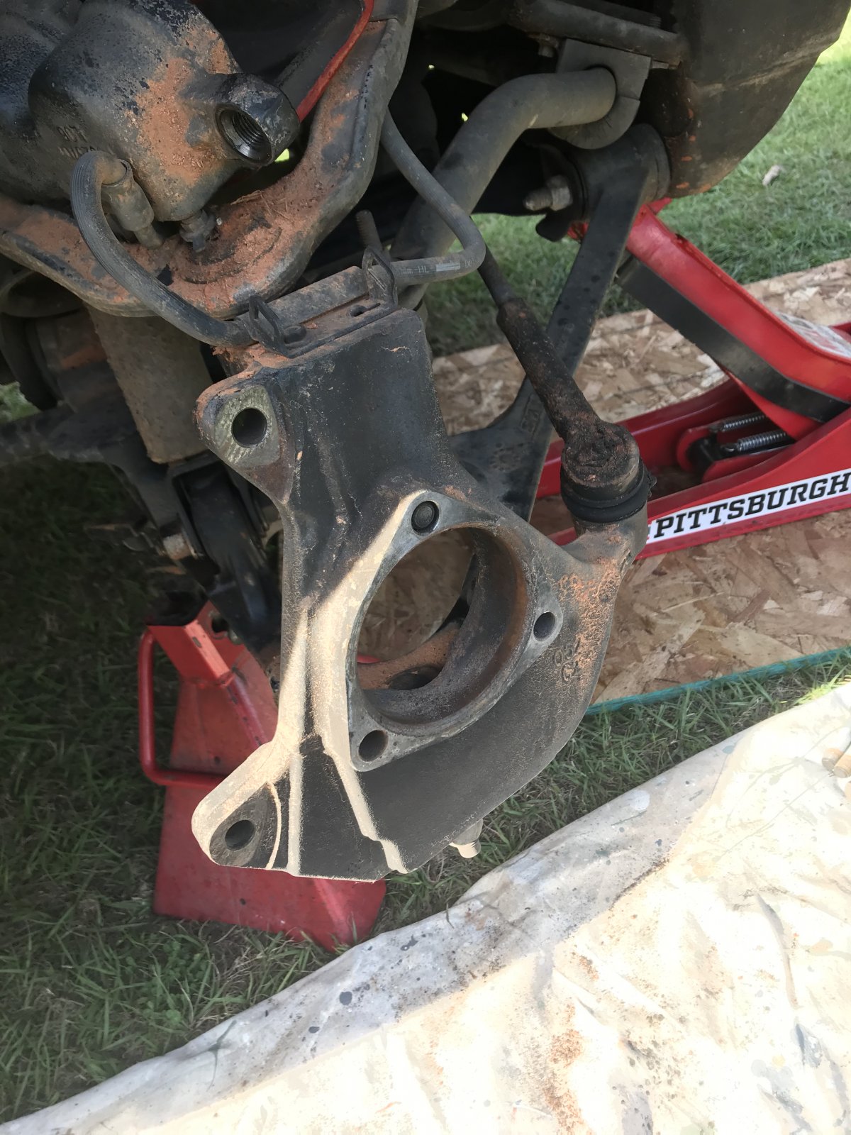

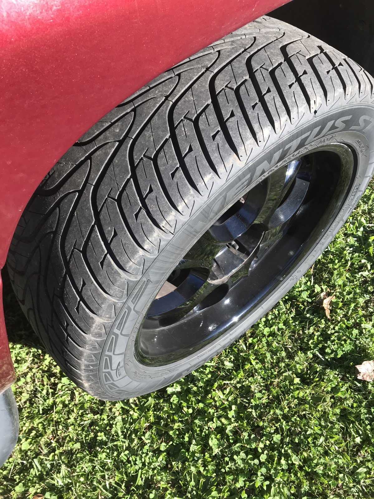

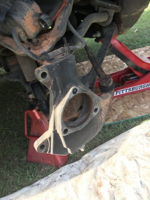

Mine drove fine for about a year and a half after I bought it. After I thought about it, it started to wander and sway a little and pull to the left some a few months back. It kept getting worse. You would be driving along and it would just start wandering around the road, then smooth out. almost would go into the oncoming lane. I thought it might be the Idler arm and pitman arm. Replaced the pitman arm. I then checked the hubs, right side was tight and the left was just a little loose. I went ahead and changed them and the tires and it hasn't did it since. My truck has 140,000 miles on it. Low miles for hubs to go but with the heavy rims and tires I'm sure it wore them out sooner.

@Battledrift69 Do you have aftermarket wheels? I had a set of 24x10 iroc replicas and my 2000 Tahoe wandered wherever the road would take me. Tires seemed good. Rims weren’t bent. They balanced fine. But no other set of wheels did that.

View attachment 271256 View attachment 271257 View attachment 271259
You post just gave me anxiety watching that jack stand in the grass lol. But I use recalled harbor freight stands. So who am I to judge

I get it. The jack stand was there as back up to the jack that was on wood. Could have sank some if the jack failed but under that grass is hard Clay. I'm out in the middle of no where Georgia.
