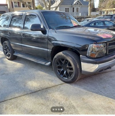

We bought this SUV and it was running at the time of purchase and afterwards too but now it isn’t. It won’t start. Also it hasn’t passed smog. Wondering if we should try to get it fixed or sell it.

Forgot pic so here it is.
