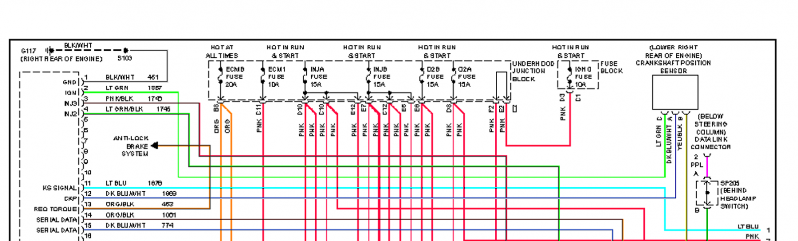

You are getting no spark, that it the problem. The anti-theft could certainly be it...
Start with the basics
- Ensure all the fuses and circuits that are responsible for spark are good
Would be good to print the wiring diagrams, and probe all the circuits and confirm voltage when Key is in RUN. Glancing at the wiring diagram there are a number of fuses/circuits that need to function to get spark to the injectors.
Check the output of all of the fuses below with Key in Run (not start/crank, just run), and ensure you are getting 12V
Thanks and I will! It’s raining here currently so I have to wait a little bit. I checked all fuses to make sure none on the ignition circuit were blown but I have not yet checked to make sure they have power. As there’s power on the pink wire on the coil packs I’m hoping it’s got sufficient power.
