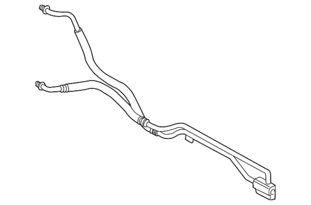

Hey All, new to the forums here with my new to me 2000 Yukon XL 2500. I brought this for some camping trips over the summer with my wife and dogs, but dealing with some issues after working with two mechanics to try and get the engine oil cooler lines replaced.
Basically, the mechanics (from two different shops) are saying the replacement part given by both their supplier and directly from GM will NOT FIT my vehicle. I've scoured youtube, researched parts supplier inventory by vehicle make/model/year, purchased AllData DIY access, bought service manuals with repair procedures, bought haynes/chilton manuals (not covered), verified RPO codes to make sure the oil cooler was factory.
In fact, the only people that I can find to tell me this is the wrong part are the local mechanics I'm trying to have install it. It's clear the OE spec was updated on this part # and the junction block is 100% of a slightly different shape, but I don't know what to tell the mechanic what to do other than to try harder, which seems unwise, coming from someone with no other experience.
Has anyone replaced the engine oil cooler hose assembly who could point me to install steps I could have my mechanic try? Has anyone run into the issue of needing a replacement part and hitting the same wall?
This is an exact drawing of the part that is shown in manuals and is on my truck right now:
This is the part that every website and dealer and supplier has given as a replacement:

2000 was a transitional year from gen 1 to 3 v8 engines. Which engine is in yours? 5.3, 6.0, 5.7L? May also want to have a look back at moidel year 99 for your hose set also and see if it macthes.
Thanks, the engine is the 6.0 LQ4. I have checked on the earlier generation as well. They lack the junction block that mounts to the side of the engine block and instead they mount to an oil filter adapter that itself mounts to the engine block.
I just got an update from the mechanic this morning saying that they have been working with the dealer and will need to modify the part. It looks like there are some notes on the updated replacement part:
"REFER TO 2002-SERVICE MANUAL FOR PROPER INSTALLATION PROCEDURE; FOR 2000 & PRIOR MAY REQUIRE MOVING THE ENGINE HEATER TO A DIFFERENT LOCATION; MAY BE REQ TO USE 1-15698443 CLIP & ADD A 6.95MM HOLE TO LWR SHROUD OR ORDER NEW SHROUD 15267487; w/ RPO Code AMS,KXL,KWN"
So, it looks like we're trying some of that for now.

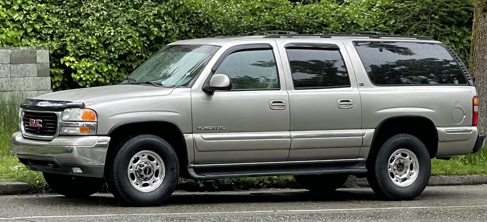

Since I haven’t driven the truck anywhere fun other than to mechanics, I can only offer my first picture I snapped when I parked it outside my house.
Here she is on a rainy Seattle afternoon. I’ve got the missing wheel cap in my mailbox now.

Alright, it’s time to bring this saga to a close. Final part selected and fitted was the standard part # 84828850 as recommended by GM, with no modifications needed.
The technician loosened an engine mount to get some additional clearance for the hose assembly to pass through and got it installed with a bit of finagling. This is all well covered on YouTube videos, but home mechanics and shop mechanics have different obligations and inclinations to make things work. Really happy this tech saw it through to the end for me.
