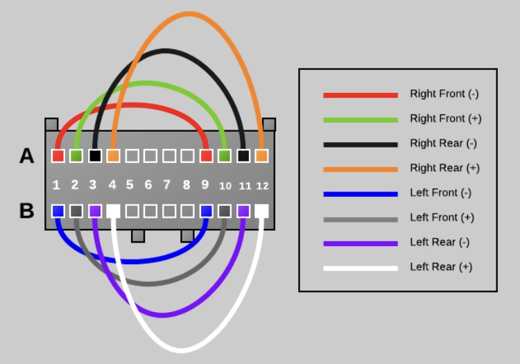

You can use the Metra 70-2021, it says for impala but you can use it on the tahoe.
The Impala adapter will clip in, but the wire routes are incorrect, so if you use the Impala bypass, you will need to reroute the wires like this...

I'm going to try the re-wired Impala bypass. Hoping that eliminates either the amp or stereo so I can get replacing the failed one and have tunes again !

I just tested with the Impala bypass, rewired and it corrected my issue. I bought it on Amazon, for like $10

I just tested with the Impala bypass, rewired and it corrected my issue. I have tunes again. I'm next going to take the factory amp apart to look for cold solder joints, etc before looking for a replacement factory amp as I want to keep the system stock.
Any one have any experience fixing an factory amp?
