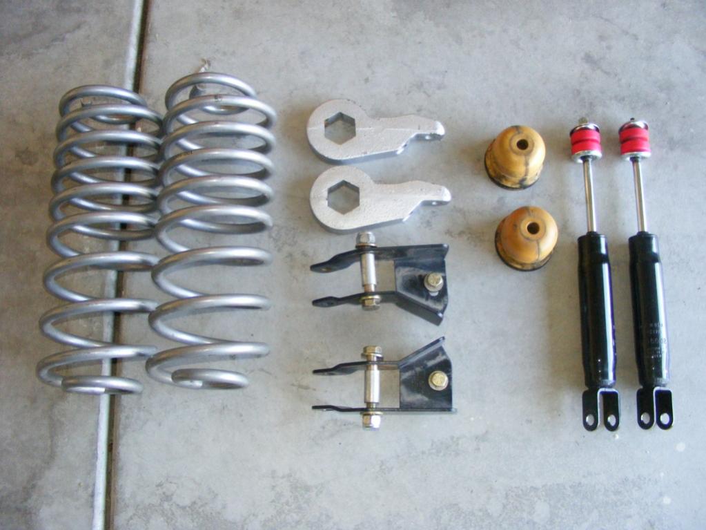

Hey guys, So I'm going to buy this Belltech 2/4 Drop kit from another member on here.. I need to make sure though before I buy it that its going to fit my ride. I have a 2000 Chevy Tahoe LT 5.3L. Below is the add for it and i attached the image of the kit. Does the kit need anything else to install it? I want to make sure it fits and is ready to go. Thanks for your help!!
Belltech 2/4 Drop Kit (5305) includes bump stops/springs/keys/shock extenders/front nitro shocks. Been on the truck about a month or so, shocks 1 week.

Do you guys think I would need to buy Rear Shocks? because it only comes with the front shocks. Also I was reading that it might look to low so I should install 1" spacers? Is that true, or is that what the bump stops in the kit are? Thanks for the responses!! I really appreciate the help!

No dude don't buy spacers, just intall it like that.
You could get new rear shocks but its not madatory as I see you have shock extenders fro the stock ones in the kit.

Install it......drive it......align it......let it settle in....then look at your 4 corner heights
yes, get the shocks, if you have the factory big black shocks, it won't lower completely without them.
