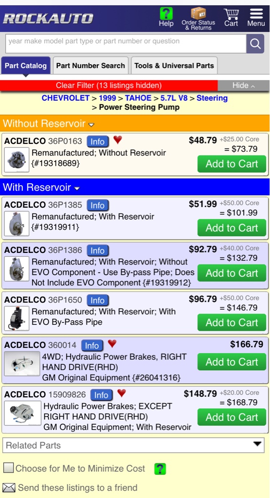

I just read a LOT of reviews given,..on autozone power steering pumps. APPARENLY there's not a cold chance in hell I am going to use this one,..or any other one from autozone,. I didn't know their PSPump reviews were so bad. And I see on amazon it appears they are selling NEW OEM AC DELCO pumps....that are not new but actually remanufactured and not really a direct fit in many instances. Do I trust NAPA? THis took wayyyyy too long to get out for me to ever want to do it again. Where should I go? I am guessing Oreilly's is the same crap as autozone?
I am so surprised that I don't trust Amazon on this one. But I don't.
