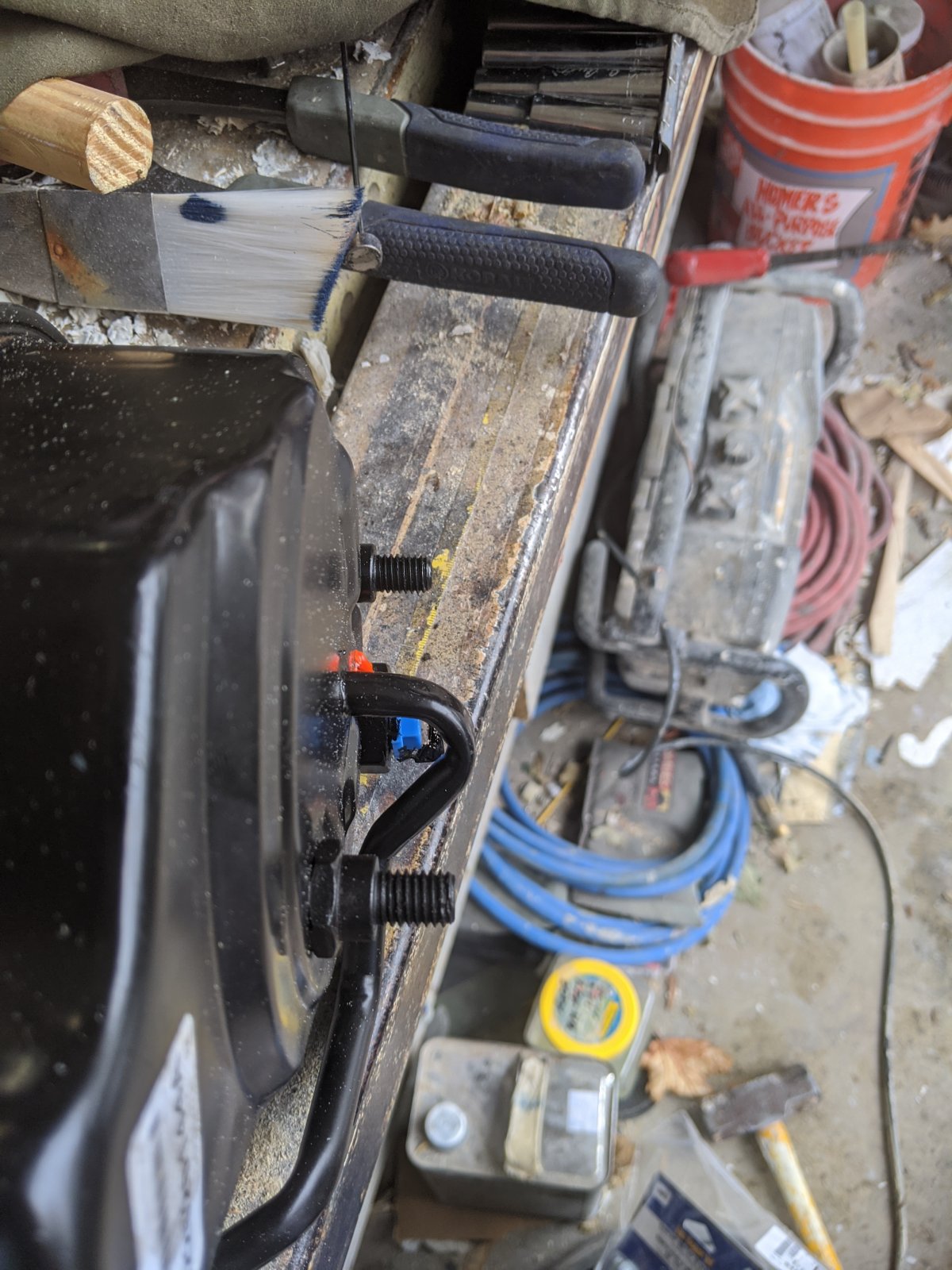

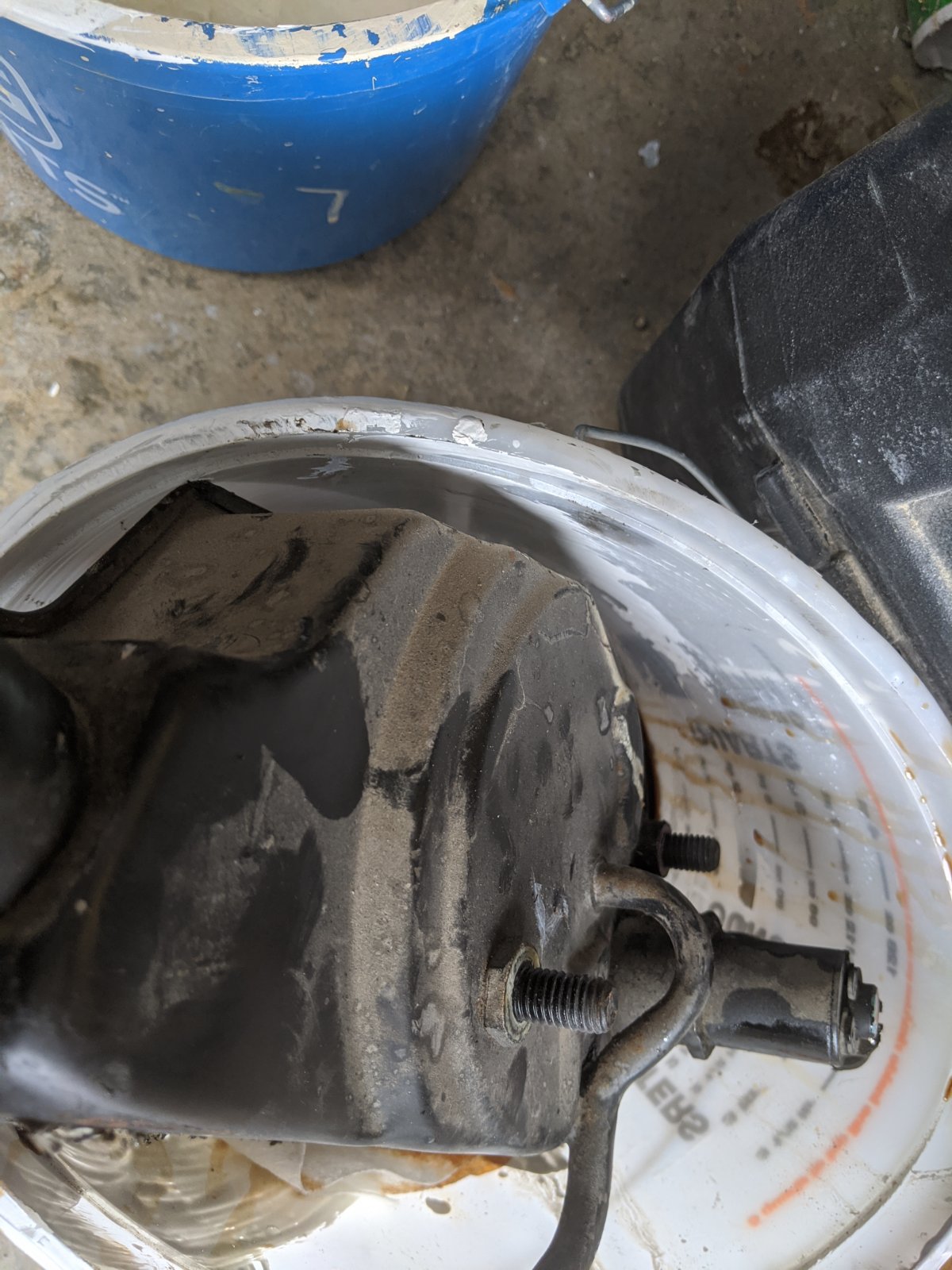

I got some help from my kids. Here are two pics. One of the old power steering and one of the new. See the shoulder on the stud? that shoulder is not on the old one. ANd it does affect the back bracket alignment, but I am not so sure it would do anything to the alignment of the front shaft once it's installed.

I thought I just uploaded 2 pics. Now they are gone. Here they are again,. They show the new pump having a shoulder where the old one doesnt (top bracket stud). I'm not sure I should drill the bracket to fit over the shoulder. But nobody is at autozone today for me to go see if they've got a correct one.

Like spacers? And it won't fit int he bracket?

View attachment 235056 View attachment 235057
Maybe you can swap the studs over?

It will fit, but the shoulder prevents it from going the last 3/16 of an inch... So I'm scratching my head over what they were thinking. HOWEVER,..the 4 main bolts that bolt the power steering pump in,..they will hold the unit so the shaft is perpendicular to the belt,..I am beginning to think I might just drill that bracket out so I can quit worrying about it. I can't see how it affects anything if I drill that out,...UNLESS,..I get another pump someday and it is the "correct" one without the shoulder (that shouldn't have been on this one)..then I will be a bit irritated.
