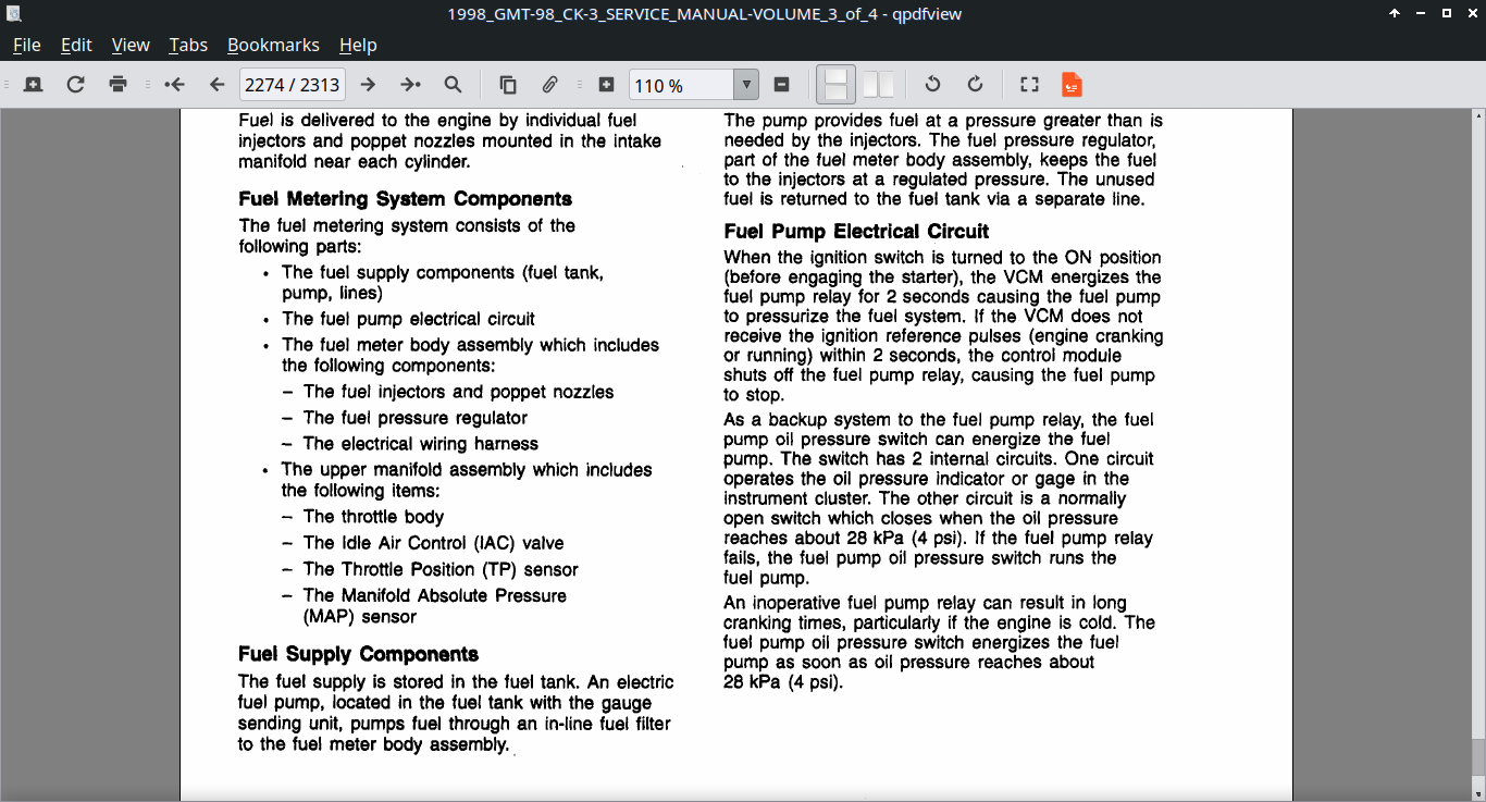

You are on the right track focusing on fuel, given the symptoms presented. Fuel pressure on these should be 61-62 minimum.
Test your oil pressure sender as it is in the circuit to fuel pump and a normal failure after 100k miles.

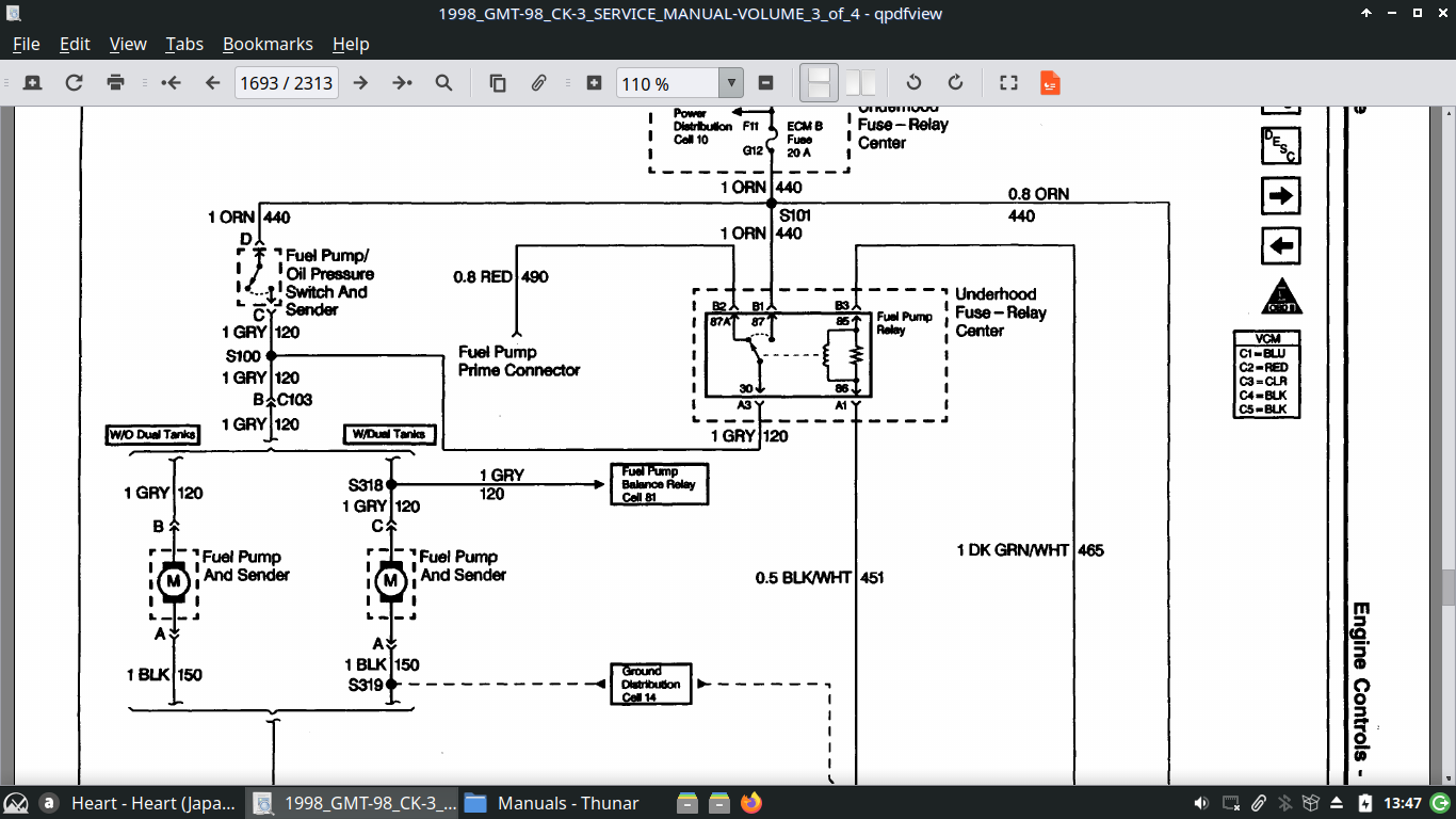

Here’s the wiring diagram. With a meter, check for voltage at the relay terminal coming from the fuse (87) and also the VCM relay control (85). Check using the relay’s ground (86) and if you get no voltage use the chassis for ground.
Grounds G103 and G104 are at the thermostat neck bolt and at the back of the right cylinder head. See how those look. The pump ground (G404) is somewhere by the tank on the top of the frame rail.

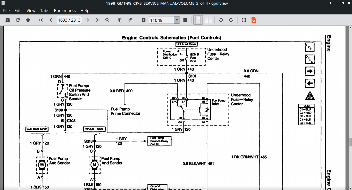

A few more 98 pages that may help-

Hey,
What page was that diagram with the oil pressure switch? I looked all over my manual (1998 2nd edition) and couldn’t find it but knew that I’d seen it somewhere before.
exp500
May 14, 2017
1,894
1,776
Hey,
page 6-1677 vol3 . It really depends where your manual is from.... Some pages are left out or not considered in that type. Only difference I noticed between trucks & Suv fuel was dual tanks or 6.5 Diesel. Hope this helps.
