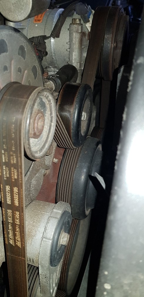

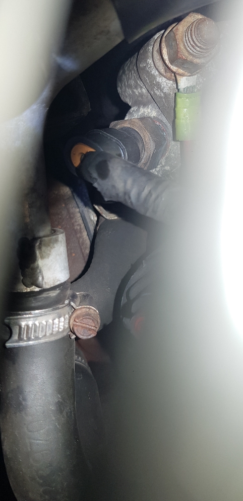

Has cooled enough to de pressurize the rad so will keep an eye on it. Rad is full and clear,well green and clean.
Not much room to showcase my photography skills but can you make out the gasket and back plat on the pump?

Weep hole is on the bottom of the water pump. Just slide your ass under there with a flashlight. Look for the wet spot--lol--or green or rusty residue.
Will have a look now. Cant really see much past the balancer. Will get in my favorite position now.
Under her! Haha [emoji6]

Yeah cant see dich under there. Wee bit of glisten on the bolts holding inspection plate on the back of the pump. Will have a wipe up and have another look later
Thanks for your help old boy [emoji16]

Usually, they start to leak when they need replaced. I'd say thats your culprit
Yes I think so too. All I've had to do for the last couple of years is oil,filter and coolant so it's been a good run while it lasted.[emoji106]
So when I do the pump I'll do a new serpentine belt,thermostat, bottom hose.
I dont do a lot of miles but it will be good to flush the system and get new fluid in there.
Lol I might do plugs n wires as well.

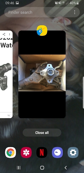

Just looking at water pumps to see what is around. There are a few available options in the country,the most expensive being an edelbrock for $695.00 the others are $95.00-$230.00 ish
Was just having a look at the yukon to see if it is the same as an ac delco cast pump I've found on a local trade site. Looks the same. Not sure if I'm short or long tho so need to work that out.

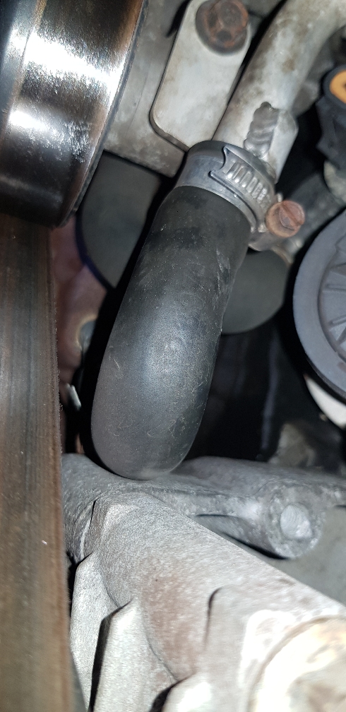

Anyway just looking at it and I can see a small pool of water in the v of the block under the thermostat housing. May not be pump?
Could it be the valley gasket? I recently decreased top end of the motor but I can see moisture in the crevice between valley and rocker cover. No oil in the water and is cooling well.
Going for a long drive tomorrow so will check when I get there and when I get back as any moisture should evaporate off the block. Then check again when it's cold to see if wee pool on block again. [emoji849]

Those are bad for the intake gaskets to leak. That's definitely a possibility
I had heard that.Prone to Injection problems around 200k also.[emoji849]
When I 1st got it my thoughts were to dump the factory injection,install an edelbrock performer vortec manifold and do a 4bbl injected carb along with Hei ignition and a wee cam n headers.[emoji41]
I'm a long way off doing that and tbh I've been pretty happy with how it performs this far![emoji106]
Is the word Stop Leak Additive a bad word in the short term [emoji37]

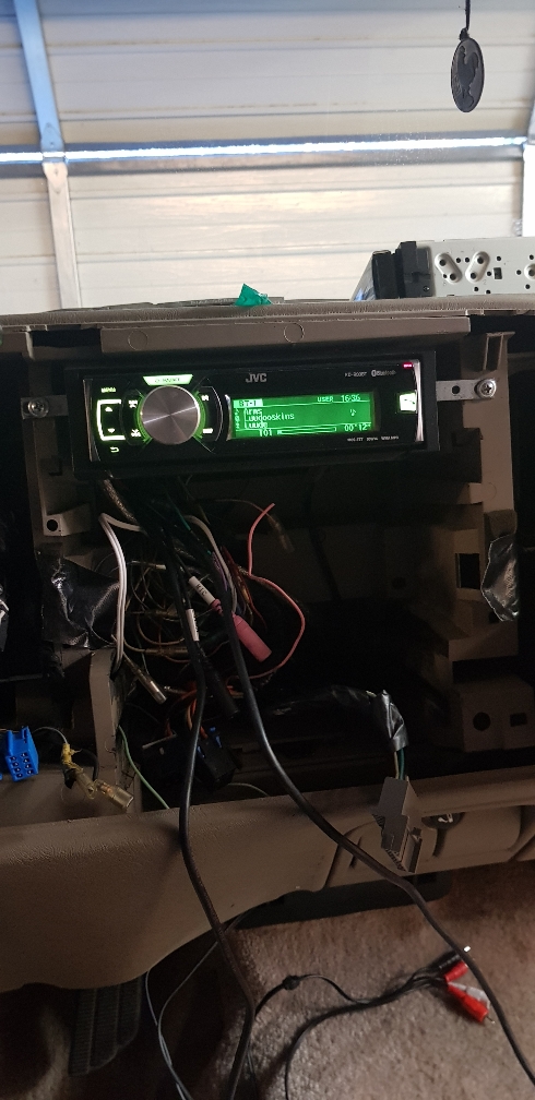

Finally going to put my bluetooth head unit in now! Totally sick of trying to message and take pics for photo spotters thread while fone plugged into stereo with 3.5mm jack!! [emoji13]
Freedom!!

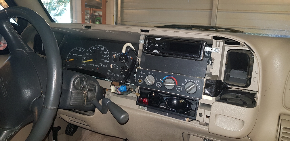

Couldn't wait to put dash back together before firing it up,much better sound on this hu.
Have hooked another rca cable to the back so I can add another amp to run some more speakers while it's in bits

And we have a winner!! [emoji106] [emoji849]It is the valley gasket. Water pump is allgood
Went out for a drive in the country. Yukon went very well.
@80 mph it was pulling 30psi on the oil pressure gauge and water temp sat comfortably in the middle just under the thick bar between 100 & 210. So what's that 150-155°f?
Got home and let it cool for a few hours and checked the manifold and wee pool back again in the v beneath the thermostat housing and on a sheet of cardboard I sat under the front of the engine.
You tube got a hiding and was about what I thought I'd have to do.
Called my mechanic and he quoted me $250-300 to do the job in 3 hours so I reckon he can do it. Would take me all day and I'd be wrenching the whole job.
Not scared to do it but would be good to get a professional opinion on the condition of the motor as he is into his American V8s
Will find a gasket and book it in.[emoji106]

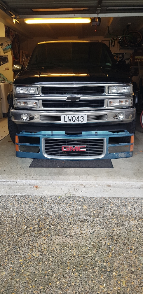

Oh Shit!!!
Look what just turned up!
Won an auction for this months ago and the guy selling it never got back to me about shipping so I just moved on and repaired n painted the Tahoe grill.
This needs a couple of repairs,a good clean and then a color change to my ever favourite color. You guessed it! Black
Sent from my SM-G950F using Tapatalk
