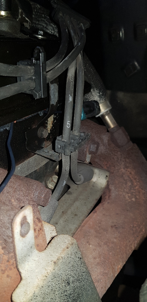

Okay so the Yukon now has new valley gasket. Noticed on the way home tho,no temp gauge.
Found the cause,temp sensor wire has been pinched up in the rocker cover as it was reattached [emoji849] will see if I can get that out & repair it without starting an oil leak from the rocker cover.
Also notice throttle body accelerator cable mount not secured properly. 2 jobs to do.
Am happy otherwise. It was the 1st time he had done one with this injection set up and took him over 8hrs,only charged me 4.5 hrs and dropped $50 off so I can forgive 1 or 2 things. [emoji106]

Alrighty!! Solved the couple of issues with the great work the mechanic did. [emoji122][emoji122][emoji122][emoji122]
Ended up being about 6 things I had to change or connect. Got a bit grumpy and broke the purge line into 3 trying to get it back under the aircon housing as it was put back as an afterthought during reassembly. Brittle this old stuff ay!

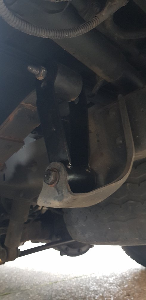

While I was in the mood I thought I'd do a feel good job and install the 2" lowering shackles. Easiest job I've done yet!!
Will go for a drive and see how it settles.
Think it is just about bang on level! [emoji2937][emoji41]

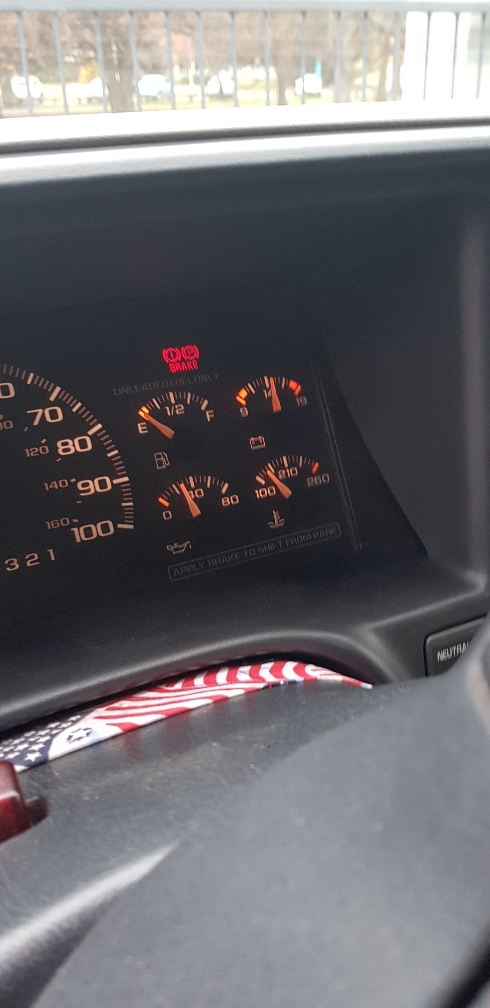

What's up with your brakes? The light is on.
97YukonNZ
97YukonNZ
Feb 12, 2021
1,489
4,193
Yeah the whole lot lights up when it is in park with the park brake on goes out when you release the brake Tony [emoji6].
Not on while driving[emoji111][emoji106][emoji106]

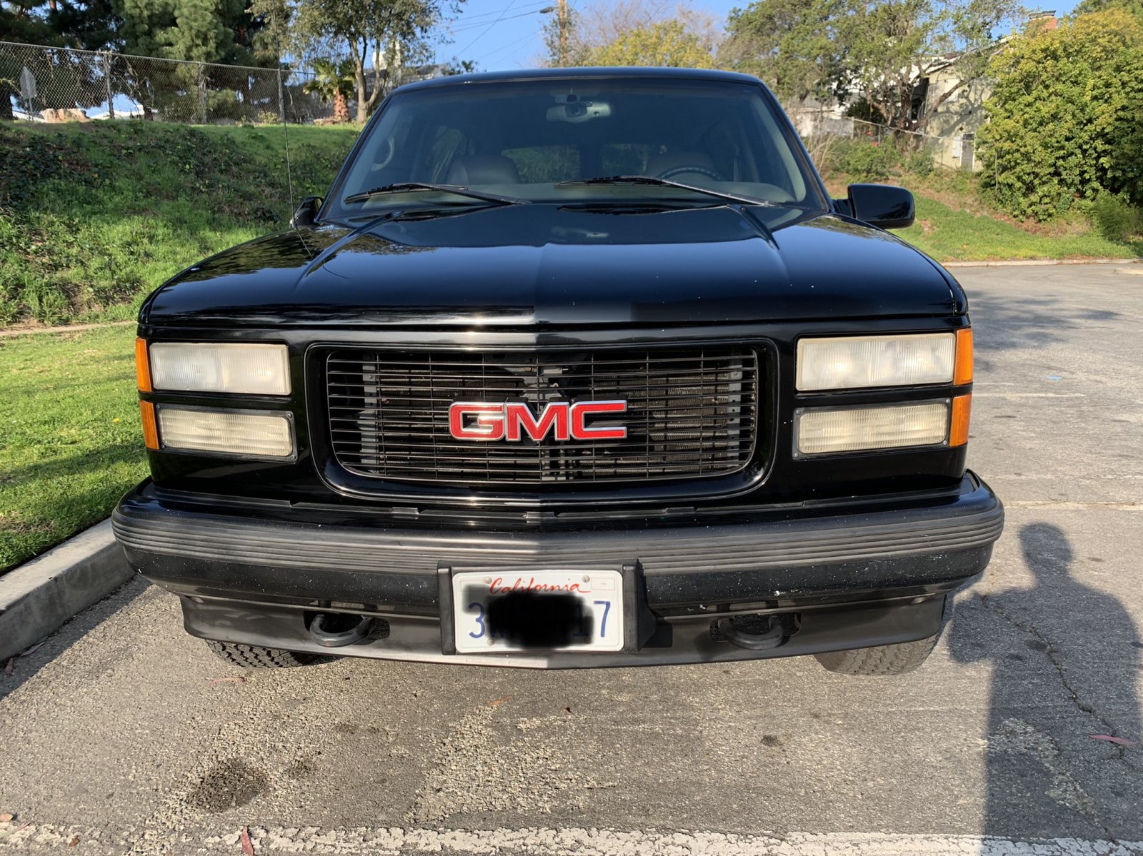

Hey I've just found a pic of a 97 2door grill from earlier this year.
This is kinda what mine will look. Mine will have chrome surround inset and gloss black around the red GMC. Matte black inset/gloss black outer.
Fosscore
Apr 16, 2014
10,855
19,701
Should look good.
Reminds of my brother’s red 1995 2 door Yukon 4x4.

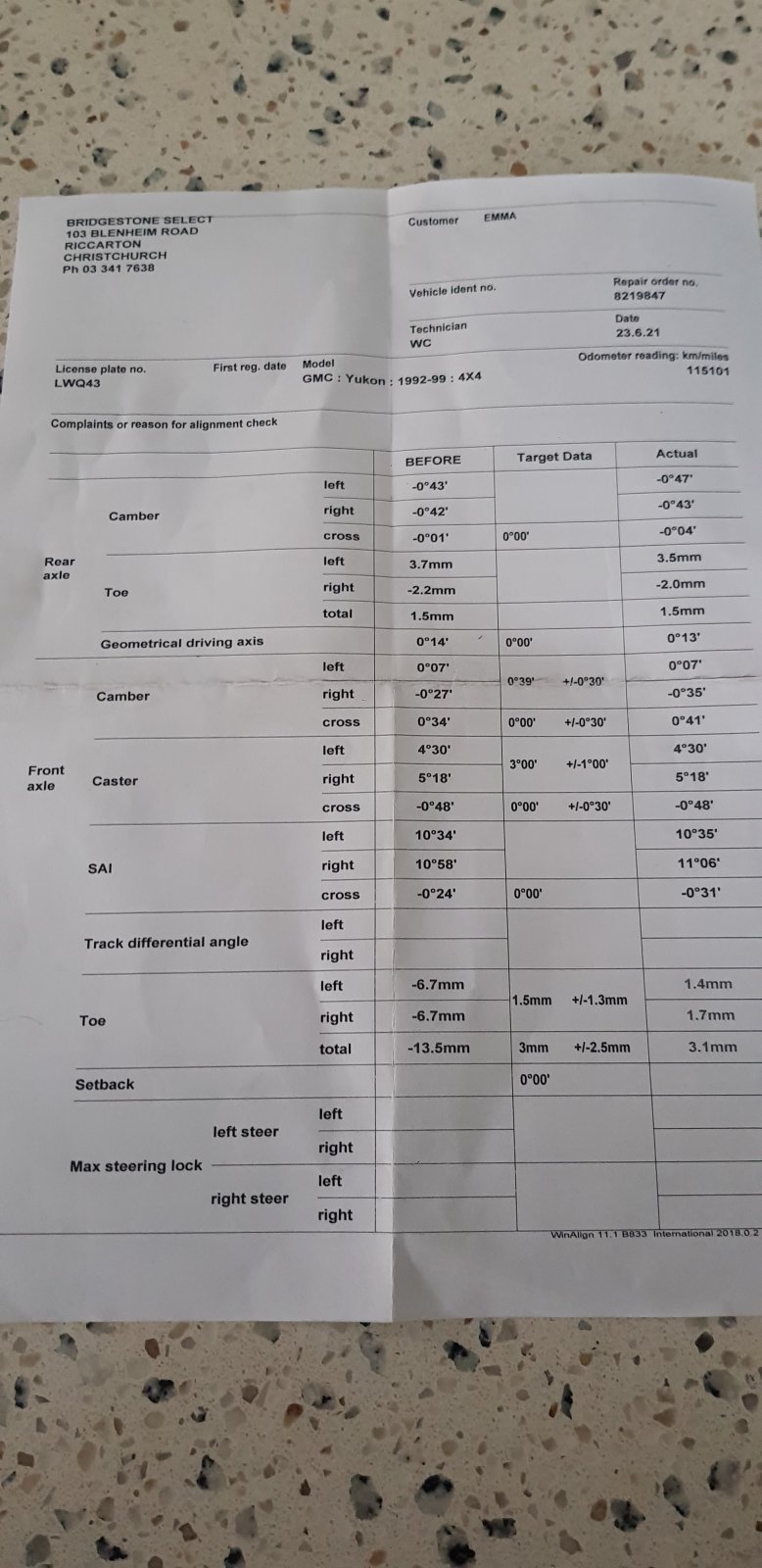

The boss had a couple of free wheel alignment vouchers he needed to use up so we took his van and the Yukon down and got a Free alignment.
This is how it came back. They had to measure the beast up to make sure it would fit on operating table! Then had to adjust all of the parameters. As you can see alignment was way out. Camber still is. Apparently I need some eccentric bolts to adjust the camber correctly. I had wound it down 1" so maybe that could have made all the difference.
Anyway is a huge improvement from me replacing a steering tie rod and just eye ******* it until now.

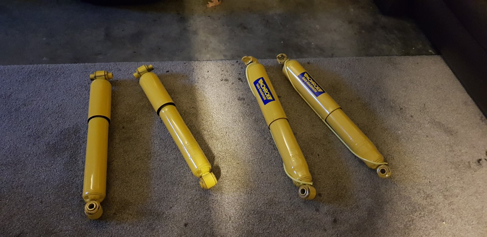

New shocks are in the country since the 14th but stuck in customs so hopefully I get them soon.
Cant wait!!!
The old ones are like rubber bands
