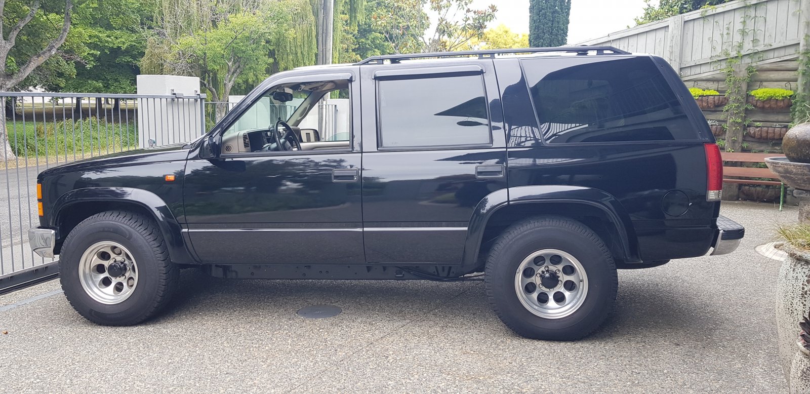

Here we are. Just pulled her out of the cave.
Bit of a rake but okay for now as is empty of petrol and no load in the rear.
Keep in mind I am going to refit stock body mounts as currently on 2" lift and am going to drop 2" by changing from 285 x 75 x 16 to 265 x 70 x 16 tyre. After that I will revisit the rake and maybe get the leaves leveled.
Will probably unbolt rear jounce stops and fix a new stop to the frame.
Very happy with this small change.

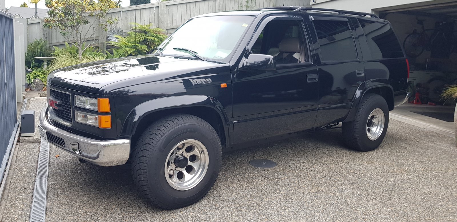

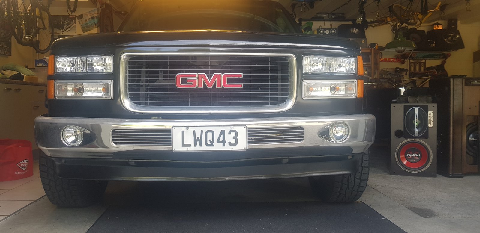

And check her out!! Just picked her up from the tyre shop. What a change! Both in look and drive. Is 5"s lower now but kinda looks the same with the lower profile tyre. Loving it!!!

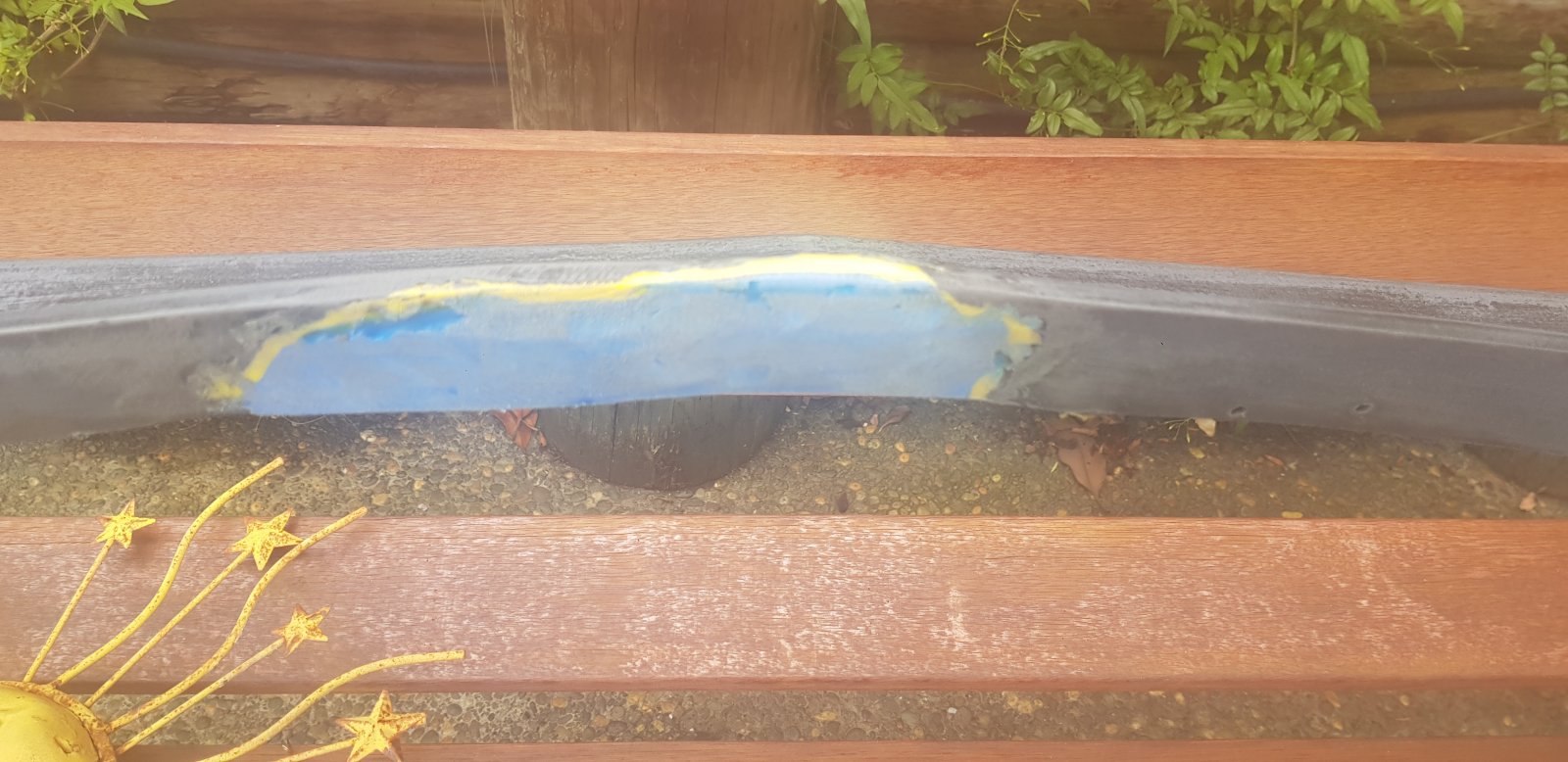

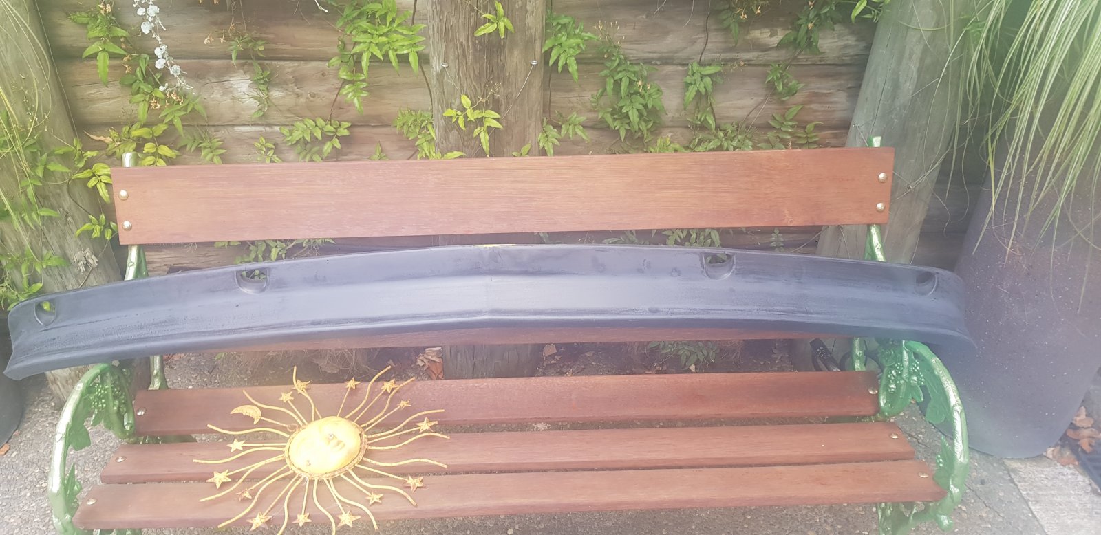

A buddy has had my front air dam for a couple of months since a 4x4 trip that I broke and cracked it.
He does a bit of plastic welding and offered to fix it for me.
Just finished giving it a sand and threw some paint at it.
Is a quick dry paint so will let be for a while and then I'll get it back in place.
