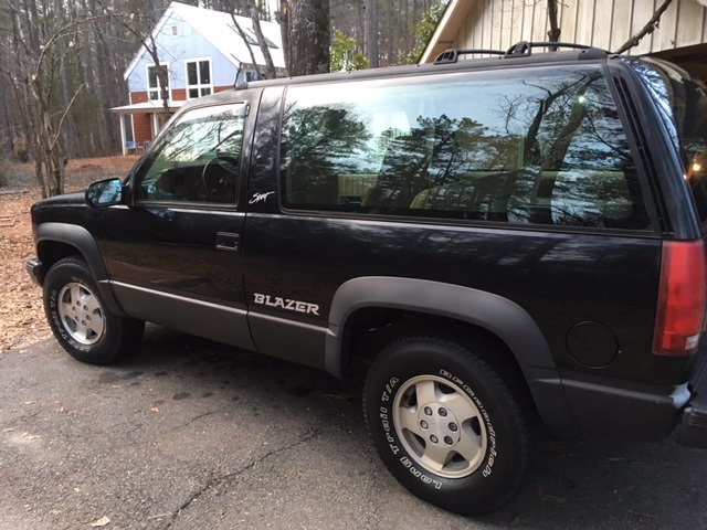

I recently bought this vehicle.
Had a couple rare options - factory bench seat and five speed manual.
It did not come with keyless entry although it does have power locks. Can a factory setup be added?

John:welcome: to the forum an congrats on a nice looking Blazer. As for your locks look under the steering column @ the lower dash, there should be a square plug access port. I believe there are 12 pins, use a paper clip and jump from # 4 to # 8 , the doors locks will lock/unlock @ that time, which confirms the program mode when you program a new remote. Call this # for information 1-866-690-9308 on key fob. Hope this helps , more pics of that nice Blazer..........awesome.

From what I understand, keyless entry was not an option until the 95 models. Those had RPO code AU0 on the glovebox label.
Nice looking Blazer, by the way.
