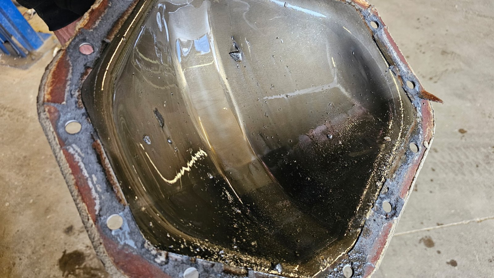

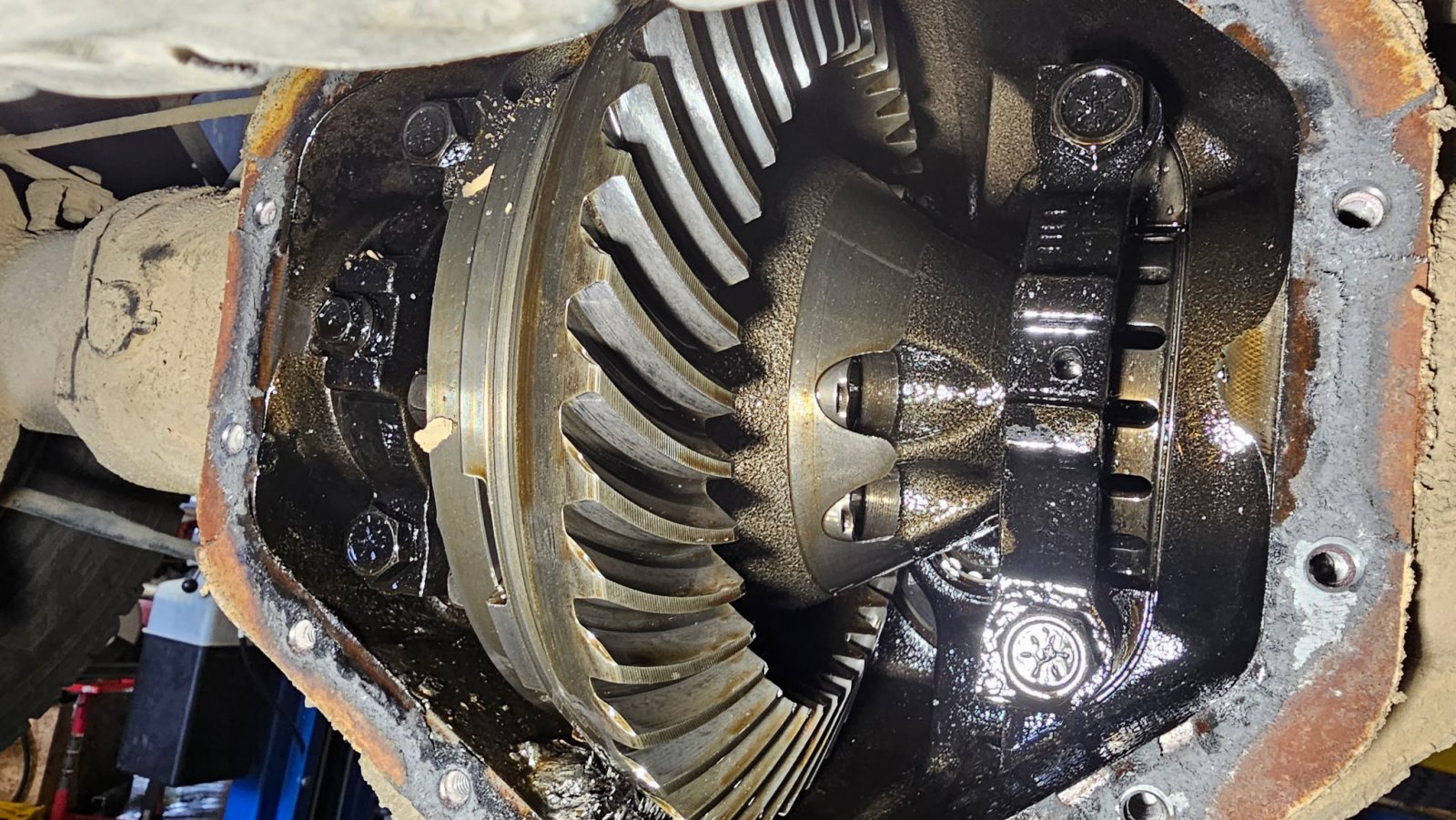

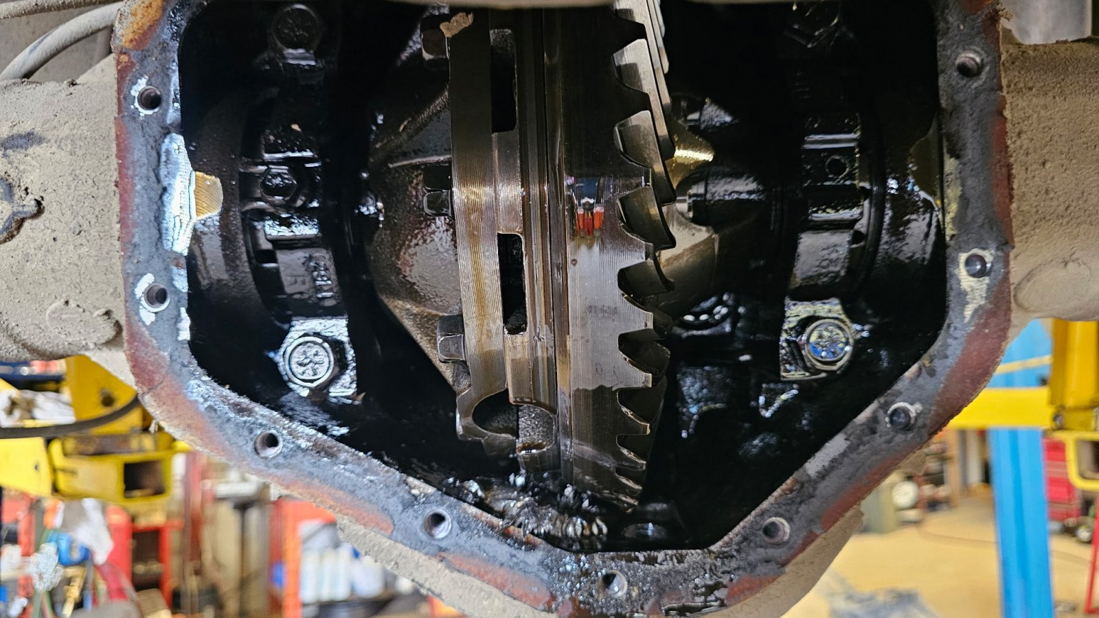

I am still piecing together how this happened to a ~30,000 mile axle. No leaks. Not low on fluid.
Please look at the pictures above. One of my axle adjusters (for the carrier) is missing the hold down bolt. I am thinking my axle issue is similar to yours.

Yikes! That's pretty bad.
If all that's have to be done is reweld the spring perches, that's definitely not a deal breaker, even if you have to get a welding shop to do that for you? Can you weld or have a buddy that can?

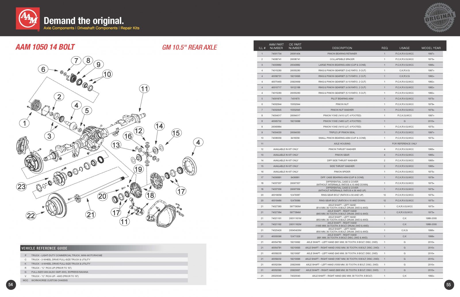

You are most welcome. Found THIS one.... maybe not a huge savings but may be a consideration. Their # is 888-752-1118
21,315
30,312
chrome-extension://efaidnbmnnnibpcajpcglclefindmkaj/https://aamaftermarket.s3.amazonaws.com/resources/pdf/file-20150608153906.pdf
Remember, AAMs website is DemandAAM.com.
You can figure out which kits you need from this information. I often buy from East Coast Gear Supply and C and M Gearworks, both on Ebay and at their respective websites.

Here's a working link to the diagram and list above:
AAM-Link

This is the first 14-bolt that I've owned so I'm not an expert here, but it seems that the nature of the defect in yours was the same as the defect in mine. Specifically, an improperly installed (or missing) adjuster retainer on one side. Mine took about 20K miles to start making noise.
The guy who rebuilt mine runs a custom 4x4 shop and he deals with a ton of Jeeps. The AAM 14-bolt in our trucks is the same one they install in Jeeps when the owner wants a bulletproof off-road rig. They're well-known as being super rugged and reliable, and he said this is the first one he's seen in his 15 years running the shop that had this particular factory defect.
strutaeng
Aug 10, 2023
1,988
4,284
Dallas, Texas
Friday 4:59 PM build date?! Lol
That clip is only to apply side bearing preload in equal increments, right? Actually, it's to lock down the adjuster? Once that's achieved the bearing caps holds everything down IIRC. Or what are we talking about?
But the fact that it's missing raises big questions... SMH
