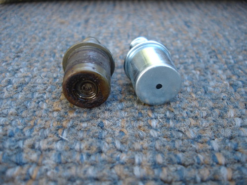

yukonese
Nov 5, 2011
48
Guys this is not a common issue with these motors so please stop saying that (unless its due to high mileage). Did anyone of you even bother checking your pcv valve as ive suggested instead of "broken is how its supposed to be" sort of attitude. It might actually work you know just a heads up.
OK, worth a try!

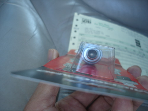

Bought a fixed orifice PCV for $.99, it is the updated one for 03 and beyond, I heard it is OK for 01 Yukon.
There is nothing but a fixed orifice at the bottom in this PCV, don't know why it can replace the original spring plug one. For this simple design, if you pay more than one dollar, you pay too much.
The old one still rattles, has some oil deposit, no idea if it works or not.
Total took 10 minutes, including finding a chair (to reach the PCV), shooting pictures.
Changed this PCV 2 days after the oil change, I will update you if the oil consumption improves in the next oil change (6,000 miles later). Thanks.

awsome man good to hear, I personally would have paid the extra few dollars for the ac delco brand part just to make sure the part is 100% up to spec so I know that if it still eats oil its due to something internal and not due to a off brand valve jmho. Let us know how it works out!
