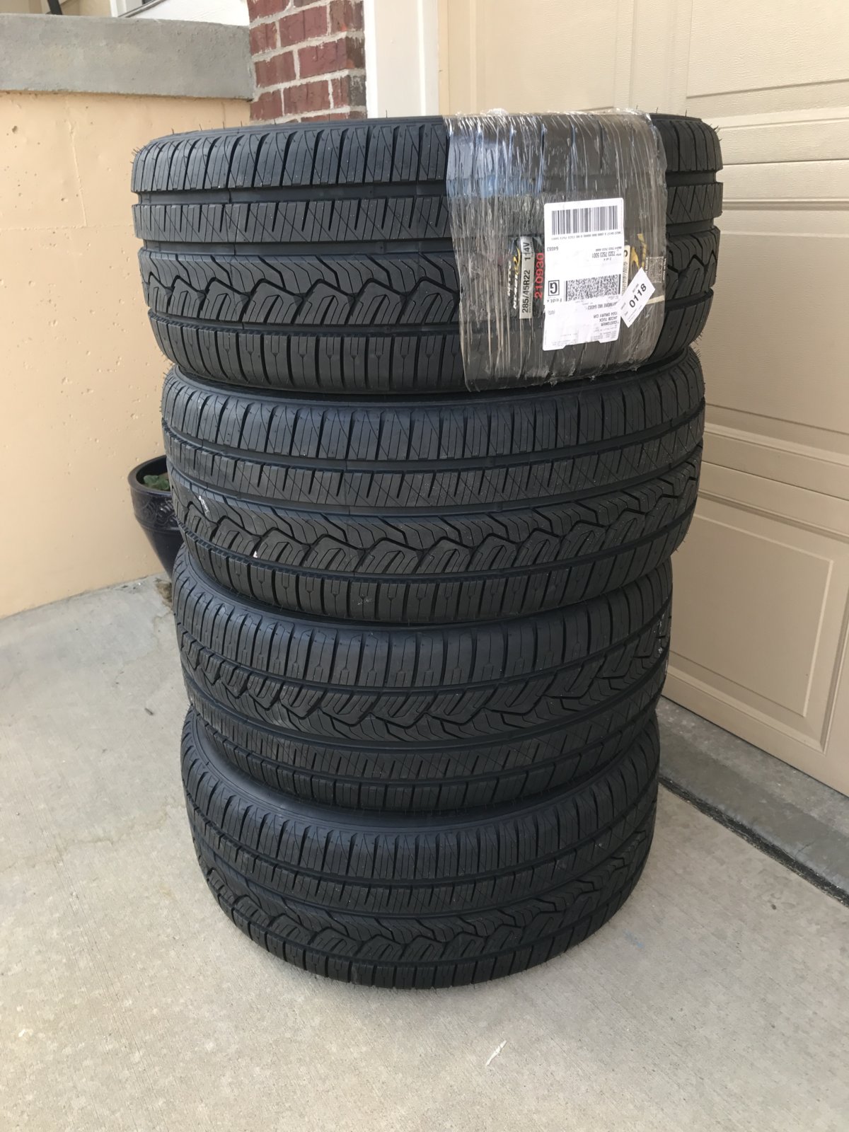

Tires arrived yesterday and will get mounted and balanced Monday after I have a chance to install new struts and tie rods on the front this weekend. Went with Nitto 421q tires this time around

Tires already?
Sent from my SCH-I545 using Tapatalk
50,933
19,329
Tires already?
Yeah, those Toyo Proxes only lasted me 30k or so. I'm sure I could MAYBE get another 10k out of them but just not worth it especially with winter in just a few months. They definitely didn't last as long as I'd hoped they would. These are rated at 75k miles tires, though, so these should be on for quite a while :waytogo: I loved the tread pattern on those Toyos and they handled well in all weather but due to the durability factor I wouldn't buy them again.

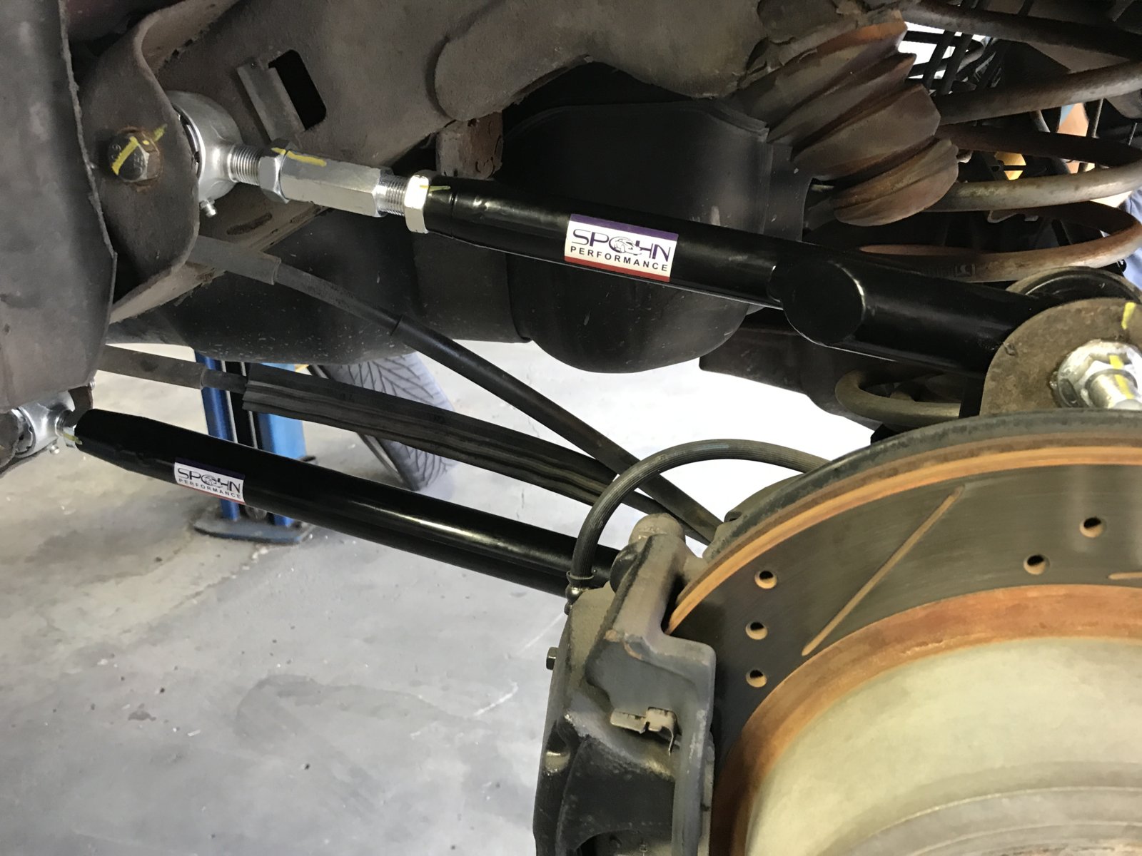

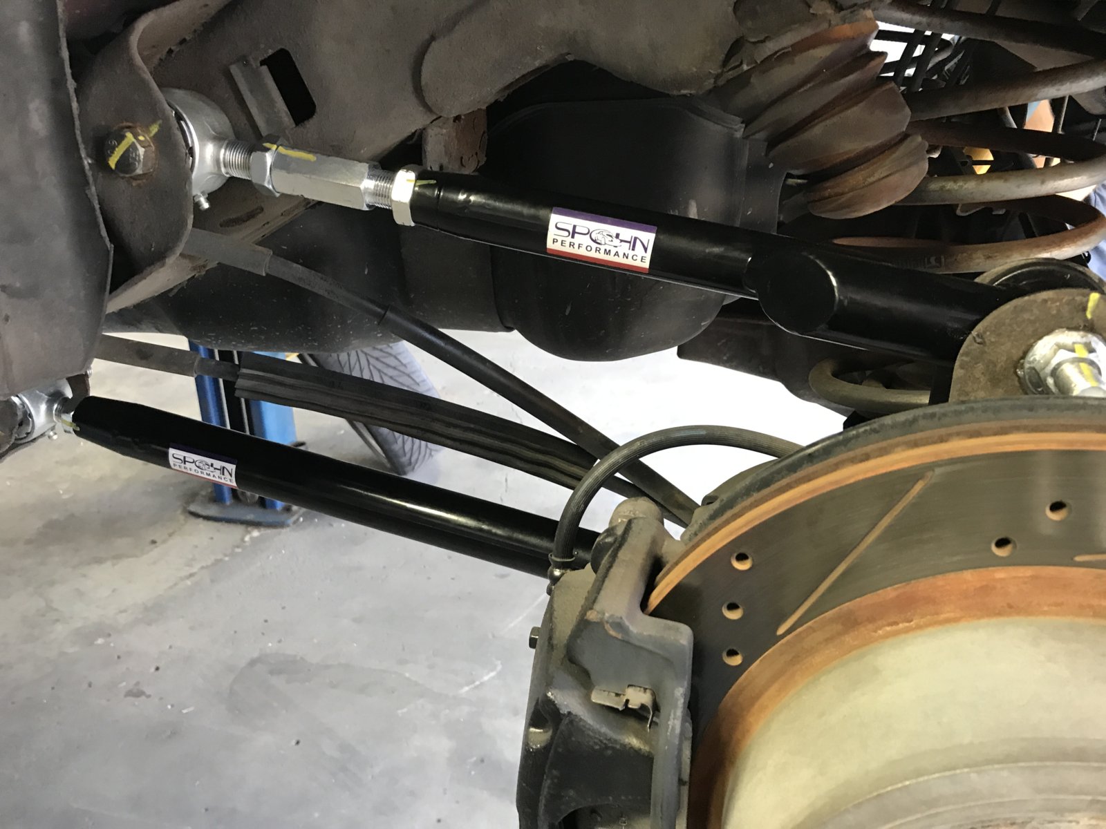

Spohn arms and panhard bar installed today. Also got my AC working again. Hopefully it stays fixed this time :okay2:
Tomorrow I'm doing my front struts and tierods in the garage. Then Monday tires and alignment happen
what's the verdict on the Spohn control arms---noticeable difference from stock?
50,933
19,329
LOL! yeah I've only driven them maybe 20 miles so far and that was on the hwy so let me give it some time :)

Sounds like no difference. :oops:

I replaced my factory rear control arms with billet arms on a Crown Vic years ago. The difference was immediate and very noticeable. :)
Lol I just don't drive my burb like a race car but I can tell that the rear wheels are more centered which is one of the points of the mod. If I'd also gotten a beefed sway bar it'd also make a big difference but a big girl like a burb is always going to have a certain level of body roll. By the end of day tomorrow I'll have new struts on the front and at that point my suspension will all be new and should be a huge improvement over how it was just a couple weeks ago when this effort started.
Make sure they are adjusted perfect so your rear end doesn't dog track.
