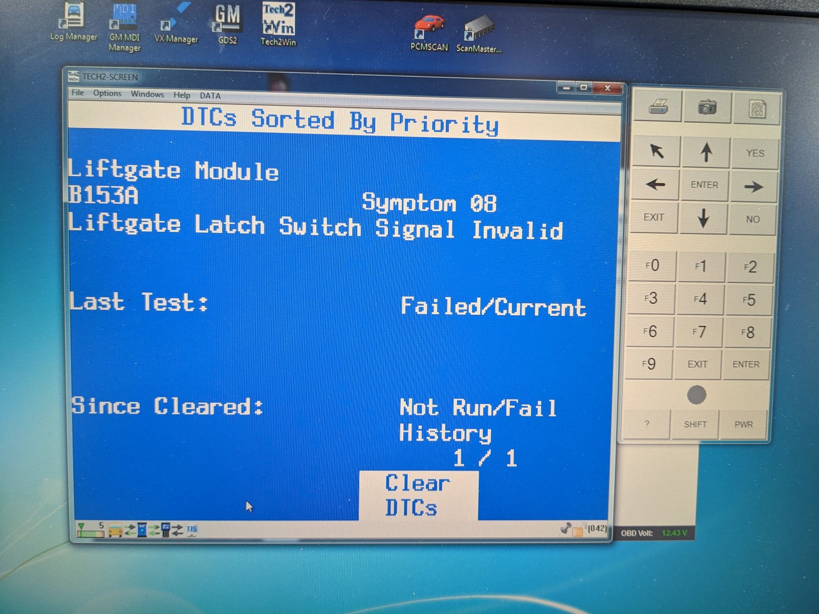

I'm about to tackle this problem also. Pretty sure I have the same problem.
