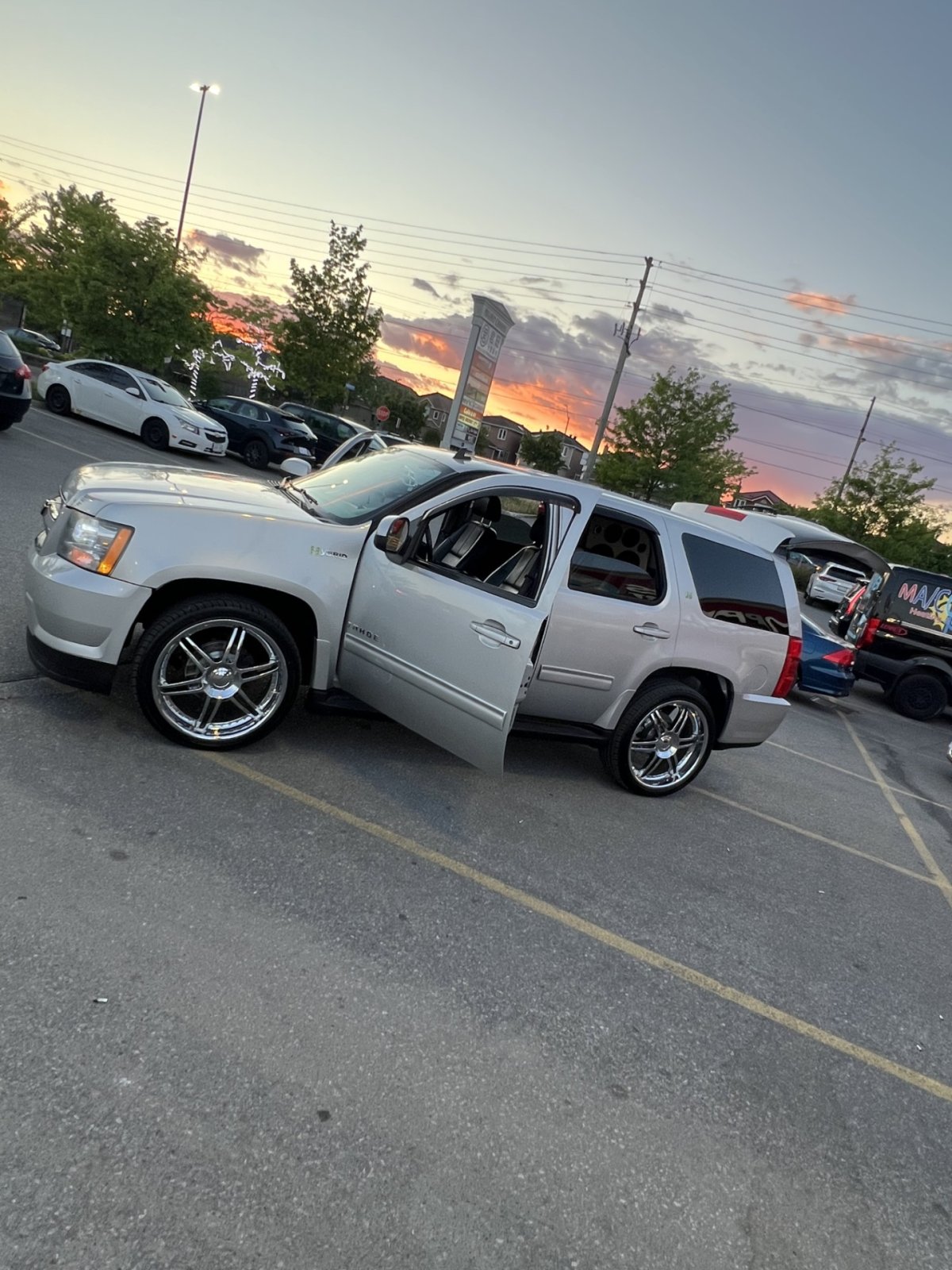

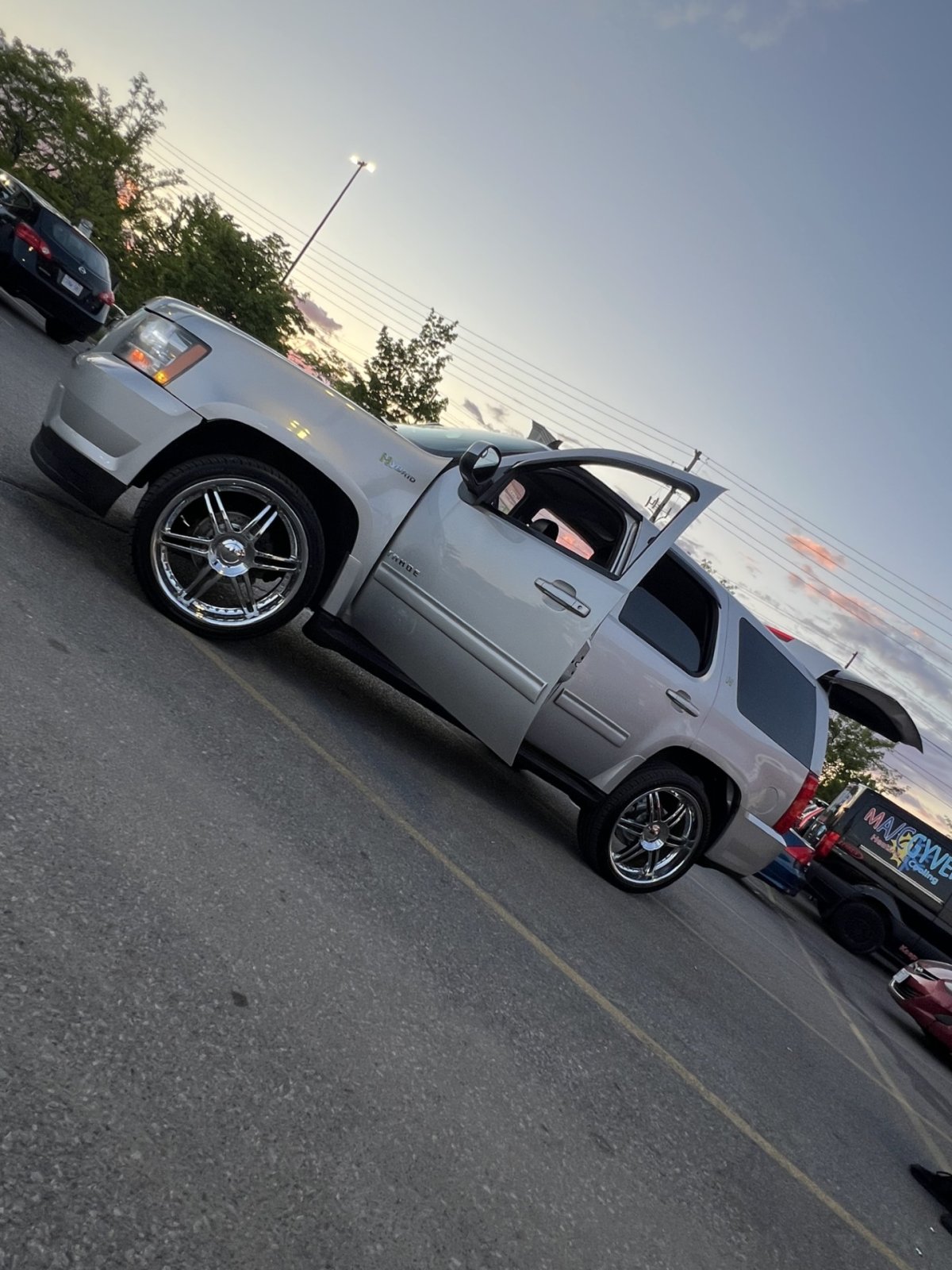

thanks for responding. This issue happened all of a sudden, no warning signs/slow movement. all of a sudden both switches went dead. i do belive that im going to have to pull the panel, and check for 12 volts at the motor. It was just weird how it happened out of nowhere. I was also wondering if anyone else ran into similiar issue? here is a pic of the truck. thanks for you input.
