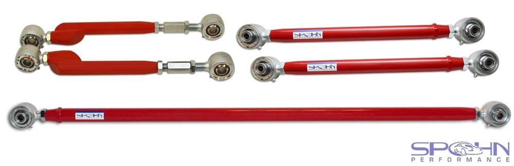

I have been getting a lot of questions since I put up the post that im using the Del Sphere panhard bar from spohn and just wanted to get some more info out.
Spohn now offers a complete rear package now to replace all the rear bars in the truck.
Package can be ordered in below link in Red or Black from My store page and by ordering as a group saves $40 dollars over ordering part by part

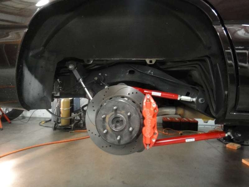

I've installed this bar package on a few trucks and the way the truck feels is much better. All the rubber bushings in rear are replaced and when mated with the DJM swaybar is a much needed improvement. Also I set the pinion angle at about -2 degrees which when you hit the gas swings to about 0 which for the modded guys gives better bite out the hole. Also since there is no more of the slop the power hits the tires harder.
Due to my truck having the upper autoride links YOU CANNOT use the spohn bars on the uppers but I will be using the rear lower adjustable del sphere bars on mine.
Heres a pic of the stock lowers compared to the new uppers
