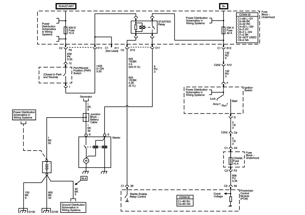

Not everyone here was an aviation electrician on the F/A 18C Hornet let alone knows how to use a digital multimeter (AKA Voltmeter but does so much more). So if I didnt know how to use a multimeter I would buy a new starter relay and an ignition switch. They are cheap and stupid easy to replace. Sure it's possible that the starter is acting a fool or even a dirty ground or even a dirty hot connection. But our generation of K chassis is getting pretty old so might as well throw a relay and ignition switch in it. You might get lucky. The way I see it..... is the 2 parts are like maybe $40 combined and thats alot cheaper than a hour with a mechanic because if it aint the starter then you are paying a mechanic. If the starter is good and the 2 parts doesnt fix it. You are out $40 BUT you just added some reliability to your K chassis since your 2 new parts now will likely out live your engine if original. Plus if you have to get into troubleshooting it further you can get a cheap multimeter and I can guide you through the checks right here and tell you how to use your multimeter and even post electrical schematics for the starter circuit. (Before anyone says it, this is NOT a PASSLOCK problem since the engine wont even crank. The PASSLOCK system allows an engine to crank but kills it after a few seconds if theft or a malfunction of the PASSLOCK system happens).
Or get the meter, forget the parts for now and we can get on to troubleshooting this electrical problem.
A quick and dirty is next time engine fails to crank have someone try to start it while you have your fingers on top of the start relay. If you feel the start relay click then likely everything is good up to it which rules out the ignition switch and associated wiring to the start relay control circuit. Doesnt rule out the start relay contacts (which could be burnt) but its a start.
