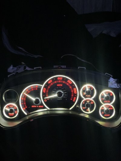

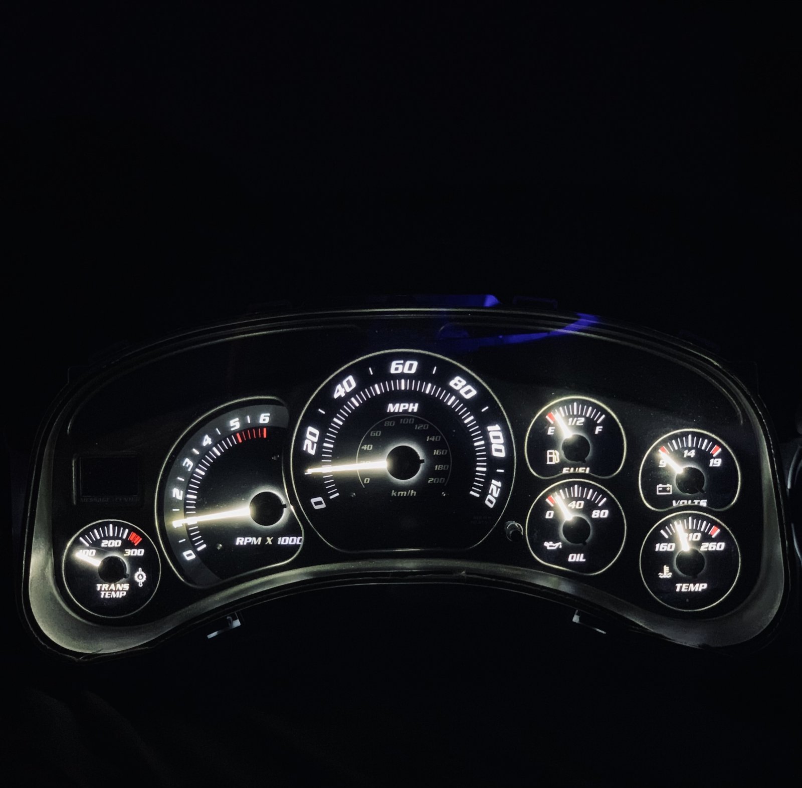

I wanted to share my latest DIY creation with everyone! I got tired of seeing the 03-06 clusters getting the special treatment in my search to mod my '02 cluster. So, I decided to figure it out and custom mod it by myself! I bought an '02 Escalade cluster to do this: I custom engineered LEDs under the needles and used RGBW strips for backlighting. I used oem overlay but removed blue paint from backside and covered the km/h speed scale. Let me know what you think!509312B6-729B-4894-8340-80765F65FC81.jpegCB9A8D6A-7F9D-408C-93B6-C08F99A435D2.jpeg74A3CFF5-B115-4986-8D94-9E028948EAF6.jpegE52ED783-6574-491B-97CD-0BA420BC96F3.jpeg

I wanted to share my latest DIY creation with everyone! I got tired of seeing the 03-06 clusters getting the special treatment in my search to mod my '02 cluster. So, I decided to figure it out and custom mod it by myself! I bought an '02 Escalade cluster to do this: I custom engineered LEDs under the needles and used RGBW strips for backlighting. I used oem overlay but removed blue paint from backside and covered the km/h speed scale. Let me know what you think!View attachment 383176View attachment 383177View attachment 383178View attachment 383179
Looks sharp. Nice job.
