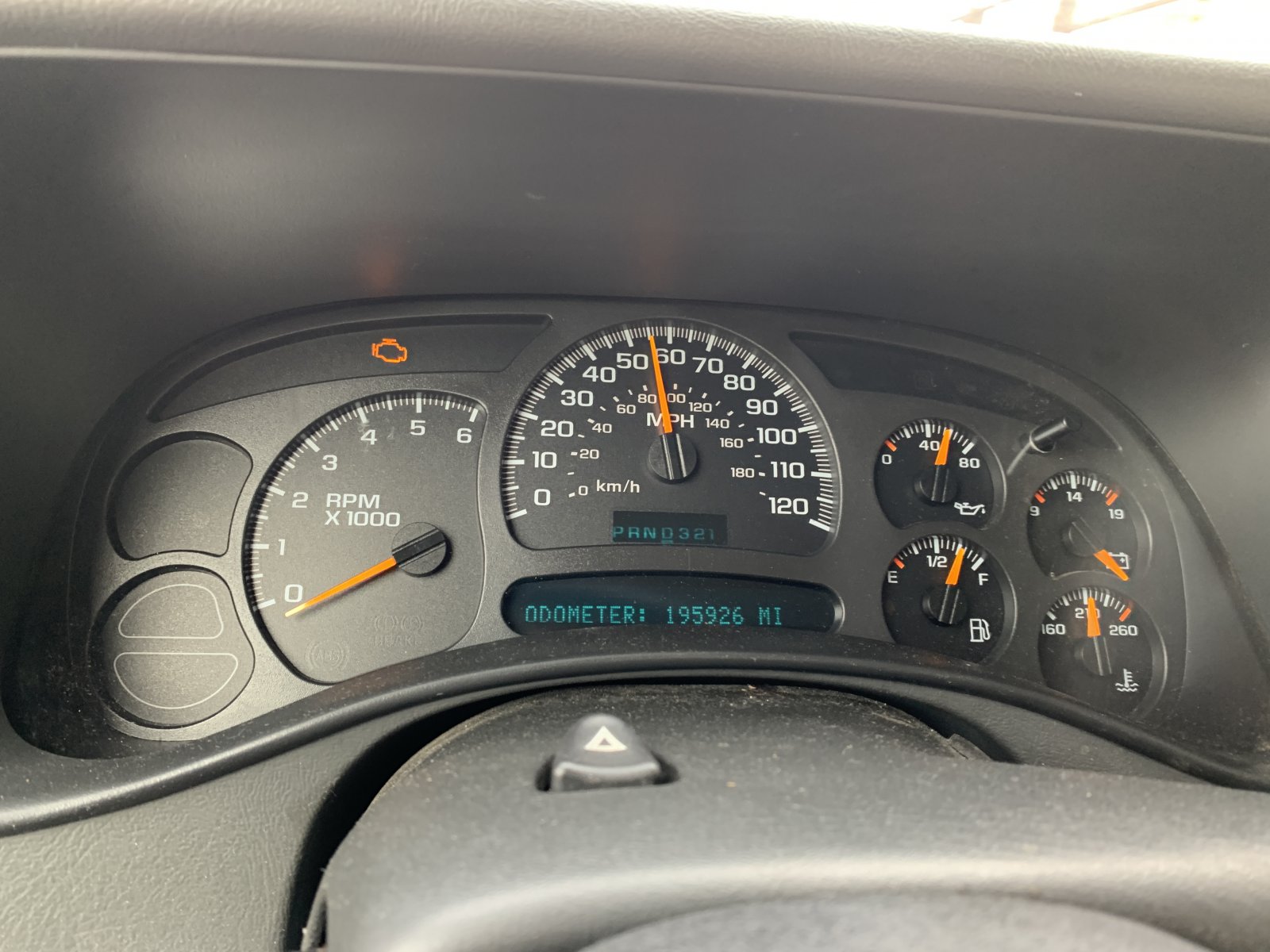

Yep, two issues…
First is code is P0300 random misfire. Good call on the fuel pressure reading, going to start there since plugs/wires were replaced recently.
From what I can tell, the second issue is either a bad body ground connection or in the cluster like you mentioned @rockola1971. Seems like a common issue with this generation from what all I’m reading. It’s not even consistent where the needles start/stop. I added a pic here - it would be funny if it wasn’t my own, so here you go… gas gauge is now vertical down… looks like this cluster wants to be in an EV .
I may try inspecting/repairing the board/components before replacing the cluster entirely as I work with some folks who used to design those things (but not this GMT800 or else I’d know exactly who to complain to!)
More to come…
