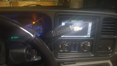

NNBS Shifter is in tow haul is functioning like it should. :). I will hopefully be able to wire in my steering wheel controls and make the + and - buttons work on the Car PC

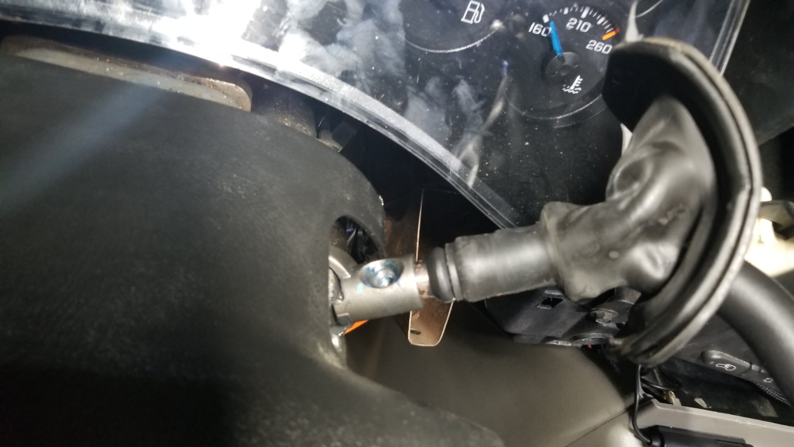

2. After that gently pop the steering wheel cover off just enough to pull the shift boot grommet it out the way, peek in and gently pull the clips from the steering column there are two black clips holding the wire from the shift lever in place.
3. Once that is free i would unplug the other end of the harness you need to keep the plug, so either pick up a spare one at the junk yard or cut your original plug off your shift stalk.
4. Remove the T30 Torx holding your shift handle on the assembly at the top.

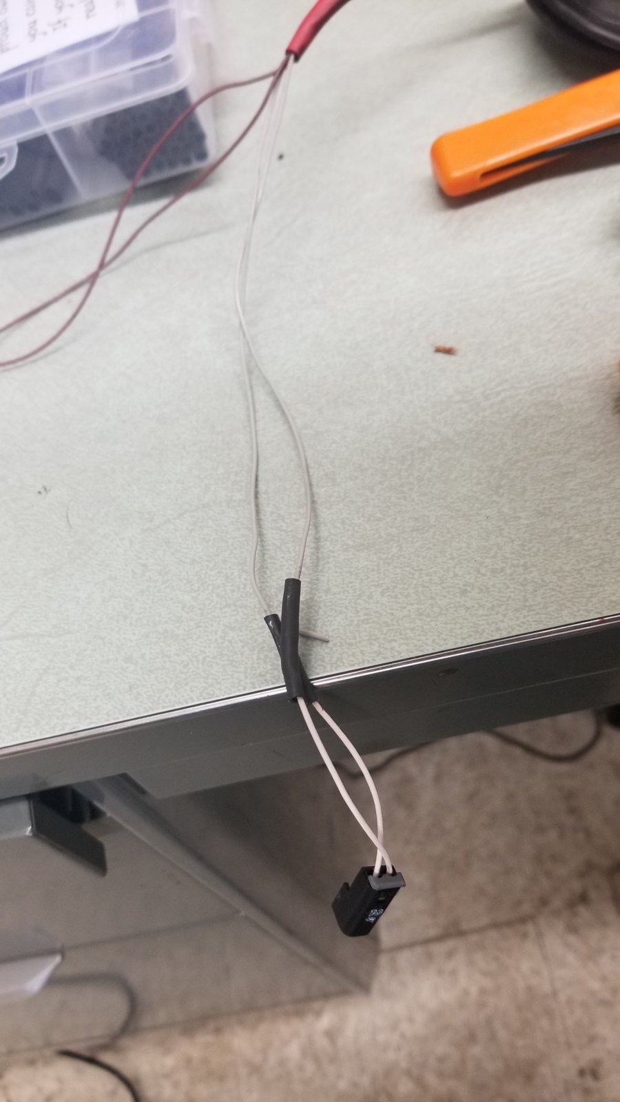

5. Take your shift handles to your work bench cause now its time to solder it together. Off the NNBS you will have a plug with 4 wires. 2 Black and 2 White wires, we will only need the two white wires to wire in the tow haul switch. this switch is a switch to ground it it its not possible to reverse the polarity of this plug chop grab your spare pig tail or cut off enough to give yourself plenty of room to strip and solder your wires together. dont mind that they are grey and brown on mine mine ended up being cut when i got the shift lever so i had to add some wire and extend them.
Since the clips are the same 2 small clips spaced about same distance the part you can weave it back down and plug it back in at the BCM. Reverse install procedure be very careful as to notice what direction your shift boot is in before re installing to save some headache of having it flipped upside down. mine ended up routed a little bit differently due to having to patch and fix the wires so close to the stalk.
