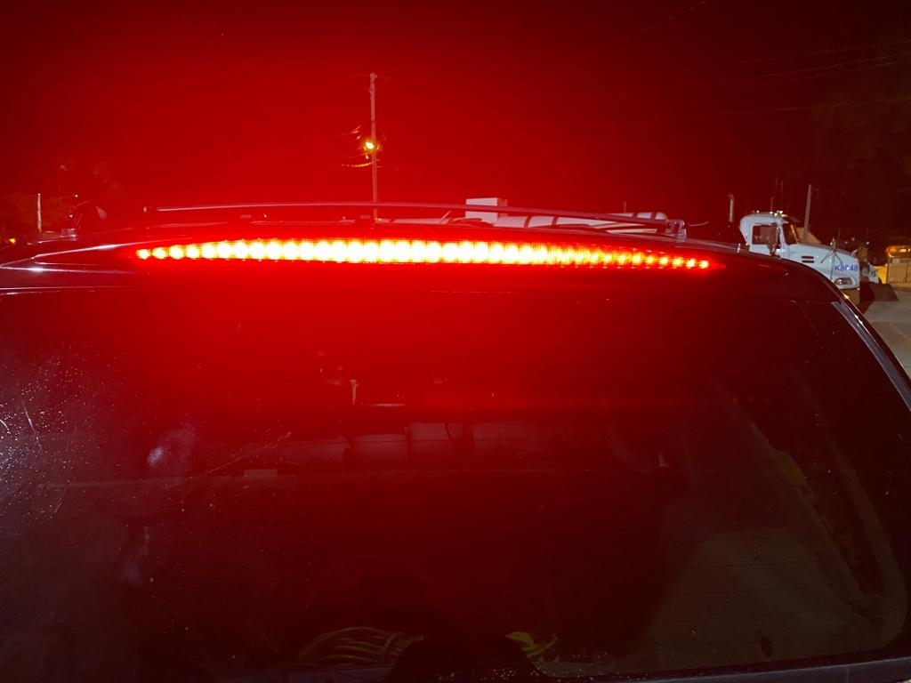

A week ago I bought an LED light strip for my 3rd brake light just like @Speedslow. My factory LED only lights up on the drivers side and the other half is dead.
Today after work I didn’t feel like doing anything that requires me to stand, lift or move anything heavy or just think for that matter. I’m tired. I can’t sit around and do nothing so I tackled the 3rd brake light. Tried using a heat gun to separate the housing with no luck. This thing is like glued together and was never designed to take apart. I ended up scoring it with a utility knife over and over and over and over and over again. It took me about 3 hrs to get this thing apart and at the end I was getting medieval on that thing but I got it apart without breaking it.
I wanted to see what the issue is before I just replace it with a $30 light strip. I found the issue, a bad solder on the power wire going to the passenger side.
I fixed the solder joint and now it works.
So now my dilemma is, do I leave it as is or do I put the new light strip in. I do like the sequential turns and flashing stop but I don’t want to do this again if the $30 light strip fails. Here’s Speedslow video if you guys haven’t seen it.
What do you think? I could possibly put the sequential light strip in and just leave the factory light strip unplugged. If the one goes out I could just plug in the factory again. I’d have to mount the strip so it doesn’t block the other light and I’m not sure if I can do that but I can try I guess. Or just leave the factory light? Thoughts/feedback?
For me, the new strip is too busy. I like the simple, factory style. But you should use the one you like.

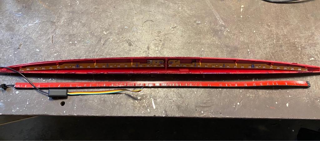

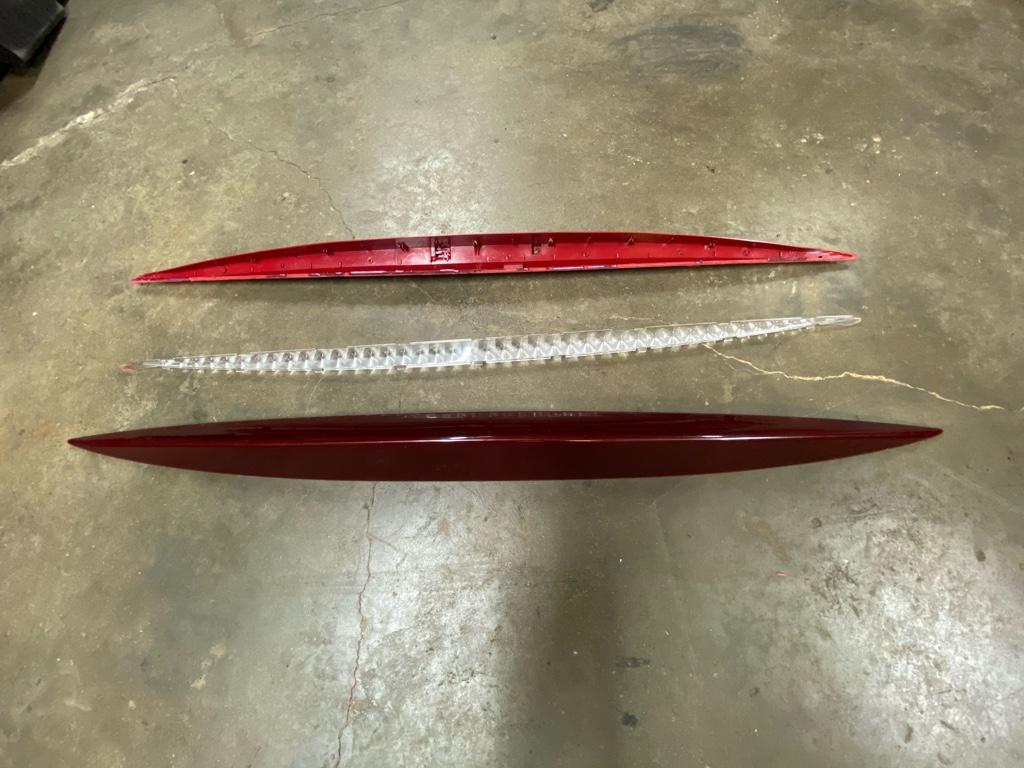

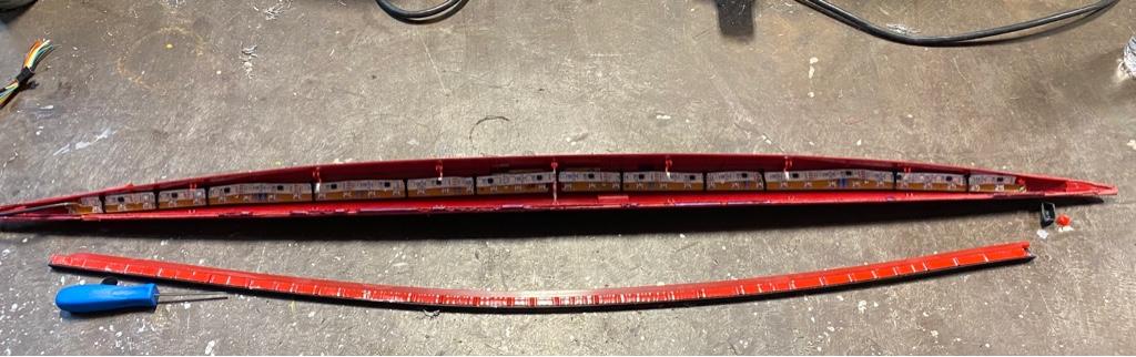

Time to cut this thing open and see what I have to work with.
The backside of this strip doesn’t have any contacts or ribbon exposed but I still added some electrical tape to it for added insurance. Then I put in it on top of the factory lights so they will still work if I decide to go back to factory if this one fails. I might even try both at same time so I have the brake light while the sequential turn is going. But I’m not sure how that will look with just hitting the brakes because one will light solid where the other will strobe before going solid. [emoji848]
Securing it was simple enough. When duct tape doesn’t work, zip ties will.

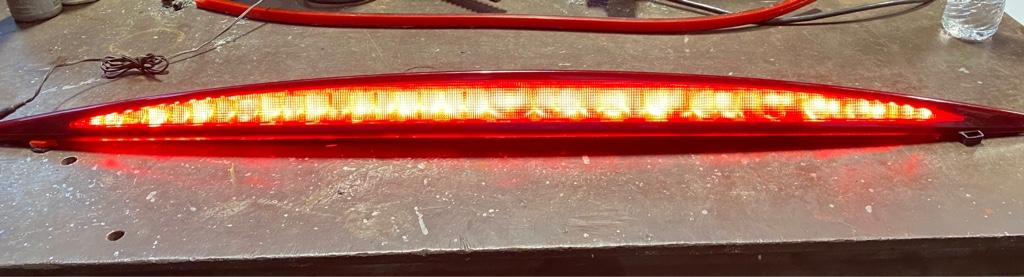

Put the clear lens back in and loosely set the red lens over it to test it out. I only tested the new strip because I know the factory will still shine like it’s suppose to.

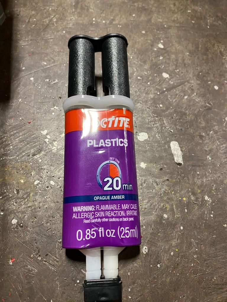

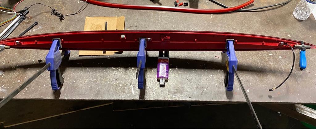

Picked up some Loctite plastic bonding 2 part something or other. Never used it before but what’s the worst that can happen? Lens falls off and get run over?
This stuff sets up in 20 minutes but doesn’t fully cure for 24hrs so I had to work fast. What sucks is it doesn’t have a mixing tube, you gotta put it on a piece of cardboard and mix it like you do epoxy. So getting it from the mixing board to the lens was time consuming. I did it with a small screwdriver and then set the lens on and used some squeeze clamps. I’ll leave it until 2mrw. Once cured I’m not sure if I wanna seal it with silicone or I was thinking maybe use a hot glue gun.
Done for now. I’ll report back how this stuff bonds and holds.

I'd go with silicone. You'll be able to go thin, and smooth it out with your finger--and can squeeze it into any cracks if need be. Not so much with a glue gun, plus when it's liquid hot, it's HOT!

Not gonna lie, I don’t like the look of the factory light behind the strip. It just looks odd and like there’s too much going on. But if you like it roll with it!
The factory light is below the new strip and the pic with it lit up was only the new strip. It looked busy because the clear diffuser lens and the outside lens were only sitting on top and not where they needed to be. I’ll show a video 2mrw after I get the lens sealed up, tinted and put back on. If it still looks busy or chaotic, I can just unplug it and plug the factory back in and you’ll never know it’s there. I appreciate all feedback, thanks.
Yeah, that’s the route I’m gonna take. I was just concerned about this plastic bonding stuff but it really seems like it’s solid. I was just thinking that the hot glue gun might help with strength as well as seal it. Clear silicone it is!!

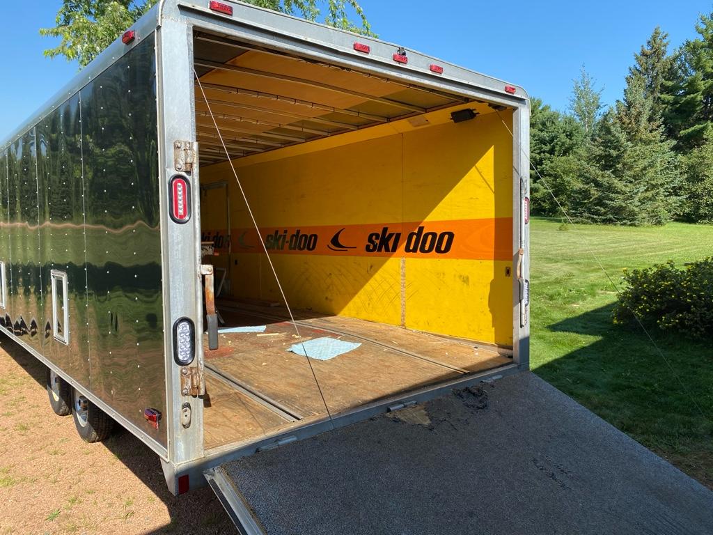

Haven’t gotten anything accomplished. Been working 3p-3a and having to get up at 8am to get the daughter going on this e-learning crap. It’s a full time job in itself. I didn’t realize I was going to have to sit there with her while doing the schooling on zoom. This is crazy! I can’t keep going like this and get anything done on this house to get it ready to sell.
I went back up to northern Wisconsin a few weeks ago and I did manage to get a few things done. All new wiring and color matched like it should be and no more corrosion clips on wires! Those stupid wire piercing clip on splices suck!
The LED lights make a world of difference.

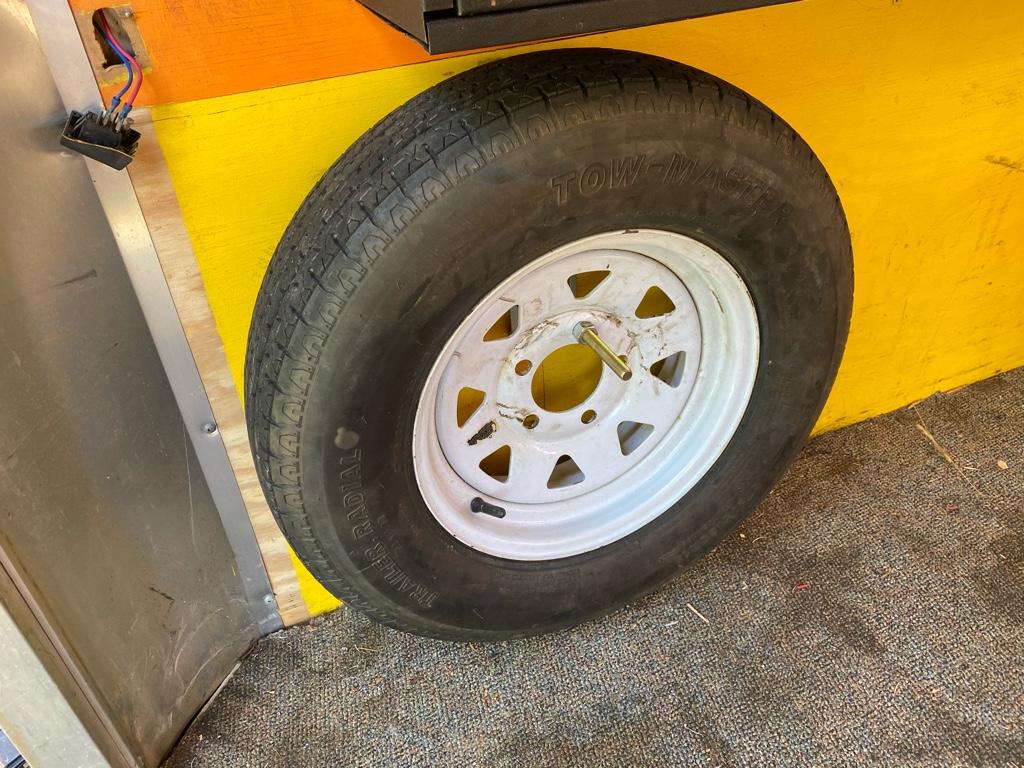

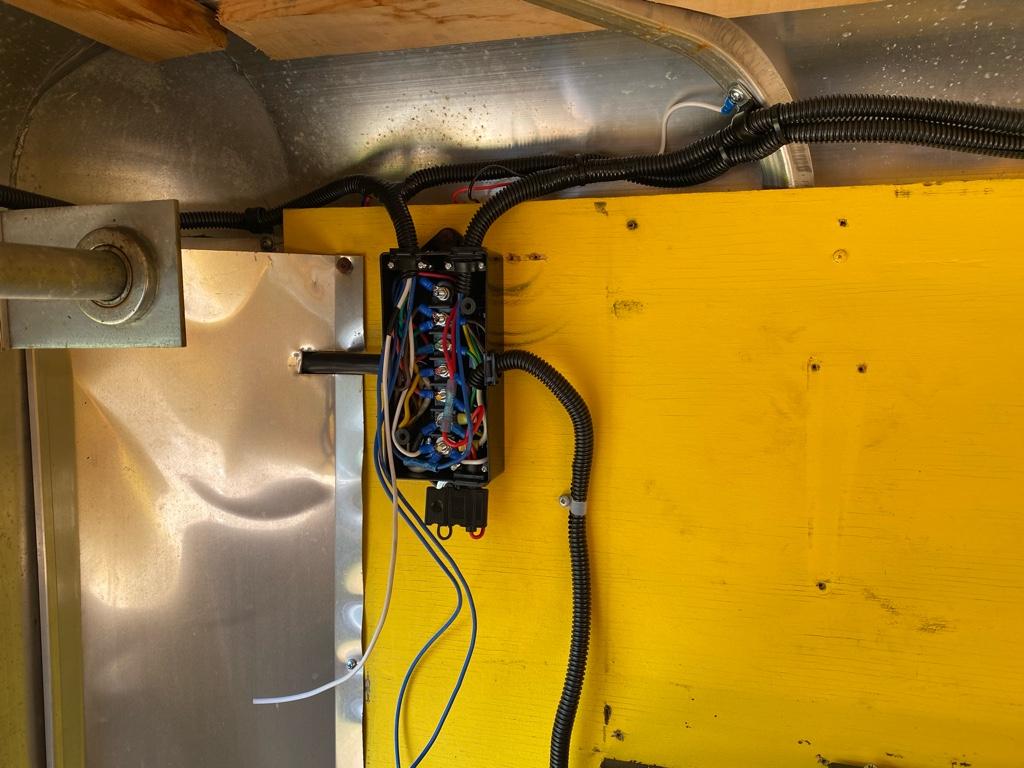

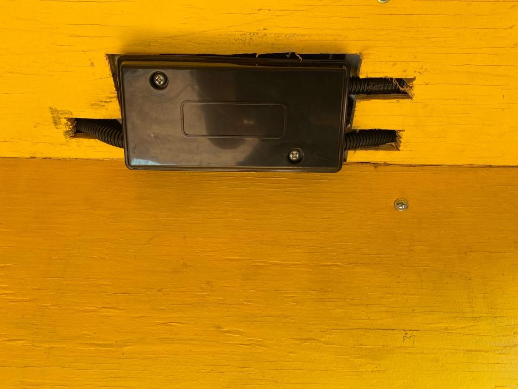

Installed a spare tire holder up in the front. Just an x-clip bracket with a stud to secure the spare. At least it’s not in the way any longer and won’t bounce around.
I removed those ugly Ski-Don’t decals from the inside walls and it’s getting a white paint job to get me by this winter. I don’t have the time nor the energy to pull all the panels, insulate the walls and ceiling and install FRP panels this year. But it will get done next summer.
New junction boxes installed, one at the front to make my connections and one at the rear. Makes it easier to diagnose any problems should they arrive and also any add-ons that may happen. Hint* exterior flood lights and motion light.
Pulled a wheel to inspect the brakes and get some numbers off seal and bearings. It looked ok. As much as I want to throw new brakes on there, I’m gonna let it go another year. No pics, my brother did that part for me. But I did order all new bearings and seals so that will get done this weekend when I go back up.
I did find a screw in a tire so we put the spare on and I brought the wheel home with me. I just grabbed a new tire today and dropped it off with the wheel and tire at my dad’s so he can bring it to the school and mount and balance it. Hopefully he knows to throw a new valve stem in also. I’m sure he does.
I wanted some reverse lights on there so I cut the holes and put some clear LED lights in. I put the clear ones where the park/stop/turn lights were and mounted them higher. The backup camera has night vision but it’s good to let others know your backing and also can see a little better when looking down the sides thru the mirrors.
So this weekend my plan is pack new bearings, new seals, paint the interior walls, install electric tongue jack, make some sort of hinge for the rear ramp door transition flap and then drag this thing home to use it to move my parents out and my stuff into their house.
Besides the trailer, I have to get oil and filter changed on my sled, change the chaincase oil, im adding some stiffening plates to the skid, chasing down no power issue to my USB ports, grease job, track tension and alignment and pulling the clutch to bring it home for a rebuild and upgrade. Then on Jacks sled I have to fix a chaincase leak, adjust his track, and grease it. Josh might be driving that this year if he can get his snowmobile license with all this Covid shit going on. I’m gonna grab another sled this year to add to the arsenal. I found an 07 Yamaha Nitro that I think Jack will do good on and it’ll double as a sled for Jess to ride on the occasions she comes up. We are running out of room again for sleds so maybe a 3rd garage? Or I might get a shipping container to store the majority of our toys in. I don’t see that portable garage/tent lasting more than one season.
That’s where I’m at. If I don’t get a chance to check back in I hope everyone has a safe and wonderful Labor Day weekend.

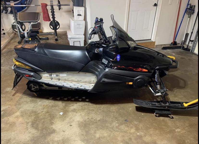

Gonna stop and take a look at it while we are heading up on Friday. If I buy it, I’ll pick it up on my way home Monday since I’ll have the trailer.
I almost bought one of these brand new in 07. I think it will be perfect for Jack and Jess. Little bit more power than he should have, about 130hp, but I think he will be fine because he only rides with us as a group. Yeah, my kids are spoiled but they know it can be taken away faster then it was given.

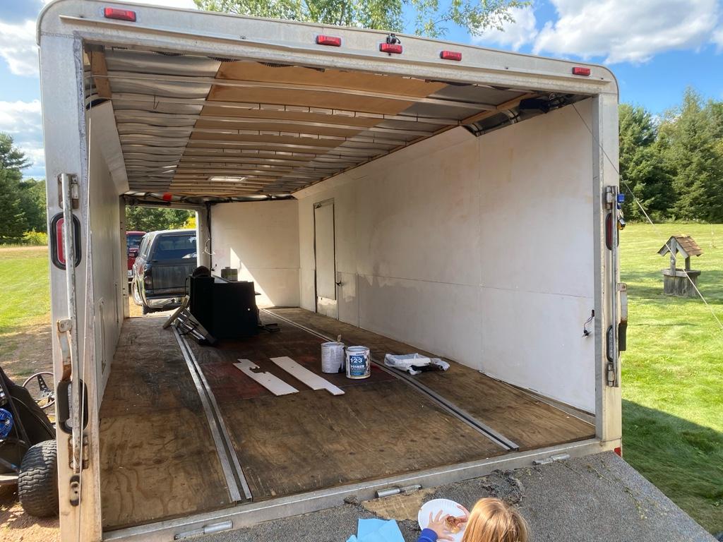

Took 2 heavy coats of primer to cover the yellow and orange paint on interior walls of trailer. Then one good coat of paint and it’s white now. So happy that’s done.
Finished paint and brother put another strip of LEDs down each side. Stupid bright in there now. Just have to get that ugly decal off the cabinet up front.

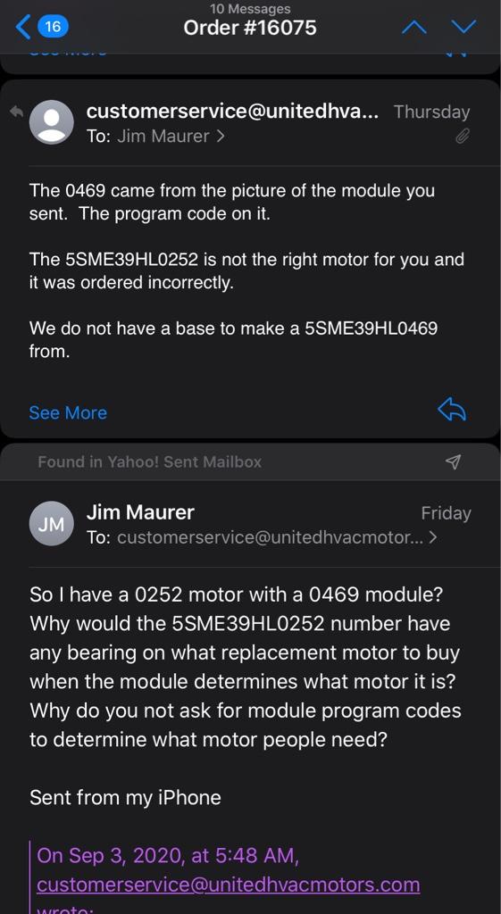

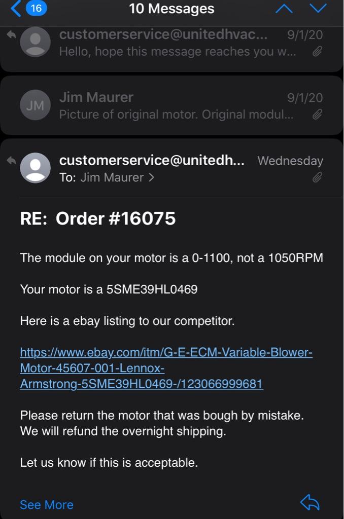

Dealing with this HVAC company still. I tell them that I can’t get any speed out of the motor they sent me and they are telling me it should be fine. I’m getting pissed and aggravated every day because they either won’t or can’t tell me what wire on the module needs to get 24v in order to speed the motor up. Then I send them pictures of my module and they tell me I ordered the wrong motor. The part number is right there on the motor, so I don’t know what they are talking about. Here’s what I’m dealing with.
So I guess now I have to send this POS back to them, wait 6 weeks for a refund and in the meantime find another replacement. If it weren’t for bad luck....
So that’s on my priority list right now. I might even find some capacitors and just solder them in and get this old unit back up and running. I’m getting out of this house in a few months anyway. I’m overwhelmed by all the stuff I still need to do before I can sell this house. Not to mention painting and replacing carpets at my parents before moving in. I promised Jess new bedroom furniture and couch too. Kicking myself for that considering how much this move is already gonna cost me. I’m looking at $38k to tear down the 2-1/2 car garage and put up a 46x32 4 car with lift after all the concrete and materials. I’m running out of time and weather to make it happen. That price also includes tearing out bushes at end of driveway and making it double wide all the way to street.

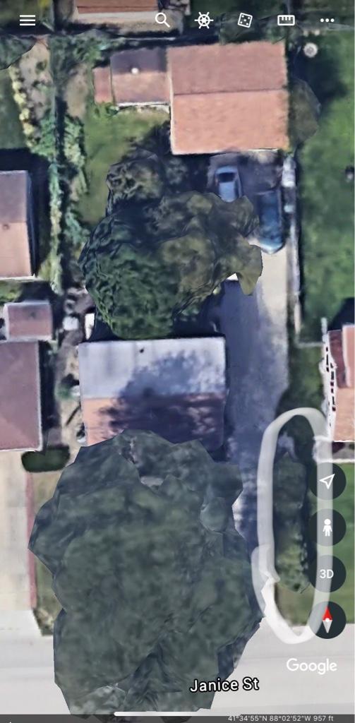

Circled in white are the bushes that will be coming out.
And above pic you can see the garage with attached shed. New garage will be almost across the entire width of back yard and 6’ deeper. Right now it’s 28x28.
Better view of the bushes that are coming out. I don’t understand why he didn’t do a double wide driveway when he did the concrete driveway about 10 years ago. And my dad is goofy about trees and shade. A lot of that is getting chopped down when I get settled in.

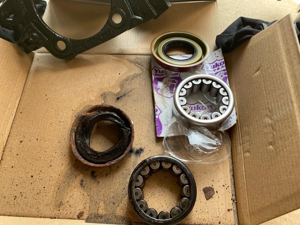

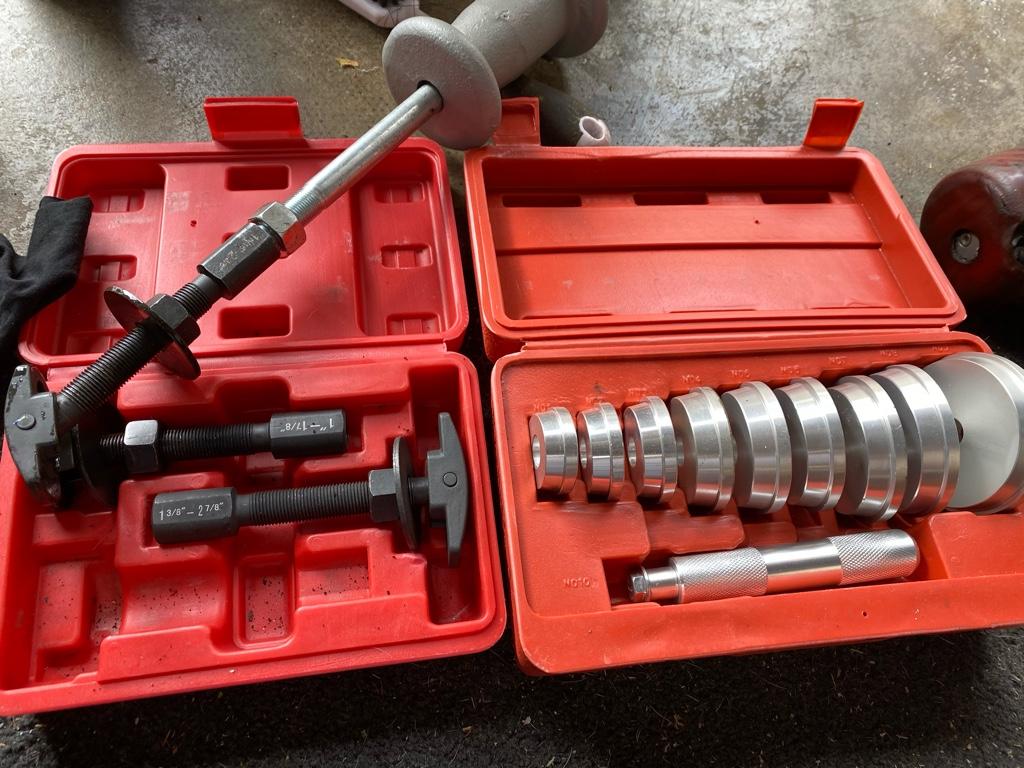

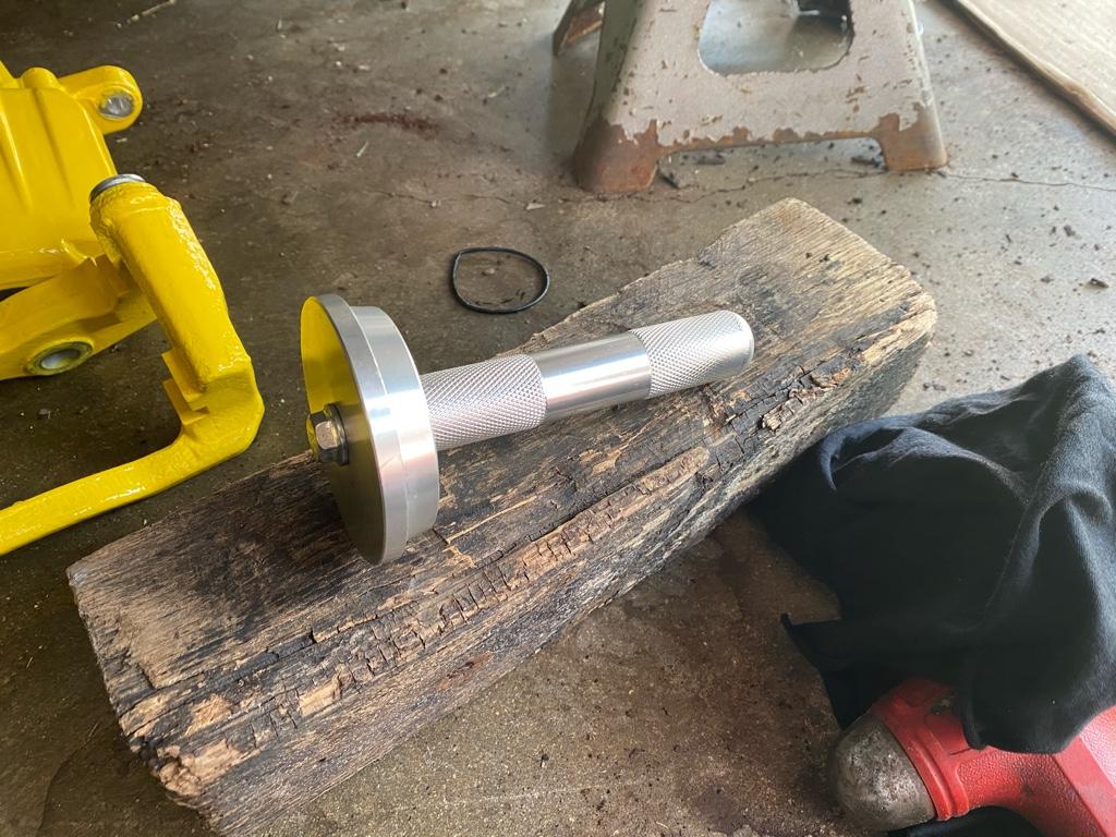

Since this rig is sitting on stands until new rims come in at the end of the month, I decided I need to get some of these new parts installed. I’ll post a picture of the new rims on the other build when I’m done here.
I pulled the brake caliper, bracket and then removed the diff cover and pulled the c-clips. Slid the axle out and then removed the 4 bolts holding the backing plate and support bracket. Rusty mess.
Just to give details on how the axle bearings come out, this is how the tool works. The end folds over and you slide it thru the bearing after removing the seal.
Tighten the washer and nut up against the bearing and use a slide hammer to pull the bearing out of the axle tube. Simple job when you have the tools to do it.
New Yukon bearing and seal.
To install the new bearing I just use a seal/bearing driver and it goes in without issue. There’s a lip on the inside of the tube so it’ll stop and you don’t have to worry about setting the depth. Just go until it stops.
When installing the seal, I always use this anaerobic gasket maker to help it seal. The seals come with a coating and I’ve seen them seal without any help but I always do it for added insurance.

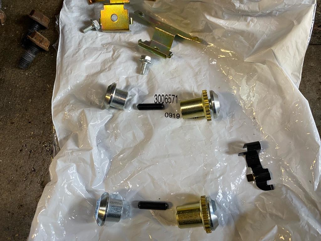

I ran the parking brake bracket thru the sandblast cabinet and spray bombed it. I can’t stand the rust. I even did the bolts while I was at it.
Next I installed the parking brake arm and new boot onto the bracket and then put the backing plate and bracket on.
Next was the clip for the adjuster.
As you can see above, I used white lithium grease on the adjuster sleeve.

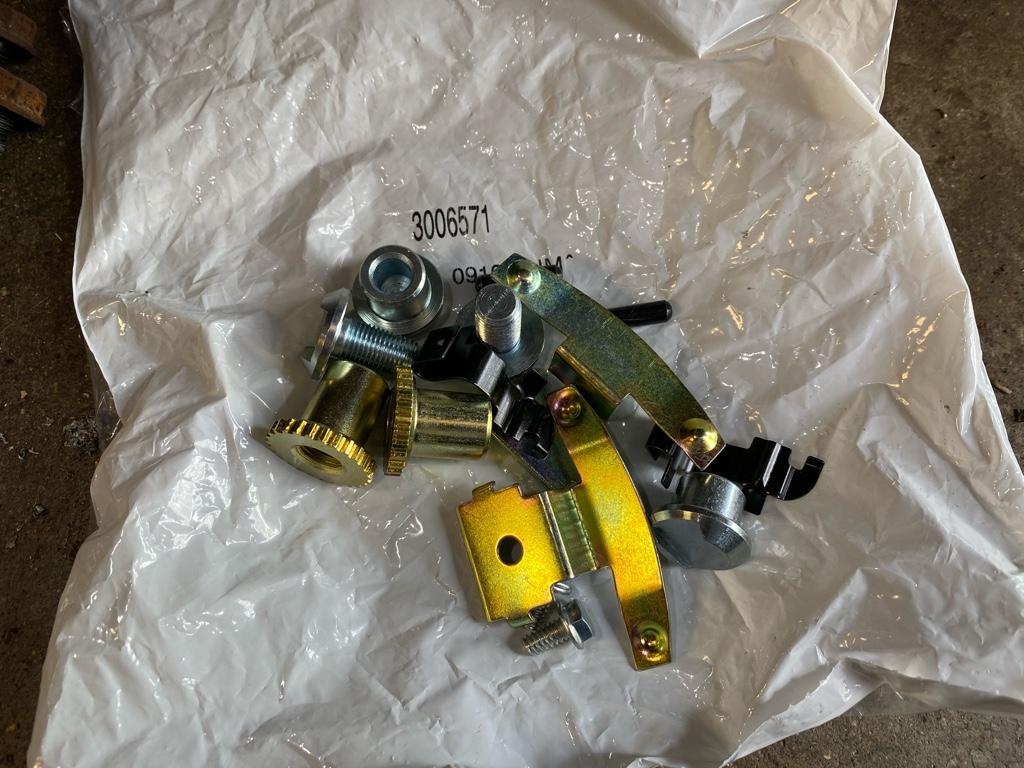

This was the adjuster I ordered when I ordered all the parking brake and backing plate parts. It’s wrong and I knew it when it came.
The correct parts for adjuster.
This is how it goes together. One for each side.
