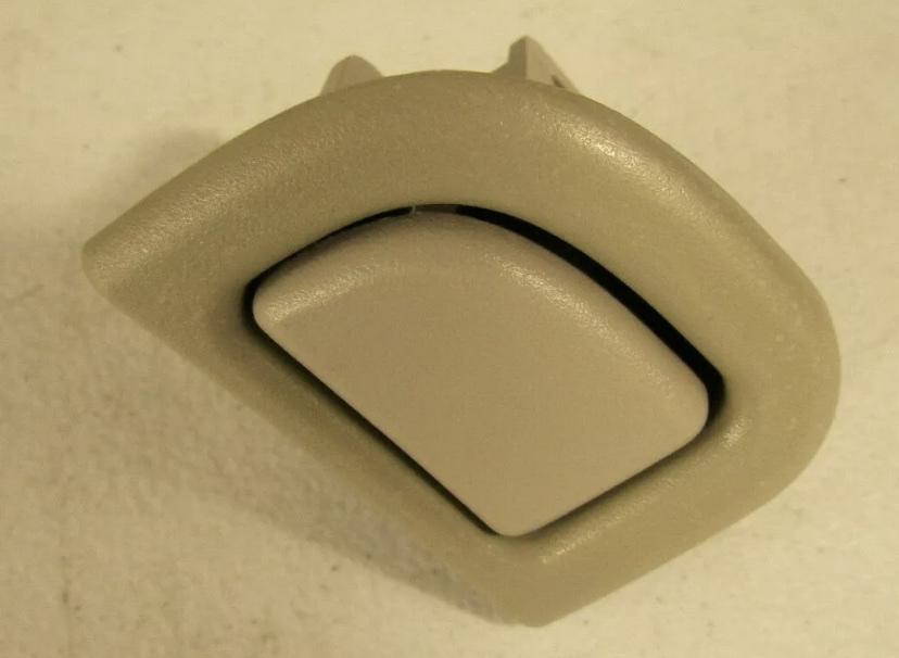

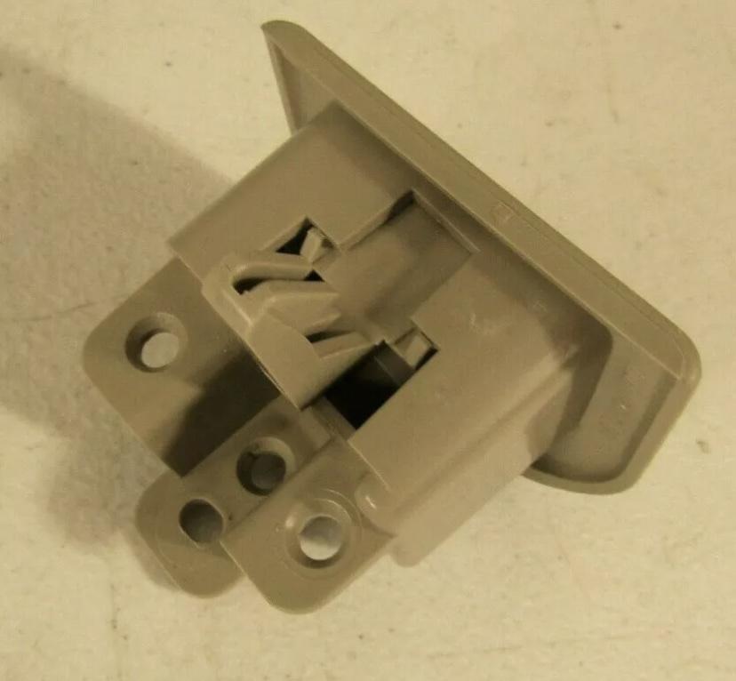

The center console lid was just a $12 part off eBay. I pulled that apart and put in the new latch.

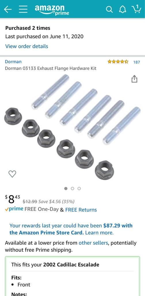

There’s also a broken exhaust manifold bolt and it ticks when it’s cold. Drives me crazy. So I ordered the parts but have yet to dig into it. These are the best manifold gaskets and I won’t use anything but these.

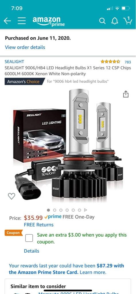

Then I addressed the dim yellow headlights. The lenses could use a good cleaning too but I needed more lighting so I ordered these LEDs.

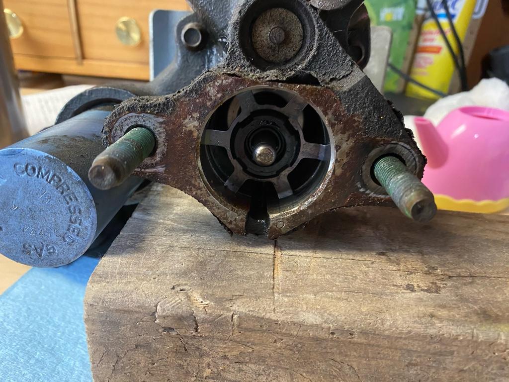

I also changed the grille just because of the conversations I had with the wife about the grille for her Esky. It looks better than it did for sure but I only did it to get a rile out of her. Lol

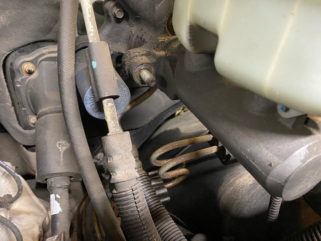

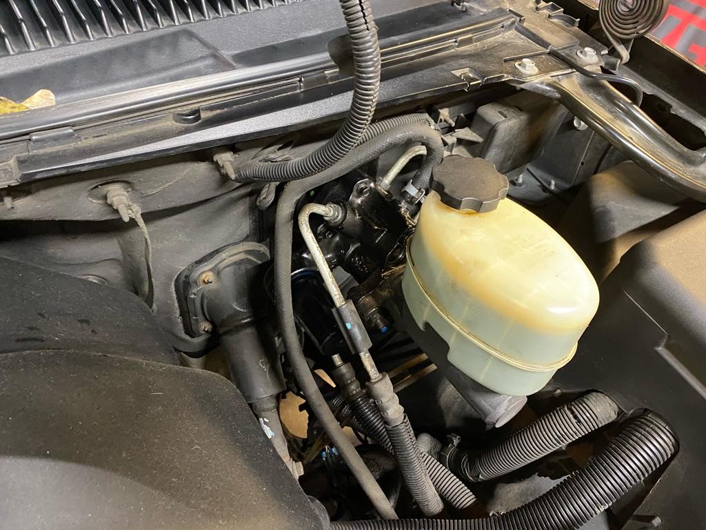

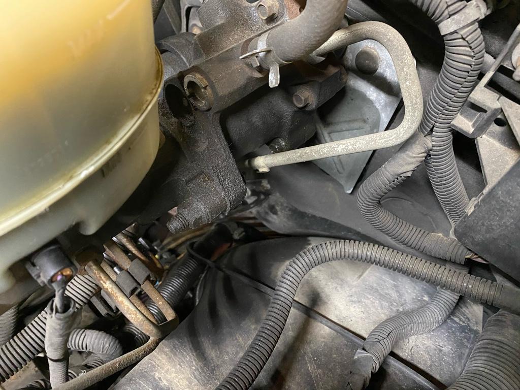

Then I noticed this on the front inner drivers side fender. The leak was where the master and booster connect.
I was able to move the master enough without having to remove brake lines.
Then I removed the lines from the booster once I determined that’s what was leaking and not the seal in master.

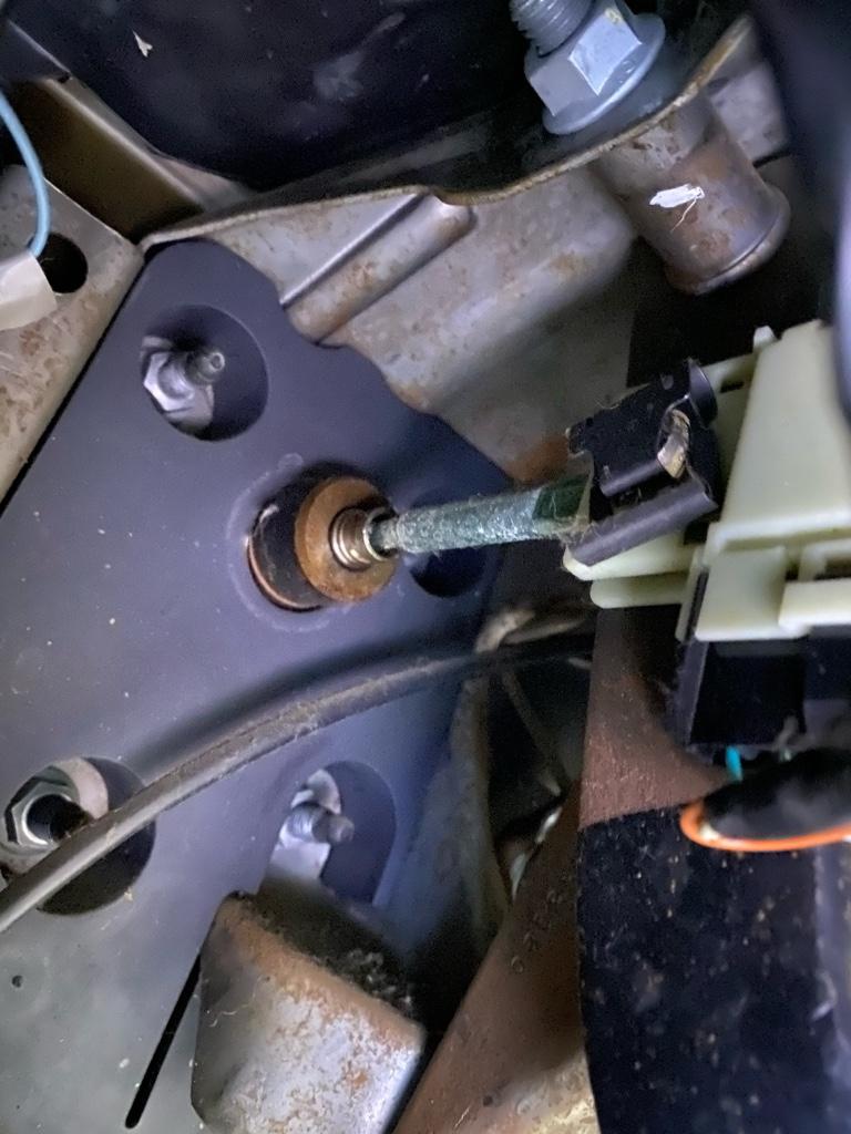

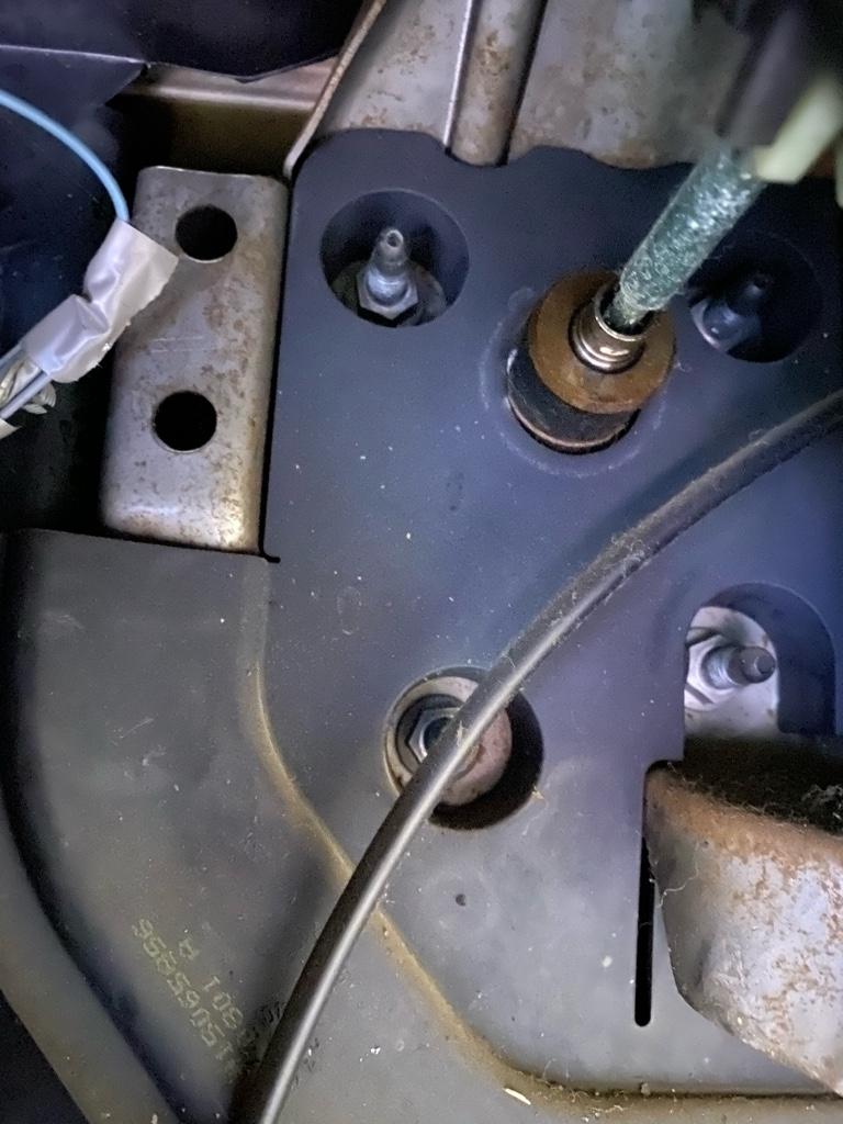

Remove the clip from the brake pedal and the brake light switch slides off with the push rod for booster.
Then it’s just the 4 studs that come thru the firewall to hold the booster on.
After that, the booster comes right off. Got my new booster and usually when I change hydro boost units, you have to take the push rod from the original and put in the replacement. This one came with the push rod and it measured out the same so i didn’t replace it. But be aware if you do have to swap it, that clip holds a spring in and it will fly out and take out an eye or at least fly across the garage or driveway and can disappear on you easily. Ask me how I know.

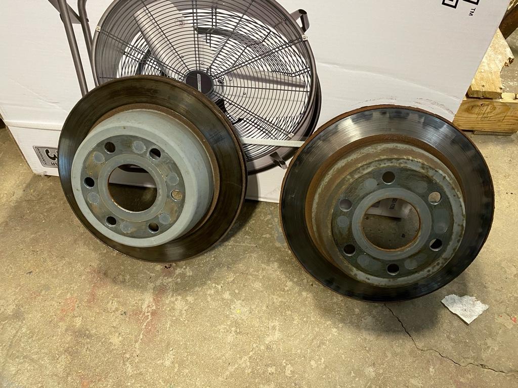

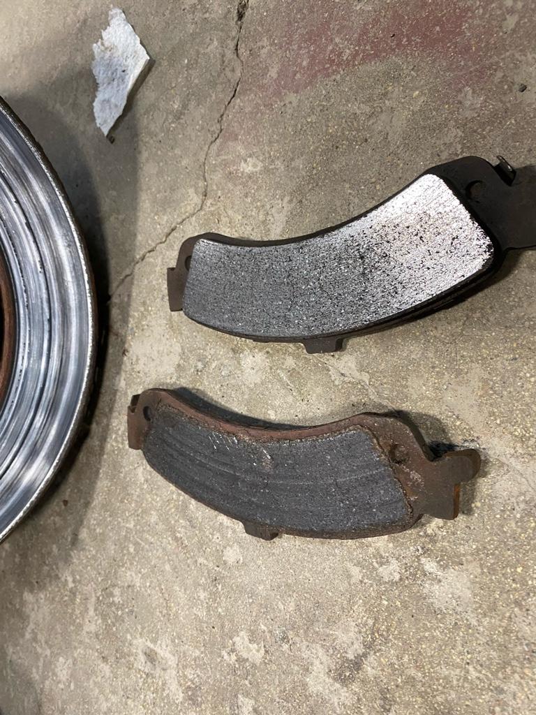

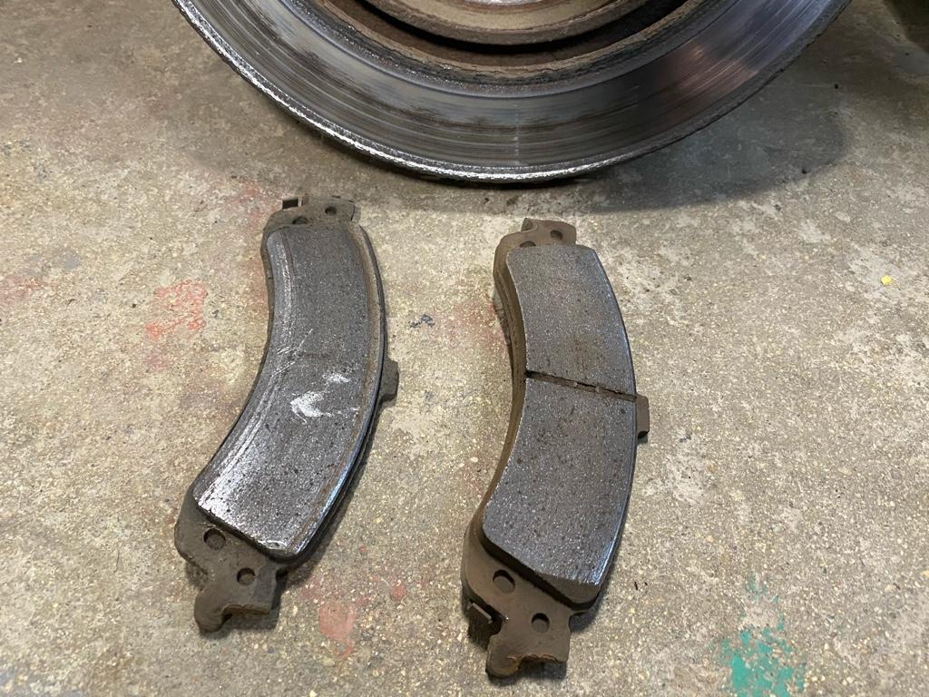

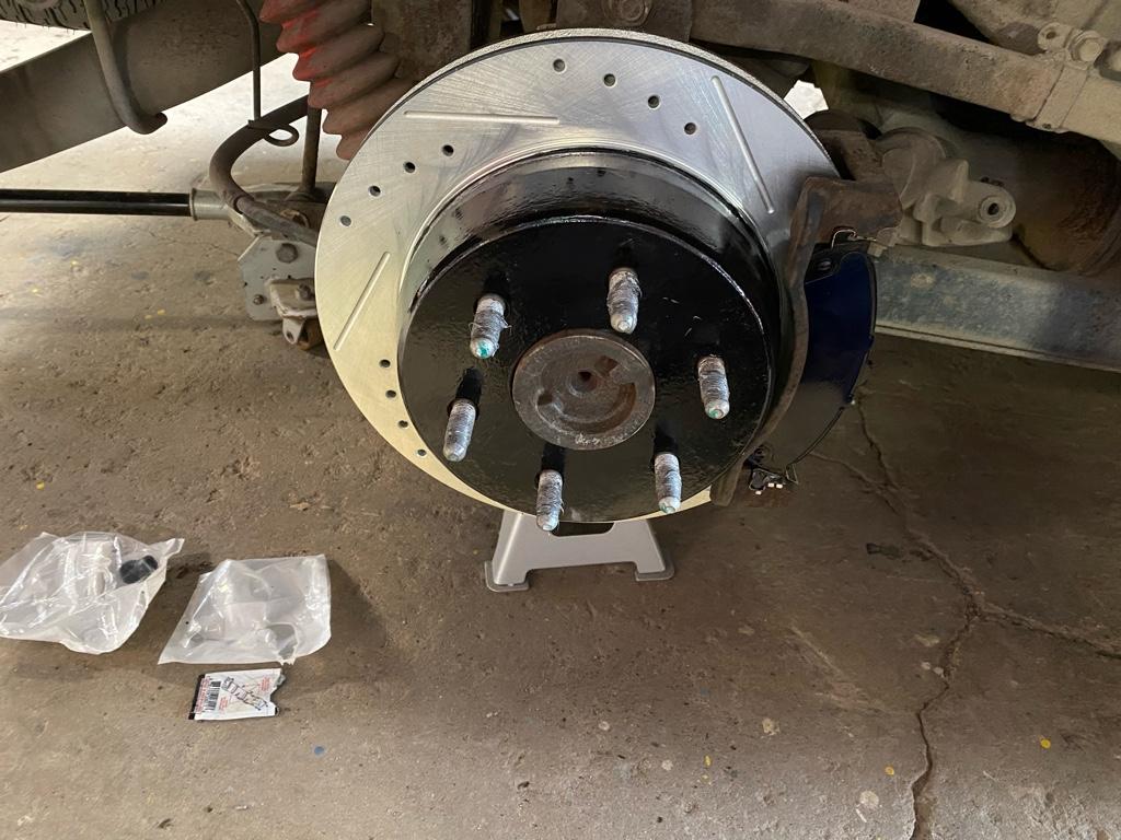

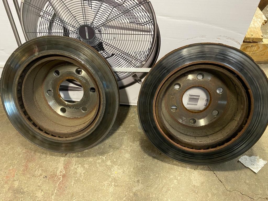

After our trip up north for the 4th, I noticed the rear brakes making a noise. Pads look thin so I went ahead and ordered some PowerStop pads and rotors from Rockauto.
They came in on Wednesday so I took the rotors to work and wire wheeled the hats so I could slap on some POR15.
Must not have taken pic of rotors when I finished painting them. Oh well, they’re in the next few pics.

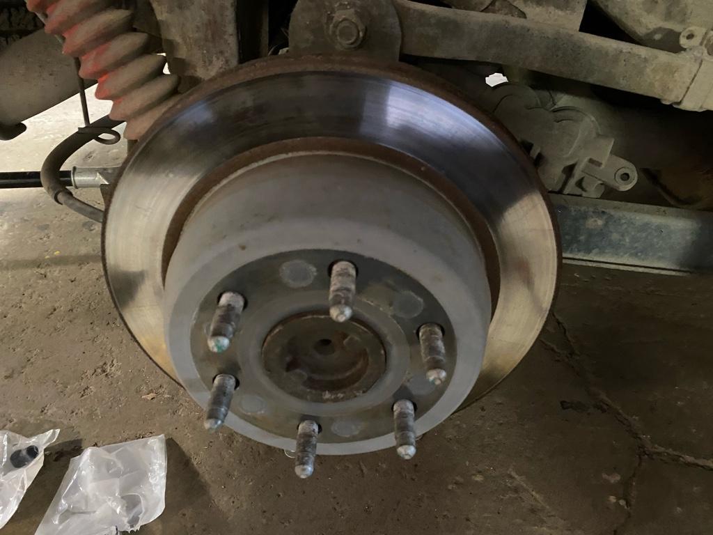

Today I pulled the wheels and got started.
Drivers side pads and rotors. This was the noisy side.
Passenger side

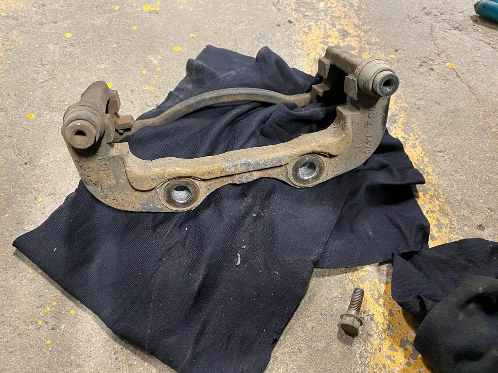

The passenger side only had one bolt holding caliper on. The bottom bolt was missing!! I drove 730 miles with my kids and dog in the car like this!!
The bottom pin was seized in the bracket. Had to order new pins and bolts. Cleaned out the bores for the pins and lubed the shit out of them.
So now I don’t feel confident with any of the work the previous owner did. So I’m gonna have to go over the front end with a fine tooth comb to make sure everything is good and not gonna fall off!

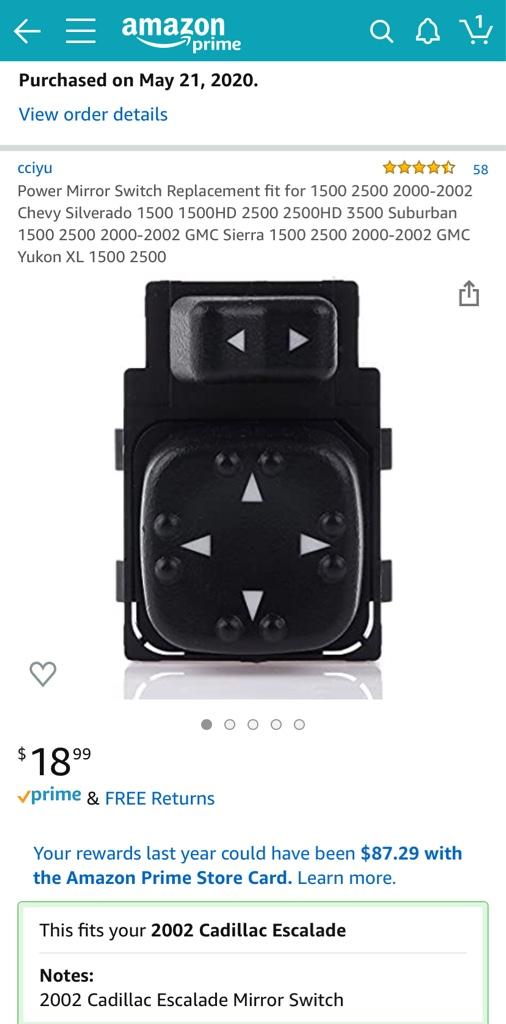

Forgot one more part I put on. Mirror adjuster switch. Tested it first and it wouldn’t move either mirror in any direction. Simple and cheap. I can’t stand when things don’t function as intended. Hell, most of the time I can’t stand when things function as intended, they can always be better!
