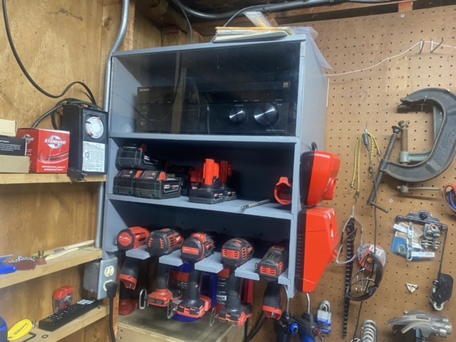

We got home around 2pm and I wanted to get my new garage radio hooked up. Jess took Julianna to a birthday party so I started on that.
I bought a Sony receiver with Bluetooth but while I’m looking at it I realize this thing is gonna get dirt and dust in it because of the vents on the case. Now I have to make an enclosed shelf for it. I can turn anything into a project!
As I’m planning this thing in my head and seeing what I have for wood, I remember I wanted to build a holder for my cordless drills, drivers and impacts. Hmmm, now it’s getting seriously involved. Lol.
All I had for what I wanted to do was plywood. That’ll have to do. As I’m sketching it on paper I figure the only way to really secure the shelves to the sides is by notching the plywood or attaching some 1x to the sides for the shelf to sit on. I don’t have any 1x so I decided to notch the shelves into the sides. No table saw either. So I set my circular saw depth to 1/4 and had to make 3 passes and then clean it up with a wood chisel. That’s what happens when a mechanic tries to be a carpenter. Had all the wood cut and notched and it was going on 6pm, had to go to work at 10 so I got a nap.
Monday morning I glued and used nail gun with 1” staples and put it together. Painted it with some battleship gray I had and went to bed. I was tired. Before work Monday night I got it up, installed radio and mounted speakers, and even attached my chargers to the side.
At work last night I cut a piece of plexiglass but I can’t find my hinges at the moment so I used couple small pieces of double sided tape and sealed off the front of stereo shelf.
What do you think? Will it get too hot in there? Should I add a small fan to the side with a filter material or just a vent with filter?

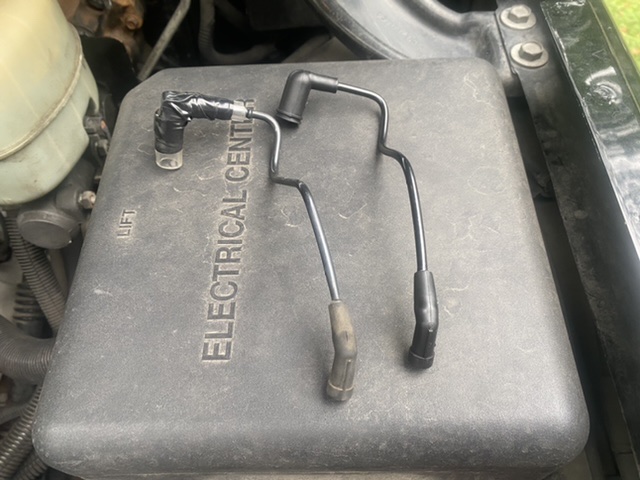

I gathered my stuff together to install the catch can on the Caddy so I could bring to work and then loaded branches in the truck to dump at work. Then my phone rang, it was work. The afternoon guy, 3p-11p, called off and they needed me to come in at 7pm. SOAB!! By the time I stuffed my face and showered it was after 2pm. I woke up for no reason at 4:55 and couldn’t go back to sleep. I came in on 2.5 hrs of sleep maybe and then when I get here I see the reminder that I have skid steer and aerial lift training in morning from 7a-11a. This really sucks!

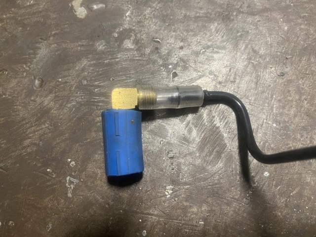

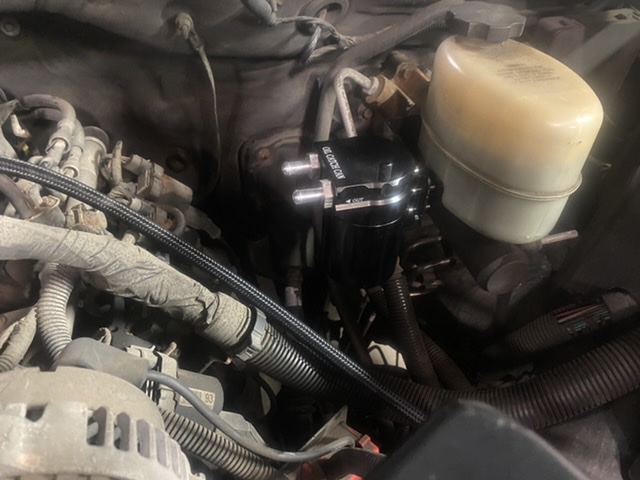

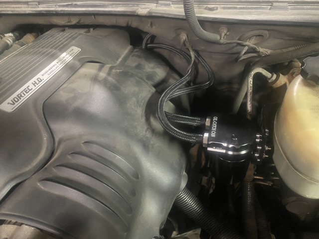

So I’ve kept myself busy tonight because if I sit down I’m liable to fall asleep. Started on the catch can about 3am. Bracket was already attached to the can so it was just a matter of bolting it on to the master.

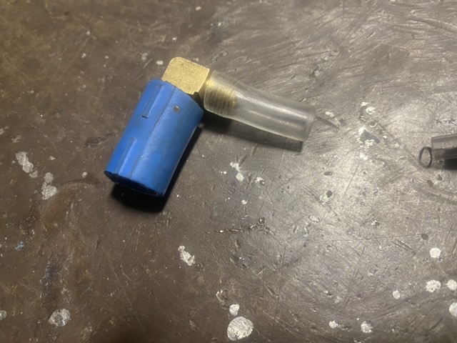

I pulled the plastic pipe that goes from top of intake to PCV valve and started putting on the 3/8” braided hose to vacuum port on intake. That’s when I noticed the small plastic vacuum line that goes from intake to fuel pressure regulator And I thought, I better take that off before I break it, which I have in the past because they get brittle. Well, I broke it taking it off. Just the rubber boot on the intake side but I don’t have anything like that here at work. So I started scrounging for something that I can use.
I couldn’t use just a hose because the fitting on intake faces straight up and it’s a 3/8” fitting but is only a 1/8” line that goes to regulator. So I need to bush it down on a 90° elbow. Best I could find was a 1/4 NPT to 1/8 compression 90°. The 1/4” was a tight fit into a small piece of 3/8” hose. But the 1/8” hose won’t go on the 1/8” compression side threads. So I had to use a 1/4” piece of hose and shove the 1/8” inside of the 1/4”. It’s rigged but it fits under the cover and is air tight because I blew in it. I wrapped it with electrical tape too. It’ll work until I get home and see if I have that rubber fitting.
After that I was able to finish it up by running the hoses to the catch can. I’m gonna put new 90° fittings in the catch can to clean up the routing but at least I was able to sneak the lines out behind the cover without having to cut or notch the cover.
This should have taken me 20 minutes but instead I had about 90 minutes in it finding fitting and hose. I’m tired and I hope I can make it til 11. I might have to take a nap in the truck before I drive home.

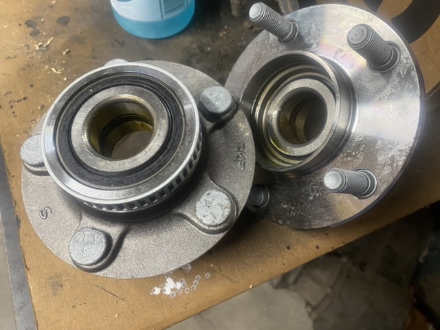

I was looking for belt tensioner on Rockauto last weekend because I plan on changing the belts on this Intrepid and I ended up getting 2 new rear hubs with bearings.
I’m not sure if you guys know this but when you go on Rockauto and enter your vehicle, you’ll see “RSS” next to the top heading. Click on that and then click on HTML and it shows you all the wholesale close out parts available for your vehicle. That’s where I found the hub bearings and they are Mopar parts. They were $14.84 each so I had to grab them. I also got Moog rear driveshaft u-joints for my 2500HD for $9.45 each.
After I placed the order I forgot to get the tensioners. Oh well, I’ll just grab them local when I change the belts.

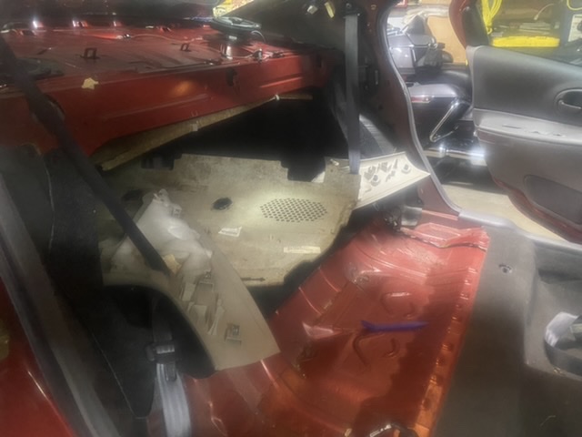

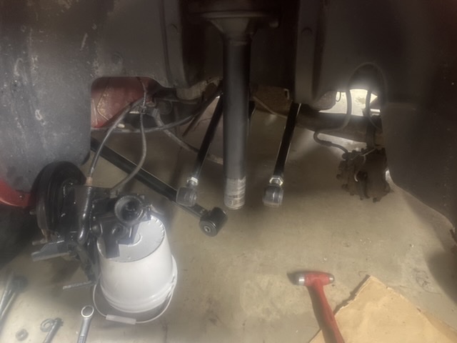

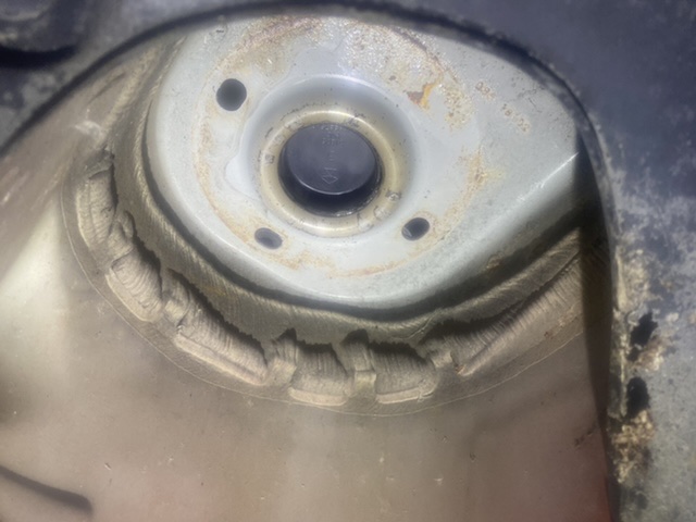

I don’t see any signs of anything touching or rubbing. The top of the strut looks like it was seated fine against the tower.
No marks like it was moving at all. The tower is the same way. Everything looks good with no signs of anything hitting.
So I started looking for something else that would cause this rattle noise. Only thing I could find is this. But the noise sounds high, maybe it’s just resonating thru the structure.

Back together and going for a drive. I had my brother stop by and he said that the sound does seem to be what we were hearing. With him moving that link I felt the top of the tower and I can feel it just like before and that was with the strut out. So I tightened down on that bolt and if it’s better or gone I’ll know that was it. Those links seem to have a slightly larger bore in the bushings making them loose fitting on the bolts. My next step will be drilling out the mounting tabs and installing a larger grade 8 bolt for the links. Hope this works! I’ll report back shortly.
Unless it doesn't get very hot (how hard you gonna drive this thing?), I would do a filter on one side, PC cooling fan on the other, just like a network cabinet. Some are updraft, some are cross-draft. Updraft is more efficient since heat rises and the filtered intake can be on the bottom where it's protected. In a garage, the fan up top can allow dust in. So, a cross-draft is probably ideal. A fan can easily move plenty of volume through that small space so you don't need every last ounce of efficiency. Plus, it'd be nice to not have to worry about blocking the fan if you wanted to put something on top of the cabinet.
First thing my brother said when he seen it, you need a fan or some sort of ventilation on that thing.
I don’t usually drive it too hard while I’m out there but I do occasionally. 90/10. But I will still add a fan. Sucks because I just recently threw away 2 fans that I had saved from work for VFD cabinets. I might be able to find another at work.
I think the cross flow would be the way to go because of the dust like you mentioned. Thanks for the response.
I've got a bunch of fans laying around in the shop if you need one. I think I have some ones with filters, too. Lmk.
Thanks. I really wish I would have seen this 2 days ago. I bought a dual fan setup off Amazon. They were only $15 which I didn’t think was too bad. What I really liked about them is they plug into the usb on the stereo and have a 3 setting switch. So they will come on and off with the stereo and I don’t have to remember to turn on and off. But I really appreciate the offer. I have a few here at work that are 120v and I was thinking of a way to tie them into the power button on stereo but I didn’t want to dissect it just in case I have an issue with it and they tell me I voided any warranty. Now I just need to cut some openings for them. I’ve been just opening the front while it’s on which kinda defeats the whole purpose of building the enclosure.
It's fairly common for AV receivers to have a switched 120VAC receptacle. But you should be fine with the USB fans.

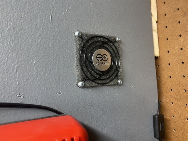

For some strange reason this receiver doesn’t have a switched plug on the back. All my other Sony ones did. Always plugged the CD changer into it. And this USB port says “for service only”. So I had to run the fan power to my surge protector that has USB outlets and have to remember to turn off the switch.

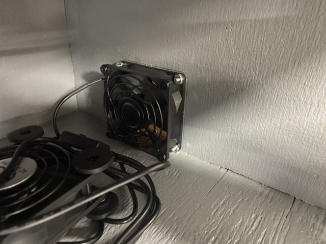

Here’s how I ended up installing the fans.
Drilled a 3” hole in both sides.
One fan blows out from the inside and is screwed into place.
The outside of the fan has a filter behind the guard. And you can see I used double sided tape to hold the switch where I can get to it.
The intake side I cut a piece of what I had laying around and painted it. It holds a double layer of filter material.
The second fan is on top of the receiver pulling air up. I know the holes are low and probably should have them up where the hot air would be but at first I was gonna have one fan blow in and other blow out and I wanted the air to move thru the side vents of receiver but realized after that there wasn’t enough room for fans on either side. It’s still moving air thru the cabinet so I’m not too concerned. I even closed up the hole in the back where the wires come thru with some foam I had.

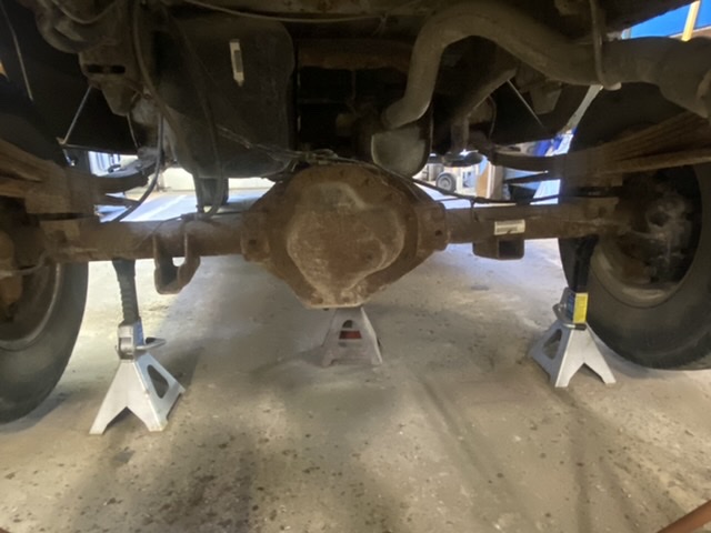

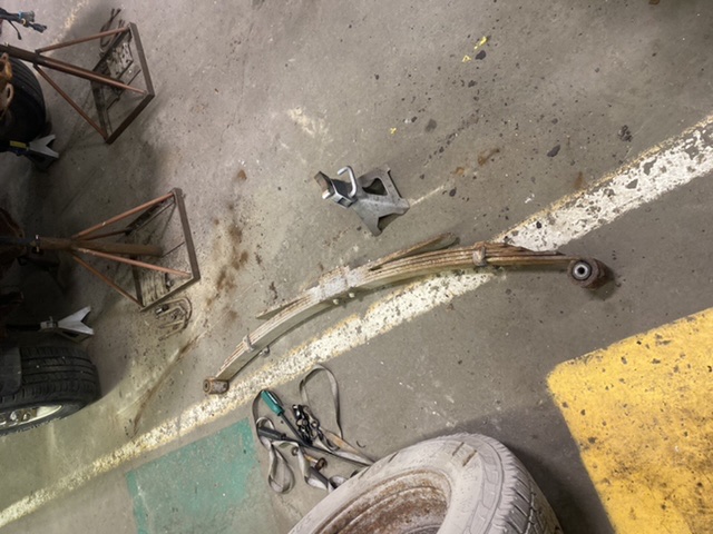

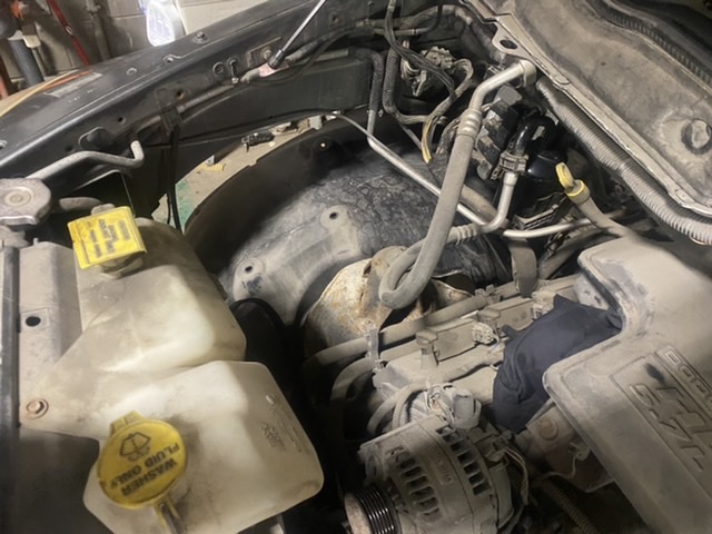

Not sure if I got into this before but we have an 06 Ram bighorn at work that we abuse. The V box salt spreader goes in end of November and doesn’t come out until end of April most years. We plow with it and our plant has multiple rail crossings and speed bumps that really put a beating on our trucks. I hate plowing in the F250 because it’s a single cab and the seat don’t go back far enough for my liking. I like to use the crew cab Ram.
It started with a power steering leak at the pump. So I decided I would change it rather then it being sent out because it would have taken forever for them to finally give us the ok to bring it in. I did the pump, all the lines and the cooler. Few weeks later the trans cooler started leaking. So then I did new lines and cooler and a flush. The trans is only 4 years old in this thing because it’s been replaced when it lost reverse during plow season.
Right after plow season this year the steering was loose. I found a bad tie rod and drag link end. So again, I did the work and replaced the entire front steering system. I didn’t save the pics because they just took up space on my phone.
Then in June one of the guys mentioned that the ac doesn’t hold charge and would like to get that fixed. It doesn’t bother me about the ac but come winter I would like to have that just for defrosting the windows. So I tested it and found a bad seal in compressor behind clutch and the electric fan was bad for condenser. Had them order everything and I did the work. New compressor, accumulator, condenser with fan, new line with orifice and I also flushed evaporator and lines before putting it back together and charging it.

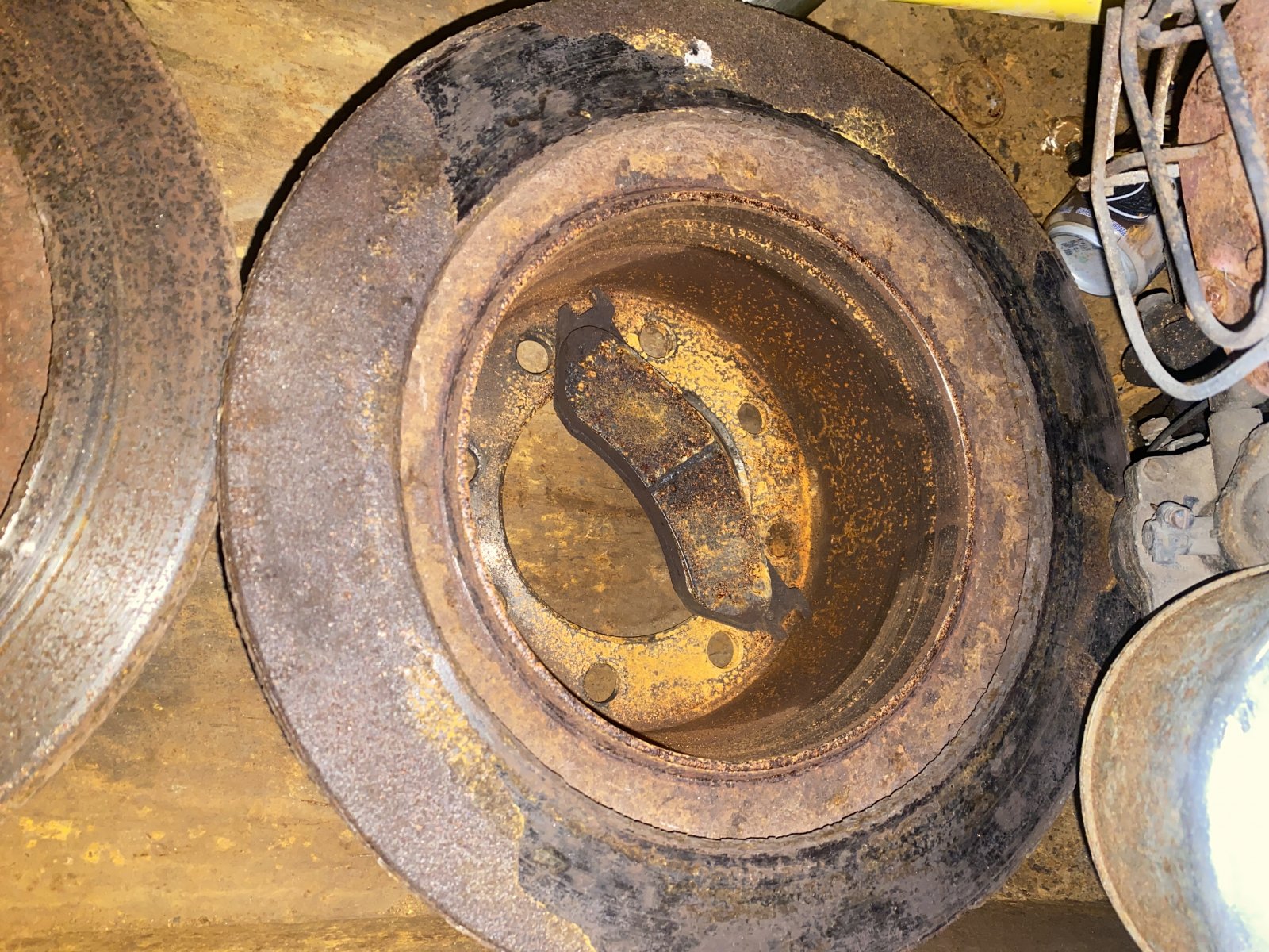

Couple weeks ago I get in it and the brake pedal is pulsing something horrible. I check it out and it’s coming from the drivers side rear. The rotor was horrible and looked like it almost delaminated. Again, no pics but the rotor is still here sitting outside so I’ll show that but it’s rusty now so might be hard to tell.
The pads looked brand new but I still replaced them. I almost think this was a bad rotor, I’ve never seen one delaminate like this before.

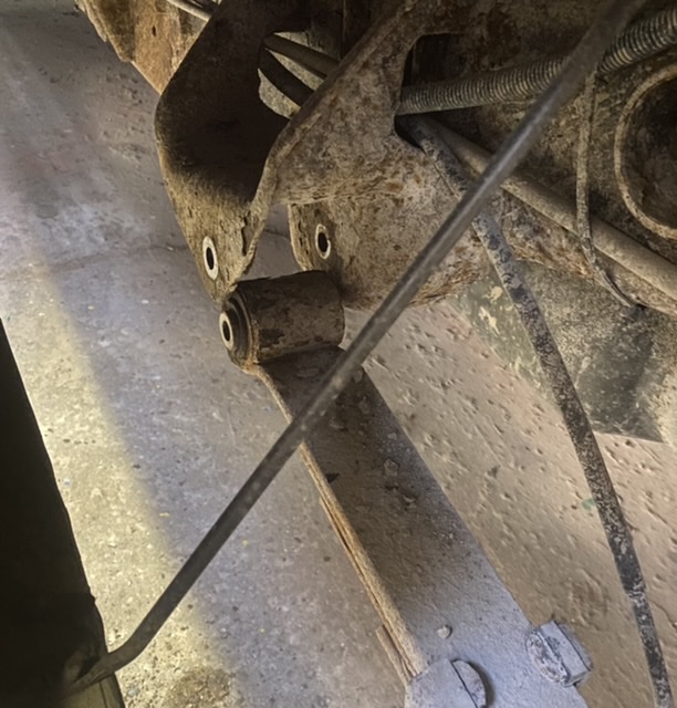

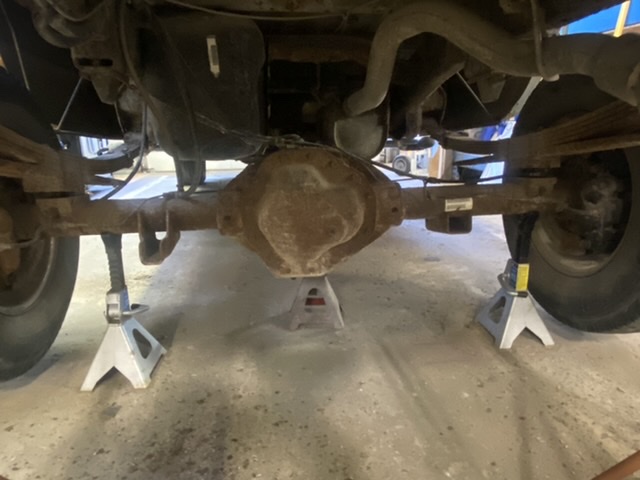

So anyway, while I’m doing the rear brakes I find a broken rear leaf spring. Now I wish I didn’t raise my hand to do the repairs on our trucks. This is gonna suck.

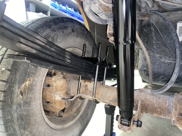

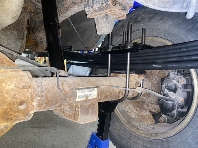

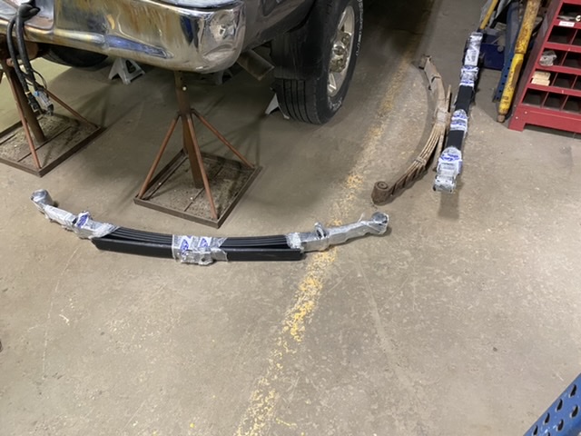

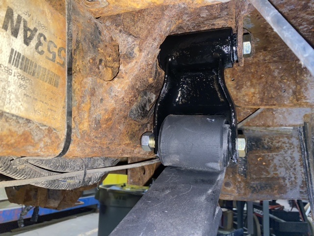

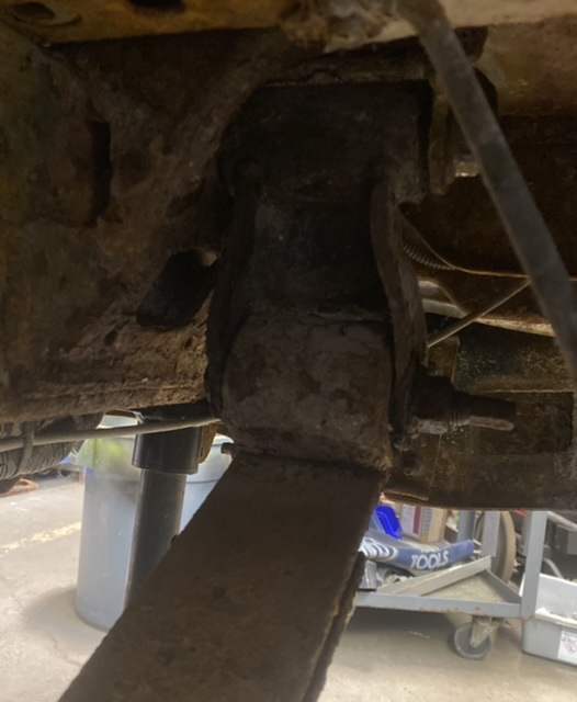

I send our supervisor the parts list and he orders them. I got the HD springs which are 3300# vs the 2960# ones. This thing fought me the entire time. I brought in my stands I made years ago for my lifted truck so I could support the frame in the back.
Things were so rusty and didn’t want to come apart.

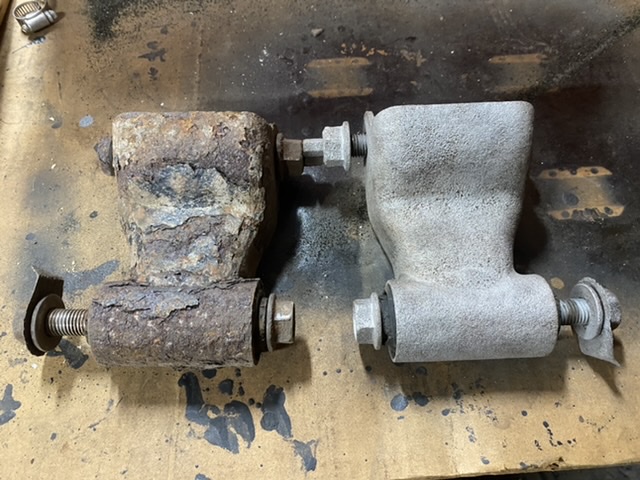

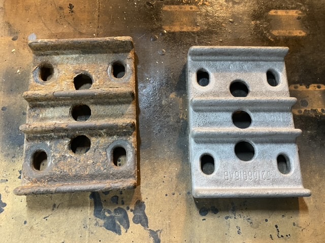

I did end up getting the springs out but man were they some heavy suckers. The parking brake on the front and the hydraulic brake line on the rear of the axle, I could just drag them off or they would have broke the brake line so I had to lift these things out the back by myself. I tried setting the rear of the spring on the ground but they would have hit the brake line and because I’m by myself on nights nobody was around to grab the rear or at least give me something like a bucket to set it on. And of course my radio was 15 feet away from me at the time so I just struggled thru it.
I ended up taking the spring plates and shackle hangers home and blasting them. They were ugly.
3 days later the parts came in from Rockauto.
