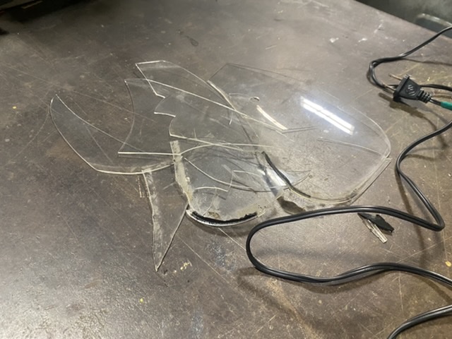

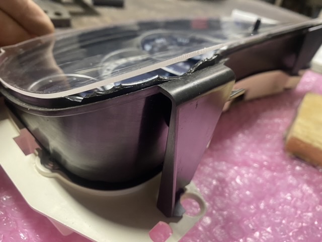

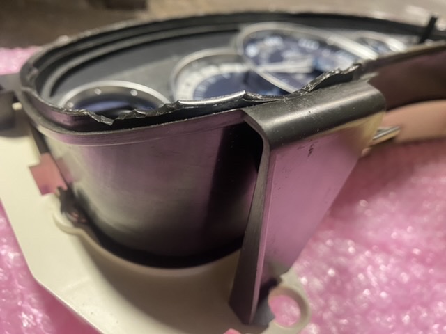

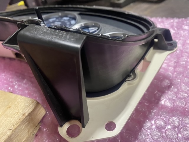

The odometer and gear selector display sometimes doesn’t light up when you start the vehicle. Jack said something about it one day and I tapped on the display and it lite up. He said it’s annoying because he doesn’t know what gear he’s in when it’s not on. I explained to him how to tell without seeing it but I agree, if should work. Asked him about it a few weeks later and wanted to pull cluster but he didn’t have time and said it’s fine, it works when I tap on it.
Well, now that I have the vehicle back I can see he did a little more than tap on it. The clear lens was cracked in a few places. I couldn’t find the bezel for the Caddy, only Tahoe or Yukon. It was a discontinued part from GMPartsDirect. I did however find the clear cover but it needs to be glued on after old one is removed. So I ordered it. It was $40 or something in that ballpark. Tonight I pulled the cluster to check it out.
It came off in pieces and some stayed stuck to the bezel that I’m gonna have to carefully remove.
It looks like it’s been replaced once before and they broke the bezel in more than a few places.
Somehow I’m gonna have to build it back up by plastic welding to it and then sanding down. That’s gonna be fun. Here you can see the gap with the new cover sitting on it. But it’s also sitting on some of the old lens that needs to be removed. It’s still a good gap.

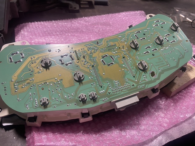

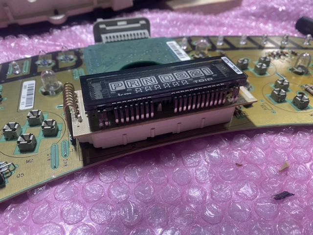

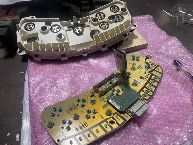

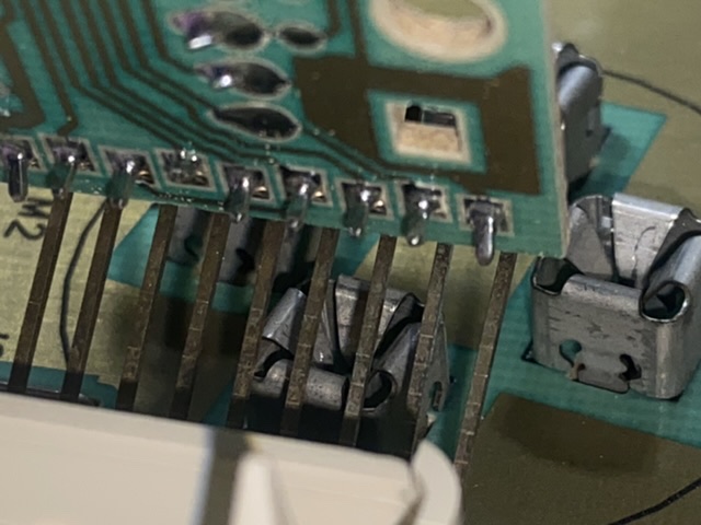

While it’s off I needed to find out why the display was intermittent. I started by removing the back cover and then the circuit board. Being very careful not to break this 20 year old plastic board I gently pried it from the stepper motor pins.
These are the pins for the stepper motors.
Got it without breaking it.
Snowbound
Snowbound
Jim
Nov 23, 2016
1,058
2,496
Chicagoland (Lockport)

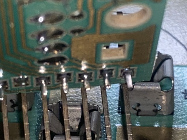

Everything looked good besides the top pin going to the display was a little loose. Seems like a bad solder but it’s on the bottom of the display. I had to gently pry on the plastic pins and carefully lift the display while bending the pins so I could expose the underside. Very nerve racking but it had to be done.
That’s it! Solder came loose. Hard to see it pic but it’s the one all the way on the right.
Soldered it back together and ever so gently bent the display back into place over the plastic clips.
Put it back together minus the clear cover and put it back in the dash and it works. I’ll pull it back out when I get home and then I’ll have to do some major surgery to repair the bezel and get the lens cover back on and sealed up. I don’t like stuff like this, I’ll have more hours in it than it’s actually worth. I’ll keep looking for a used bezel but for now I’ll do what I can to repair it. Good thing is I’m not in a hurry.

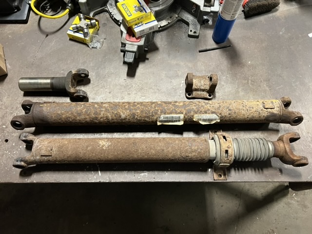

This week was another fiasco with that Ram. After the springs and shocks went on I drove it out of the shop and it had a horrible vibration. I felt it slightly before the spring change but we had plans to bring it in for alignment and oil change since the alignment was never done since I changed the front end. I told the supervisor to have the shop check out the U-joints in rear shaft. But now since it’s really bad I can’t let one of our guys drive this thing to the shop, it might spit a joint with how bad it vibrated. So here we go again. And by “we” I mean “I”.
I thought the bolts were gonna break at the pinion and the center support bearing. Had to spray them and work them in and out to keep them from breaking. Finally got it though.
I’ve had some joints that didn’t want to come out but these had to be the worst. Beat ‘em, heated ‘em, beat ‘em some more and was only denting the yokes. Had to bring in my ball joint press had put tension on the joint while heating the yoke to get them to move. And this was after every retaining clip broke and had to use a chisel to knock out the clips piece by piece. Why do I do this to myself?
2 days to get the joints out. Ridiculous!
Going back together was just as bad. Had to spread the yokes a little because I didn’t have room to get the clips in like I went thru that time on her Esky. Took all night to get this shaft back together and put back in.

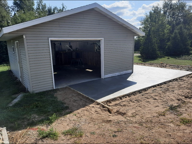

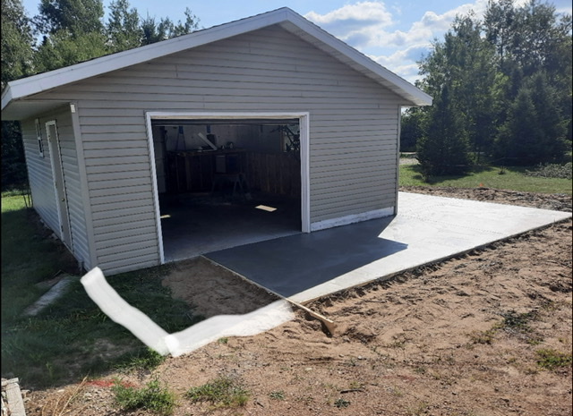

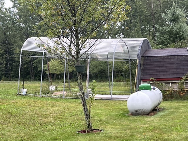

As I mention earlier, the concrete pad got poured up north but I can’t get anyone to come out and even give me a quote to move the garage. Talked to my brother and we decided that if we had to, we would just move it ourselves. I didn’t even realize at first that when the concrete guy sent me the photos, he didn’t pour the pad all the way out to the south where I wanted it. I think I was just so happy to be getting concrete I overlooked it.
I need this out here because it’ll be an apron for the south facing door. Without it, the existing pad will be half way into the garage door opening so it’ll be like half an apron and also I need it for when the garage is on rollers I’ll have something to roll that corner on instead of trying to shore it up with plywood.

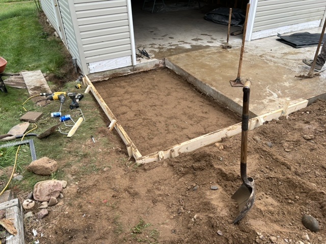

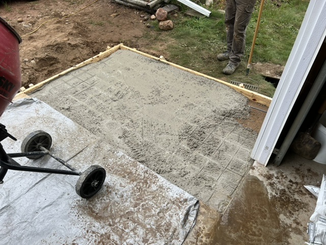

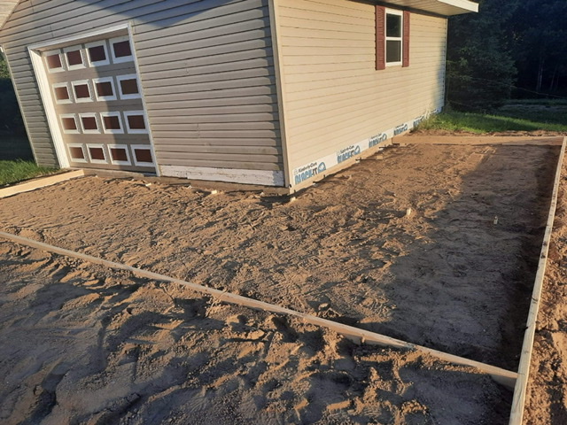

Drilled the concrete to pin it with rebar and then set up the forms sloping to outside corner for runoff.
Next we put down the sand. Filling 2-3” and tamping that down until we had our 4” from top of forms for the concrete.

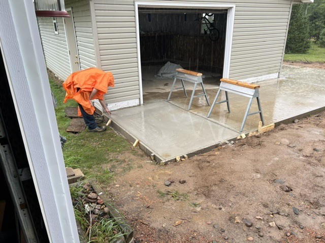

Next we blew out the holes drilled, filled with epoxy and hammered in the rebar. Put down the screening and wired it to rebar and supported it so it was 2” off the sand. I forgot to take picture before we started to pour concrete but you can see the screen here.
It took every bag of concrete we had but thankfully I figured it just right. Having brought up the concrete mixer from work was a life saver. There’s no way I would have been able to do this in a wheelbarrow.
Because it was raining on and off it took forever before I was able to float it out. While I was letting it sit I pulled 2 sleds off my 2 place tilt trailer and dragged that around front. A buddy at work gave me his drop in bed liner from his truck and I cut it into strips to attach it to my trailer for ski runners so they don’t scratch up my new decking I put on trailer. No pictures, I’ll get some later.
Last trip up I brought some corrugated plastic sheeting with me so we could attach big to the top of the portable garage that collapsed on me last year. The wet heavy snow tore the canvas so I wanted to try something to give it a little more support and hopefully the snow will slide off. So we did that while the concrete was setting up.
I was going back and forth between plastic sheeting and floating the concrete to keep standing water off of it. I didn’t stop moving all day long!

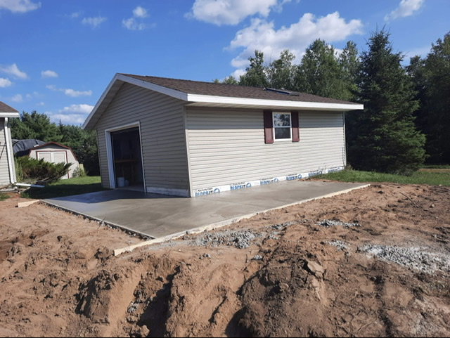

The new canvas cover showed up on Friday so I was able to bring it up with us. But it got too late Saturday to put it on and the mosquitoes were killing us!
It wasn’t until around 9pm when I was able to finish the concrete and edge it out. It still wasn’t set as much as I would have liked but I wasn’t gonna stay up and fight the bugs, it’s only an apron! Before we called it a night we had to cover the slab with plastic sheeting. The lightning was getting closer and I wasn’t gonna let it pour on this all night. Threw down the plastic sheet and I could see it was gonna be ugly so we pulled it back off and had wrinkled lines on concrete surface. This sucks! Hit it once more with the finishing troll and then we set saw horses on garage pad, laid sheets of plywood on an angle with one side on ground and other on horse then covered the plywood with a big tarp. Kept the concrete covered without touching it. That was it for the day! Went in about 10pm, showered, stuffed my face and passed out.

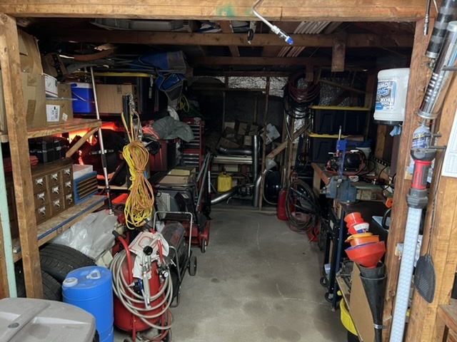

I previously jammed everything in my garage over to one side in preparation for my garage addition. Due to the concrete supply that never happened. I need to get my sled in but don’t want to kick my wife out so I spent some time cleaning and moving things back into the attached shed. I wasn’t worried about being organized because this stuff still needs to be gone thru and put away once the garage is built. I just need to access it when I need it but get it out of way so I can work on my sled.
Took everything off the metal racking and stacked it up, cleaned the floor in shed, reattached some wood shelving and bench in shed then moved rack over to shed and threw everything in shed to get out of garage. Hard to believe this was completely empty 2-1/2 hrs prior to this picture. Lol.
I can almost see the outside wall again in the garage! This picture was Tuesday morning.
I’ve been living like this for a year and a half now and it’s driving me absolutely crazy.

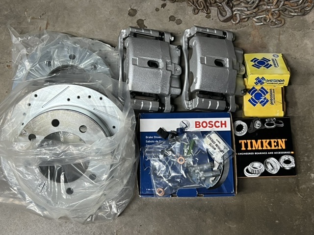

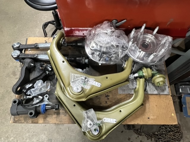

As far as those packages go, I need to change the front end on my truck, do the shocks, rear backing plates and parking brake shoes. So I ordered these parts.
Rear calipers
Backing plates
Shoes
Hardware kit
Axle seals
U-joints for rear driveshaft
Front hub bearing
Inner and outer tie rods with sleeve
Idler arm and bracket
Pitman arm
Upper a-arms with alignment bolts
Sway bar end links and bushings
Bilstein 5100 shocks
Lower ball joints
Hub bearing mounting bolts
Next weekend I have to pull a tractor to southern Illinois for a buddy and we have a trip planned to go to Tennessee beginning of October. Any time I get a vehicle I like to replace the front end just for a piece of mind and then I know everything is new and it’ll all be under warranty. That’s just what I like to do. I never really went over the front end of this 2500 when I got it and I don’t wanna be doing it during snowmobile season.

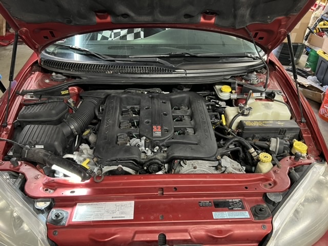

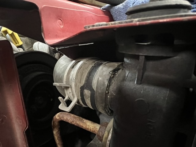

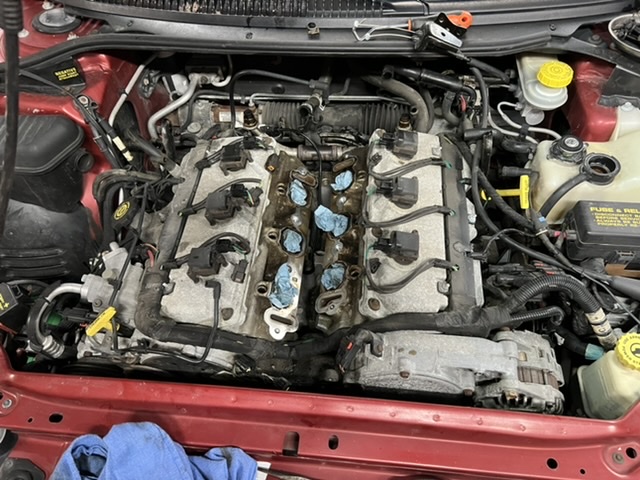

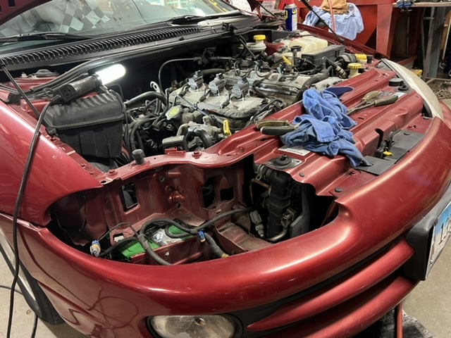

Wednesday when I got home from work in morning I hooked up scanner to the intrepid and is has miss fire on #3 cylinder. Fuel trims on bank 1 were -99% so that tells me injector is dumping fuel.

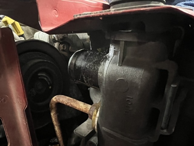

Got started on that right away. Had to pull upper plenum and lower intake. Only reason I pulled lower intake was because the bolts that hold the fuel rails are the intake bolts. Once I removed the inner 4 bolts I knew the intake was gonna leak if I didn’t replace the gasket.

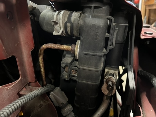

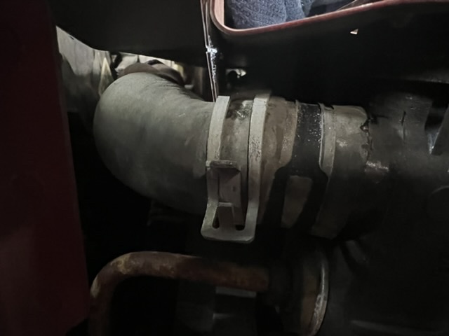

Upper radiator hose was soft so I’m gonna replace that as well. Have to pull the right headlight out to get to the hose on radiator.
The lower core support is pushed in so the radiator, condenser and coolers are sitting at an angle.
This sucks but I’m not gonna remove everything and try to straighten it. I couldn’t get the clamp off because the top support is on the hose!

Time to improvise. I cut out part of the top support just to clear the hose.
Nobody local had the injectors so I had to order them. Parts ordered were injectors, intake gasket set, radiator hoses, fuel filter and knock sensor because it’s under the intake and I’m here.
Got done with that about 11:30am and ready to call it a day when the wife tells me the AC stopped working in the house. Checked that out and it’s the capacitor for the fan and pump. Ordered that so I’ll have to replace that as soon as I get it.
I’ll get everything cleaned up and ready to go back together in morning and then go to bed. Wake up around 5 and see it I can’t get it back together and running again before I have to leave for work.

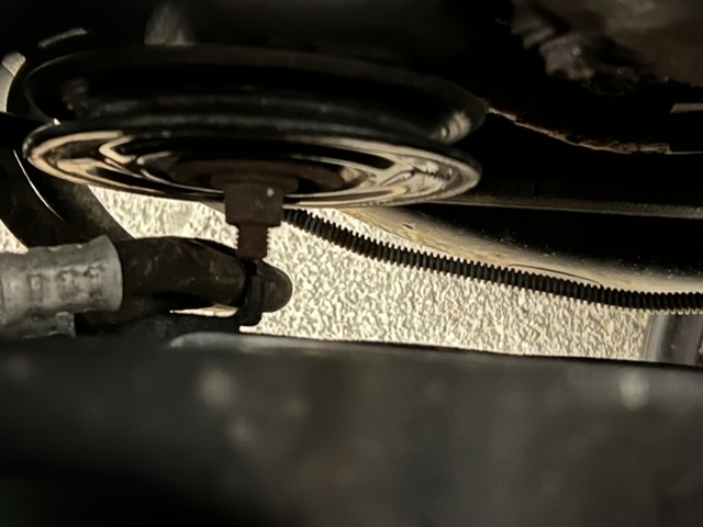

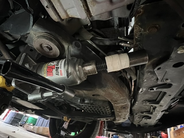

I ran some coolant flush thru it and went to drain it and couldn’t get to drain on radiator. That bottom core support being pushed back made it hard to get to. Also noticed the trans lines were against the tensioner pulley for ac belt. I couldn’t even get the belt off the pulley they were so close. The pulley wore past the plastic retaining clip that held the trans lines to bottom core support and were just rubbing on the lines themselves. So before I could drain the radiator of the flush I had to try to move that lower crossmember.
Had to use a 1-1/4” PVC pipe to hold a socket to top of bottle jack because I don’t have 3 arms and pushed the support forward.
Now I was able to drain coolant flush but had to do it again because it still was nasty orange color. But I had plenty of room to change belt and get lines off tensioner. I moved that thing 2” probably.

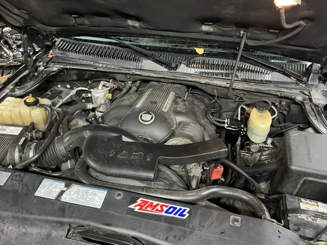

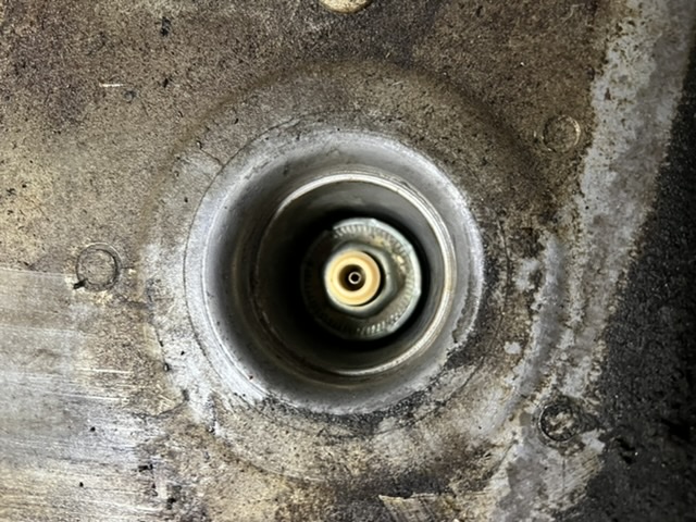

Last couple times I drove the Caddy it threw a check engine light for knock sensor. Figured I may as well change them out instead of resetting the light so I dove in yesterday morning after work.
This explains why I was setting a code.
Front sensor.
Rear
