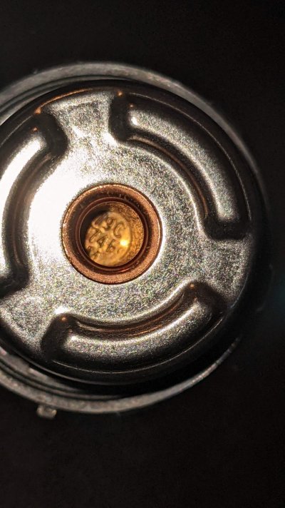

Motorad has some thermostats in 160, 174, 180, and 187. (And 190)
I tried the 174.. It opens enough to drop temp at 188, and closes at 186.
Today it was 92 out, and I could hold temp at 188 when cruising @30mph.
Don't think it will maintain much lower than that and in hotter weather and more load, who knows.
I'll set my fan to come on at 194 for now.

Speaking of which, I looked at my receipt, and I actually have the 174 degree Motorad (Lingenfelter spec)
Who knows if it was returned/boxed wrong or whatever, as I didn't look for any markings on the t'stat itself...
But, that might explain why people are disappointed if they wanted the 174 to not equal 188 engine temp.
Definitely, forget where I saw it, but a listing showed one temp, and if I zoomed in on the pick could clearly see it was the not the same. the motorad is way inside down in the hole at the bottom.

Installed Dorman aluminium(british accent) heater T's. 1 year old SKP T's came off no problem, but the Dorman hoses left their clip on the T. One spilled its o-rings and spacers. Think I got them back in right... Also replaced small sections of wiring loom that had disintegrated.
Replaced my 2 year old OEM thermostat that seems to stick. Slapped a Motorad 180 deg in there. Old one opened up (fully?) anywhere from 194 to 203 degrees. So far this Motorad seemes to drop temp around 188 deg. I will try a lower fan-on temp like maybe 195. (factory fan 1 on temp is ~201 degF)
Think I found the sticking point on the GM thermostat.
Do you have a p/n for that thermostat?
And you don’t have to use the British accent, some of us grew up pronouncing it that way. The number of strange looks I’ve received over the years. Usually at first people think I’m joking with them. Some have looked it up, others prob think the university degrees hanging in my office are honorary. Ha! Honestly it’s hard to pronounce it like they do in America. I have to slow myself down to pronounce it “incorrectly”.
That OEM stat was sticking from the start. Costs 3x what others cost!
Even though it was within normal operating range, the variability made me worry it might stick for good someday.
So far the Motorad is consistently at 188 degrees where I notice the temp dropping for the first time.
ECT modifier for spark timing shows upto -3 degrees at 212F coolant temp and 0 degrees at 194F.
So at 203F there would be upto -1.5 degree of timing pulled.
Looks like staying between 176-194 should be 0 timing pulled (or added).
