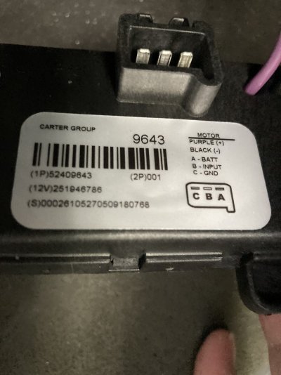

replaced the blower resistor on my 2005 GMC Denali...I had lost complete fan speed control (it has been having a mind of its own since my purchase in June) this week...
appeared to be one of 3 fixes...the blower worked sometimes so I didn't think it was that...it could be the blower resistor or the HVAC control module and that was far more expensive so I tried the lesser priced "fix" knowing I could return the resistor if that wasn't the fix...
not happy with buying a no-name part but the OEM doesn't seem available (mine had the 3 prong connector in back for Auto HVAC) but so far I can turn the fan on and off as well as in between...
pic of the OEM part
