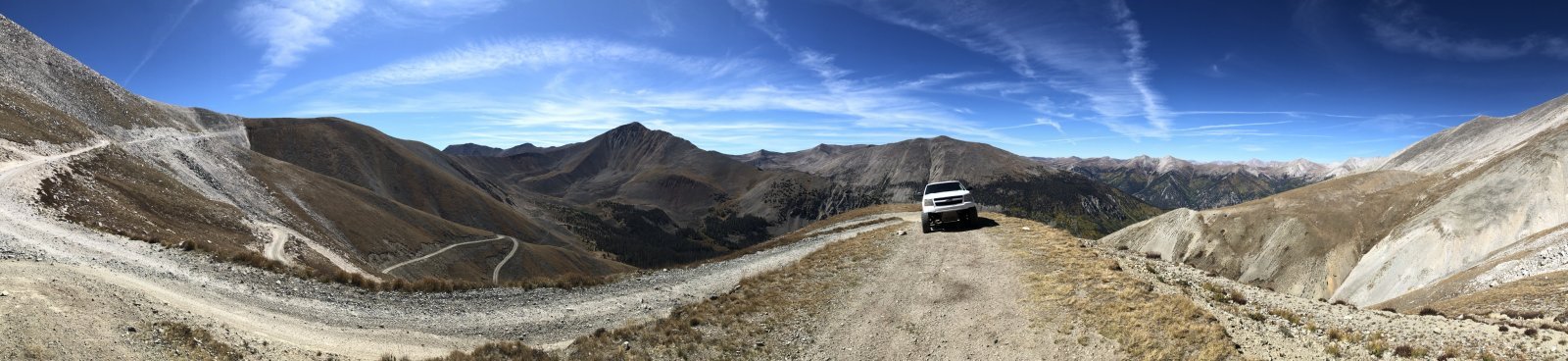

Navigated some long shelf road sections in CO today.
Stopped for lunch at this spot with nothing but high peaks in all directions, and came to a kind of bittersweet decision. This will be the Tahoe’s last trip with us out to places like this.
One of my goals this summer was to assess the build and decide whether to proceed with more mods, or move on. The Hoe may stay in the fleet and stay closer to home, but the potential consequences of mechanical failure in an area like this are just too severe. So I’ll be getting something new or newer for future exploring.
For the kind of places we like to go, it just makes sense to stay in the sweet spot of a machine’s reliability, which is neither the first 90 days nor 13 years+ of age.
