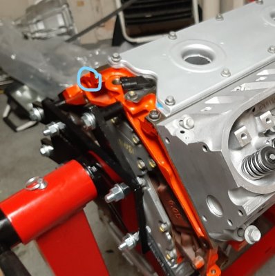

I cannot figure out where a few items go here...
This grounding strap comes off the harness going down across the front of the engine. The battery negative cable goes to the side of the block around there. Does this attach in the same place?
This bracket was attached to the back of the steering pump (I believe). I cannot figure out how it was oriented.
No clue the purpose of this. I recall it was attached to the passenger side head. This is the only orientation it would fit... or does it go on the back of the head? I cannot remember nor do I know what purpose it serves.
This was in my bag of bolts for the AC compressor / bracket. I cannot figure out where it goes though? Short bolt, has a washer on it.
Sent from my SM-A505U using Tapatalk
Not sure on that grounding strap. Really, if it's a ground, it can go anywhere on the engine or frame. Where does the other end go? You should do a Big 3 Upgrade anyway.
On that PS bracket, the single hole end goes to the side of the engine block. You'll see a hole for it.
That odd plate is to protect the rear of the driver side fuel rail. It fits the front passenger side because the heads are identical and just flipped around. It goes in that same position, but on the opposite corner.
That short bolt is either for the ground strap on the upper LH corner of the passenger head or it's the bolt for the engine block side of that PS bracket. I've always thought that PS bracket bolt was black, though. It having a washer and being in the A/C bolts bag tells me it came from that side of the engine so it's likely a ground strap bolt.

Hey @iamdub thanks for the help! I got most everything figured out cept that black bolt. I will investigate your tip...
