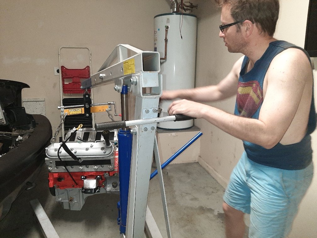

Released a 6.0 LS back to its natural habitat today.. Took about 3 hours. Give one for fiddling with lift. Was pretty easy...
Trick was having that harbor freight siccsor jack for transmission. Make adjusting dowel pins and aligning transmission a cinch.
I would recommend getting valley cover plate to lift with.. was real nervous using accesory bolt holes on heads.
Also having took front bumper and core support off made a HUGE difference.
I put front bumper on as was tired of tripping over it but should have left it off.

Nice, congrats! Get that puppy running!
Sent from my SM-A505U using Tapatalk
Hell yeah man, well done

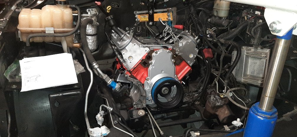

Cannot wait to get it running. Mostly amostly assembly work now. But still need to figure out how to setup and run the wideband O2 :/

Got all my bolts in, and slack taken out. Starting to put the bellhousing, and motor mount to frame bolts to torque spec.
Before I do that though, I torqued the flex plate bots. Probably that should be done last, however, I'm wanting to quadropoly check I don't have one of those builds that requires the spacer on end of crankshaft.
How would I know if I required that spacer on crankshaft snout (I'm not familiar with trust specs on 4L60E Converter). Here's my casting numbers:
Block: 12551364
Crankshaft: *sigh* I should have wrote more of this stuff down, is from a 2001 5.3L LM7
It looked like the torque converter had about 1/150 inch of space or so (just eyeballing it). Once I put in the toque converter to flywheel bolts everything came together easily. I know that torque converter moves back and forth a bit on the tranny output shaft but no idea how much?

I am curious about thrust specs (forward and backward movement) on torque converter behind flex plate. I had about 150 thosands (eyeball measure) of slack when bolting up the torque converter. Slack was taken up by bolts, curious if that is within nominal specs.

I think your flexplate/converter is fine.....stock converter right? Should bolt right up.

Ah yeah, they still are hydraulic but damn near a solid roller. I think the piston is 93 thousands long. I think factory LS7 drop-ins are like 150 thousands? My only fear is the cam won't like it and burn up, which would, well stink.
Manton Pushrods helped me spec the pushrods so all else should be fine. It should oil similarly to factory lifter just a bit less volume of oil. I need to hit up Tony one of these days when I come across some good loot and after the transmission is built. I would LOVE LOVE LOVE the 205 AFR mongoose heads. Roger Vinci said they'd be the perfect combo for what I want, a truck / torque motor.
Crazy thing, I built a low torque motor that could handle 7500 RPM. Kind of an oddity. I really didn't know what I bought when I purchased the LSR lifters. However, Manton said they will work awesome for what I want to do. I just don't know how much of a beating the cam will take with them / how much if any dampening they really do.
I think you're right on transmission. Apparently some of the early 6.0 motors had a different crankshaft to hook up to a 4L80E. That had a longer snout. I did some reading on it, finally found the info. And yup I'm doing a 4L60E (stock) with this 6.0 build. The built transmission is coming up next (different thread).
